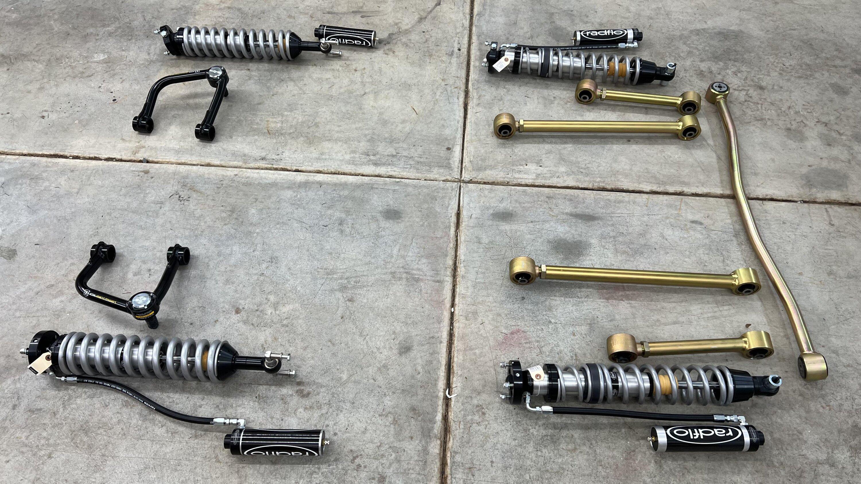

I was planning to kick off a Radflo thread! I have the extended travel Radflos, been waiting to get them setup better before posting online. I haven't tested offroad yet due to a couple of items that need to be taken care of on my overall setup.
For those that installed, are you happy with the 650lb springs in the front? Even with my winch, RSEs and fully loaded my math aligned with Fox springs, my 18" 550's ($224:cautious:) just arrived and installing them tonight. Kings come with 550lbs on the front, Fox 365lbs on the front (per Accutune). Radflo matches King on the rear so I'm good with those rates, 4.00” x 3.00 500lb / 14.00” x 3.00x 350lb. Older Radflo kits came with 18" springs on the front which is apparatly what I got, ordered from Metal Tech in March. The now current ext travel kit comes with 16" 650lb springs.
Also, did anyone check the rear resi clearance for where the instructions said to mount? Radflo confirmed I mounted in the right spot. My 35" Mickey's easily hit the resi just testing in the garage, I had to get creative and bent the resi mount to sit it more on top of the frame rail. My new rear links are exact same length as stock, maybe the move different? Next step is to move them forward like the Dirtlogics.
I am still happy with the setup: Radflos, Icon UCA and Metal Cloak rear links and track bar. Also installed the RC steering bushing, still need to install the RC rear brake line relo kit. Once I get it dialed in I think it's going to be awesome! Just annoyed about the resi mount (still not sure I have enough clearance) and the oversprung front (it's probably good for dunes and high-speed). Radflo has been very helpful, once I get the 550s on there I'll report back to here and Radflo.

How much lift would you say you gained it the front? Also, are you thinking that the 650 lbs front springs are to much?

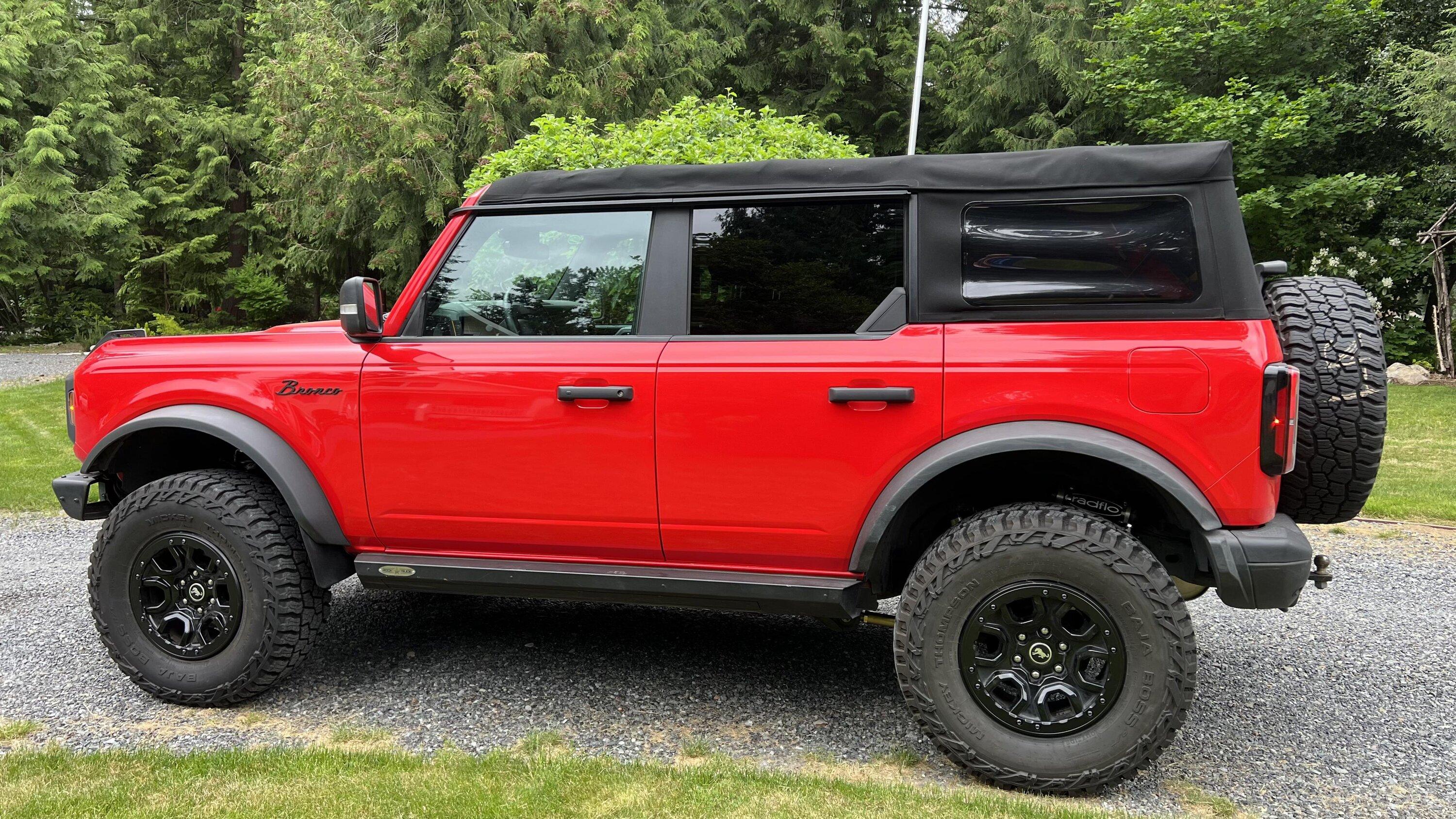

How much lift did you gain in the front? Did you start with the Bilstein's or Hitachi shocks?
I had bilstein, not sure how much higher it is.
These are still the stock tires.
On the front I'm sitting at 2.5" lift over SAS, I had to back the preload all the way off to get it down to there! Yeah, I think 650lbs is too much to let the suspension flex, the stock SAS front rate is 374lbs. 550 should drop the front a little bit and soften up the ride, right now it feels like I could full send a jump or run the Baja, 650 is probably perfect for that type of stuff.
