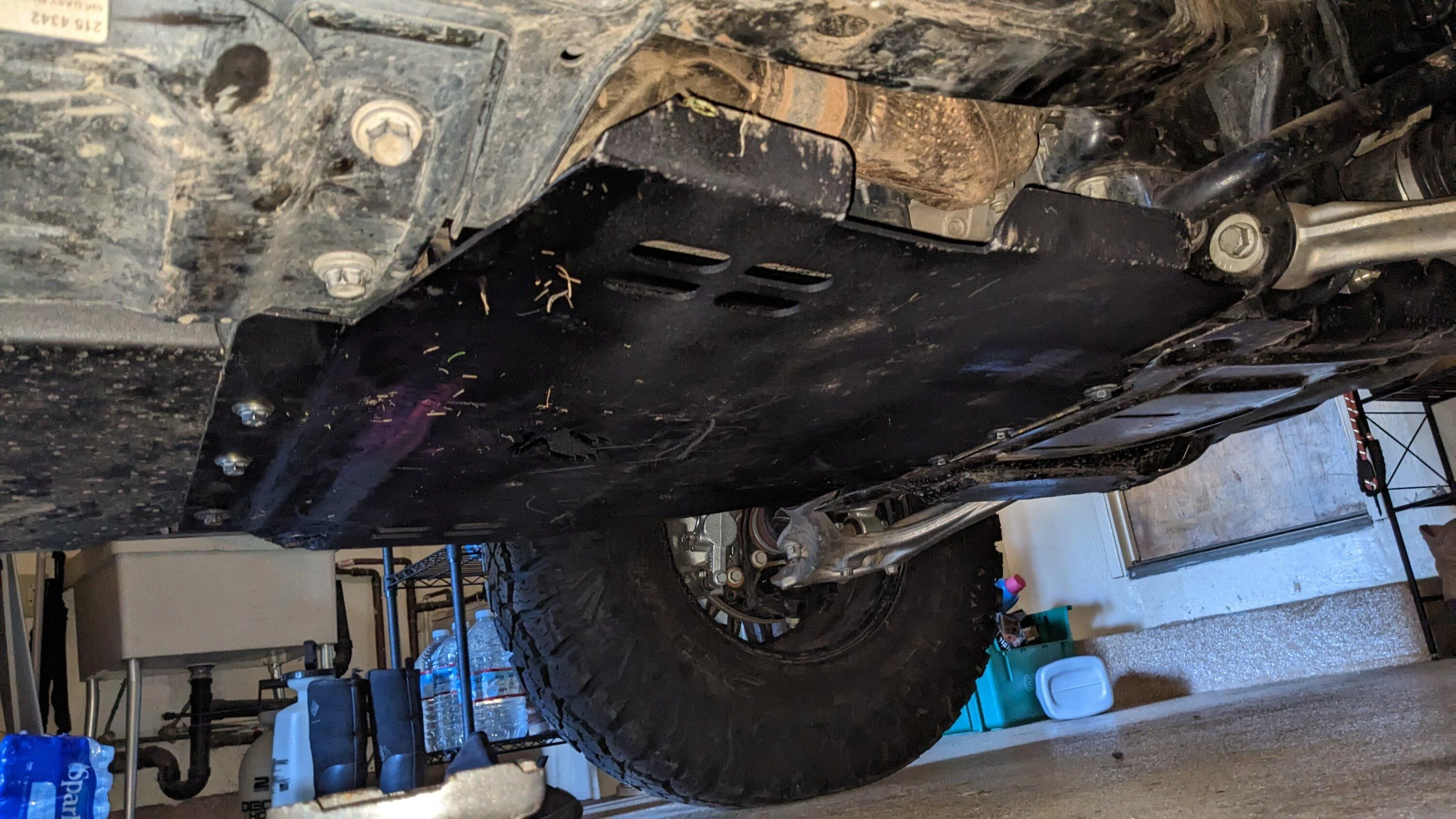

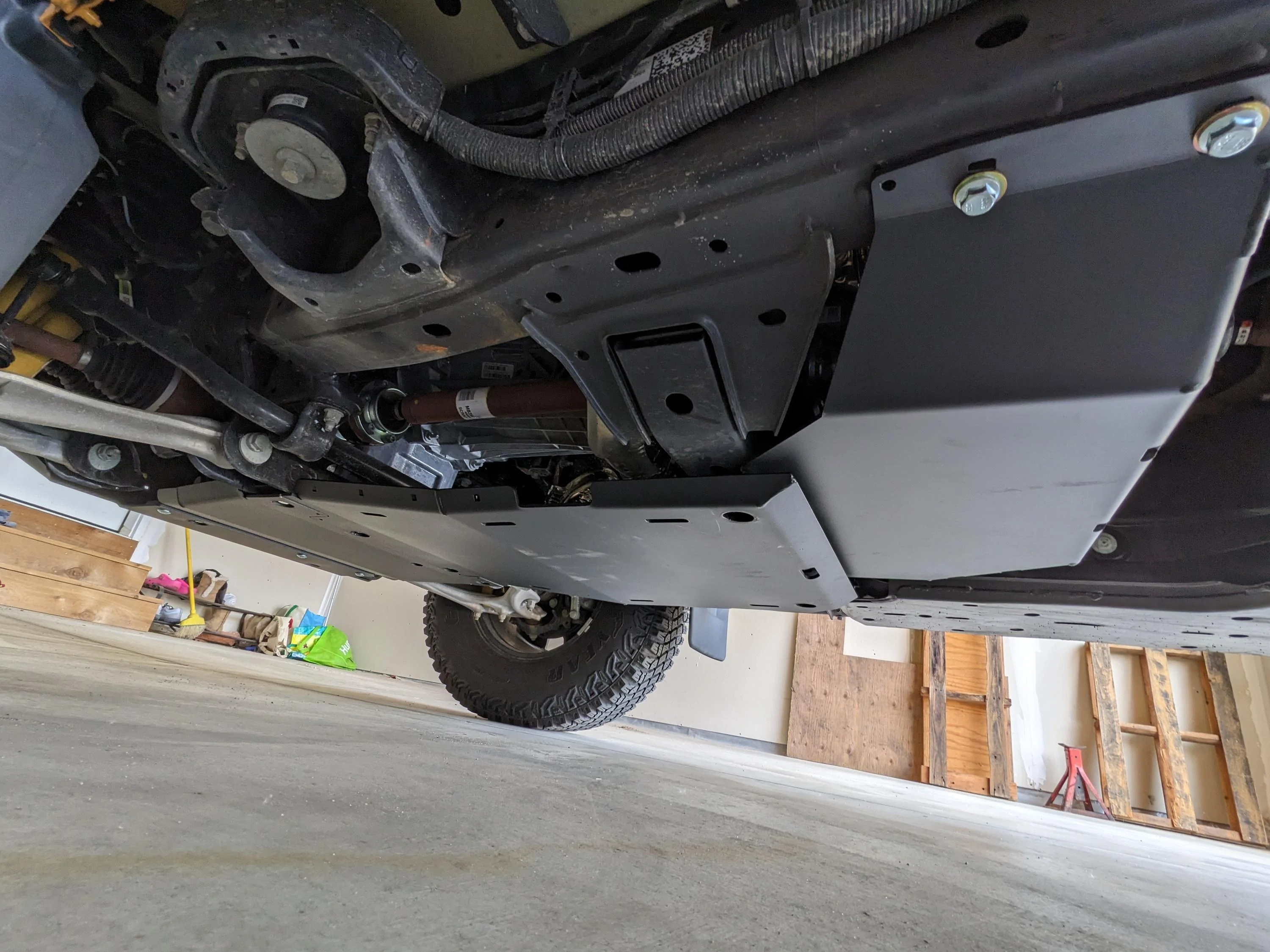

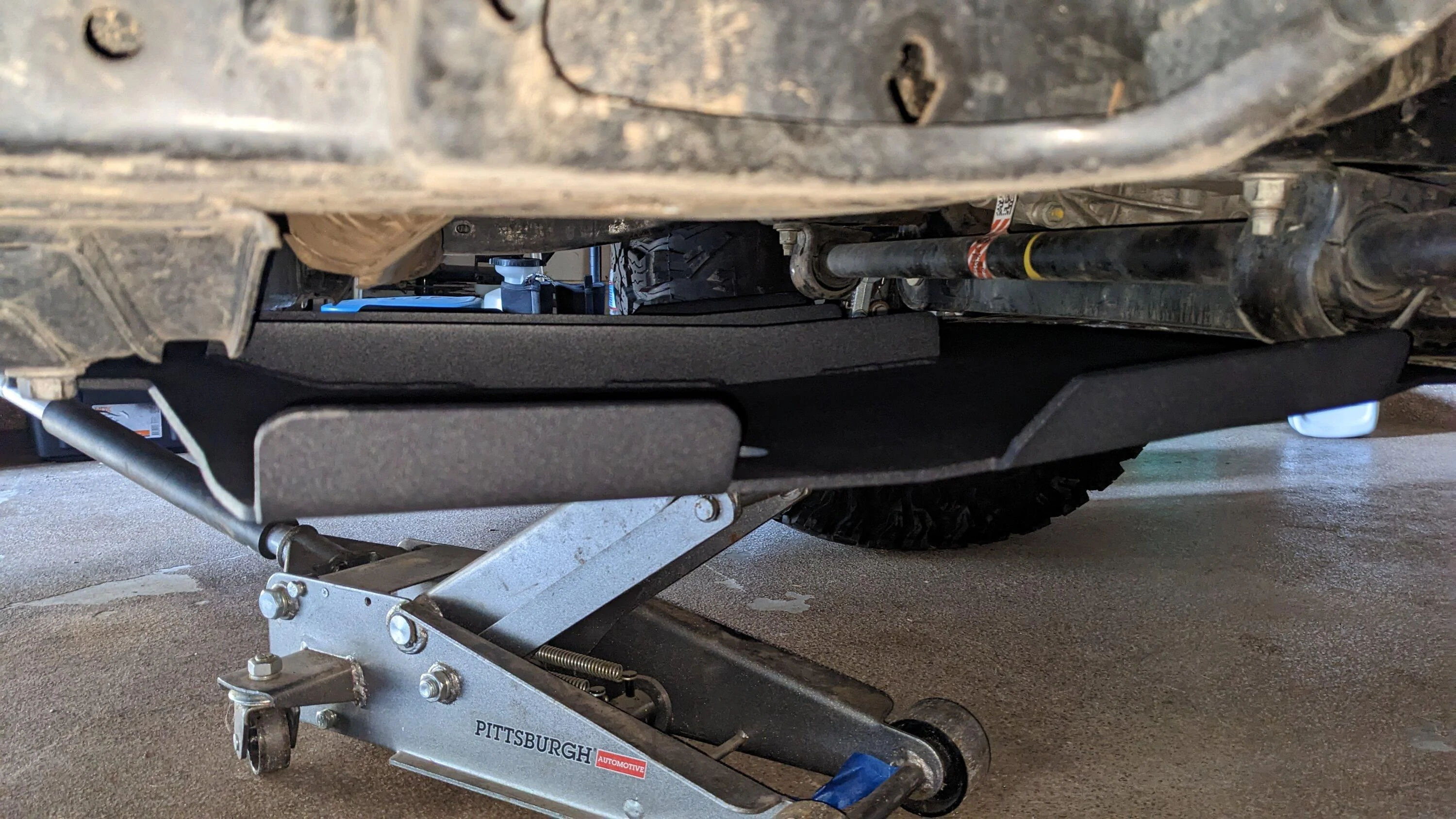

I haven't seen this posted yet but I figured I would let people know about how low the RCI trans skid sits on the 2.3. I can see on the V6 why it would need to be this low with the cross braces but dang there is a HUGE gap on the 2.3s. Kind of disappointed in the loss of ground clearance from a skid that could have easily been tucked up higher. IMO there should be a 2.3 specific skid.

Yeah, I just checked mine, and except for the cross braces, same fit. I didn’t really notice any loss of clearance because I’m running 37s. IMO, if you off road, some type of skid plate is needed to protect that plastic.

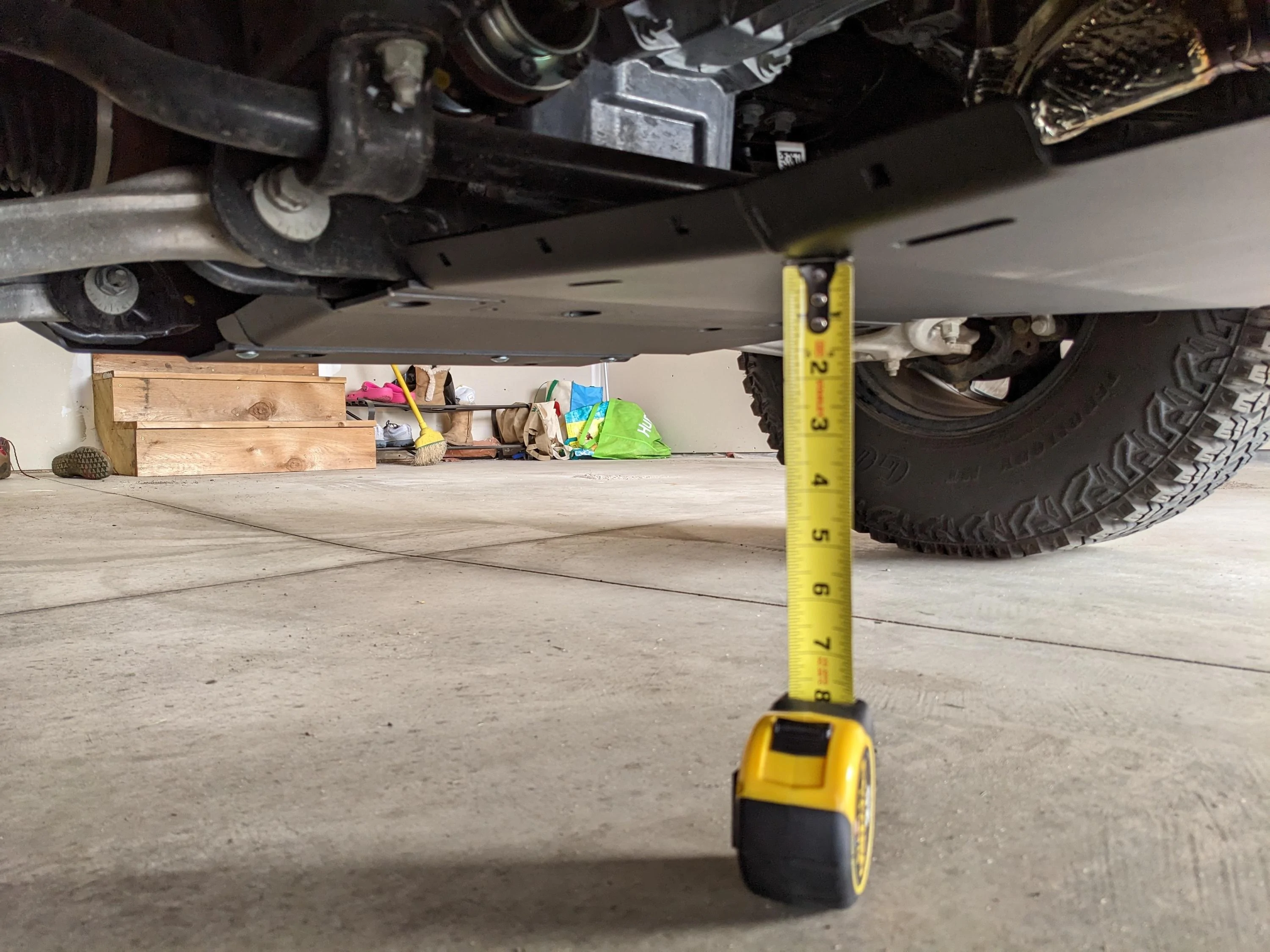

Hmm, I think your photo makes it look larger. Essentially the transmission clearance is to provide room from the transfer case skid to fit under it so that there isn't a lip to catch on a rock.
I've got 11" clearance on my sasquatched 2.3 manual.
If you want, you could grind those pedestals down an inch or inch and a half and likely still have clearance. Not sure if it is worth it for that, but I don't know the trails you have to go on.

You only need the 1/4" for the transfer skid to fit under it. Not the 2" pedestal. Pretty hard to trick the gap lol. Just a lot more that could be done for 2.3 folks.
It would add cost to them to give us 1-3/4" (since you said we just need 1/4"). I suppose they could not weld the pedestal on and use spacers and longer bolts. Have you emailed them?
Again, if it really bothers someone, they could cut the pedestals off, and do their own thing.

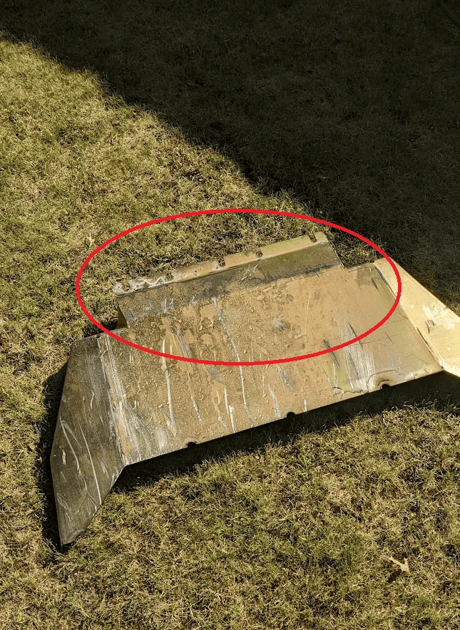

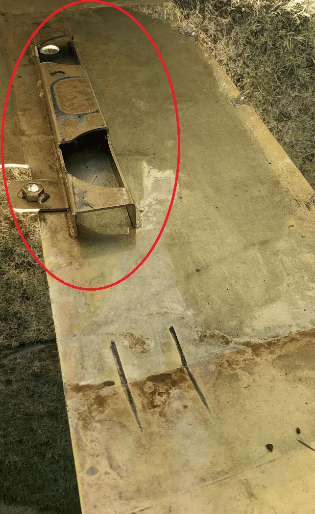

I modified my Talon Garage skid since I have a 2.3 bronco. You can see how much clearance I gained by just sectioning out the rear.
Ford Bronco RCI Transmission Skid 1690296434243
I did stick some 1 1/4" square tubing on the back side to prevent the plate from caving in.

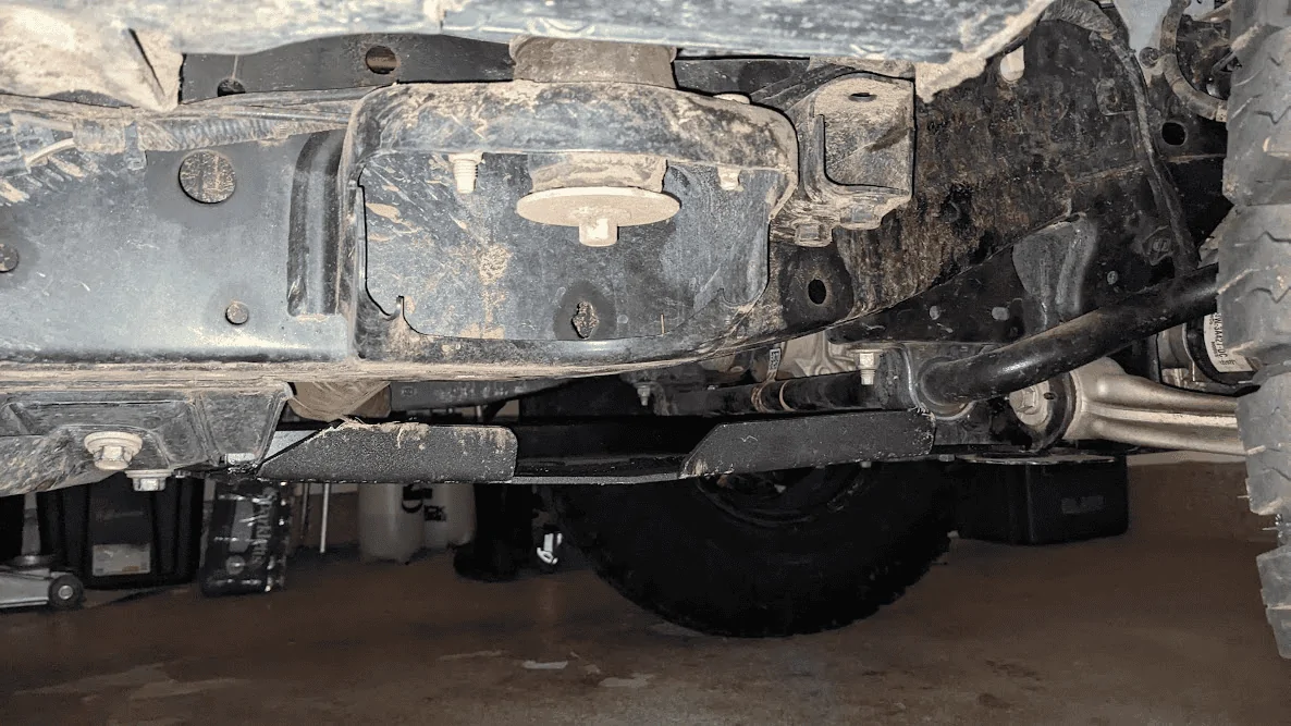

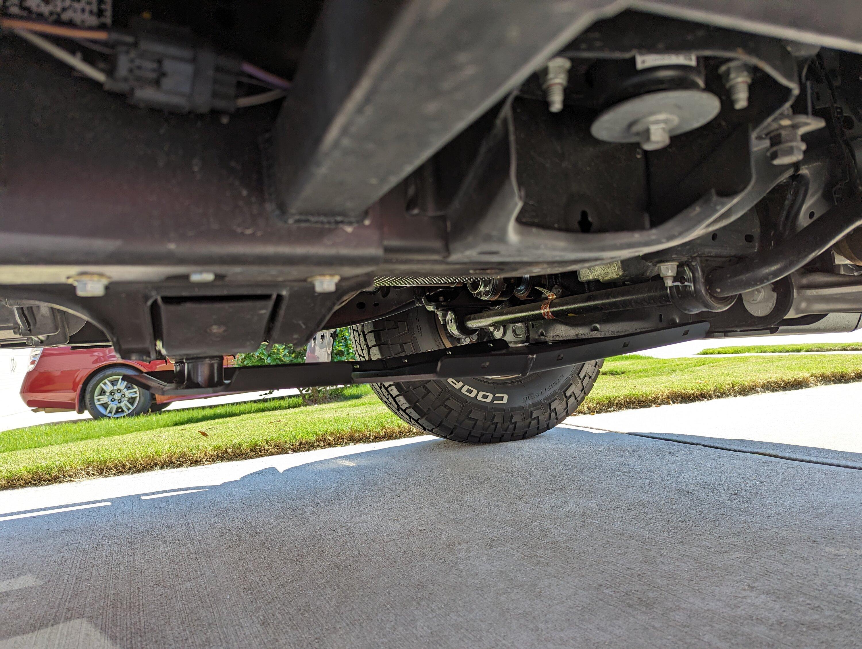

You can see on my previous set of Metalcloak skids that the front has a drop down on the skid. this is to help clear the V6 Braces.
Ford Bronco RCI Transmission Skid 1690296834120
The plate that bolts onto the transmission cross member is also spaced down to clear the the where the braces tie in at.

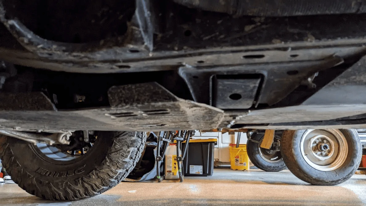

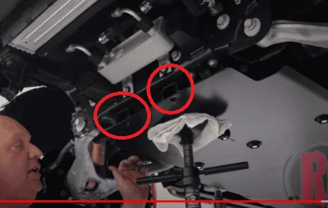

I wish I had taken pictures of the Rock Hard skids when I saw them. I literally looked at them and walked away shacking my head. I stole this clip from there install video which does a fantastic job of not showing how much clearance is lost. They did leak a little, like Metalcloak they space down the front just farther forward. They have to at least have 1" of spacers at the transmission crossmember with the stacked plates.
