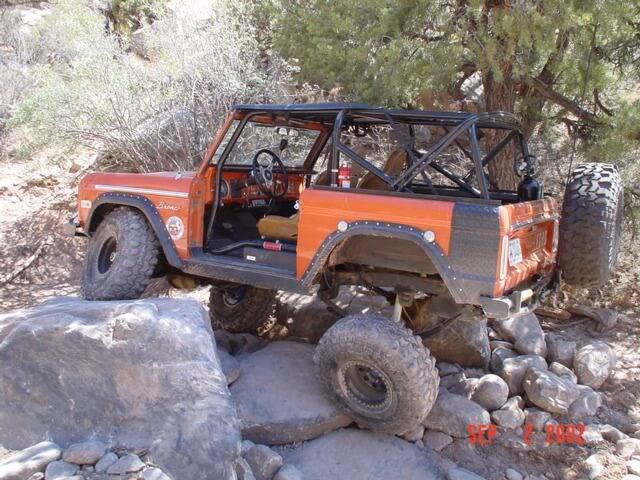

I absolutely agree with goatman. I don't desert race, but I have done a lot of hard core trails around the country in my EB. If you are familiar with the EB suspension, you know that the radius arms basically fight against each other as the suspension gets bound - basically the front end is one big sway bar. It wasn't until I hinged one of my radius arms that I could meet or exceed the suspension articulation of my wheeling buddies who drive jeeps.
Driving on the road with the hinged radius arm unlocked is not safe at speed - too much suspension movement. It's OK for driving short distances around town, but definitely not on the highway. This would be much less an issue in the new Bronco because disconnecting the sway bar doesn't appear to allow a huge amount extra articulation, but the point is at speed you want the sway bar connected for more control.
