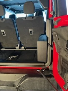

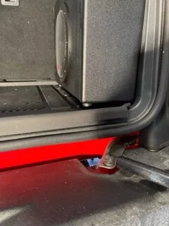

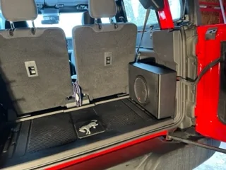

Follow up. The installer at my shop has a lot of experience, so I decided to let him do it. He told me he tapped the kick panel speakers on both sides. He ran the wiring into the side door pocket so that I can easily disconnect and tuck the wires away. I choose to go with this one because he was firm that the powered underseat type subs were not good. (I had one in my Jeep and thought it was OK, but have to admit, this is much better.) This 8" Rockford Punch was smaller than most and as I don't have much space to give in my 2-door, this appealed to me. I had him run the remote into the center console and for now, it's just loose. I may mount it in there. Here are some photos. It sat quite nicely on the carpet, but as you can see, I have a mat that has a raised edge. I used a couple feet with washers to square up the front. Some industrial strength velcro is holding it nice and snug against the sidewall and makes for a clean install IMO. The difference in sound quality is remarkable. I will be replacing the front dash speakers and the rear speakers later this week when the rest of the parts come in. I think in upgrading the base stereo without breaking the bank, this is a great option.

Unfortunately, my bronco did not come with auxiliary switches. But, fortunately, the sub powers on when audio is present, so it's not really an issue for me.

That’s the same sub that I used. It works really well, I actually have the gains turned down pretty far. I’m mounted mine to my to the tailgate, so it doesn’t eat up much space when I want to put the doors in. As for getting the flash done, I just ran off the front kick panel speakers.

Thanks! I made a bracket that I attached with strong two sided tape to the sub to hold it snug against the sidewall using the storage pocket. Pretty happy with the improved sound quality!
