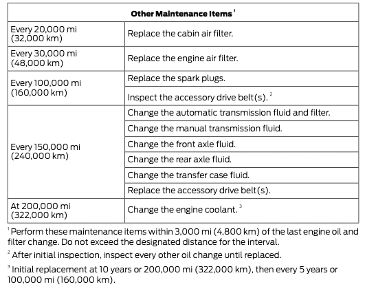

Where are you seeing a 30K transmission fluid change interval? My manual shows 150K for that service (pg 464), that may be a bit extreme but curious why 30K?
Oh you know what, I think I was getting 30k mixed up with the transfer case change.

I'm not suggesting 150K is a good idea..........

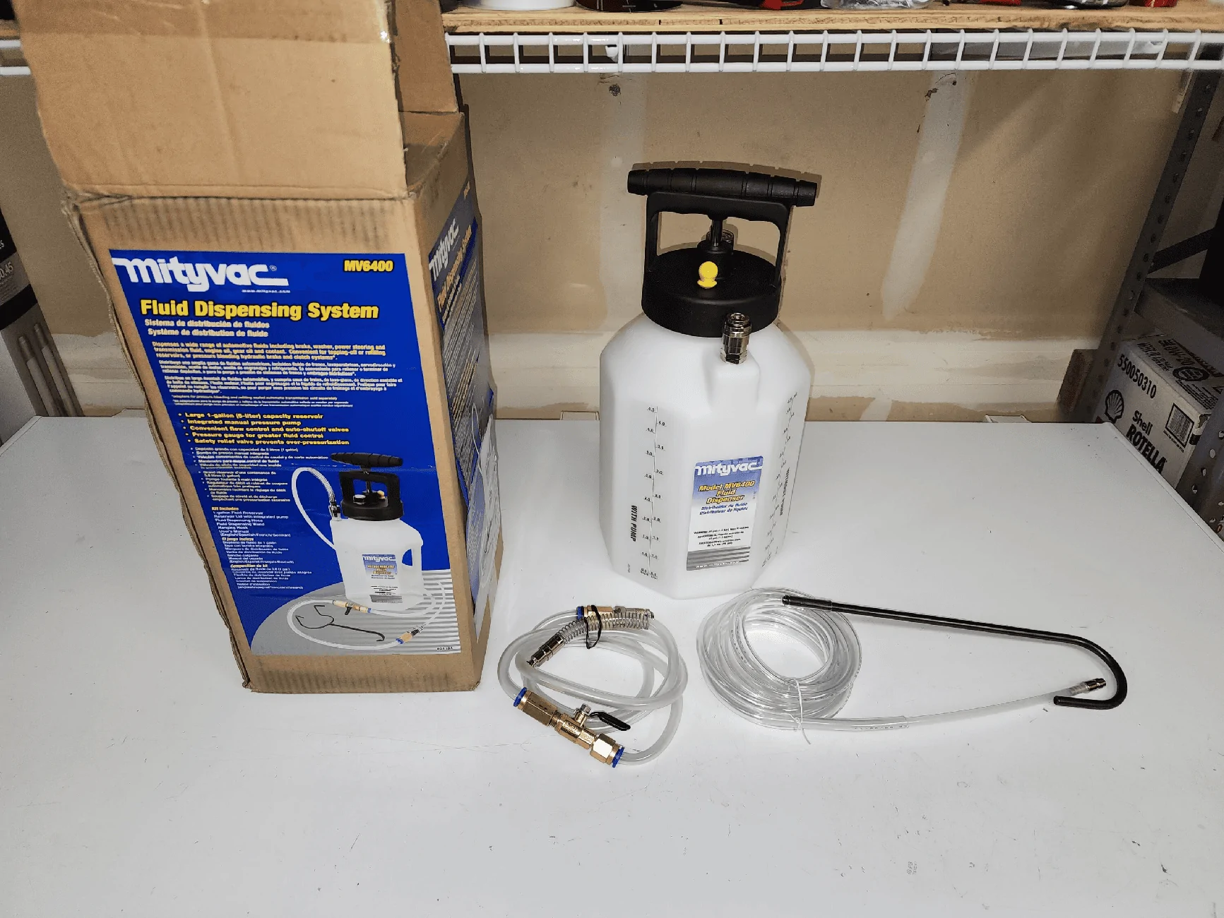

In about 1500 miles, I will be performing a transmission fluid and filter change (10K mile mark) and will be installing a PPE deep aluminum transmission pan at the same time. I will probably dump the fluid a couple more times after that to replace as much of the original fluid as possible and then settle into a 50K oil change interval.
The process is not overly complicated, but you do need something to reinstall the fluid. I have this Mityvac with the Ford "nozzle" (the metal candy cane) that I bought to do the work.
Ford Bronco Transmission fluid change questions 20240115_131132
I plan to create a video of the work and will share it.

Perfect, thanks for that and I look forward to watching your process
