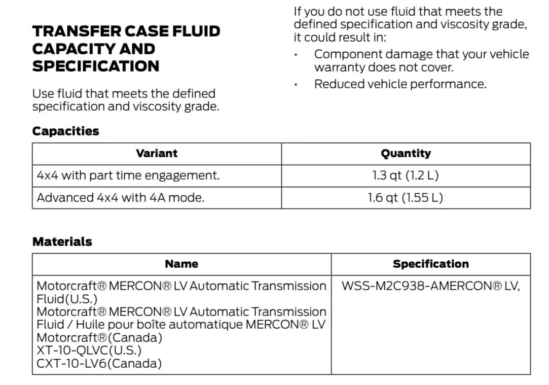

I was surprised there hasn’t been a thread discussing this yet.
Rounding 30k and figured I’d change it every 30 until 100k.
MOTOCRAFT MERCON LV XT-10-5Q3LV. Thoughts/alternatives?
Transfer Case Plug: 26 lb.ft (35 Nm) for Part-Time & 18 lb.ft for the 4A.
Transfer Case Plug Seal/Crush Washer (Part-Time ONLY): AB3Z-7482-A or CHEAP ALTERNATIVE
Anyone use a high-temp thread (Permatex 59235) sealer on the plugs or not necessary? The manual suggests discarding the plugs on the differentials each time because of the thread sealant used at factory. Why don’t they use the same practices for the transfer case? Assuming it’s because of the disposable seal that presumably holds the plug in place once torqued?

I typically change the fluids in the axles and transfer case early to remove the wear metals since none of these systems have filtered oil supplies and will be doing mine soon too.
Motorcraft Mercon LV is not synthetic (it may be semi-synthetic or a blend), but given there is no combustion by-products, and the operating temperature is nominal, it probably does not have to be.
It also may not matter, but many fluids are not licensed by Ford as a Mercon LV replacement, such as:
- AMSOIL Signature Series Fuel-Efficient Synthetic Automatic Transmission Fluid (ATL) - the word "Approved" or "Licensed" does not appear anywhere
- Red Line D6 - it is listed as "suitable replacement"
- Valvoline Dexron VI/Mercon LV - it is approved for Dexron VI, but recommended for Mercon LV
There are a few (aside from Motorcraft) that are officially licensed by Ford:
- Castrol Transmax® Dexron® VI Mercon® LV
- Coastal LubriGold Full Synthetic Multi-Vehicle DEXRON®-VI / MERCON® LV Automatic Transmission Fluid (made by Warren oil)
- Kendall VersaTrans® LV ATF (Kendall/Phillips 66 likely makes Motorcraft fluid)
- Mag 1® Low Viscosity Multi-Vehicle Transmission Fluid (made by Warren oil)
- Ravenol Mercon LV Fluid
- Super Tech DEXRON VI/MERCON LV Full Synthetic Automatic Transmission (made by Warren Oil)
If I were to use any of the above (aside from Motorcraft), I would use Ravenol. It is officially licensed by Ford and is a full synthetic made in Germany where there is a strict definition of what can and cannot be labeled as a "synthetic". In the US Group II+ base oils can be labeled as synthetic and are not true synthetics nor have the accompanying properties.
Just my thoughts...

Blauparts used to sell Ravenol in 4L containers--I reached out to see if they still do. I added 4 QTs to my cart and the shipping was still $14.75 so that is a bonus.
https://www.blauparts.com/ravenol-atf-automatic-transmission-fluid-f-lv-1l.html
It would be so much better if Ford would set a specification as Chrysler did on ATF+4--no matter who makes it to meet the spec of ATF+4 it has to be a full synthetic.
I'll probably do a dump and fill with Motorcraft the first time at 2K or so miles and then at 10K switch to Ravenol.

I did a swap with OEM Mercon. No complaints.
The Plugs are traditional NPT's. Self sealing pipe threads with goop incase of a fucked up install (I guess). I have always reused plugs without adding sealant and have never had an issue, YMMV

I ran Ravenol (ATF+4) in my 2019 Jeep Wrangler's transfer case and it worked well. Given that Ravenol is licensed by Ford, it is hard to go wrong. Blauparts answered me and they only sell it by the quart, but the shipping seems to be fixed pricing so that helps.

Timely thread for me. Just got back from my dealers parts dept. I mentioned the service manual says "Note: Make sure a new seal is used." He had no part number for it though. Manual does show seals. Anyone have a part #?

PS... @redone17 - unless I see something really different, I plan to just wire brush my plugs and use either:
High density Teflon tape (pick your color):
- https://www.homedepot.com/p/Hercule...d-Sealing-PTFE-Plumber-s-Tape-15110/300791226
- https://www.homedepot.com/p/Blue-Monster-3-4-in-x-1429-in-PTFE-Thread-Seal-Tape-70886/314130476
- https://www.homedepot.com/p/Oatey-1...-Sealing-PTFE-Plumber-s-Tape-31403D/202078116
OR
Teflon thread sealant - https://www.permatex.com/products/t...lants/permatex-thread-sealant-with-ptfe-4-oz/
From the outside of the transfer case, they appear to be standard square head NPT pipe plugs (though a magnet on the drain plug would be nice).

Motorcraft Thread Sealant with PTFE: TA-24-B is what Ford calls for on the plugs.
Ford Bronco Transfer Case Fluid Change IMG_2173
Really any type of thread sealant would be perfectly fine. I’ve never had any issues or leaks just putting the plug back in without adding anything.
