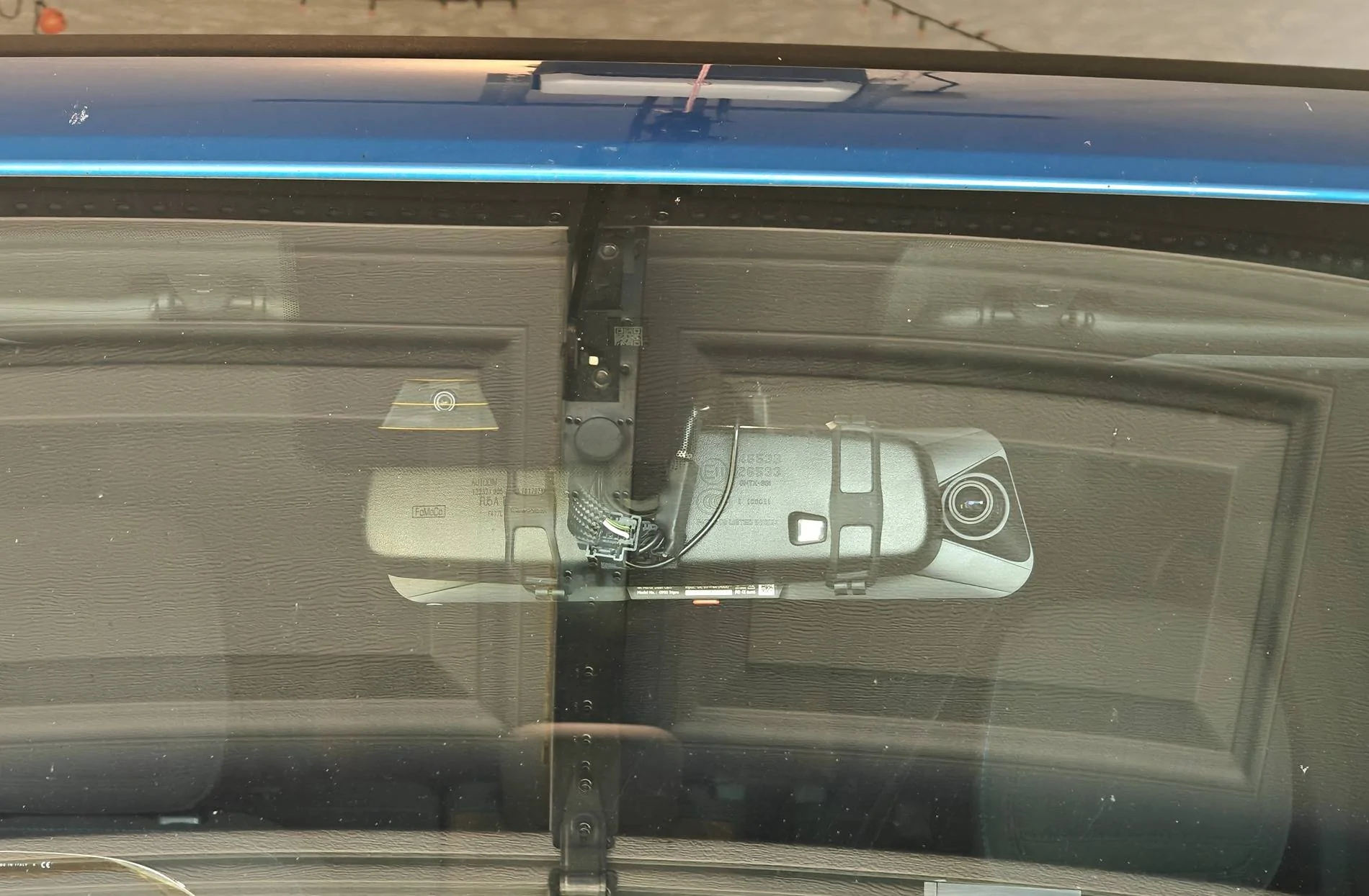

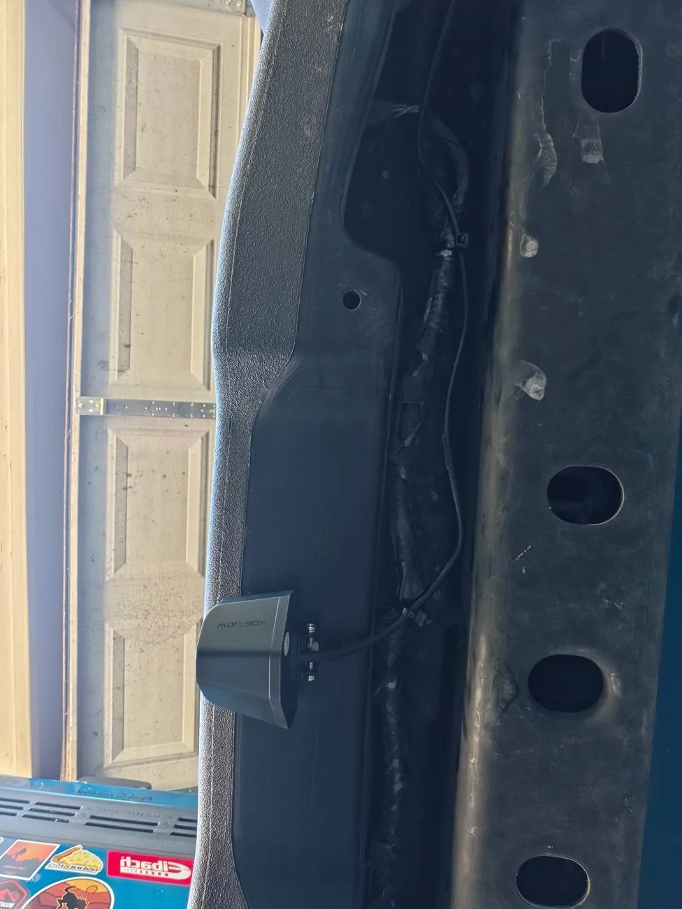

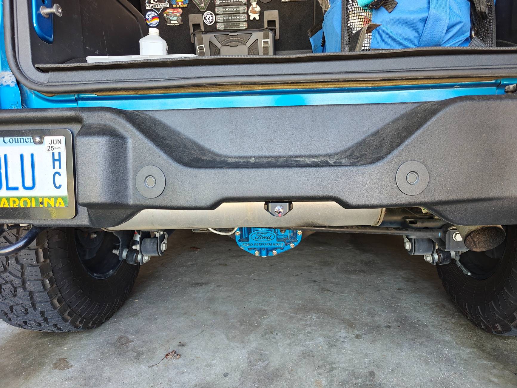

I installed the camera below the bumper, though I have ordered an extension in the event I decide to move it. I didn't love the idea of it perched on top of the third brake light or getting in the way of the spare. It may be a tad vulnerable here, but it works for now. Will be considering alternatives.
Ford Bronco Wolfbox G900 TriPro w/ Cabin Camera Installation & Review IMG20250517134652

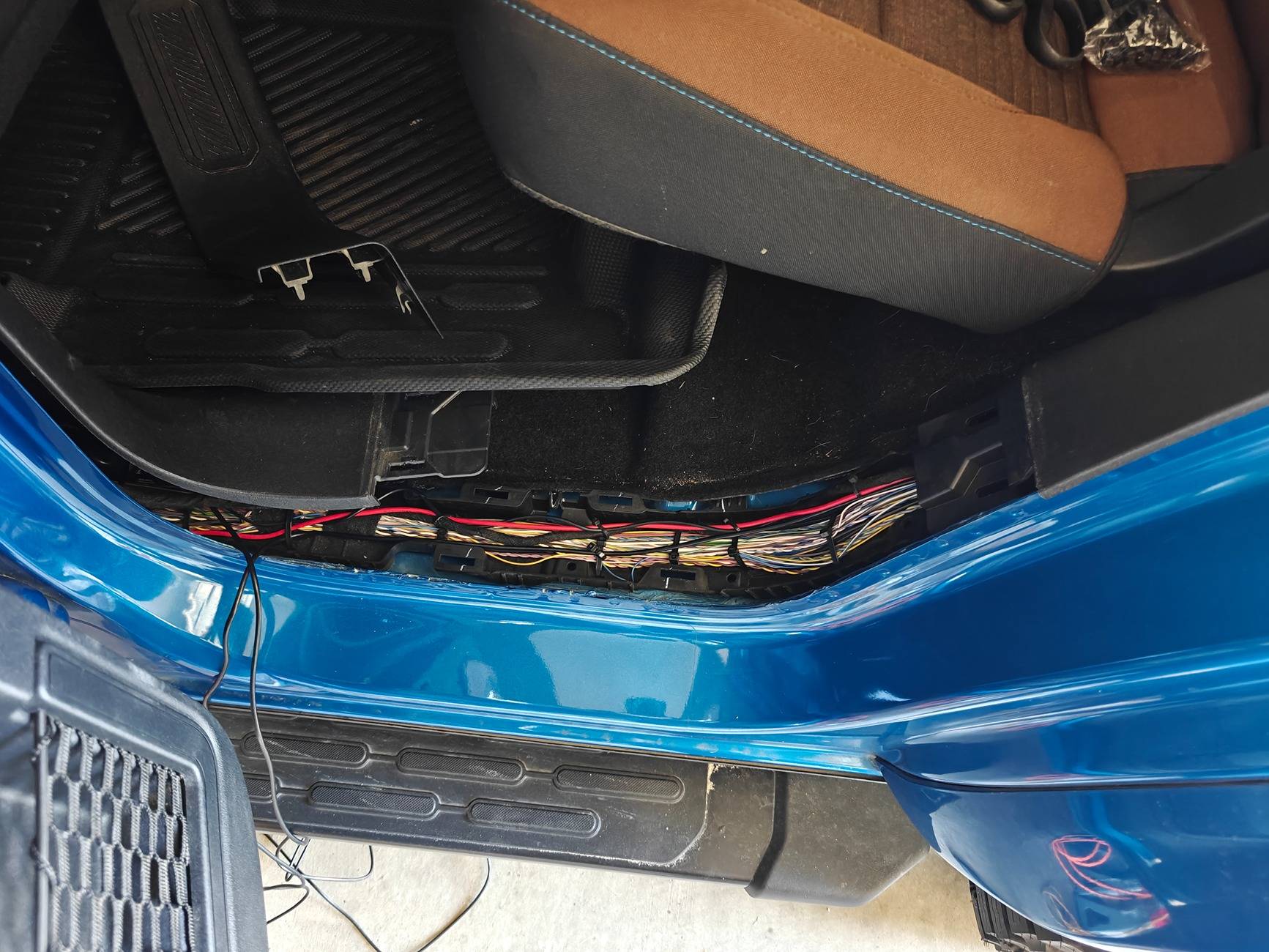

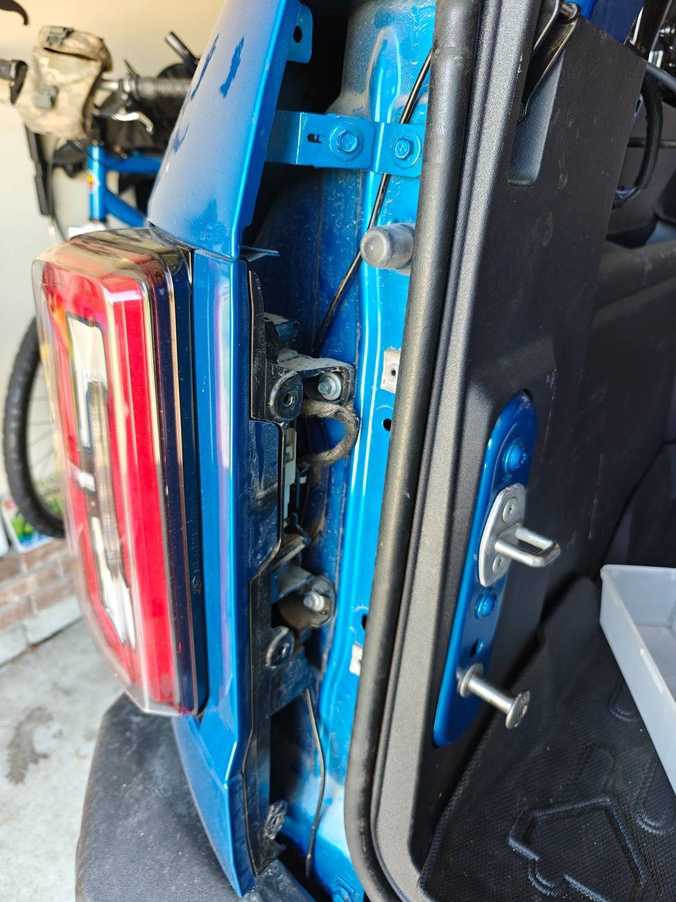

I ran the wire along the loom in the bumper and then up behind the cover near the driver taillight. It comes with a reverse tap but I opted not to use that given the Broncos come with a factory reverse camera, and I also have the 360 cameras, so this would be very redundant. That is zip tied up out of the way. The wire continues up behind the weather stripping & into the top of the interior panel. Continuing forward to follow the factory wire loom as I did with my subwoofer wiring.

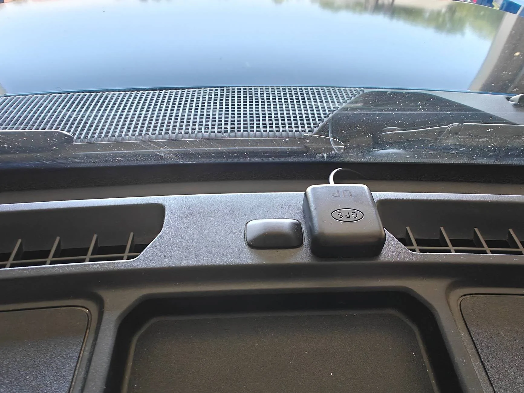

The GPS module I fed the same way as the power/rear cam wires, however, down the passenger side, and have the sensor mounted on the center of the dash.

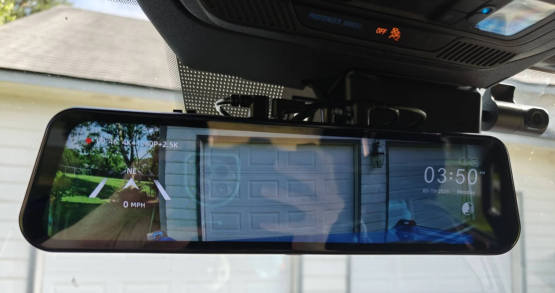

As for the monitor itself, there are two ways to mount it. One way is with the provided straps & strapping it to your OEM rearview mirror... and the other involves a secondary ($20) purchase in order to replace your mirror with their bracket. I mounted mine with the provided straps but have ordered the bracket. The straps, while a nice "option", do not feel like a long term nor attractive solution at all. The Wolfbox monitor sits too far off to the side in order to fit the forward facing camera. It also leaves the edge of the oem mirror peeking out on the opposite side. It does not look good like this.
Being more off center also gets in the way of the driver's visor & causes the visor to cover part of the display.

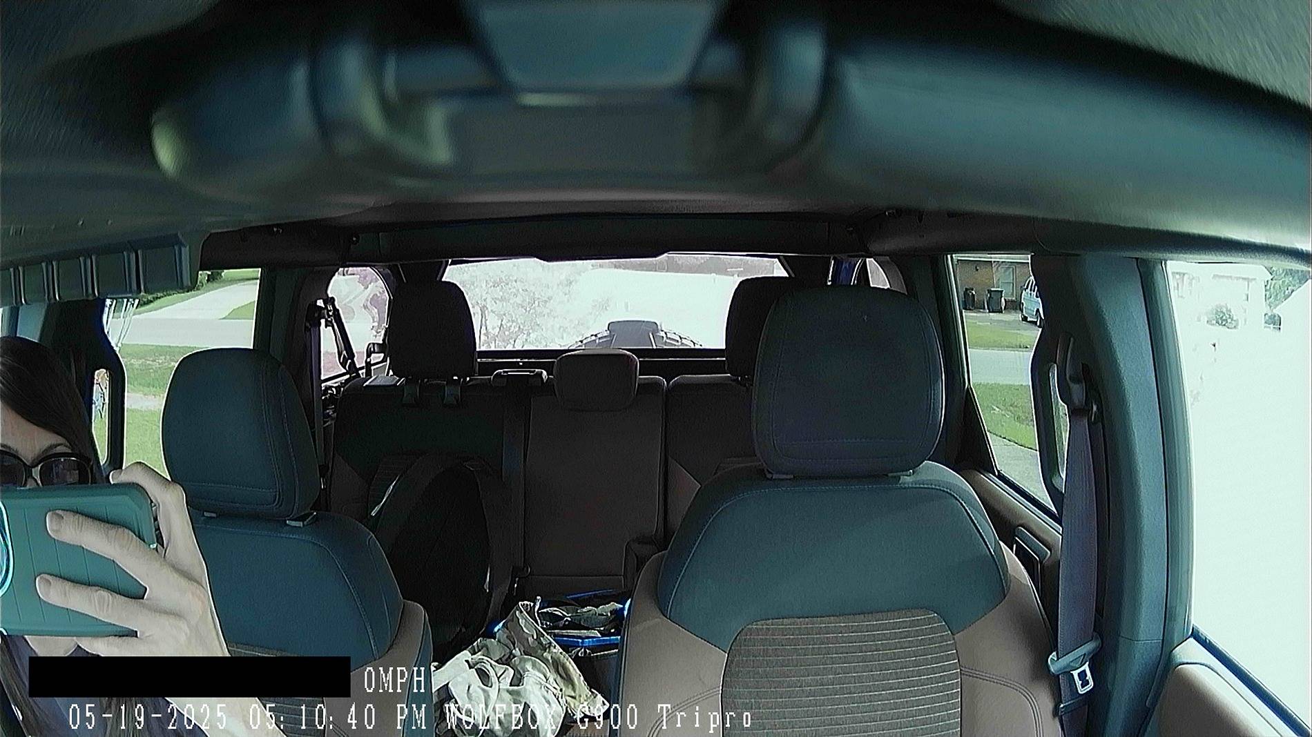

I mounted the cabin camera up to the right of the rear view mirror. I liked this spot for being out of the way and the angle of the cabin it provided, but it does get covered if the passenger chooses to use the visor. Something to consider when you choose your cabin cam location, if this would bother you.

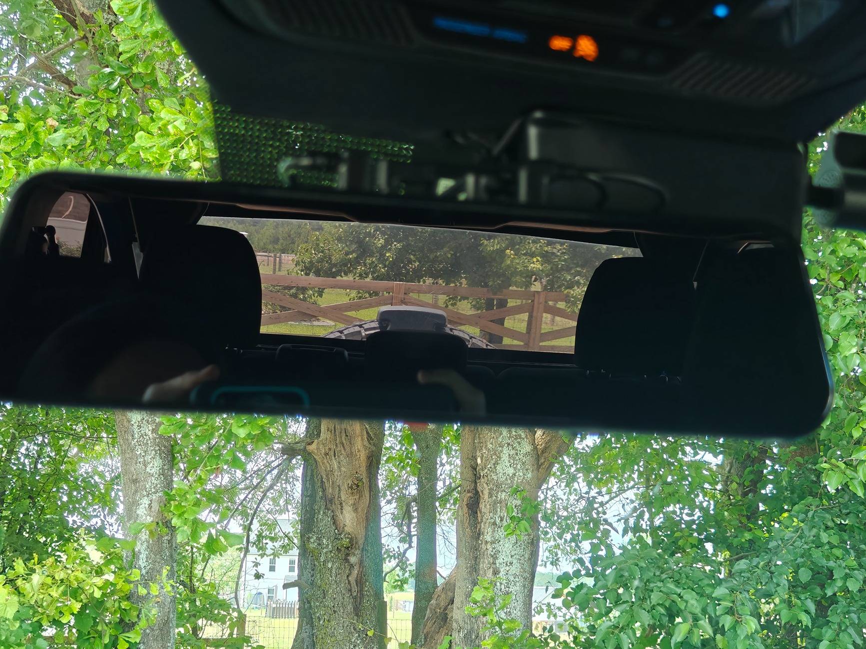

When the display is off it still has enough reflectivity to be usable as a rear view. Here is a comparison of the field of view the camera allows (REALLY helping with blind spots).
Display off (acting as regular rearview)
Ford Bronco Wolfbox G900 TriPro w/ Cabin Camera Installation & Review IMG20250519125719
Vs the digital display

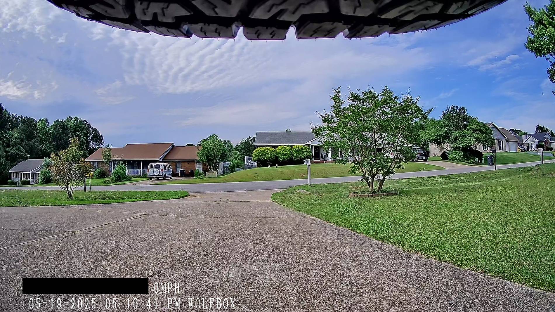

"Take picture"
Corresponding photo downloaded via wifi/Wolfbox app. (I blocked GPS location out).
Ford Bronco Wolfbox G900 TriPro w/ Cabin Camera Installation & Review 2025_05_19_171041_00_R.JPG
3-way split screen image

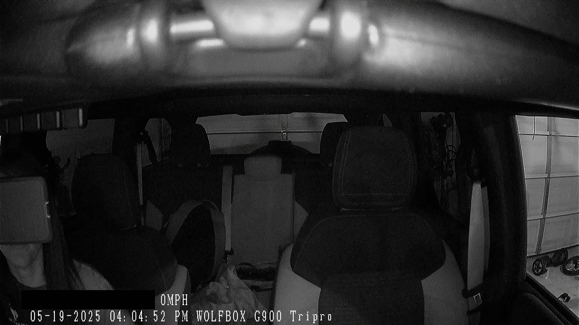

At night/low-lighting the cabin cam automatically switches to night vision and does a great job. (I blocked GPS location out).
Ford Bronco Wolfbox G900 TriPro w/ Cabin Camera Installation & Review 2025_05_19_160453_00_I.JPG
Vs daytime

"Take picture"
Vs daytime

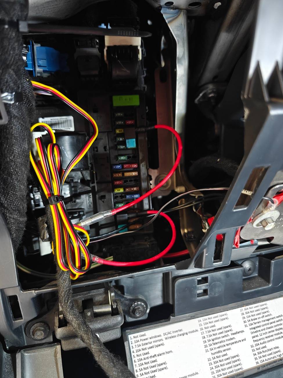

I just installed mine. It’s great! Was a bit of a pain to self install. I got the Tri pro with the front bumper cam instead of the cabin cam for off roading. Question on the fuse box: can you go more into detail on that? I may have it hooked to the wrong fuse based on your picture (and the fact that my rear sensors seem to not have enough power to properly function now lol).
Can you also show another picture on how you got it up through the A-pillar for the actual screen power? I was able to kind of get it through for the rear camera on the right side but was having trouble figuring out how to get it up the left side from the fuse box.
Fully working and definitely do not regret it, but just want to clean it up so it is a better install. Thanks!
Are you talking about how I ran the wires up by the A-pillar/headliner to the camera/display, or how the power feed crosses over from the A-pillar area into the fuse box area? I took a video showing how I ran them from the A-pillar upwards, then realized you may have been referring to the fuse box area.
Ill post this video regardless, as it may still be helpful for you or someone else.
Rewatching that I noticed I had to fix a bit of wire that popped out, oops, lol.
As for the fuse box, Stickerfab has a video explaining how to correctly wire the fuses, so I followed their recommendation. At 3:50ish in, he touches on that part of the install. I think he also talks about the small spot you can cross the wires over into that area. I had already done that part so just paid attention to the fuses. If you need further clarification, I'd be happy to take another video.
Both of the videos were helpful. Thanks!
