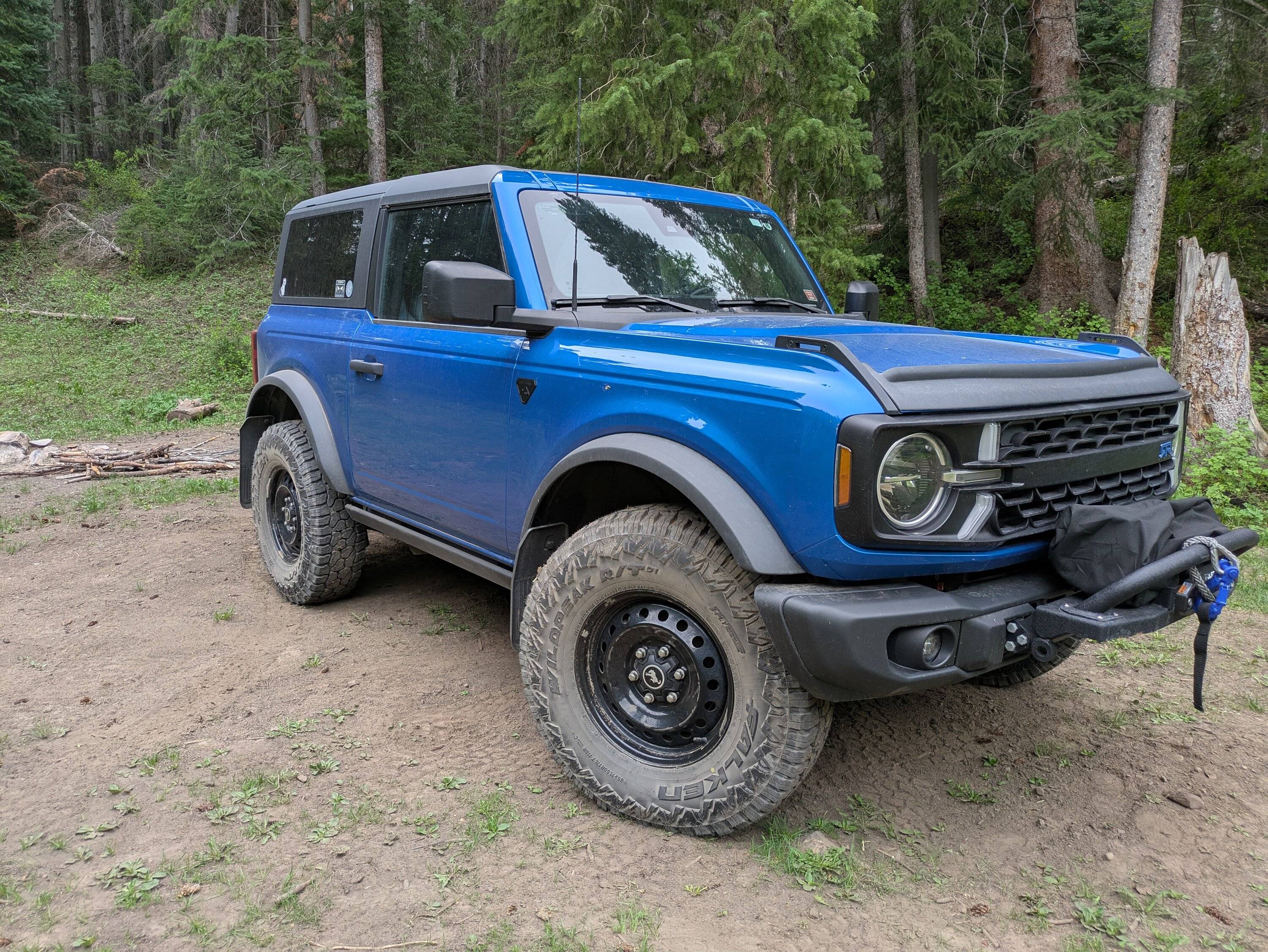

Up until now, I'd only call what we've added "accessories" rather than modifications. But now....we've got us a bit of a build.
I just picked up our Bronco from the local dealer, Columbine Ford. They did a marvelous job adding the following:
  • Zone Upper Control Arms
  • Ford Performance 2" Lift Coilovers
  • Ford Bronco Severe Duty Steering Upgrade
  • Ford Performance 2.3 power upgrade
  • 35 x 11.50 Falken Wildpeak RT/01
I'm so pumped up about this!

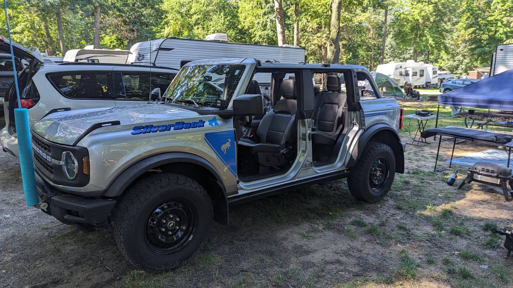

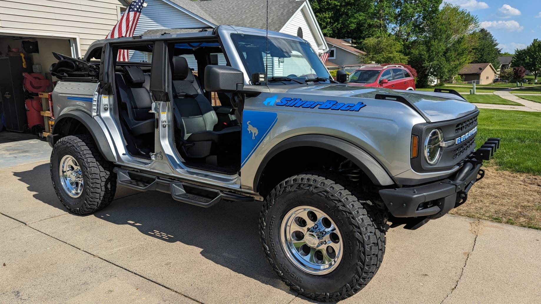

Before and after pics of my black diamond. Added an Accutune Stage 3 lift, with adjustable Fox 2.5 shocks. Came with Icon upper control arms, Rear upper and lower links, and a rear sway bar. Added Mickey Thompson 35's on Ion Alloy 17" wheels after the 3.5" lift. Love the ability to adjust compression on the shocks for different terrains and speeds.
Beautiful! That's next level!
