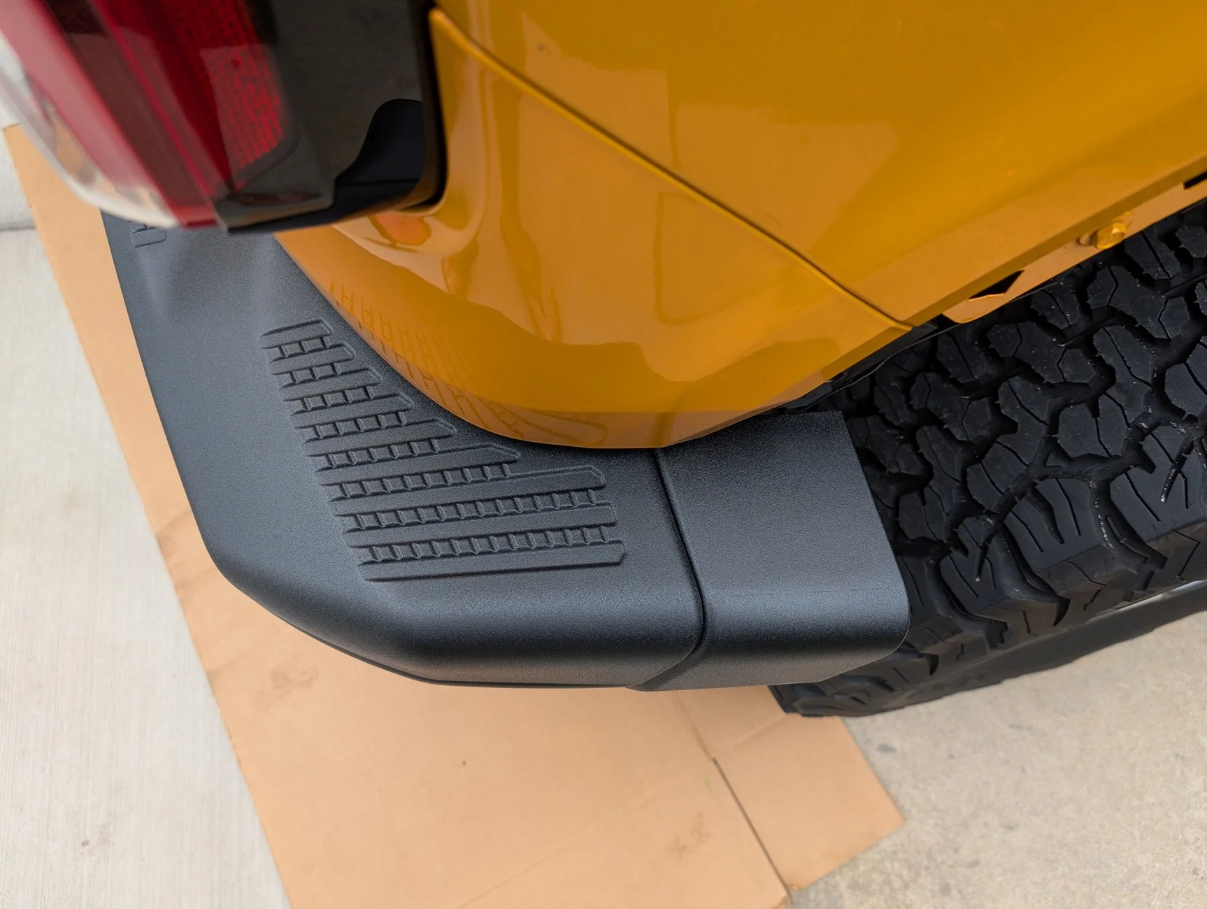

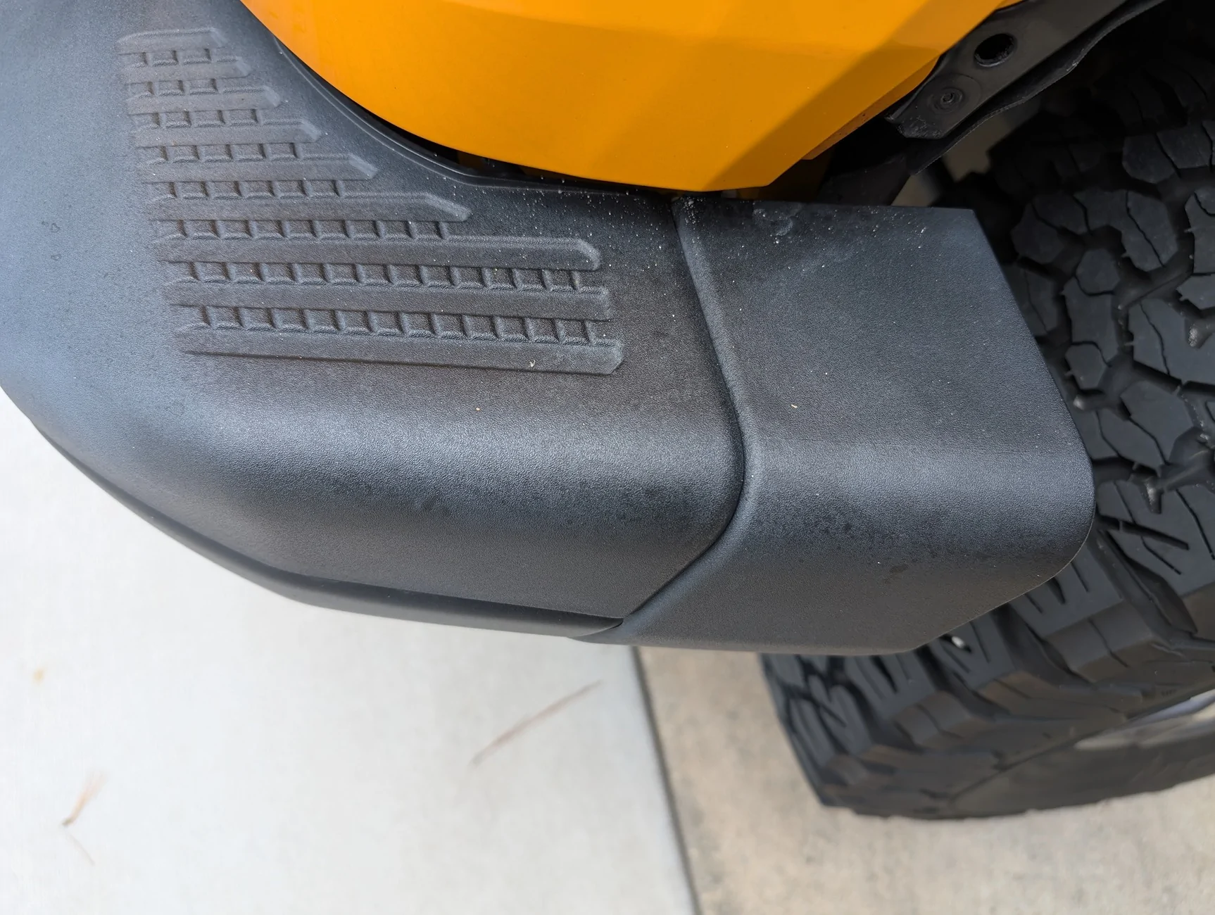

My Bronco has been parked outdoors in a sunny environment in the 2 years 7 months that I've owned it. Just in the last month I noticed the dreaded "zebra striping" on all four plastic fender flares. I can report that Solution Finish got them looking nearly new with little effort. I removed them, washed them, and degreased them with alcohol (and a panel prep spray to be extra clean) and applied just one coating of Solution Finish. I only let it dwell 30-60 seconds before buffing off the excess with a microfiber cloth. I then did the same thing to my rear bumper, which for a long time has show some white/gray splotches, dots, mineral deposits(?), etc. The plastic coating over the steel bumper wasn't quite as absorbent as the flares, but the end result was also excellent. I'm reporting this as I've had mixed results using Solution Finish over the years on different vehicles and plastics, but I had excellent results this time. Here are a couple of before/after pix.
