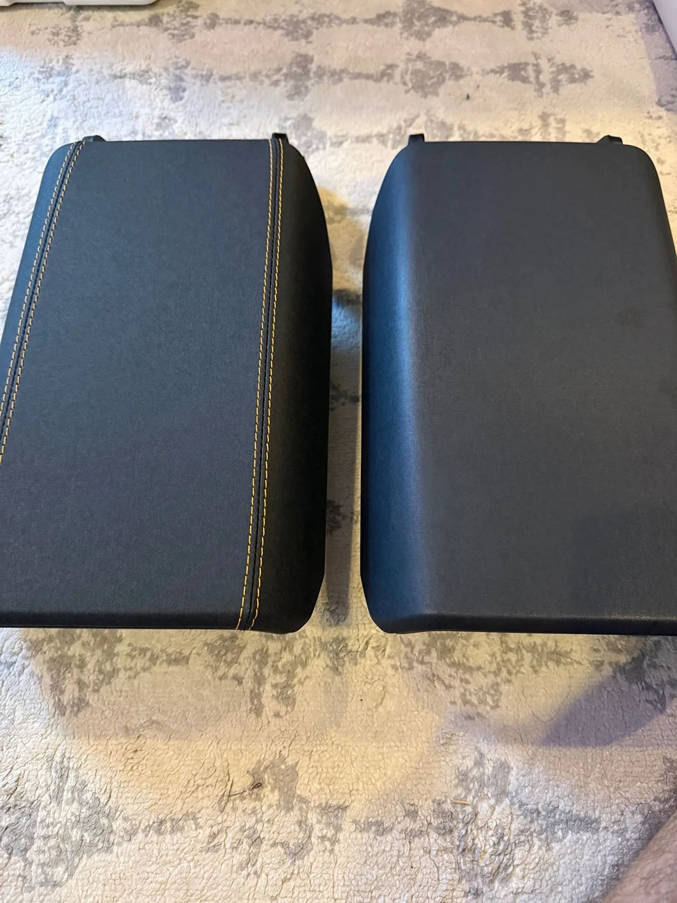

I’ve seen a couple other posts, but figured I’d add a thread for anyone else interested in swapping to the newer style, stitched console lid/armrest.
Grabbed the newer Badlands part - P2DZ-7806024-BA - to upgrade my ‘23.

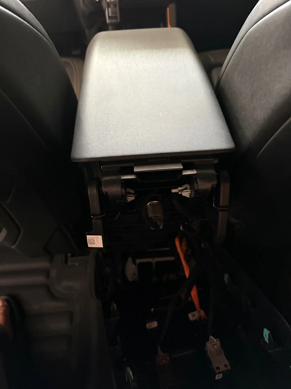

From the backseat, release the rear console trim by pulling back, starting from the top.
Then there is a single rod holding the armrest assembly that slides out to the driver’s side.

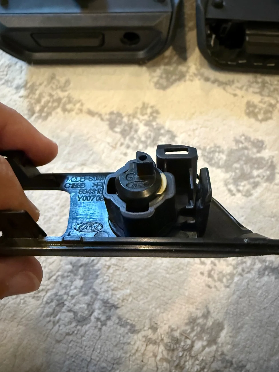

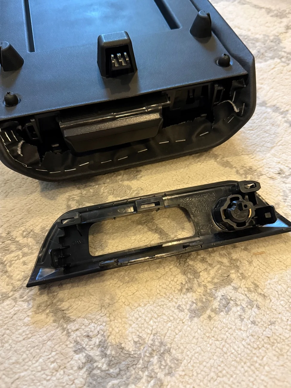

For the lock mechanism, I removed the front “faceplate” trim around the lock and release button w/ a trim tool. You can then remove the lock cylinder by pressing the retaining clip down and pulling the cylinder through the front. Then just push it into the new armrest assembly.
Easy swap that makes a nice cosmetic upgrade in my opinion.

The new one (P2DZ-7806024-BA) does it not come with a lock assembly? does it have the latch assembly? Curious if maybe you grabbed a photo of the underside?

Grabbed mine off eBay, but don’t believe directly from Ford would include the lock cylinder since it is keyed for your physical key.
It did include the latch/release. Nothing really to see from underneath as there is another trim piece.
