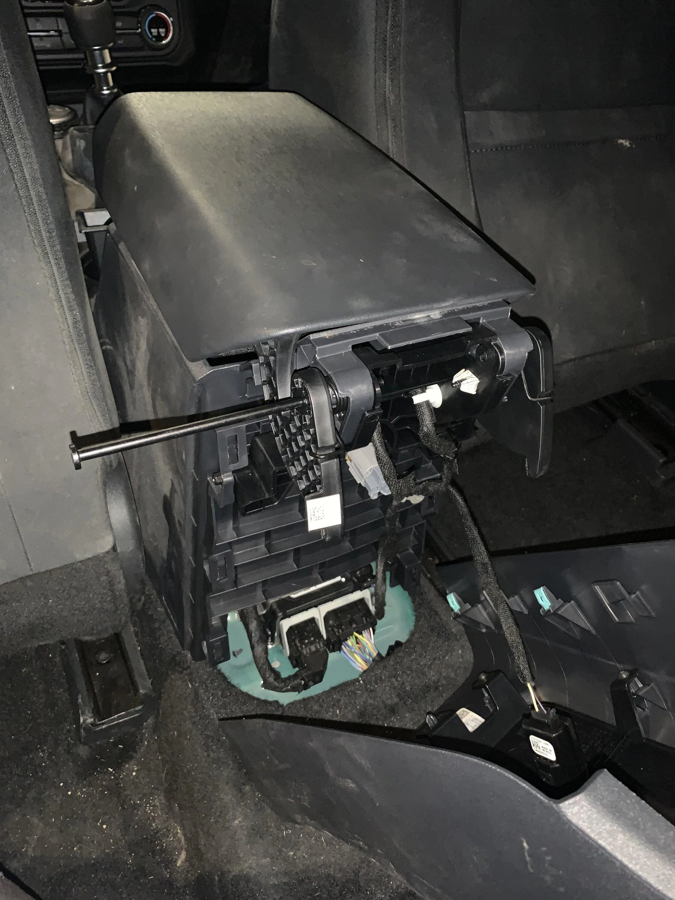

Finally got warm enough to give this a try without fear of breaking clips.
super easy. Pull back on the rear cover as described by fatrat.
no bolts or tools needed. Just slide the axle out and then reinstall the back cover.
Ford Bronco Console lid removal? IMG_1385
pictured with axle nearly all the way removed and lit still in place.
Wish I had done this on day one. So much more enjoyable to go through the gears. And steer to the right!
