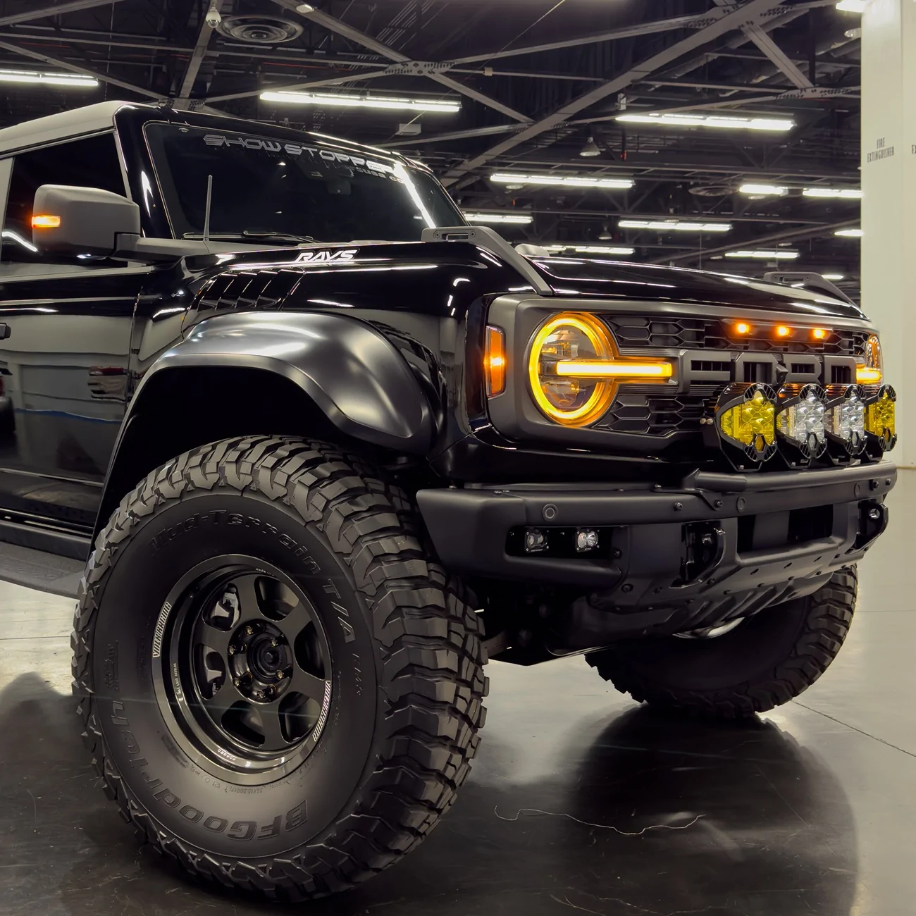

I wanted to mount @Baja Designs LP6 lights on my bronco and seen a few different variants whether it been directly mounting - drilling the modular bumper or using whatever light mount offering. Aftermarket bumper are not my style and I was not a fan of the different products on the market whether it been light mounting or the overall design.
I reached out to my fabricator with a couple photos of different mounts and let him work his magic. I really wanted a mount that sat as low as possible, as close as possible to the grille, and tube as the main design. He knocked it out of the park with the final product in my opinion.
Ford Bronco Bronco Raptor Bumper Baja Designs LP6 Light Mount IMG_1505
Ford Bronco Bronco Raptor Bumper Baja Designs LP6 Light Mount IMG_1524
I also requested for 4130 / chromoly material for the whole mount. Starting off with the main tube / light mounts, he ended up rolling the tube to get a very close match to the bumper curve which also give the lights a nice sleek profile since I wanted to avoid having a straight tube.
Took some time to get the perfect measurement and took a couple attempts to find the right spacing since real estate is pretty tight behind the lights to accommodate the deutsch connectors and wiring, but ended up with this miter to position the rolled tube perfectly. Then tied it into a standoff tube that was capped. Only using 3/4 mounting bolts as it seemed super secure, which also helped clean up the overall mount without having a bigger plate for the mounts. Stock bronco torx bolts seemed to have enough length, but I'll be taking a look into a little longer hardware once I finalize the package in the next couple weeks
Super stoked of what my fabricator was able to whip up within a couple of days and cannot wait to cruise around at night with upcoming desert season!

Really nice work, my only concern would be based on climate, how much are flow are you blocking to the radiator. There were definitely some early comments about the extra airflow Raptors required.

Absolutely nailed it. I saw this thing making the rounds on instagram yesterday. Thanks for posting the up close up pics.

Damn! That grille looks sick now with all that bling!
