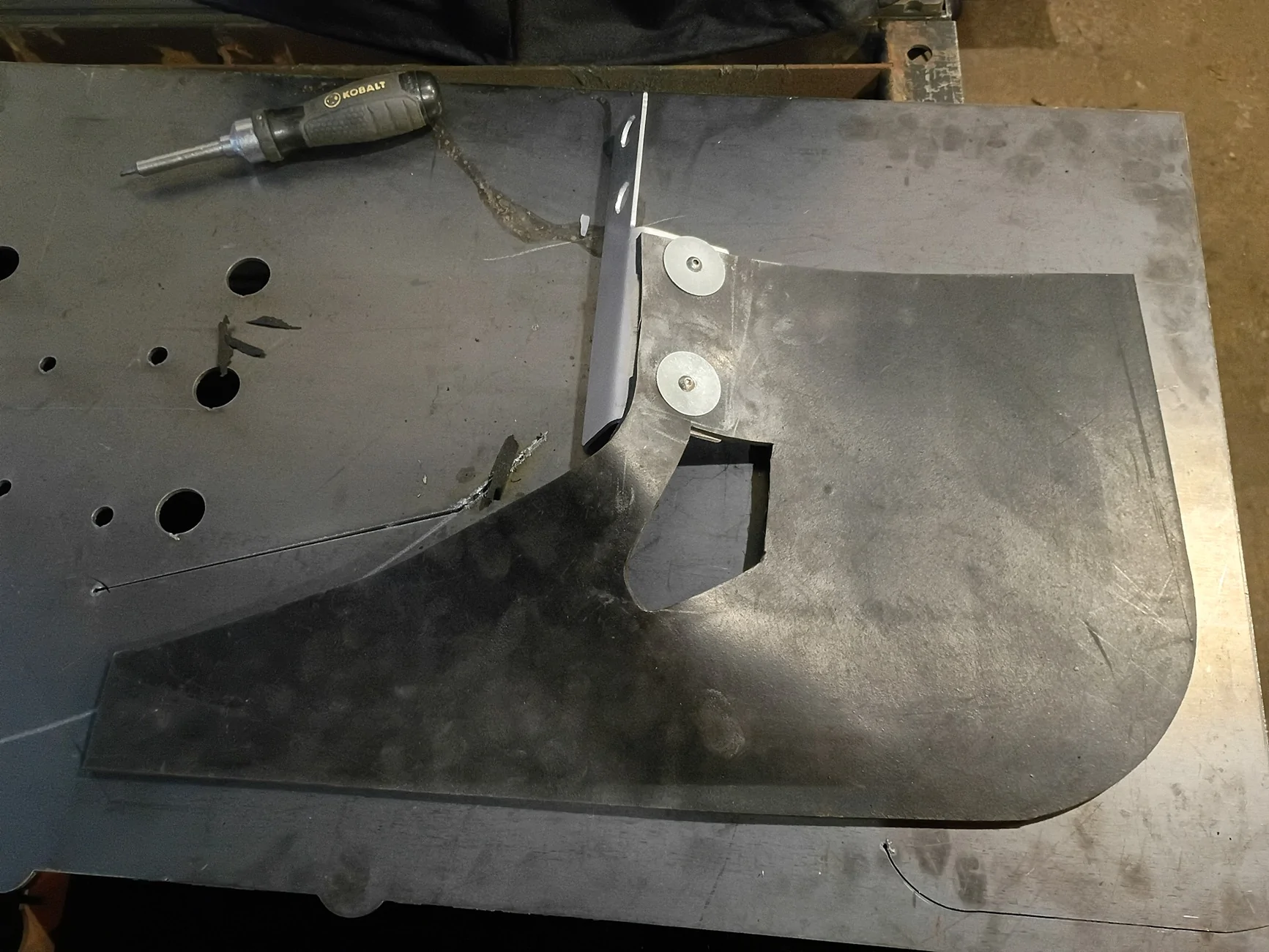

I've wanted to install mudflaps since I bought my two door Black Diamond Bronco, but the only ones that had the coverage and design I wanted were the Gatorbacks, and I couldn't see spending $500 on mudflaps.
I wanted them to be rubber, so that they would be flexible, I didn't want poly or plastic, and I wanted more coverage than most aftermarket options offered. I didn't want to drill into the Bronco, and I've had bad luck with the cheap plastic mounts on aftermarket ones on my Ranger.

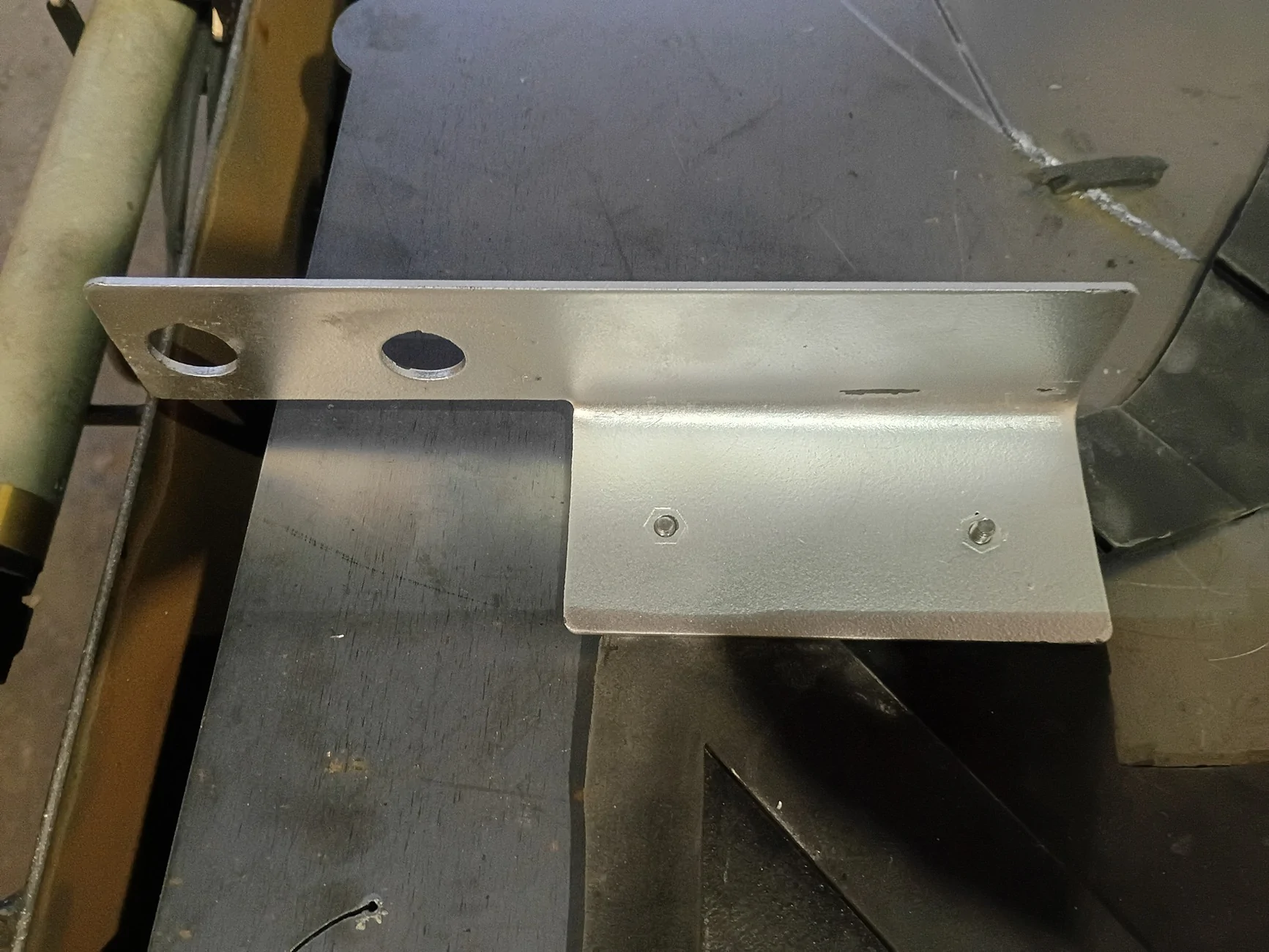

So, I decided to make my own. First order of business was to design a simple bracket that was sturdy, and easily mountable. Fire up the plasma cutter!
Ford Bronco Homemade custom mudflaps DIY 1000001783

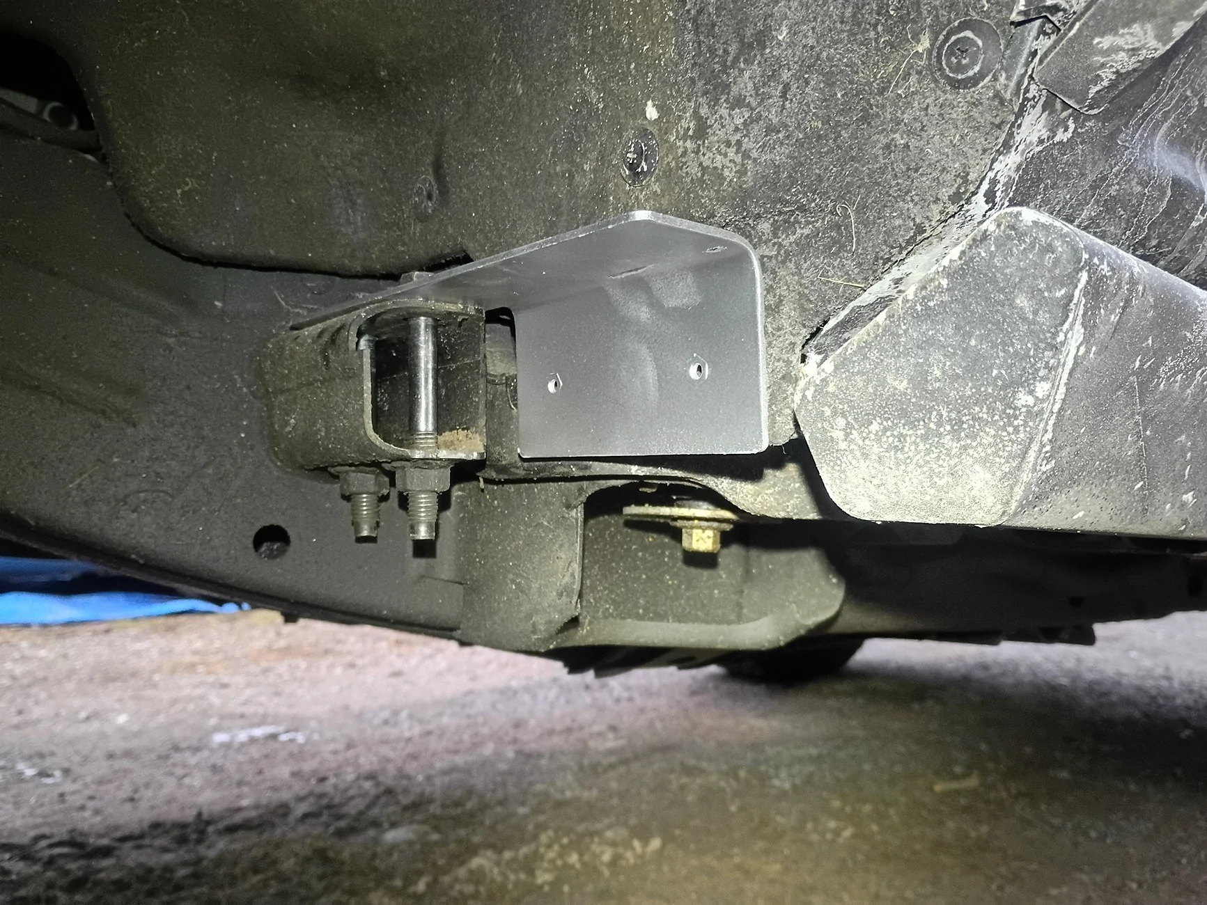

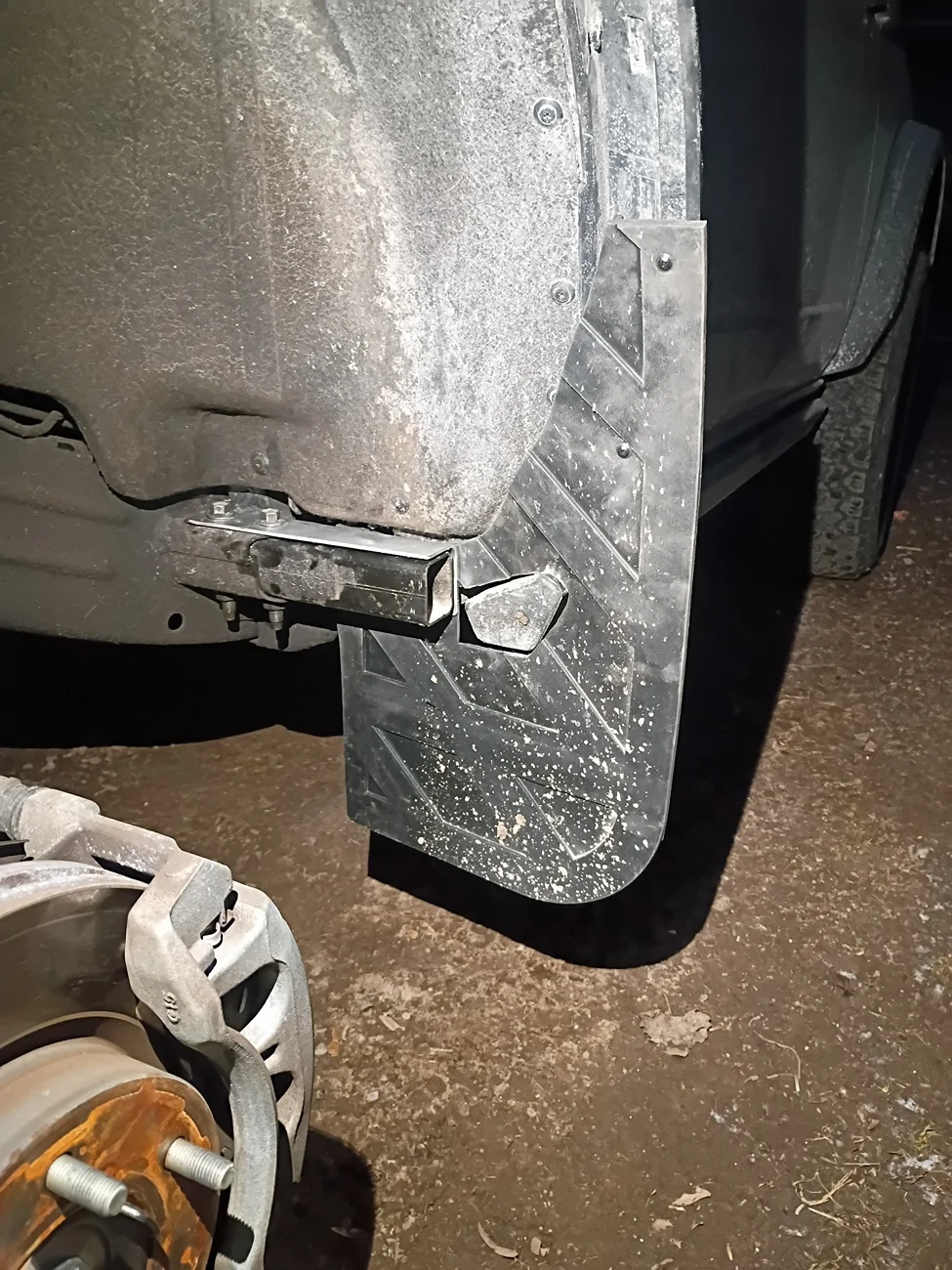

For the rear, this is what I came up with, it mounts to the rear cab mount with a single nut.
Ford Bronco Homemade custom mudflaps DIY IMG_20260111_162016000

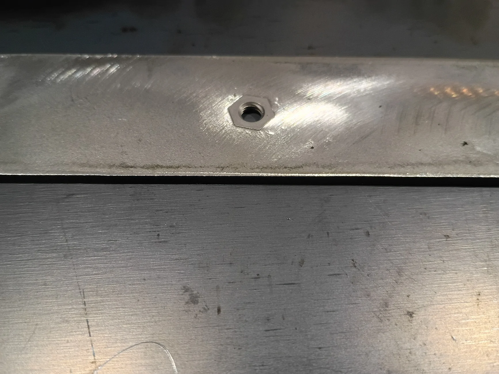

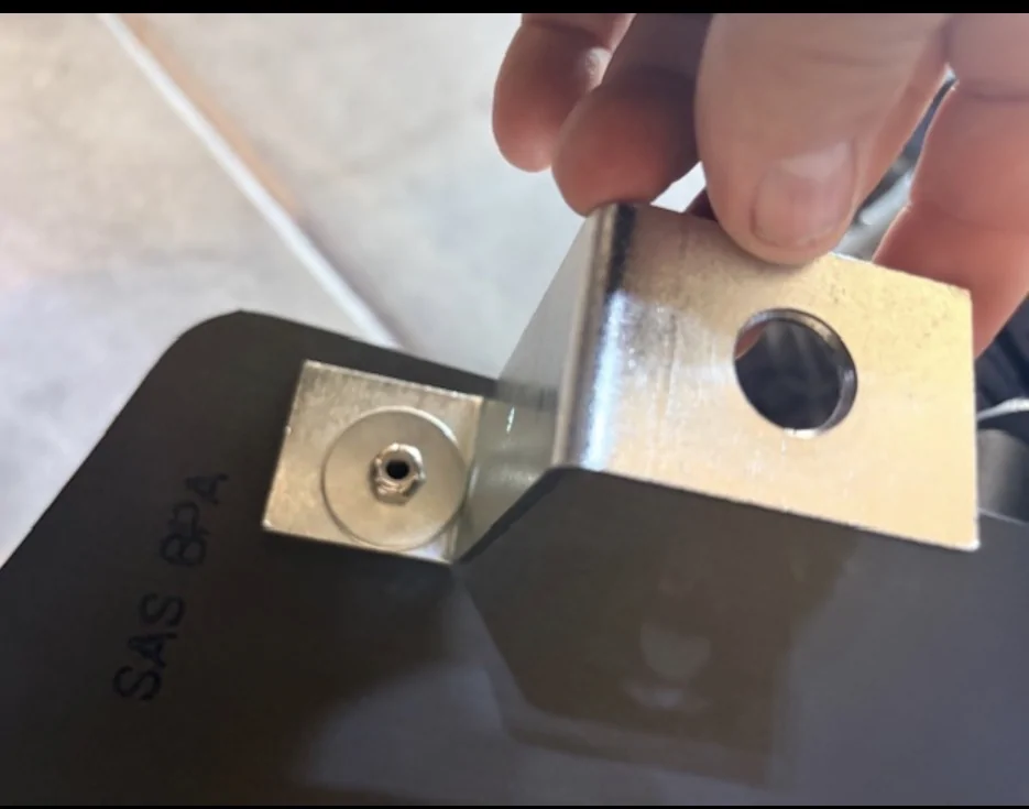

For the mount itself, I didn't want to have external nuts, plus there isn't really room for them on the front, the way I was designing my bracket for them. So I used press in PEM nuts.
Ford Bronco Homemade custom mudflaps DIY 1000001785
Ford Bronco Homemade custom mudflaps DIY 1000001786
Ford Bronco Homemade custom mudflaps DIY 1000001787
All pressed in! Now I can just bolt the flap onto the bracket, and I don't have to worry about losing the nuts.

Bracket in place, before mounting the flap.
Ford Bronco Homemade custom mudflaps DIY IMG_20260111_163105454_HDR
Ford Bronco Homemade custom mudflaps DIY IMG_20260111_163313636
Ford Bronco Homemade custom mudflaps DIY IMG_20260111_163334130
Ford Bronco Homemade custom mudflaps DIY IMG_20260111_164610415_HDR

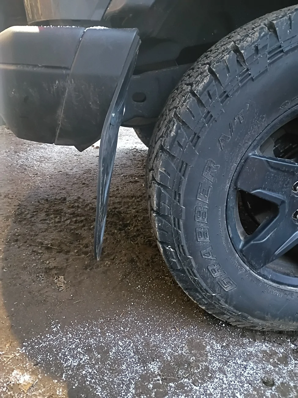

The rear, all set!

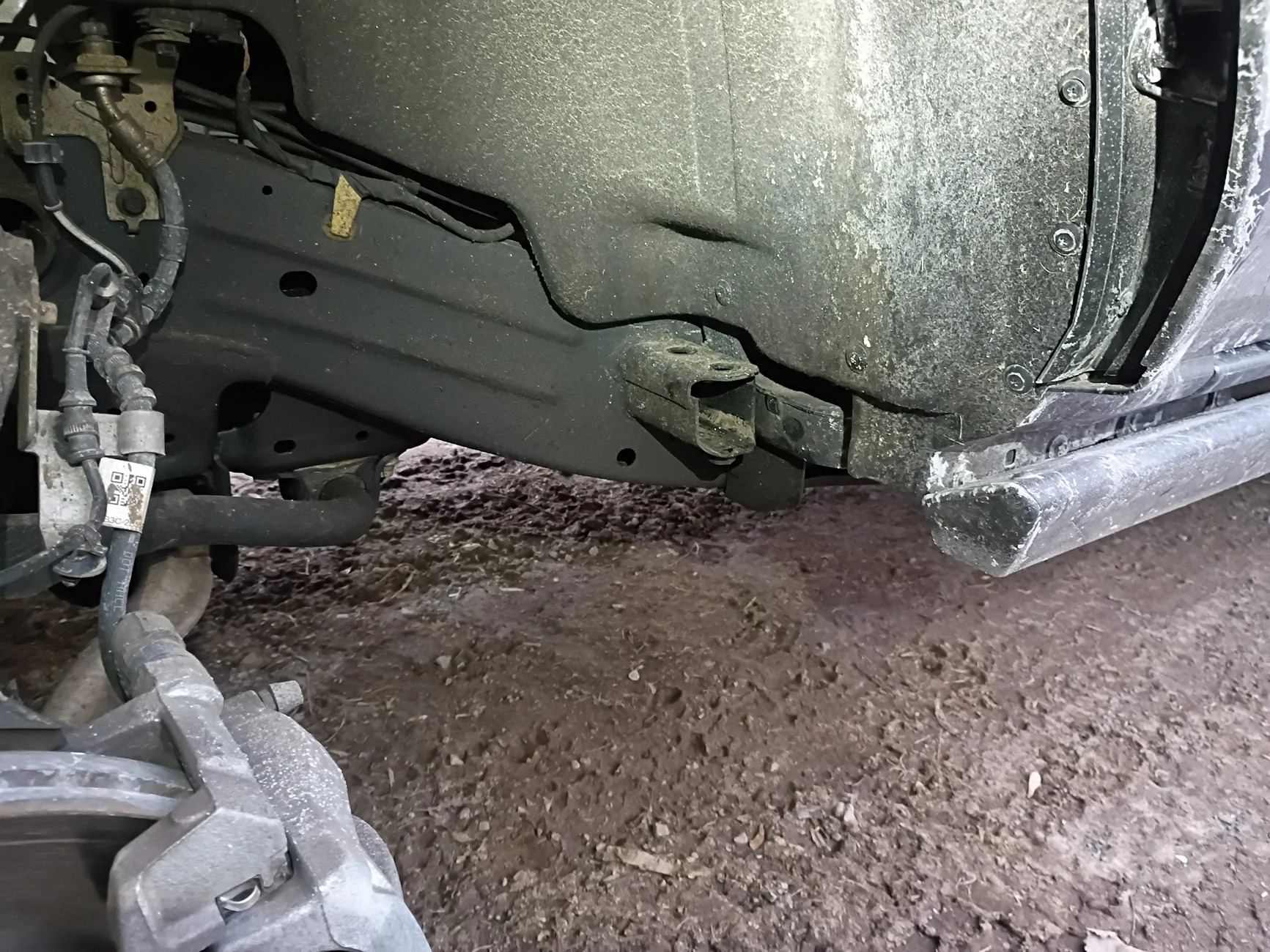

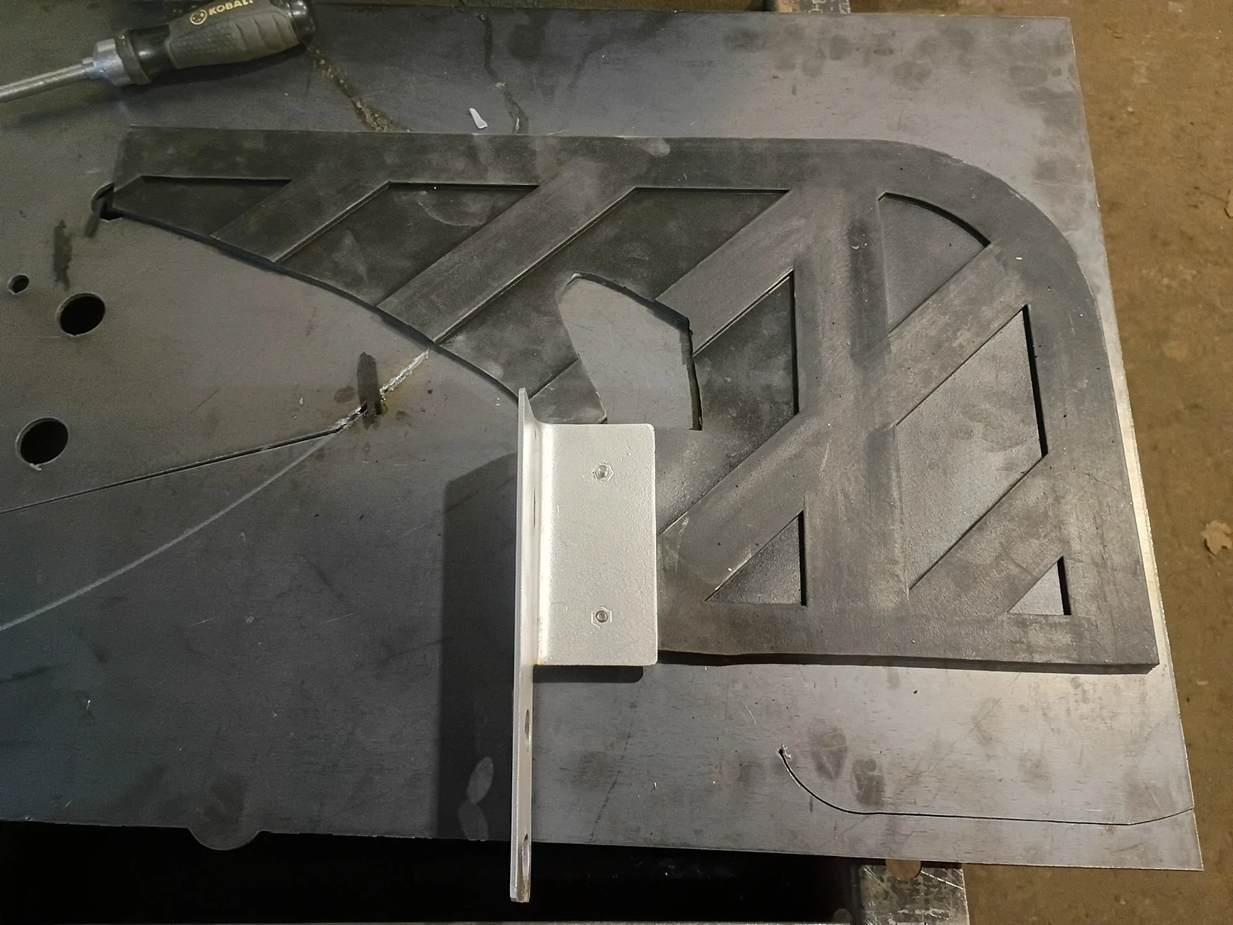

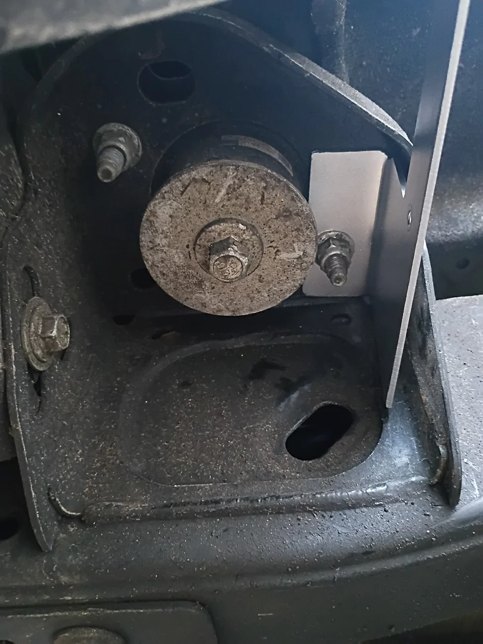

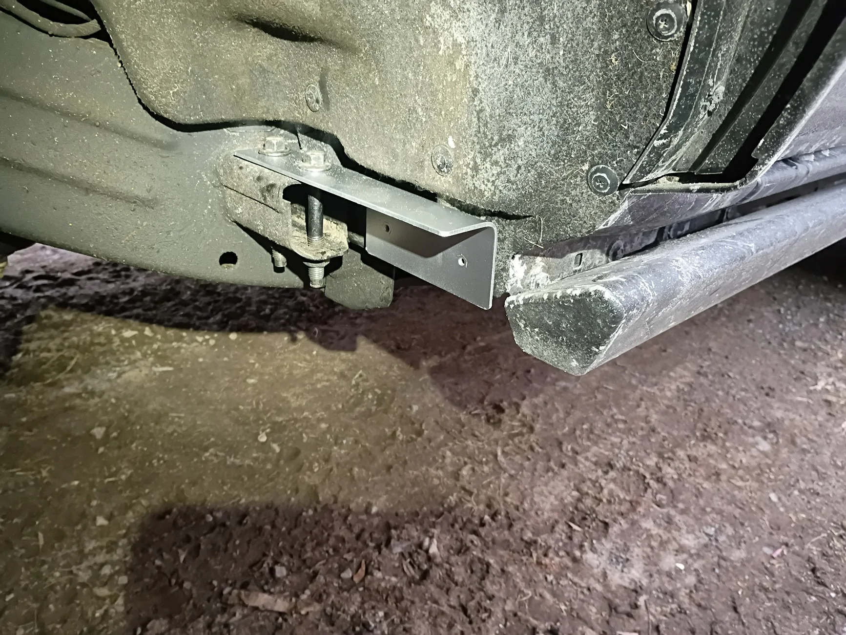

For the front, I wanted a bracket that would mount with the intrusion mount bolts.
Ford Bronco Homemade custom mudflaps DIY IMG_20260112_162355747_HDR
Same idea as the rear, it used press in PEM nuts for the mudflaps.
Ford Bronco Homemade custom mudflaps DIY IMG_20260112_161543697
Ford Bronco Homemade custom mudflaps DIY IMG_20260112_161707594_HDR
Ford Bronco Homemade custom mudflaps DIY IMG_20260112_161655437

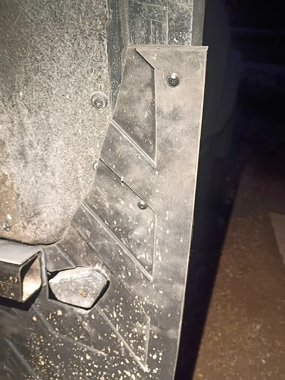

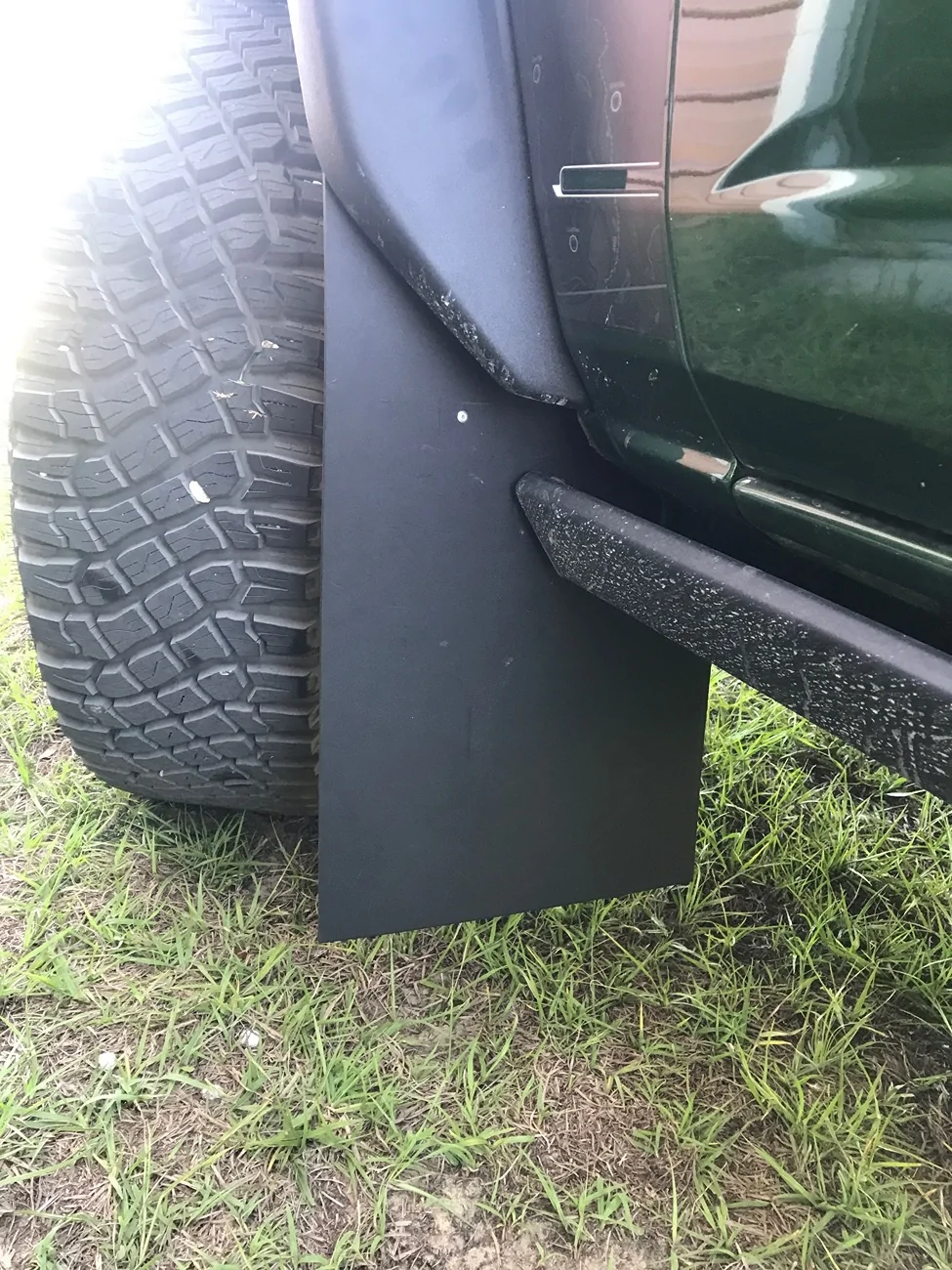

My rock sliders were in the way, so I had to trim a hole into the flaps so that they would sit correctly.

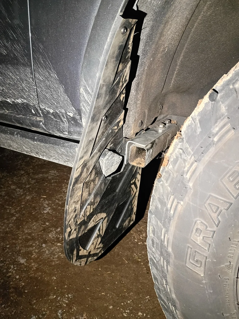

Front installed
Ford Bronco Homemade custom mudflaps DIY IMG_20260112_171356908

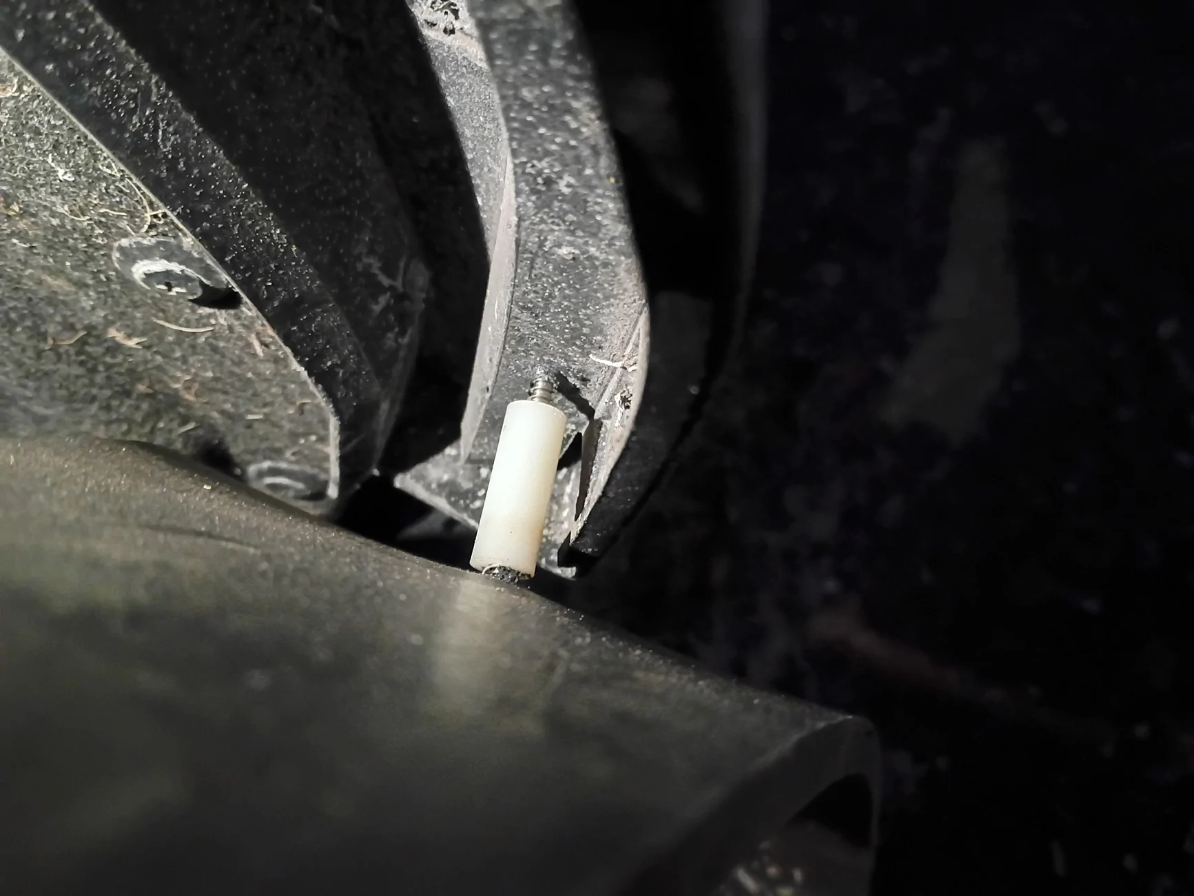

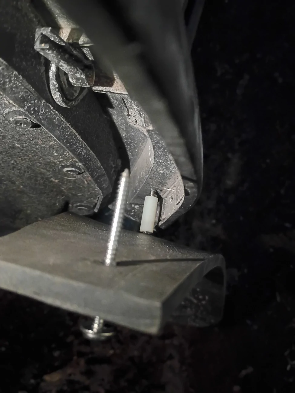

Now I did have to use two #8 screws, and two 1-inch nylon spacers at the top of the flap, and screw the flap into the plastic fender flare. I didn't want to, but the screw threads are hidden in the space between the inside and outside walls of the flare, so no big deal.
Ford Bronco Homemade custom mudflaps DIY IMG_20260112_171423691
Ford Bronco Homemade custom mudflaps DIY IMG_20260112_171506300_HDR
Ford Bronco Homemade custom mudflaps DIY IMG_20260112_171516449_HDR

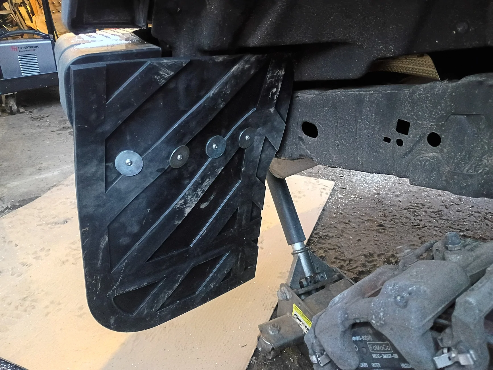

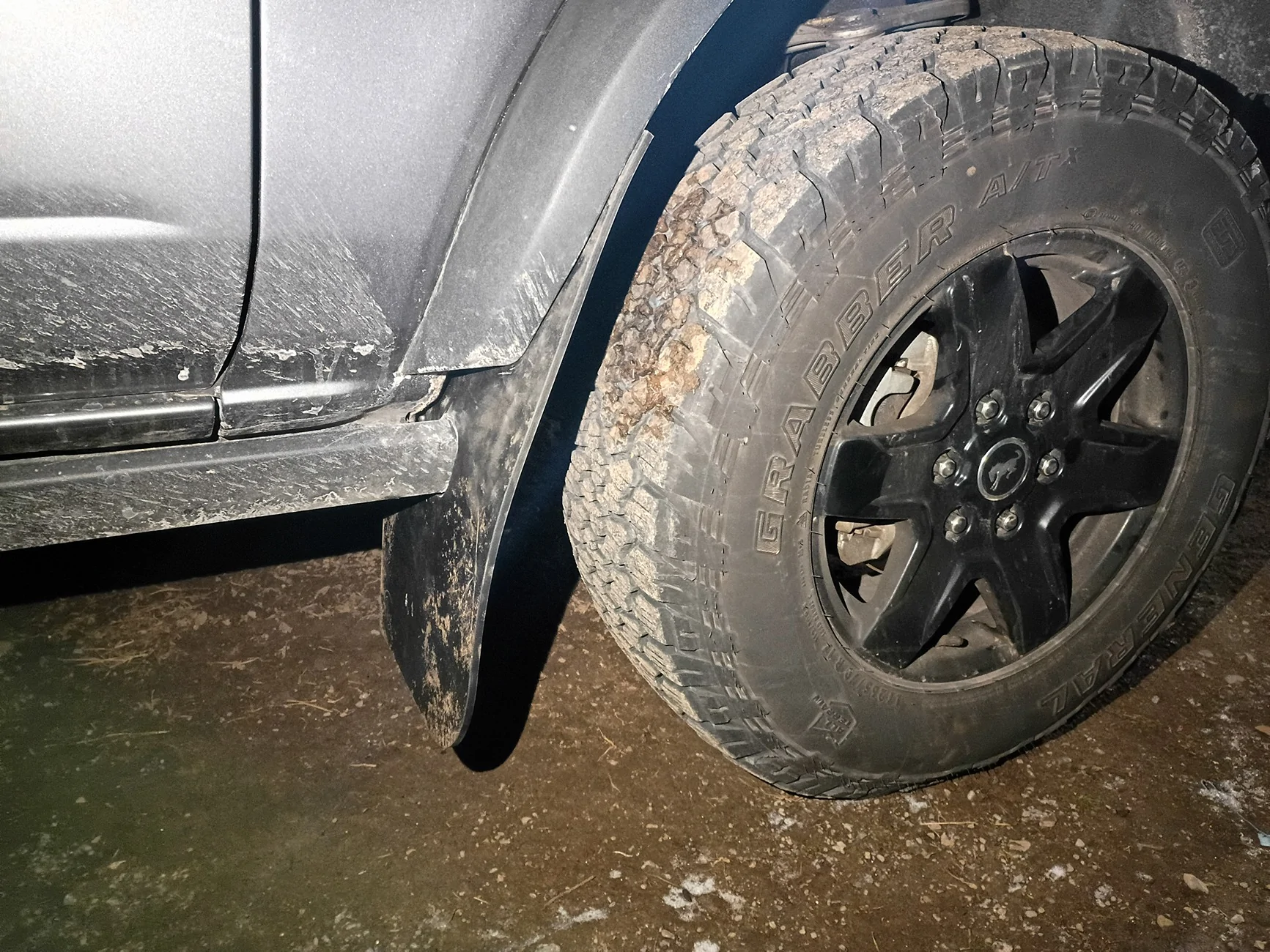

And the front mudflap, all installed. You can see from the spray on the door that I really needed these!
Ford Bronco Homemade custom mudflaps DIY IMG_20260112_173514931_HDR
Ford Bronco Homemade custom mudflaps DIY IMG_20260112_173501644_HDR
Ford Bronco Homemade custom mudflaps DIY IMG_20260112_173526498_HDR
The beauty of these is I can put longer flaps on if I want, or I could even design poly flaps if rubber isn't desired.

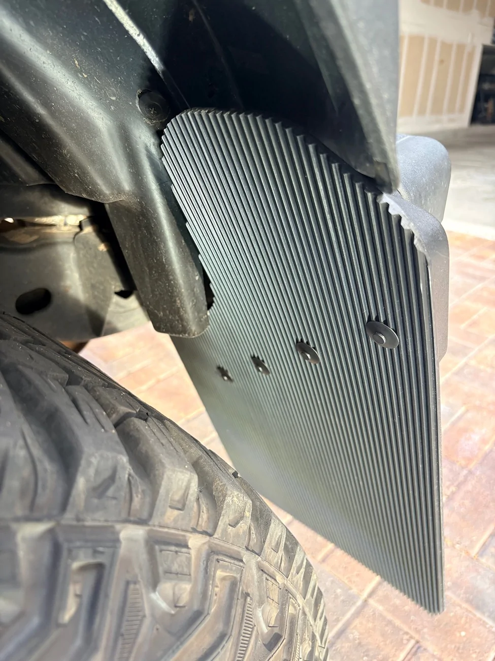

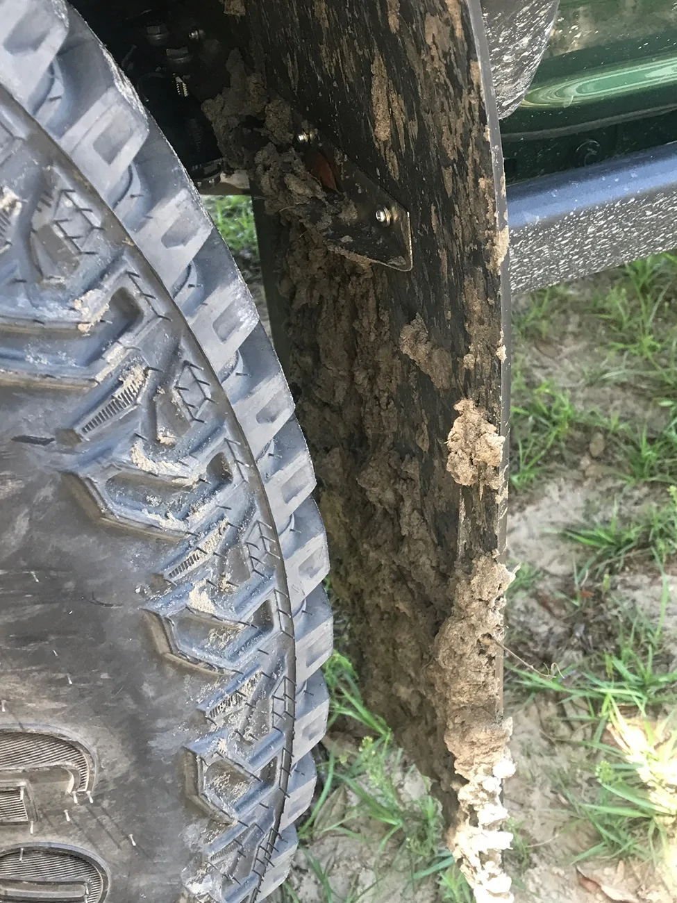

Great job.

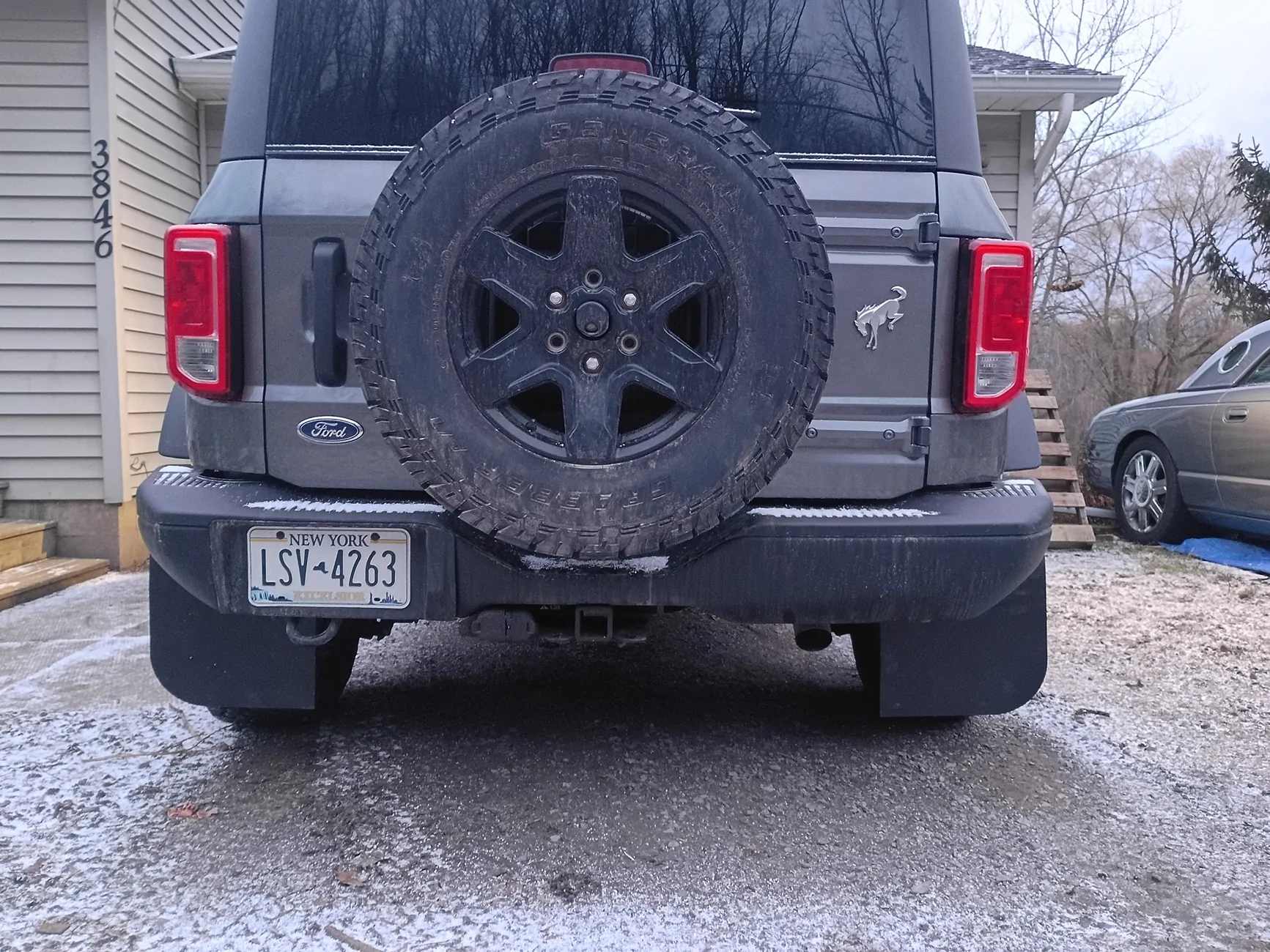

I made my own also with very similar front brackets. I knew I would need heavier steel but used some thin stainless stock I had to start. I upgraded the brackets since this pic.
I went for full coverage but I can trim them down anytime in the future.

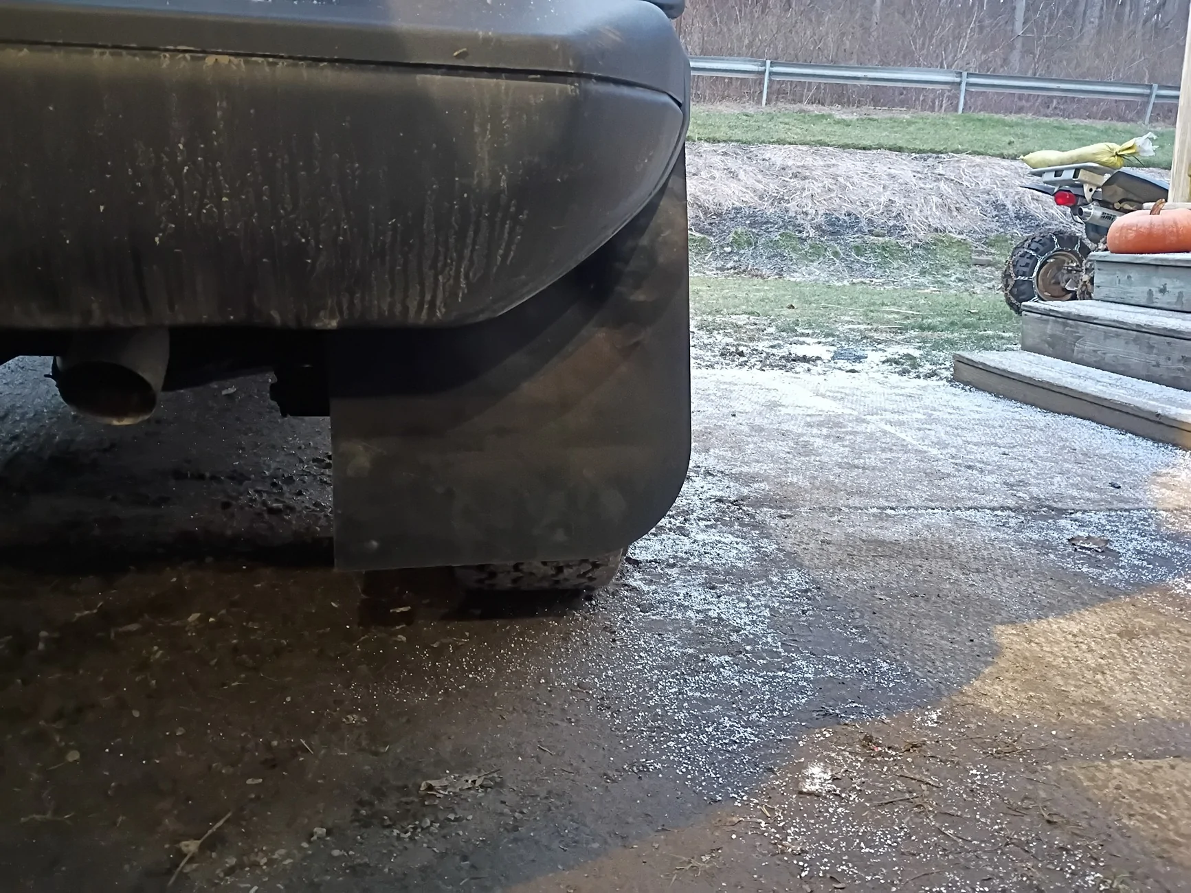

Way to go, can't find what you want make it yourself. I do the same thing made my mudflaps out of an old floor mat work great and didn't drill any holes to mount them
