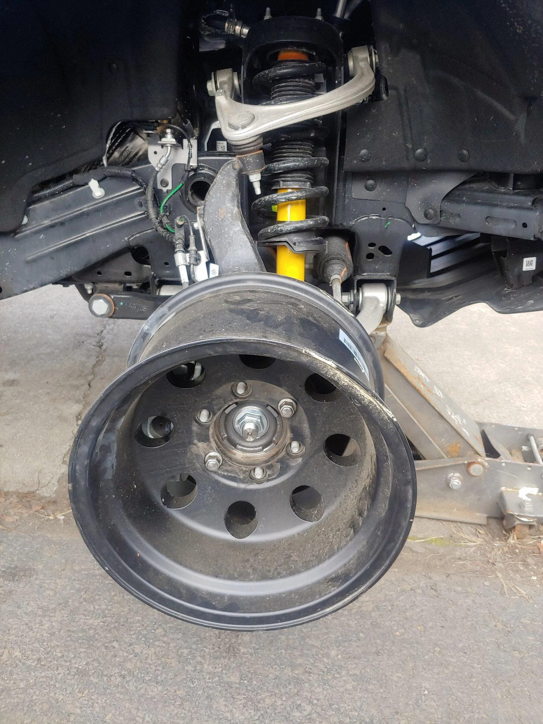

I have seen two run 15's on facebook. I believe they both trimmed the calipers a bit.

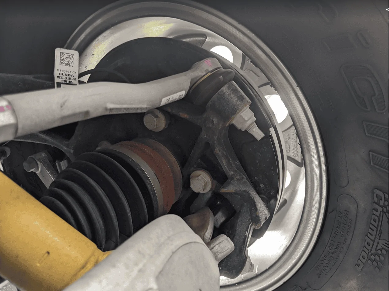

I can't imagine that the bearings are going to be happy with that offset/back spacing.

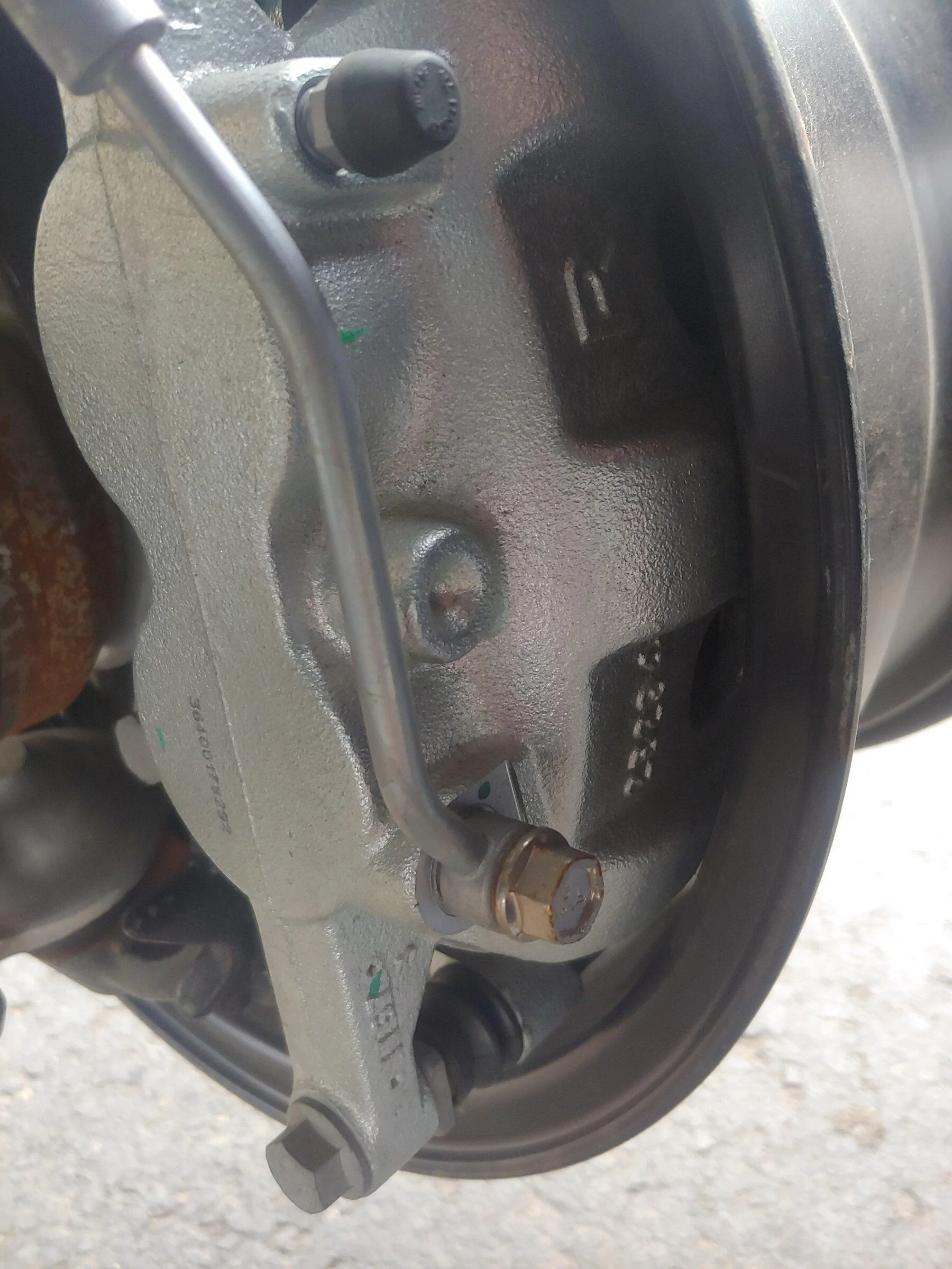

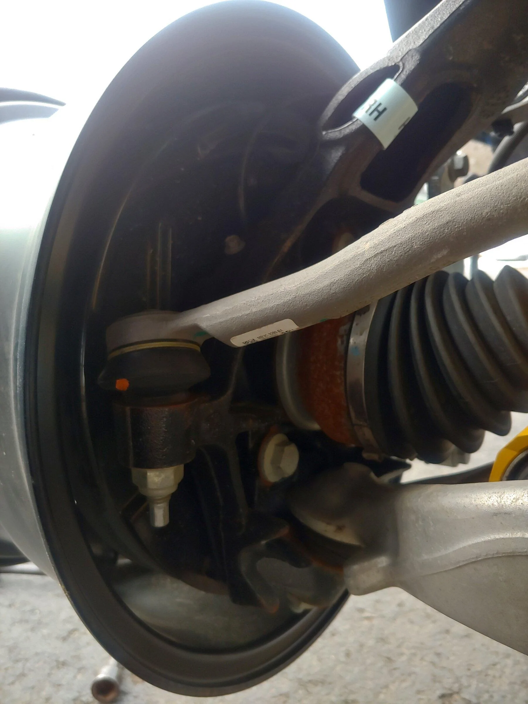

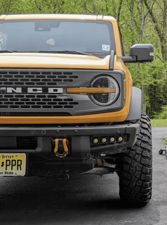

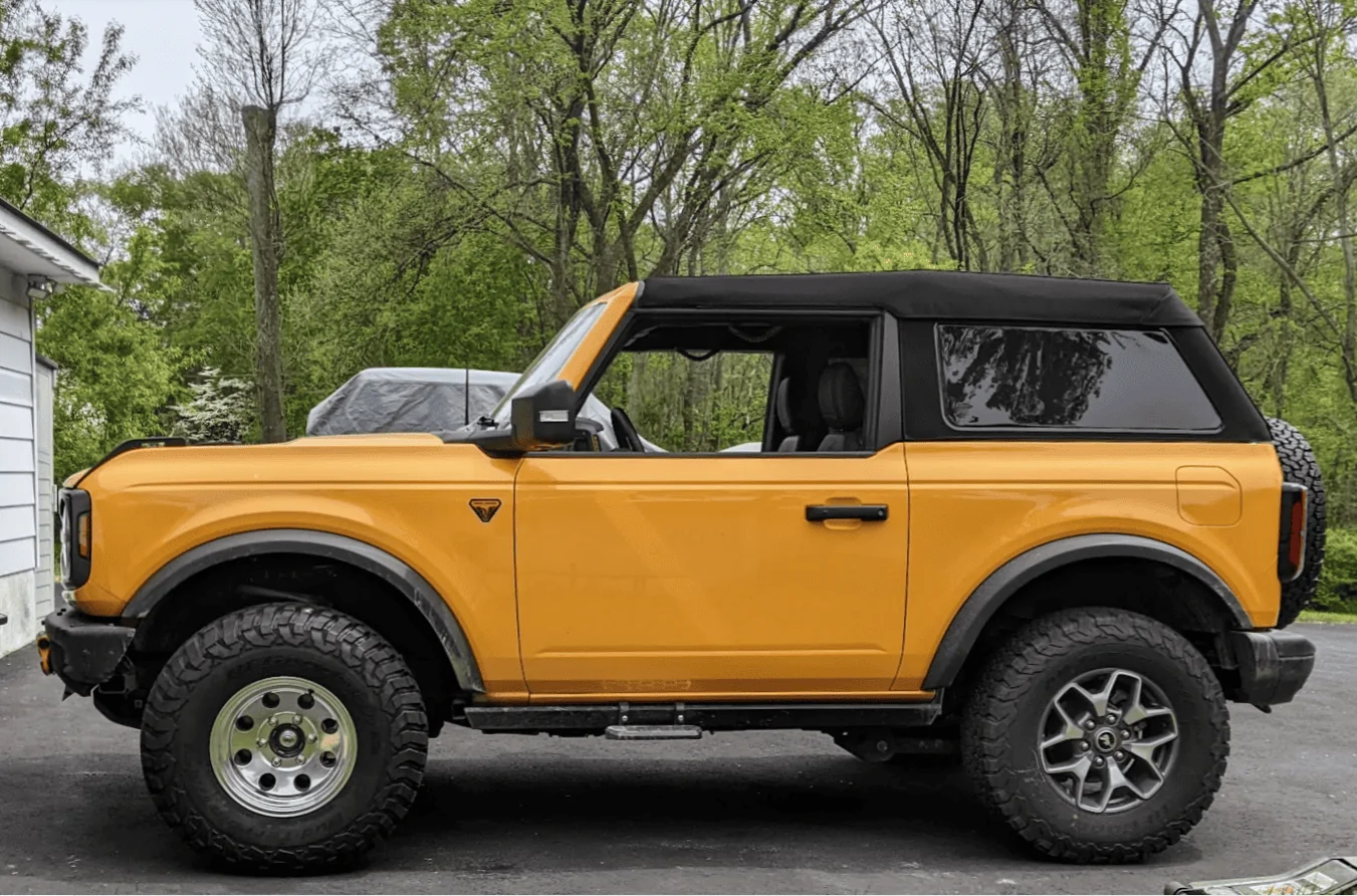

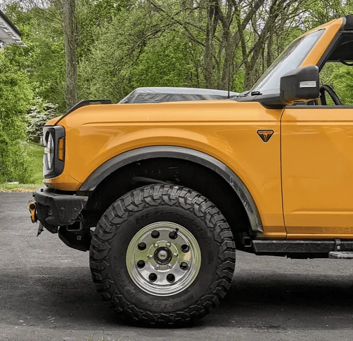

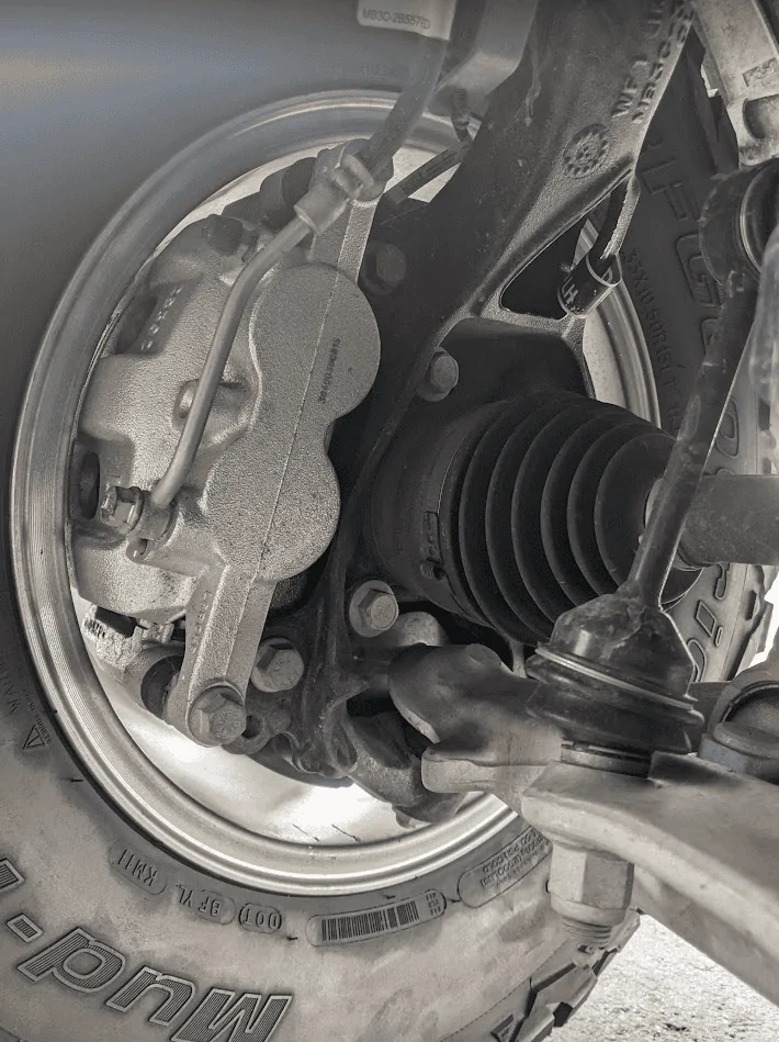

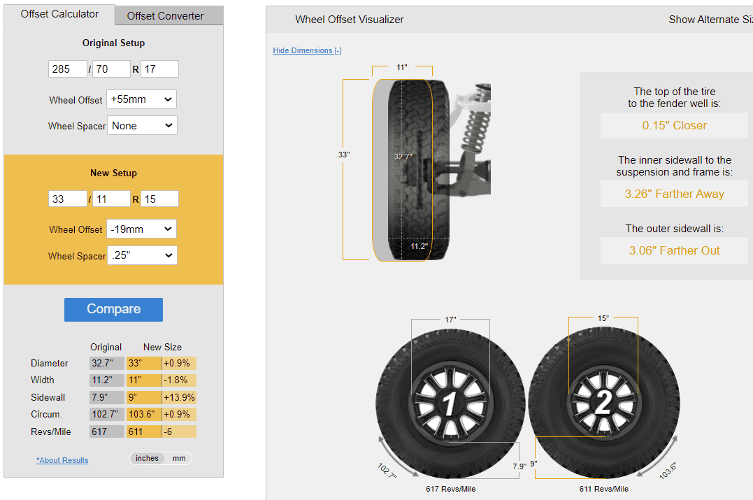

Hey @Tricky Dick , I finally got around to test fitting one of my American Racing AR172 Baja 15x8 Wheels (-19mm Offset) (3.75” BS). The inside face interfered with the caliper bracket a smidge, but a 1/4" spacer fixed it right up. The tire measured 3" further past the fender flare, which would make the overall measured O.D. of my Badlands 76" + 6" = 82" and therefore necessitate that I add "Raptor" lights to the grille! 😂
The tires are BFG Mud-Terrain T/A KM3 33x10.5x15, but I changed the width to 11" for the purpose of the TireSize.com tool, since the actual width measurement for the 10.5" tires mounted to 8" wheels is in fact 11", and the outer sidewall being further out by 3" matches what I measured. The tires just miss the front and rear crash bars at full lock.
I kinda dig the vibe of these wheels, and might just fit up the whole set soon.

15 inch rims looks so much better with all that meat showing. I'd even live with that huge poke all day long.
Agreed, and I think a set of Squatch flares could reduce the poke down to just a little sidewall protrusion.
I can confirm that they must have trimmed the rear calipers. I finally got around to fitting these up in the rear, and no dice unless I removed some caliper material. Nope, not gonna do it.
