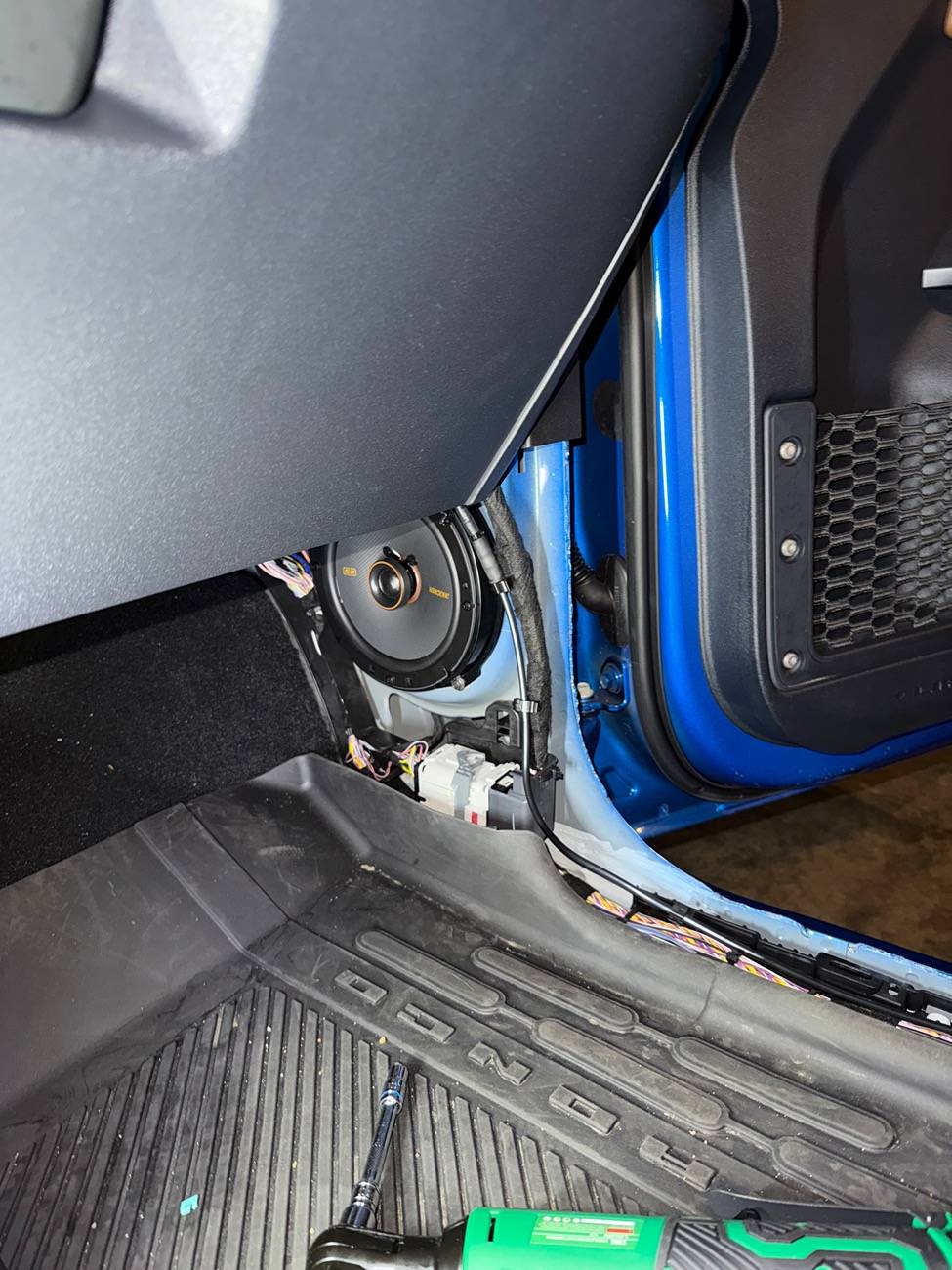

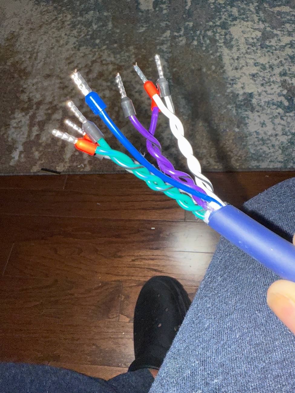

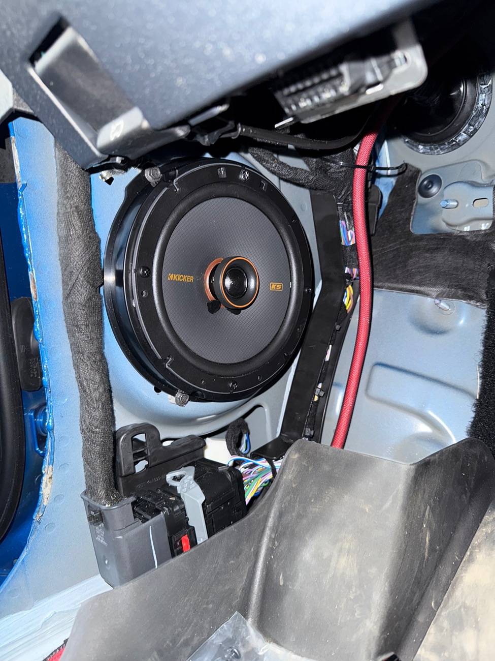

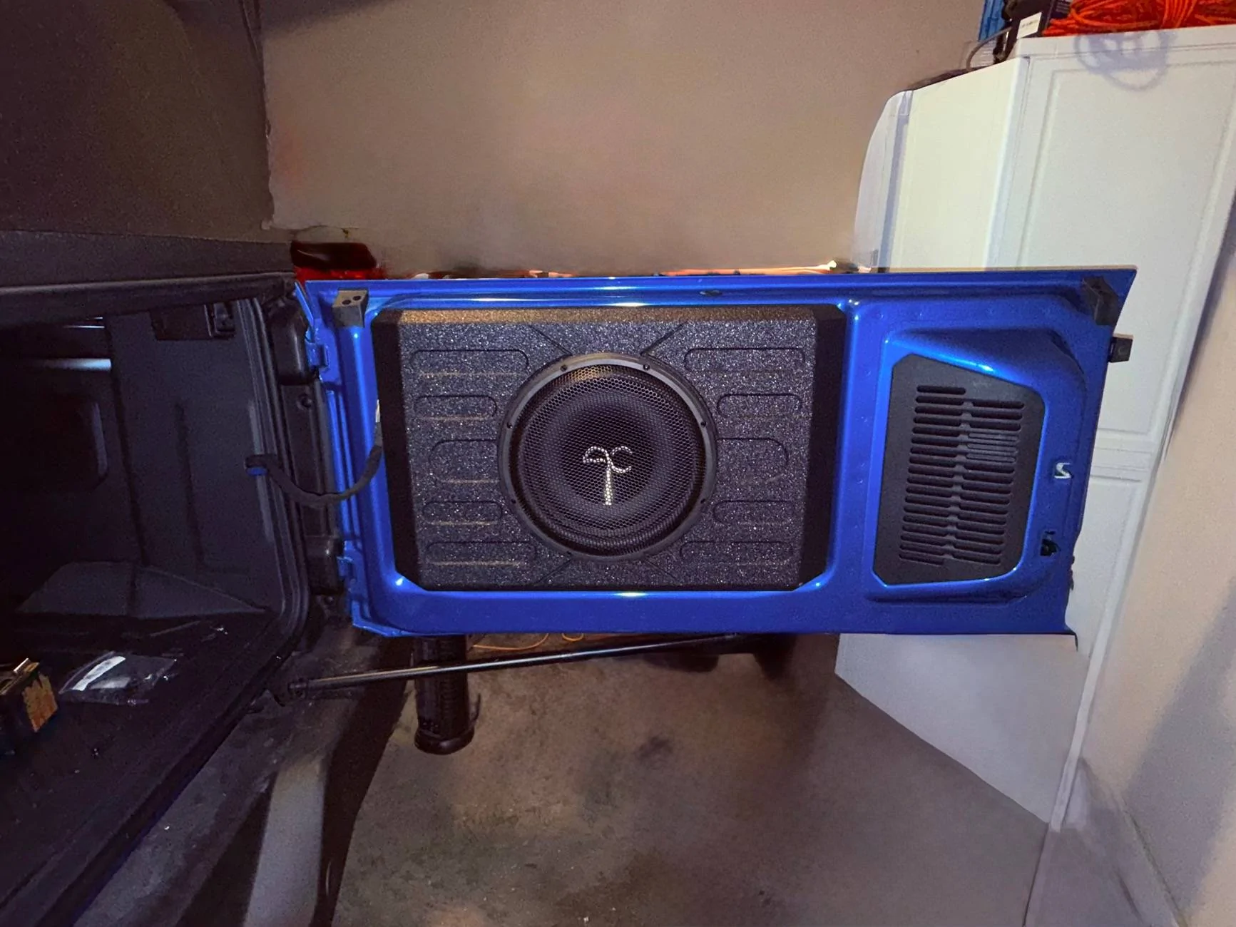

I replaced all 6 of my speakers with Kicker KS series, and installed a Wavetec 5 channel amp accompanied by the Stinger tailgate sub.
