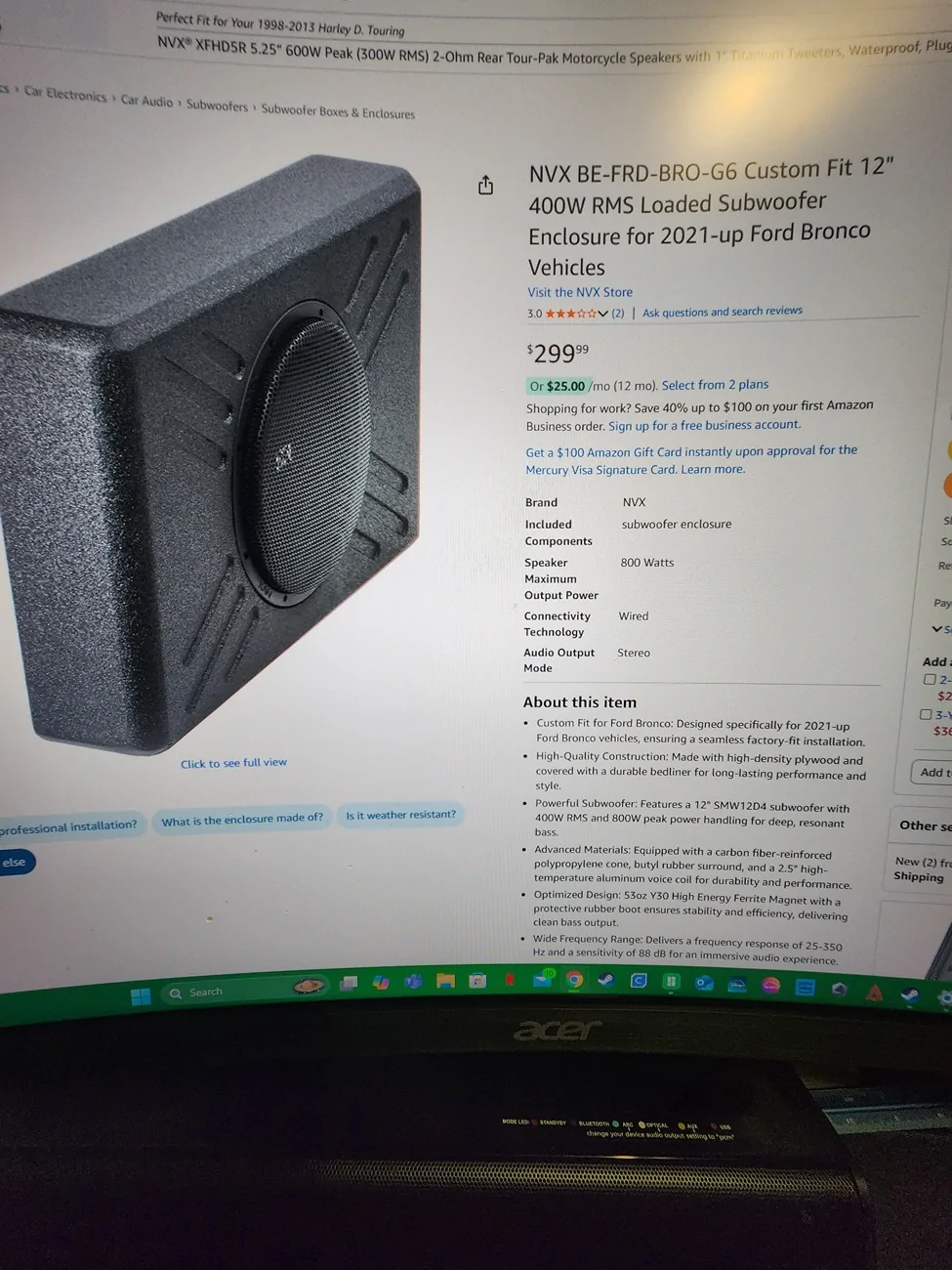

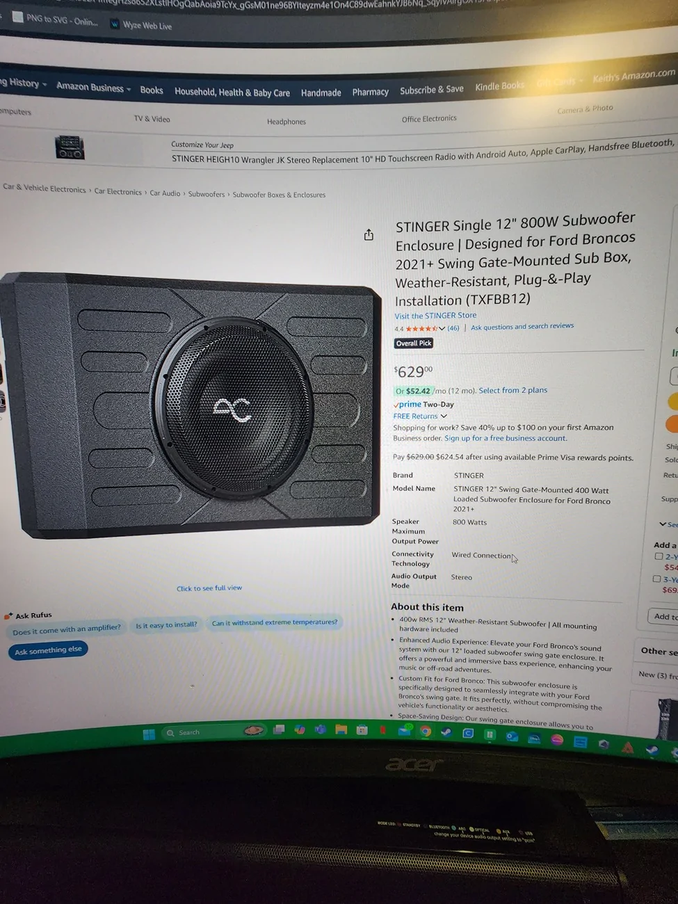

Any legitimate reason the stinger box is $300 more than the NVX version? Even if the sub is better with that extra 300 I could get a much better sub and put it in the NVX box.
