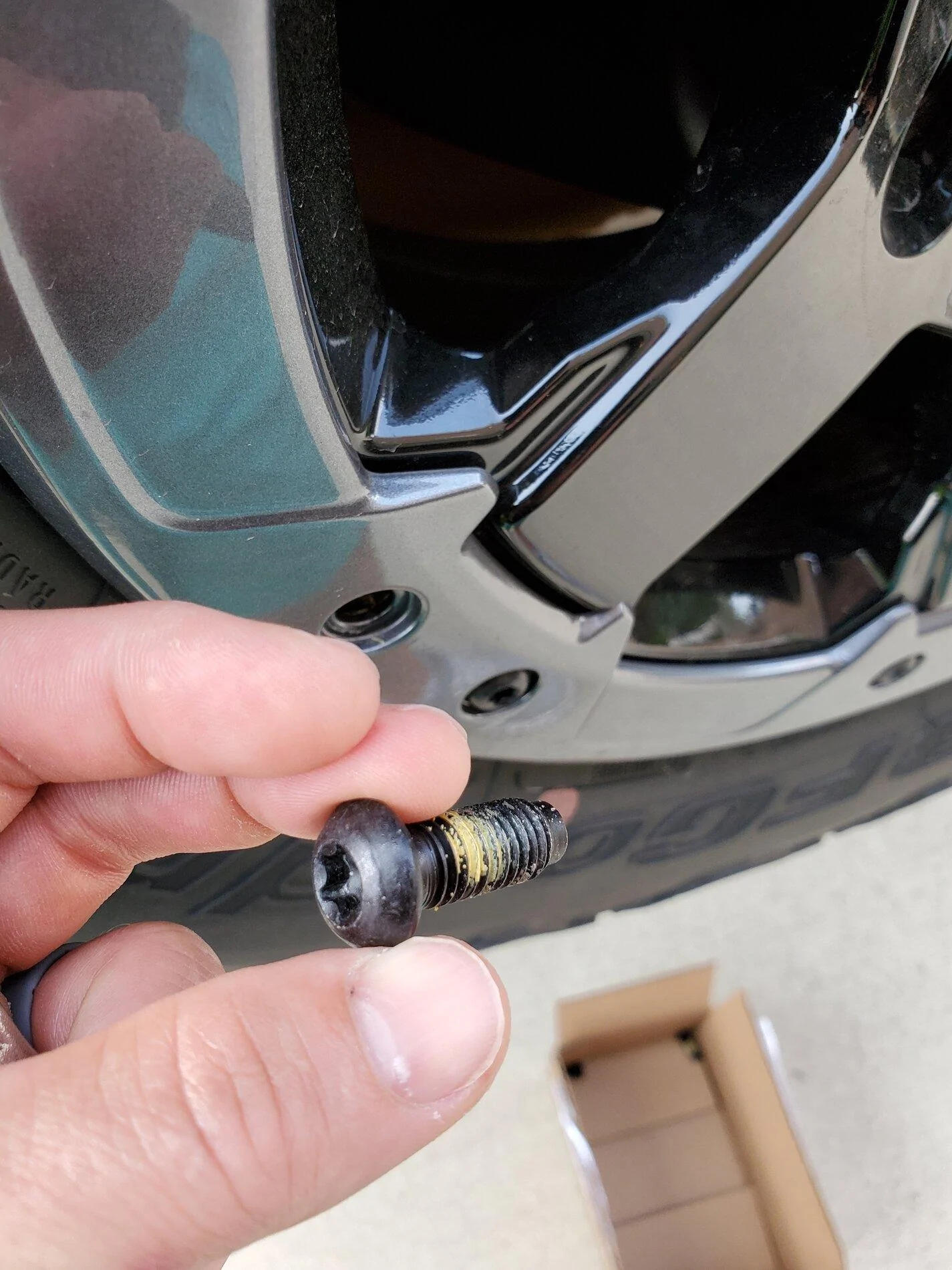

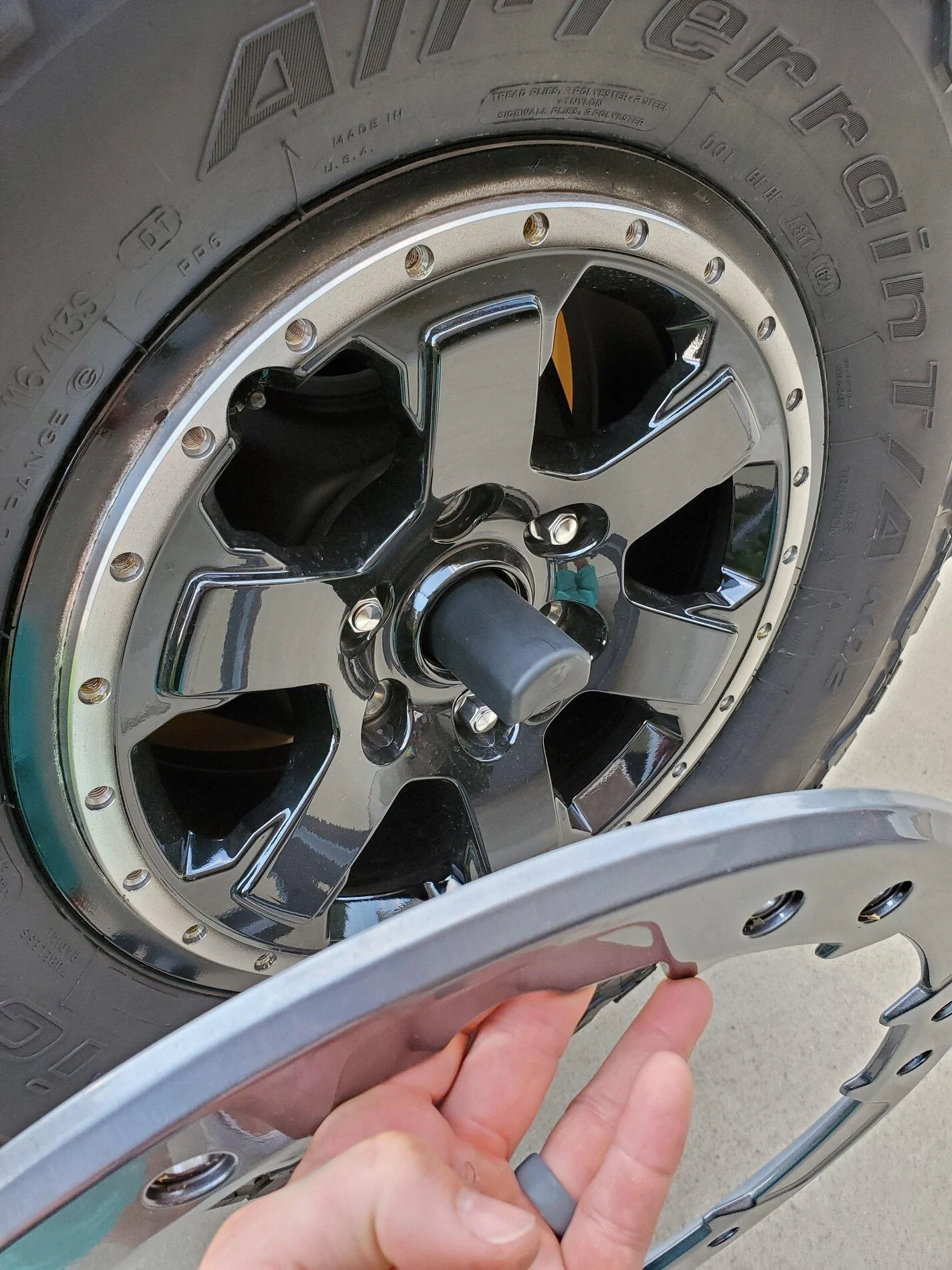

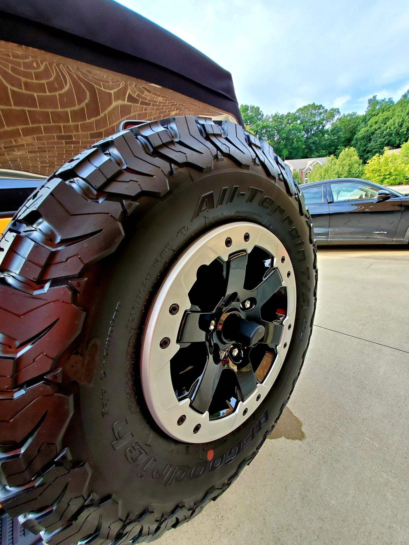

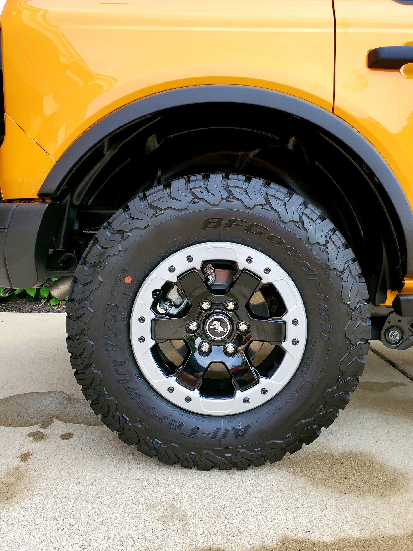

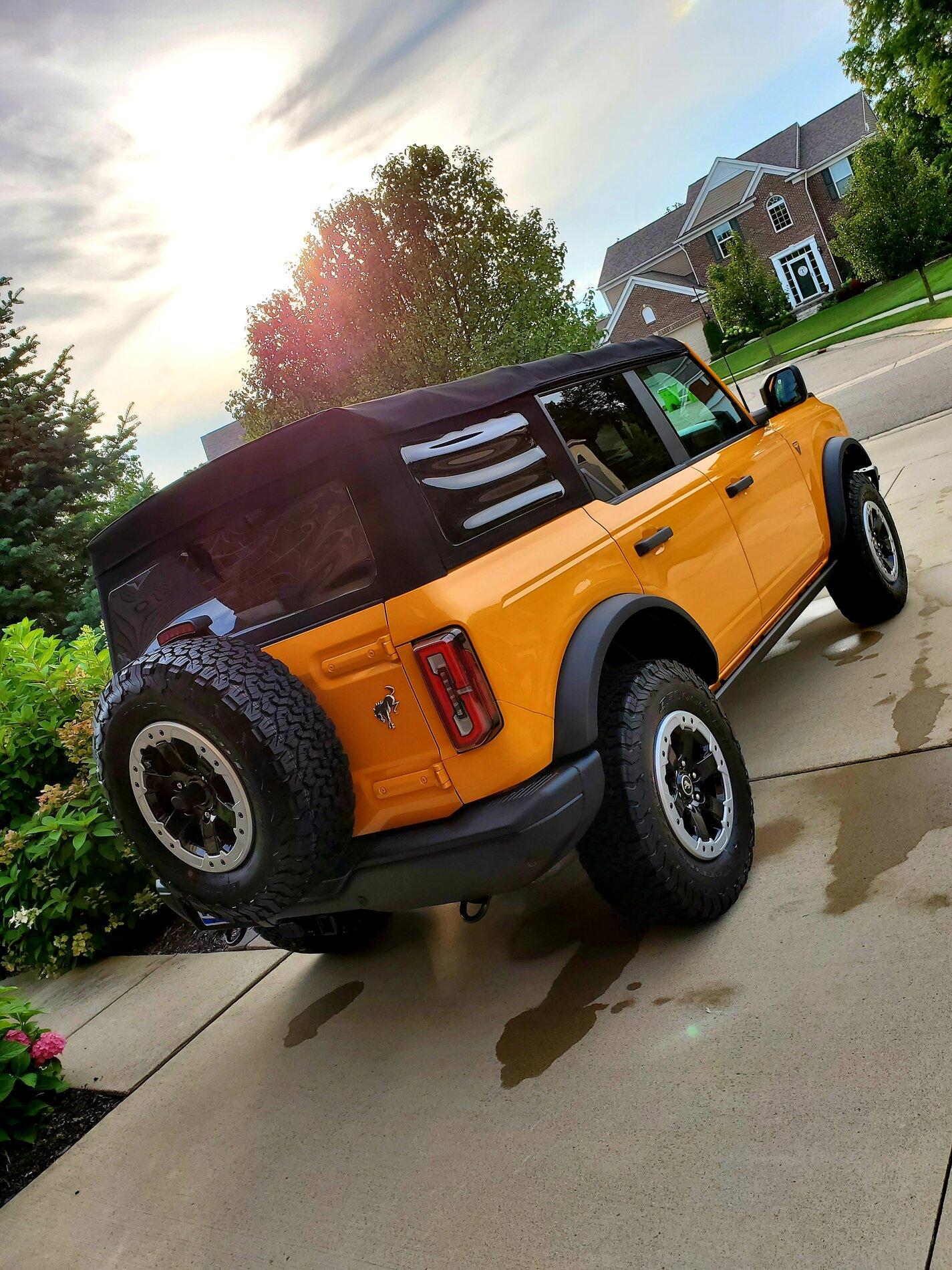

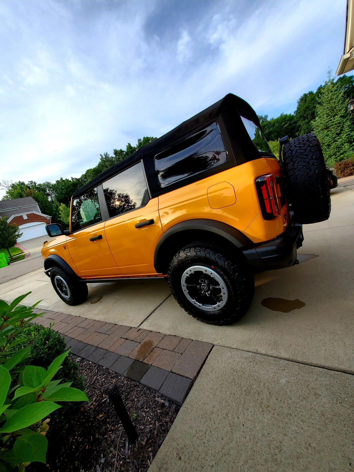

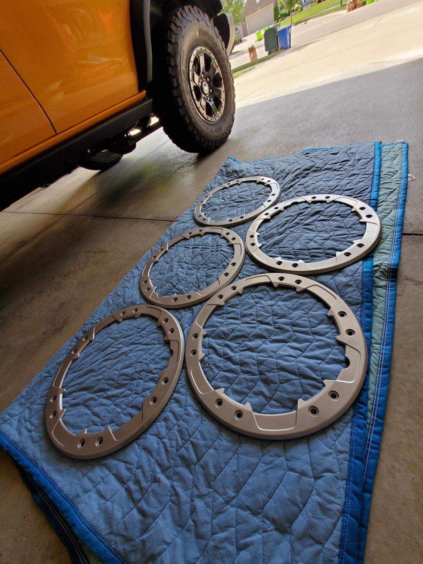

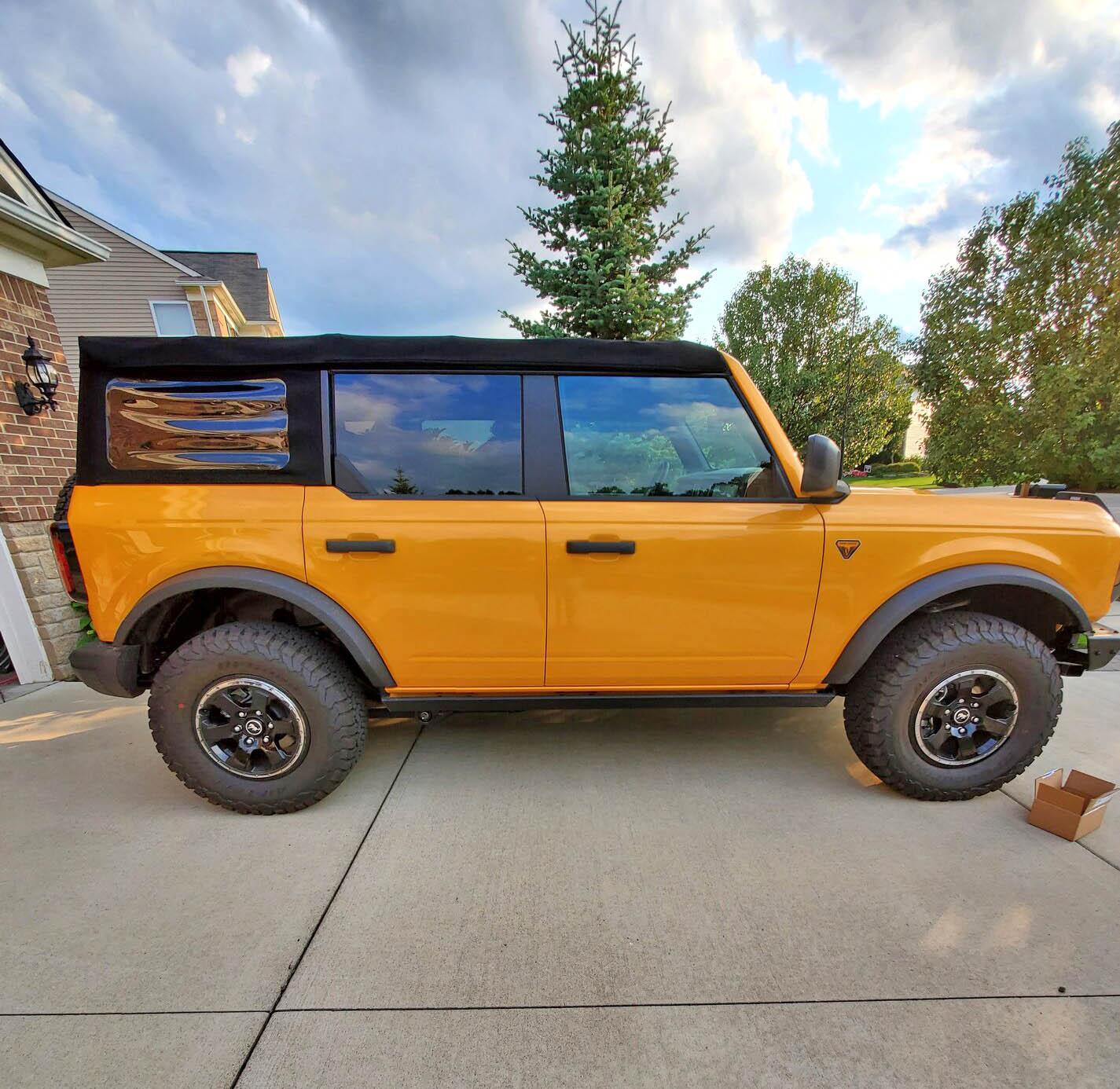

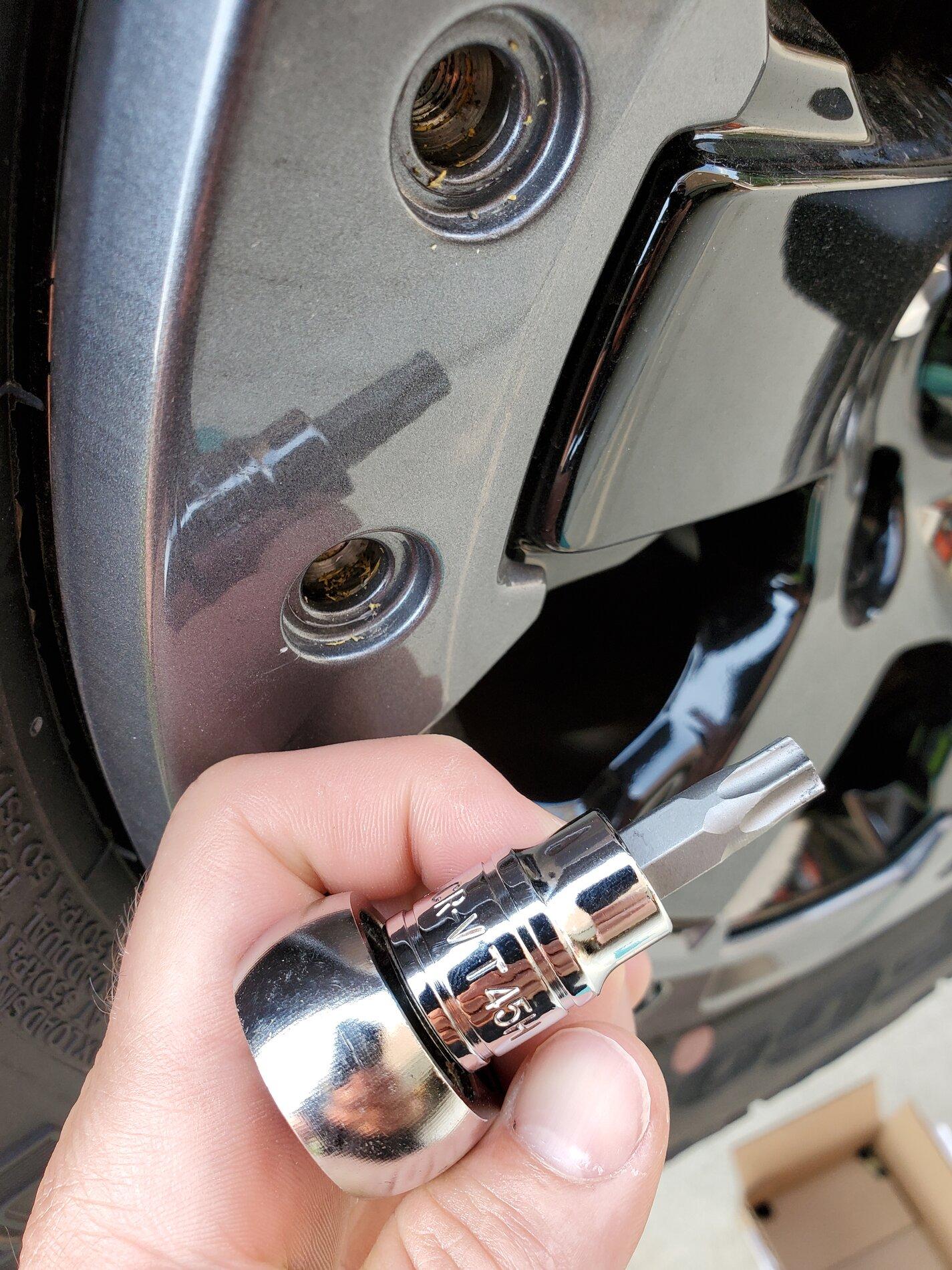

Personal preference but I'm not a fan of the darker trim ring on the non-Sasquatch wheels. These darker colored rings are metal so I'll be powdercoating them in the next few days. Anyway, here are some pics.

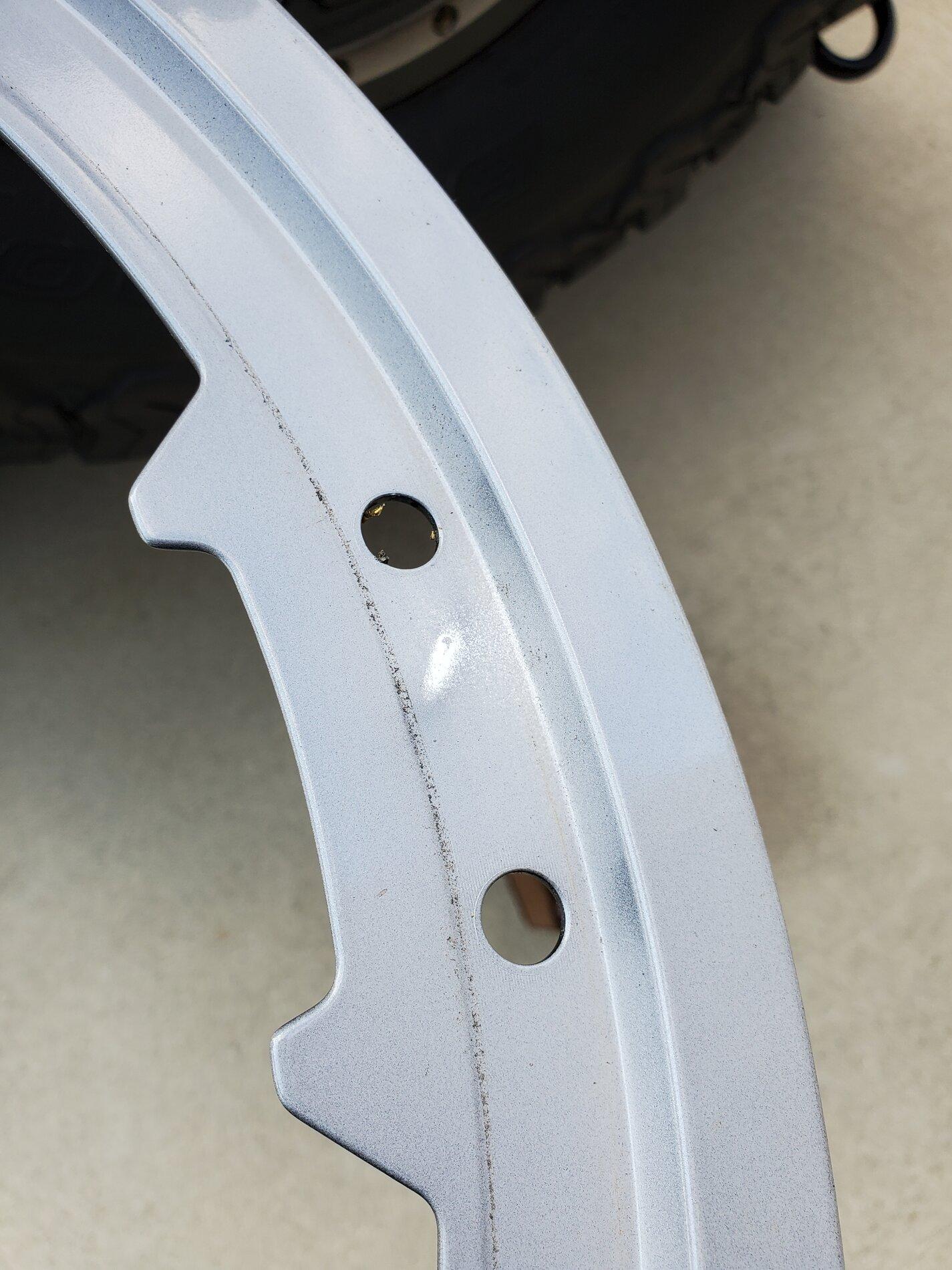

They take a T45 Torx bit and literally fall off revealing the additional holes for the actual bead lock.
Ford Bronco Beadlock Capable Wheels Rings Removal and Color Changed (Powdercoated) - Non-Sasquatch Badlands 2021 Bronco Beadlock Wheels Ring removed 2
Ford Bronco Beadlock Capable Wheels Rings Removal and Color Changed (Powdercoated) - Non-Sasquatch Badlands 20210727_184705
Ford Bronco Beadlock Capable Wheels Rings Removal and Color Changed (Powdercoated) - Non-Sasquatch Badlands 20210727_184744
Ford Bronco Beadlock Capable Wheels Rings Removal and Color Changed (Powdercoated) - Non-Sasquatch Badlands 20210727_185207
Ford Bronco Beadlock Capable Wheels Rings Removal and Color Changed (Powdercoated) - Non-Sasquatch Badlands 20210727_185232

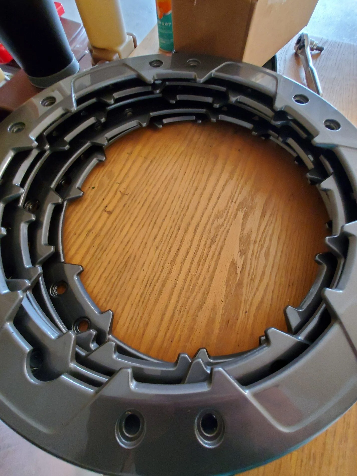

Rings were chemically stripped, blasted and powdercoated with a metallic silver and clear powdercoat.
Ford Bronco Beadlock Capable Wheels Rings Removal and Color Changed (Powdercoated) - Non-Sasquatch Badlands 20210730_161218
Ford Bronco Beadlock Capable Wheels Rings Removal and Color Changed (Powdercoated) - Non-Sasquatch Badlands Ring Comparison
Ford Bronco Beadlock Capable Wheels Rings Removal and Color Changed (Powdercoated) - Non-Sasquatch Badlands 20210730_193033
Ford Bronco Beadlock Capable Wheels Rings Removal and Color Changed (Powdercoated) - Non-Sasquatch Badlands 20210730_193052
Ford Bronco Beadlock Capable Wheels Rings Removal and Color Changed (Powdercoated) - Non-Sasquatch Badlands 20210730_193112
Ford Bronco Beadlock Capable Wheels Rings Removal and Color Changed (Powdercoated) - Non-Sasquatch Badlands 20210730_192953
Sans Rings 👎
Ford Bronco Beadlock Capable Wheels Rings Removal and Color Changed (Powdercoated) - Non-Sasquatch Badlands 2021 Bronco Beadlock Wheels Ring removed 1
Ford Bronco Beadlock Capable Wheels Rings Removal and Color Changed (Powdercoated) - Non-Sasquatch Badlands 20210730_193009
Ford Bronco Beadlock Capable Wheels Rings Removal and Color Changed (Powdercoated) - Non-Sasquatch Badlands 20210730_193127
Ford Bronco Beadlock Capable Wheels Rings Removal and Color Changed (Powdercoated) - Non-Sasquatch Badlands 20210731_105456-

Closeup on the ring design. Off to powder in the morning.

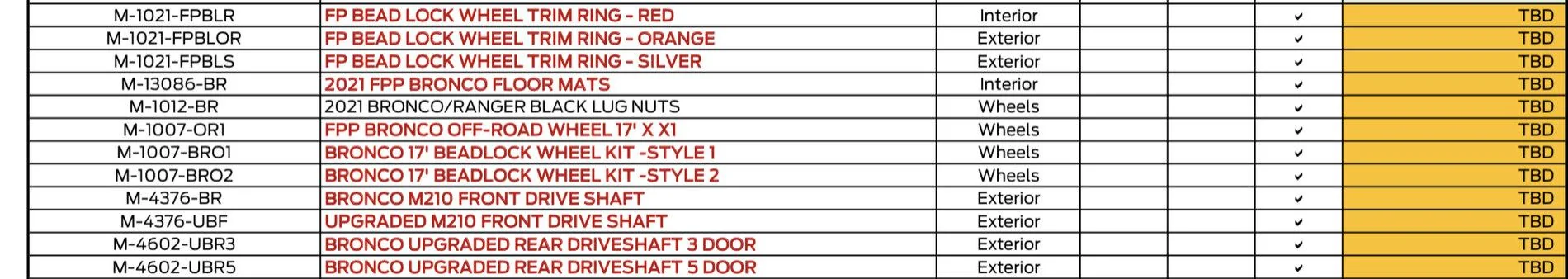

This might have been asked and answered alrady and I searched but couldn't find it so forgive me for asking but....
Where can you get the actual bead lock ring, not the beauty ring?

It’s in the accessory catalog list with P/N, but I haven’t seen any pricing on them yet (or availability online).
