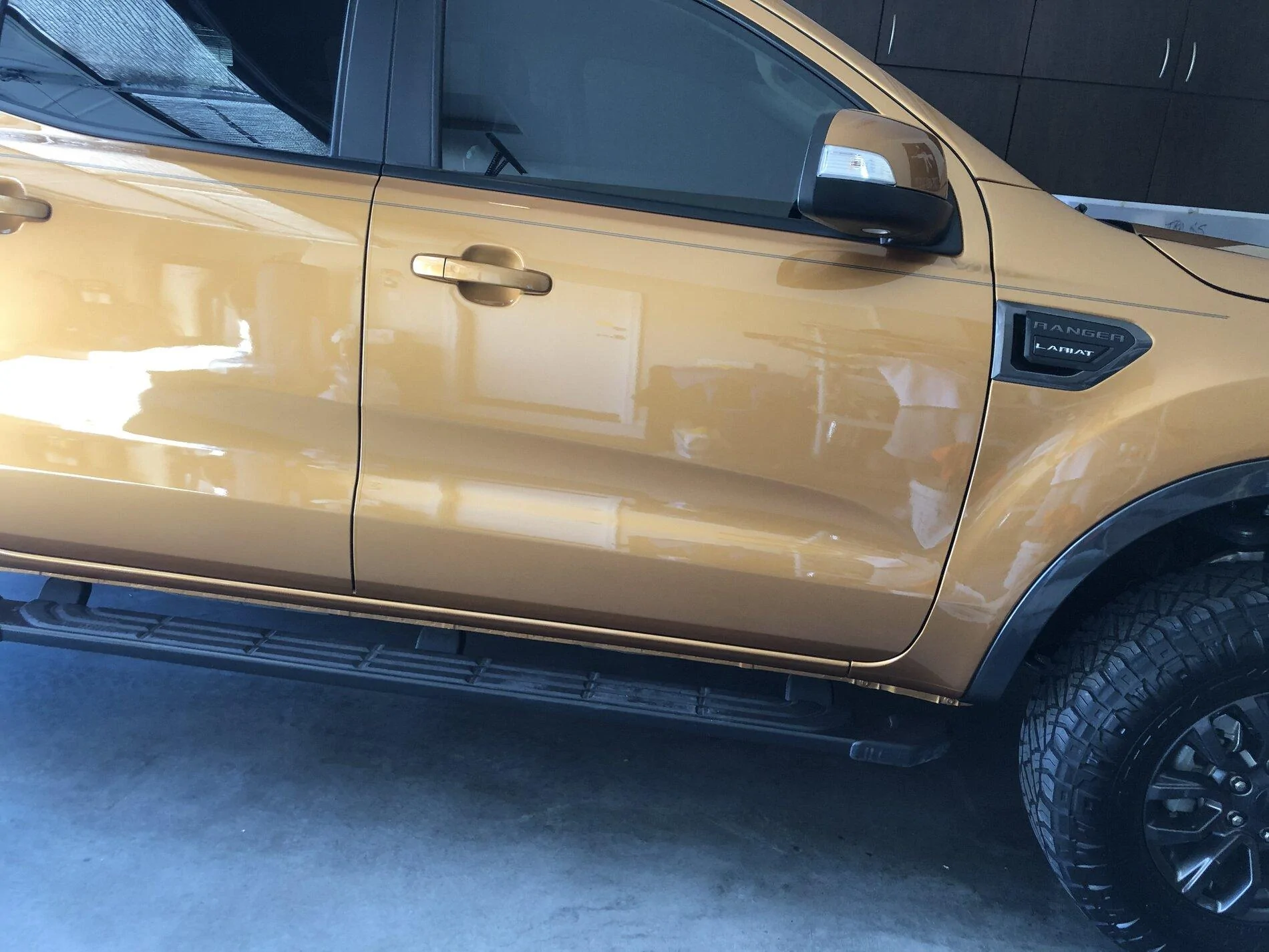

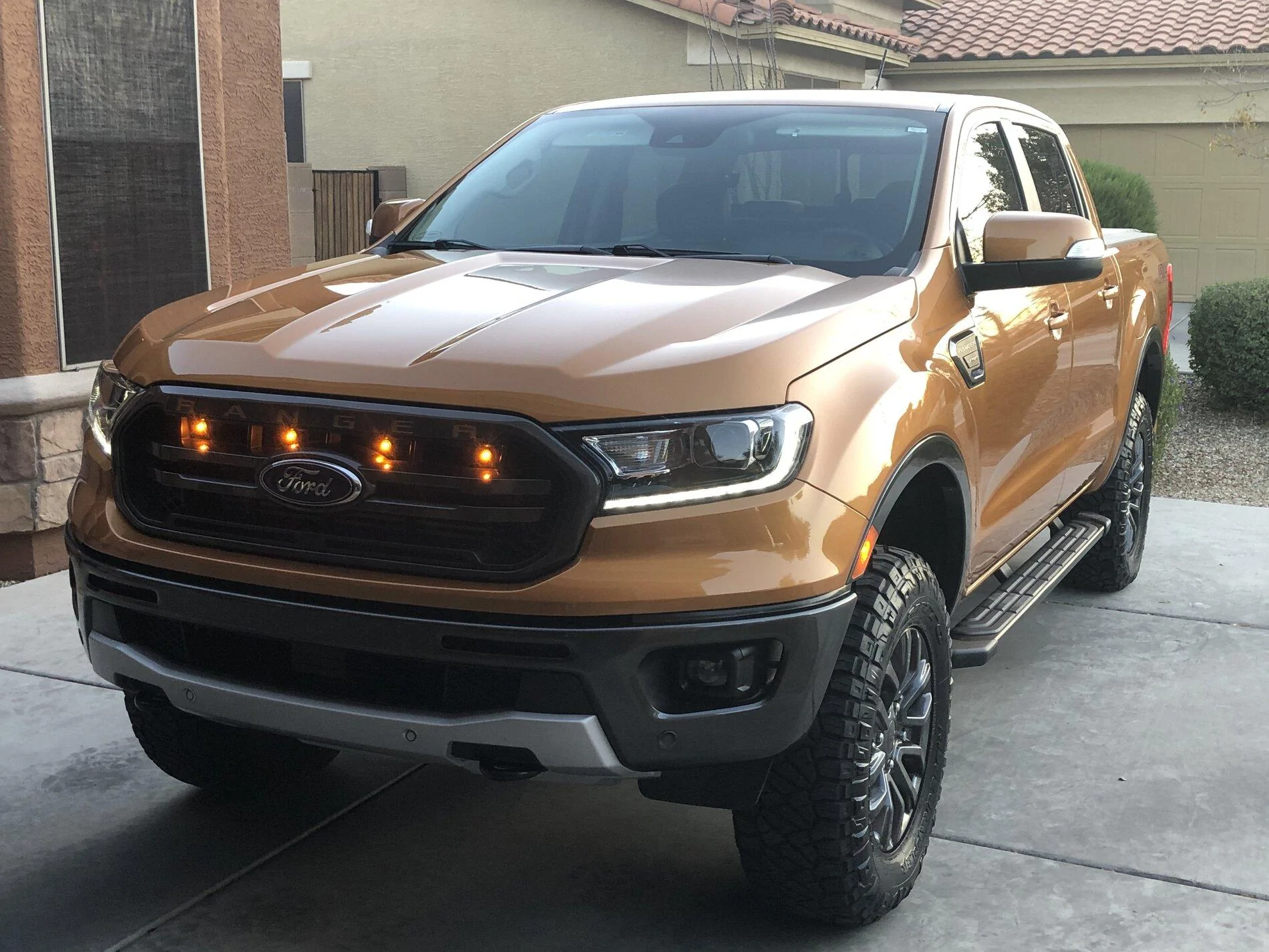

I did a complete write up on it here and yes you can use it on all surfaces. The water beading it's fantastic and it really brings out the depth in the color especially on darker vehicles. I did 2 coats because the sun here is brutal and you can layer up to 3 coats. There's no need to wax afterwards but I do use an Instant Detailer & Gloss Enhancer after washing. This picture is right after the second coat of Graphene without any Gloss Enhancer.

Looks fantastic! Do you have use any special soaps for your normal washes to prevent them from stripping the coating?

Thx! No that's the nice thing is you use anything you want to wash with and it won't interact with the Graphene. Just don't use Dawn dish soap use a good car wash.
I know one of the head guys there at 303 who helped develop this and asked him a ton of questions before using it. You can use any manufacturers speed detailers or gloss enhancers too. I use Optimums Instant Detailer and Gloss Enhancer over this. It gives it an added high gloss shine which last about 2 weeks. This goes on super easy and you only use a few sprays on a pad per panel. Let haze and wipe off. Just don't wear a white shirt (product is black) when doing this. Ask me how I know. ?

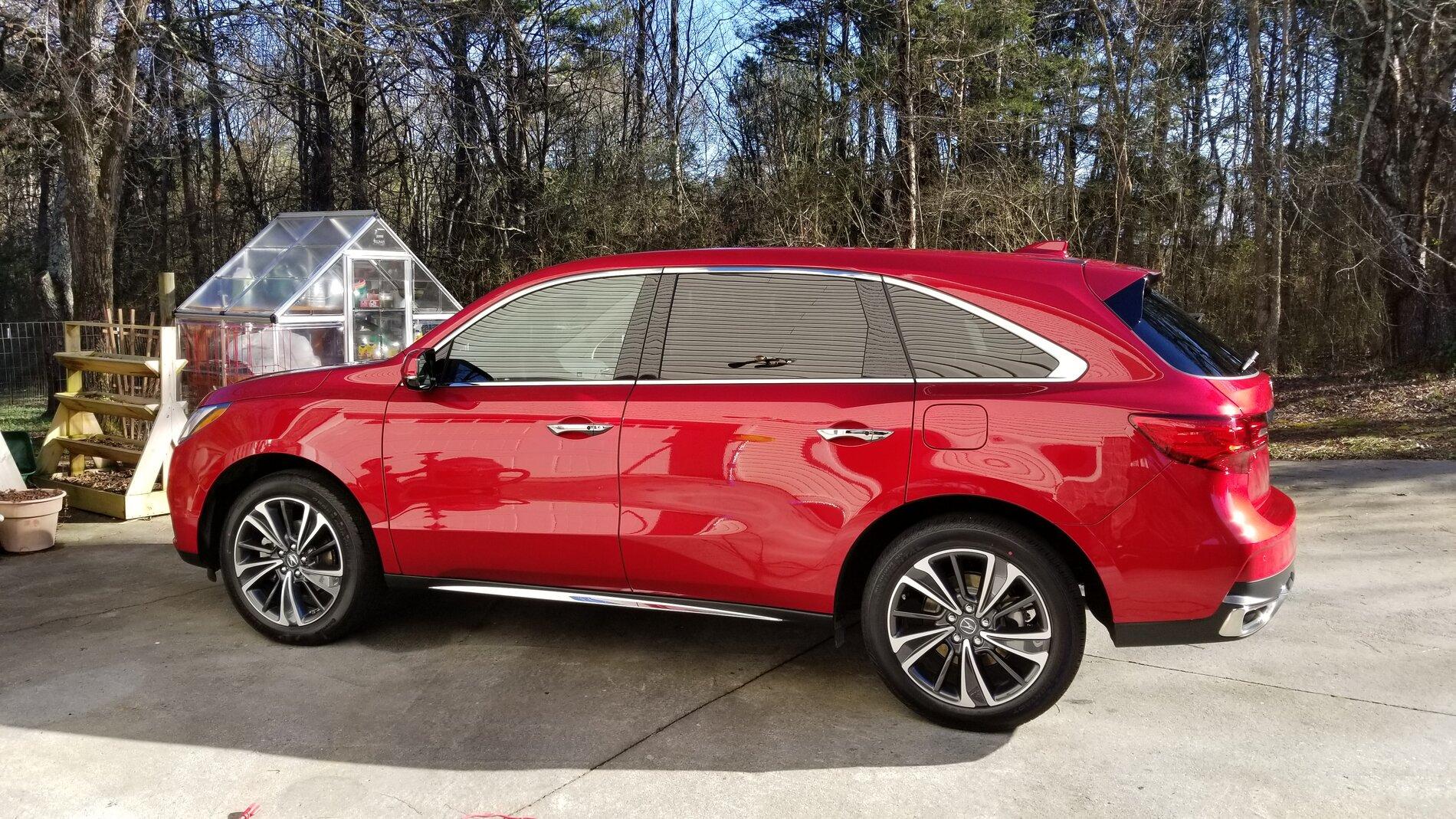

Wife got a new 2020 Acura MDX in Performance Red Pearl. Foam bath, hand wash, synthetic clay, 303 polish with LC white pad, then laid the 303 Graphene on yesterday. We'll see how it does through springtime into summer.

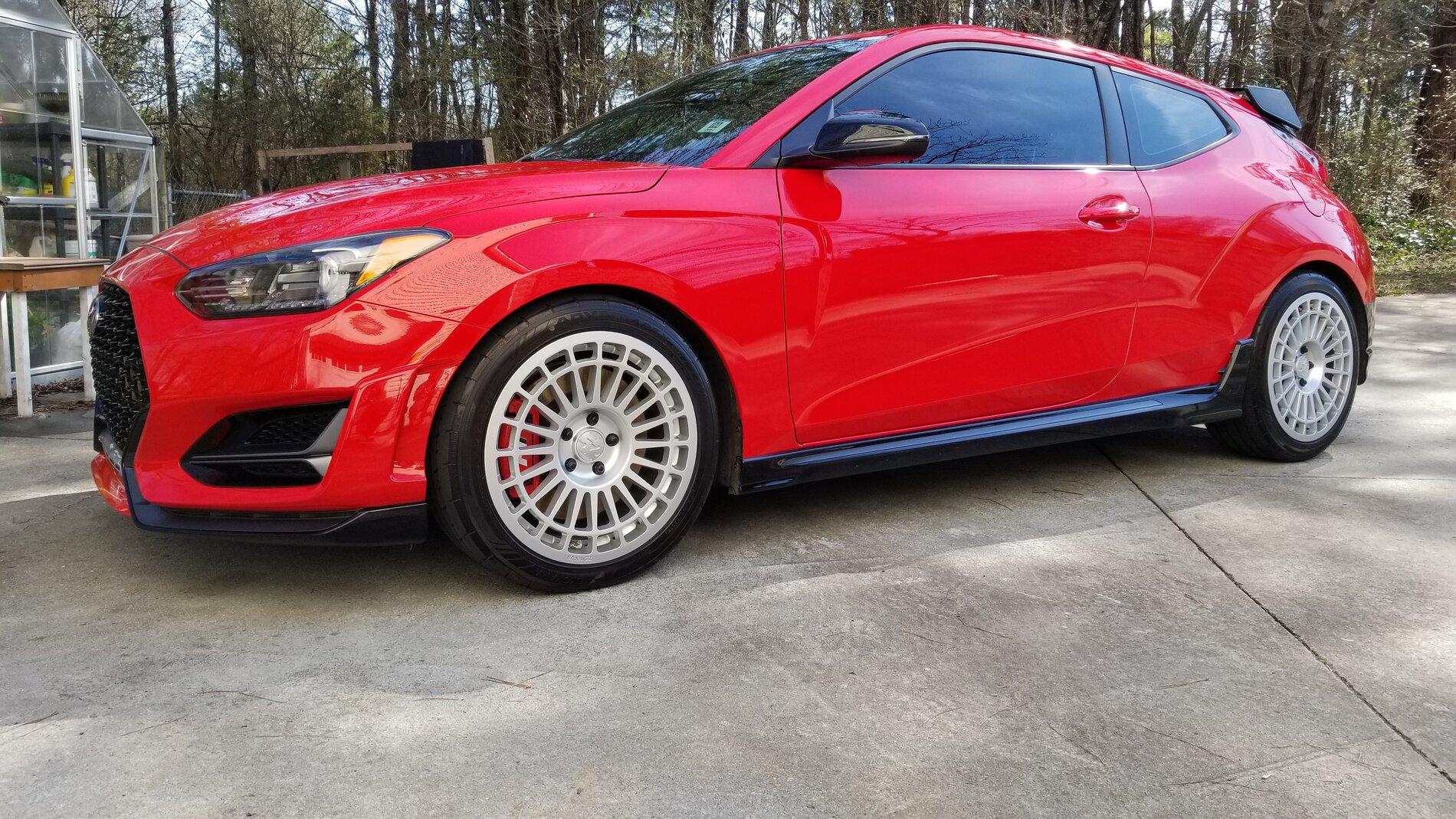

Recoated mine today. After I handwashed then clayed it made the old graphene coating seem to work a little better. Still polished and recoated. Hopefully the last time before it gets traded in for the Bronco.
