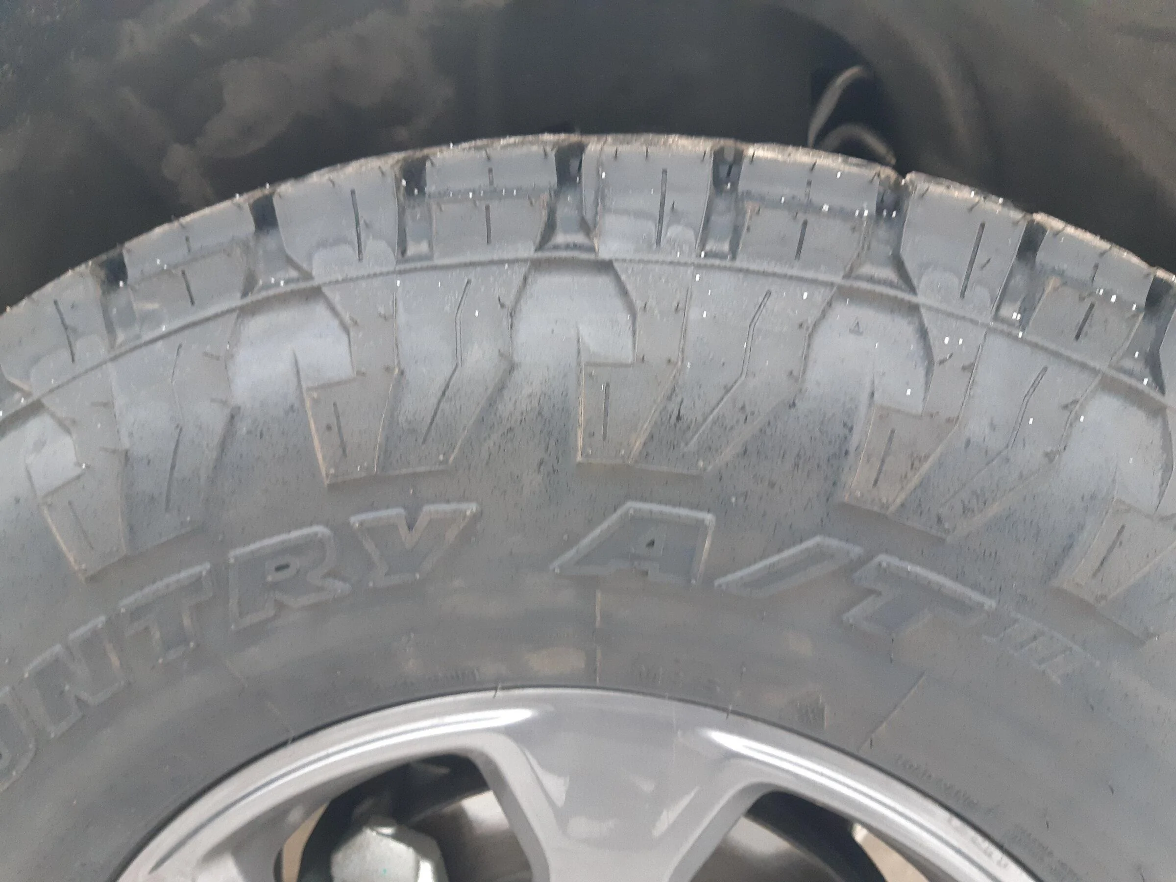

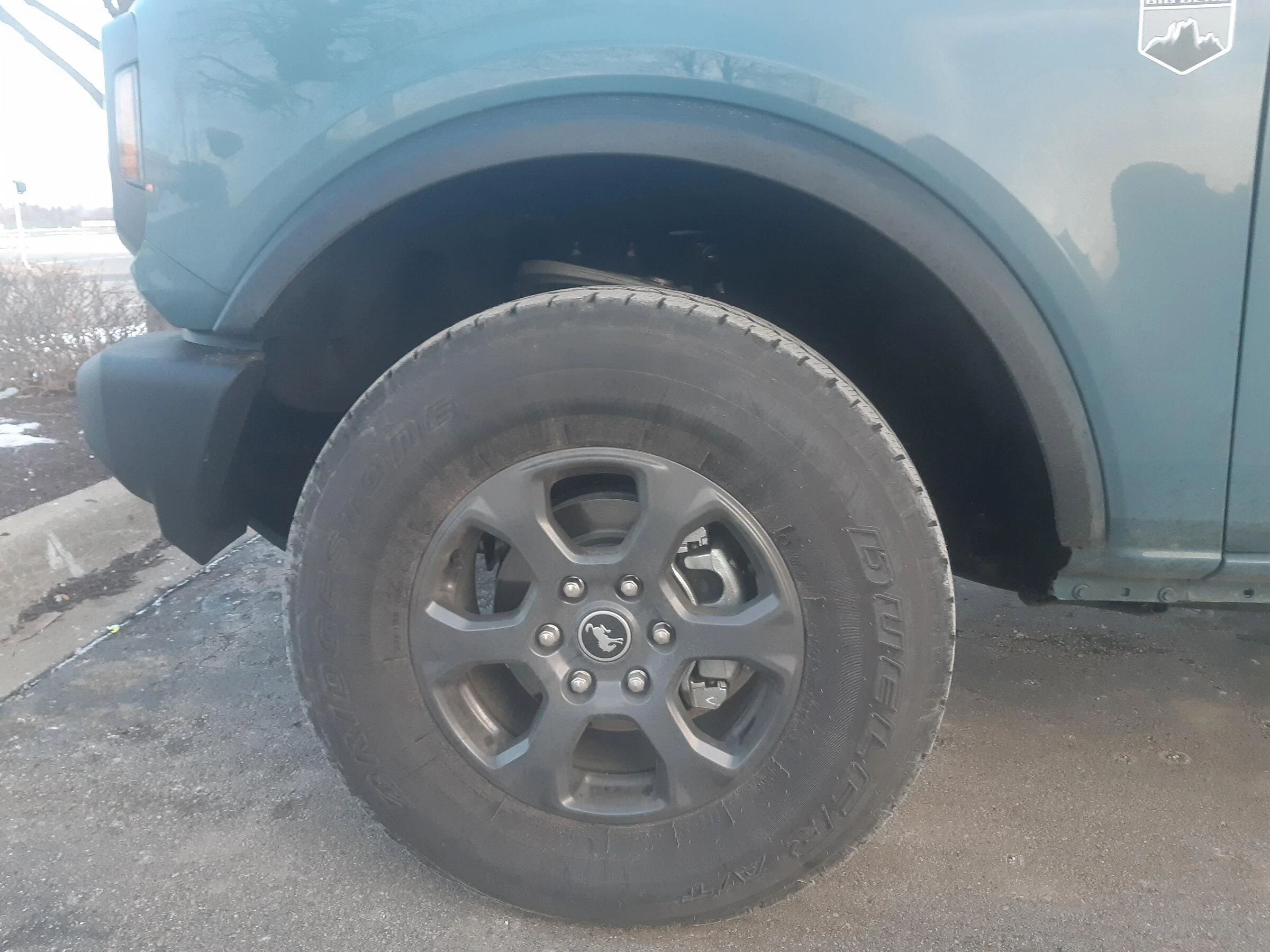

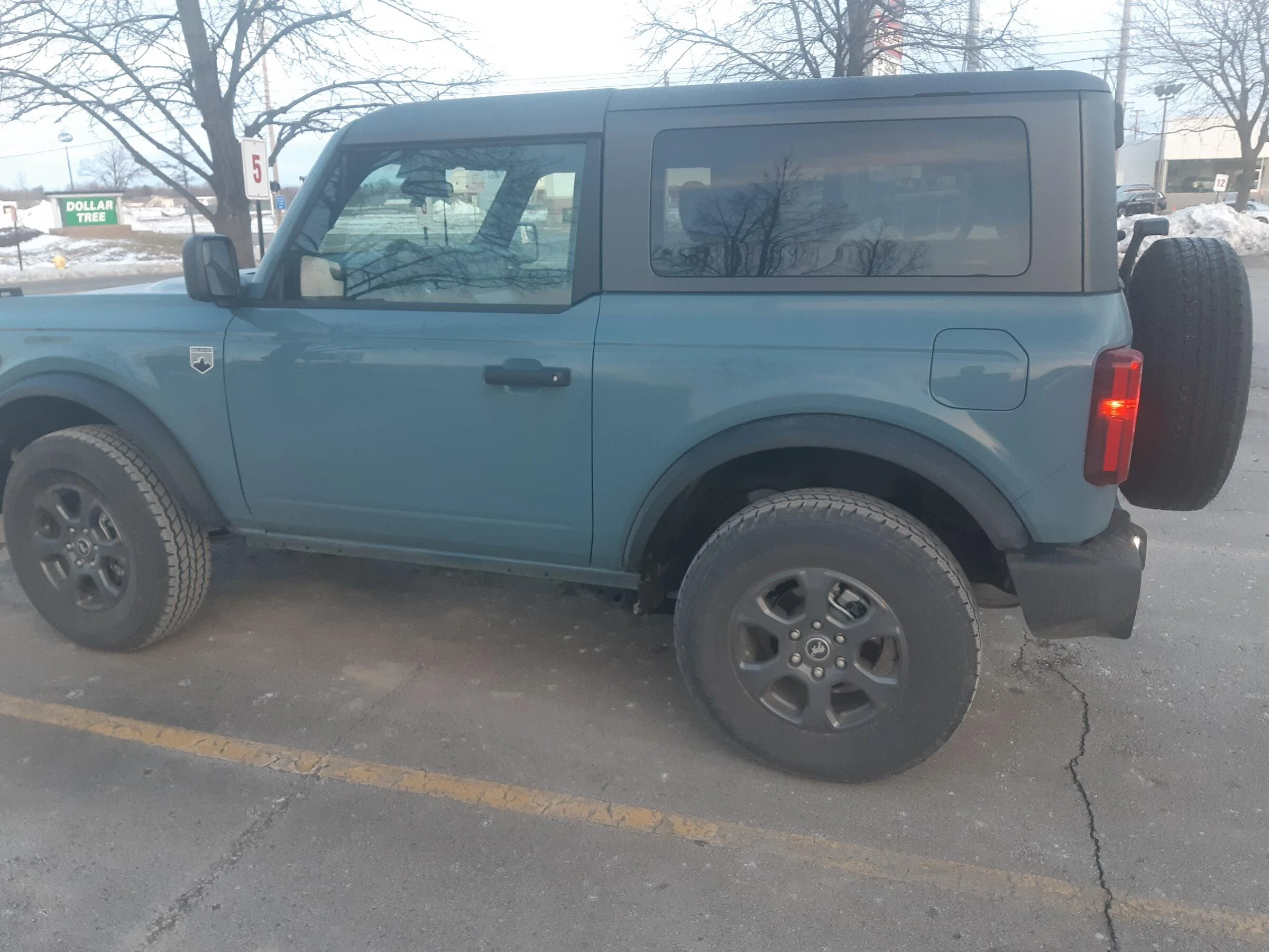

I swapped my stock 32' for 34' Open country AT3's (285/75r17).
I think they are a good middle ground between the stock badlands tires and the sasquatch set.
It was the only 34 I could find with load range "C". I had to remove the crash bars, no rubbing with the stock wheels. Really happy with the looks and performance.

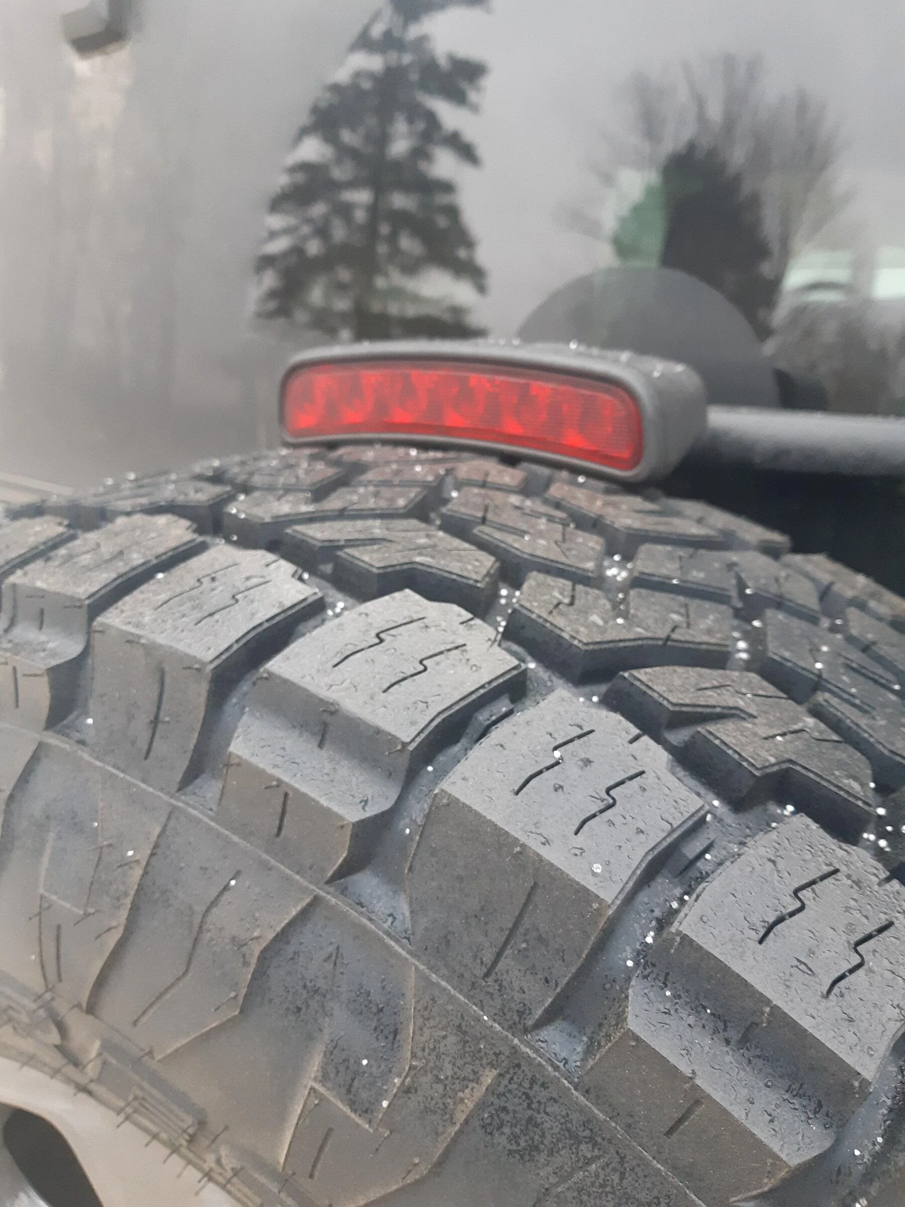

Can you see the 3rd brake light good enough with this tire mounted on back without having to extend it higher?

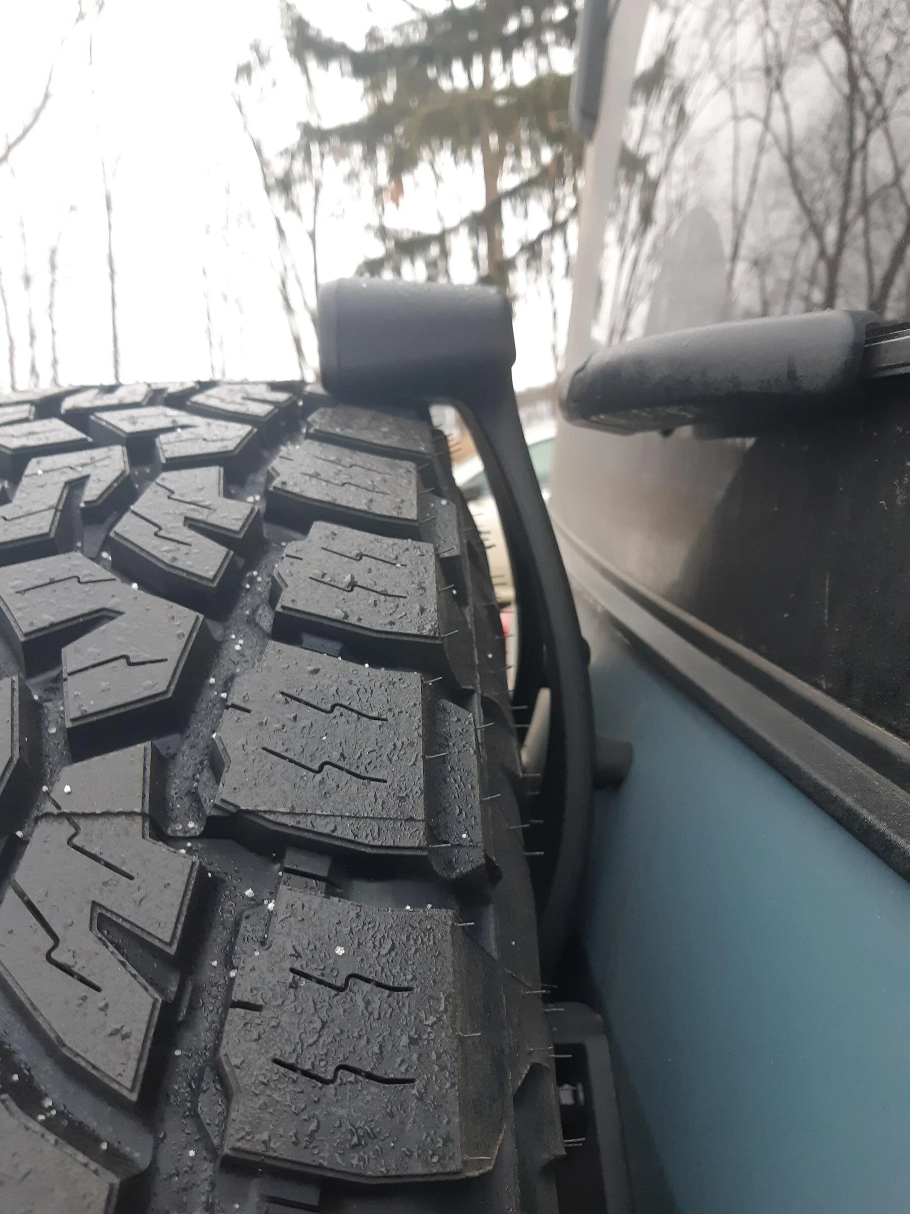

The 3rd brake light fits with the 34s but any bigger and you will either cover/bend the light or need an extender. (there must be a cheap DIY solution)

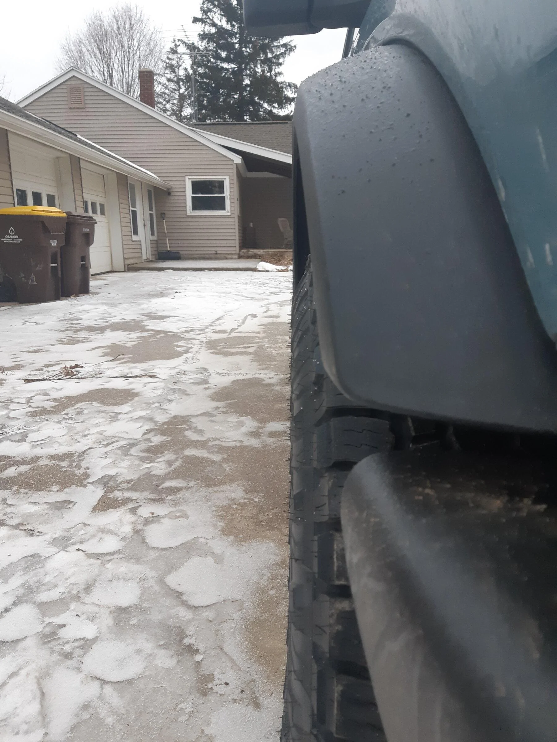

Here are some more pics of the brake light and the minimum poke on the flares.
Im sure 34" is the limit for the stock brake light.
