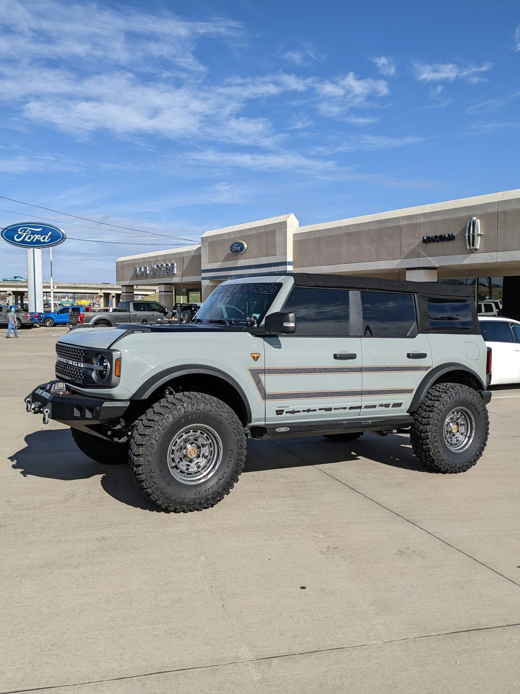

@BlueBronco is running 37's on a manual BL
Yep. Here is a gratuitous pic too.
Ford Bronco 37"s with 2.3L manual? PXL_20211230_185500172
The OP asked about the 2.3 being up to the task and I can confirm that it most definitely it. However, what is more important is having the correct gearing. As mentioned, mine is a manual BL with 4.7 gearing. I had initially thought I would need a taller gear but after the first time I drove it I realized the 4.7's handles the large tires just fine. And yes, that includes taking it off-road and over some fairly difficult and rocky trails. But, would, not recommend running 37's on any less of a gearing.

Yes, it’s a 2d manual Badlands, which comes with 4.7 gears. Should be ok then?

That’s just what I was hoping to hear. Looks great! How much lift, and what is the minimum lift I can safely do? (Starting at non-Squatch BL)

Mine is close to 3.5" of lift over base height (not BL height) using Dirt Logic 2.5" external reservoir coil overs.
How much lift and what you use to get there depends on your intended use.
