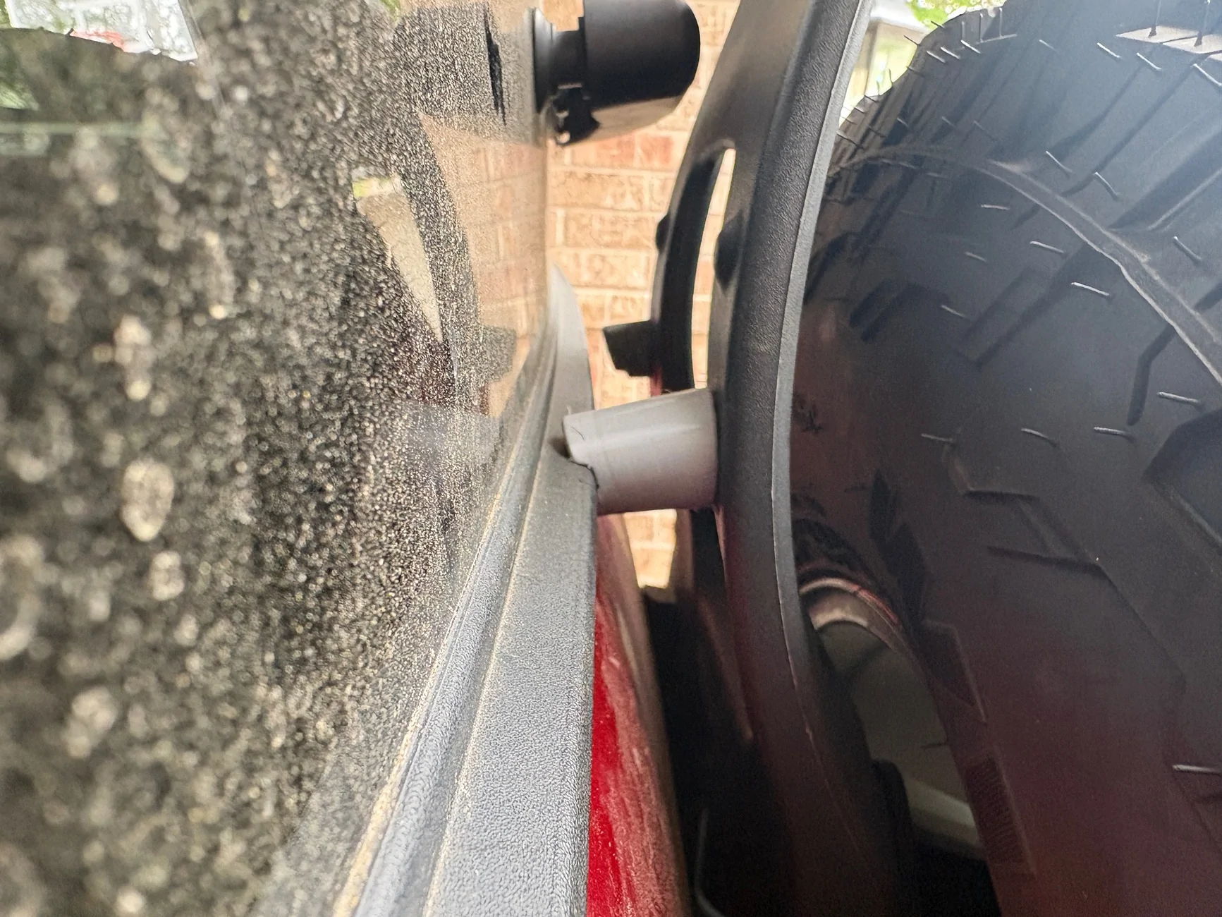

I installed a third brake light extension bracket to accommodate my 35" tires on my non-sas badlands. Moving the assembly up to clear the tire changed the location of the little rubber bumpers that normally rest on the tailgate. I designed a slip-on extension to extend that little bumper to mate with the new location (the ridge between the glass and the tailgate) (photo shows one with and one without my extension). It probably isn't necessary but might keep it from vibrating and perhaps leading to fatigue failure of that arm or wiring within it.
I printed it in TPU so it's a bit "squishy"
