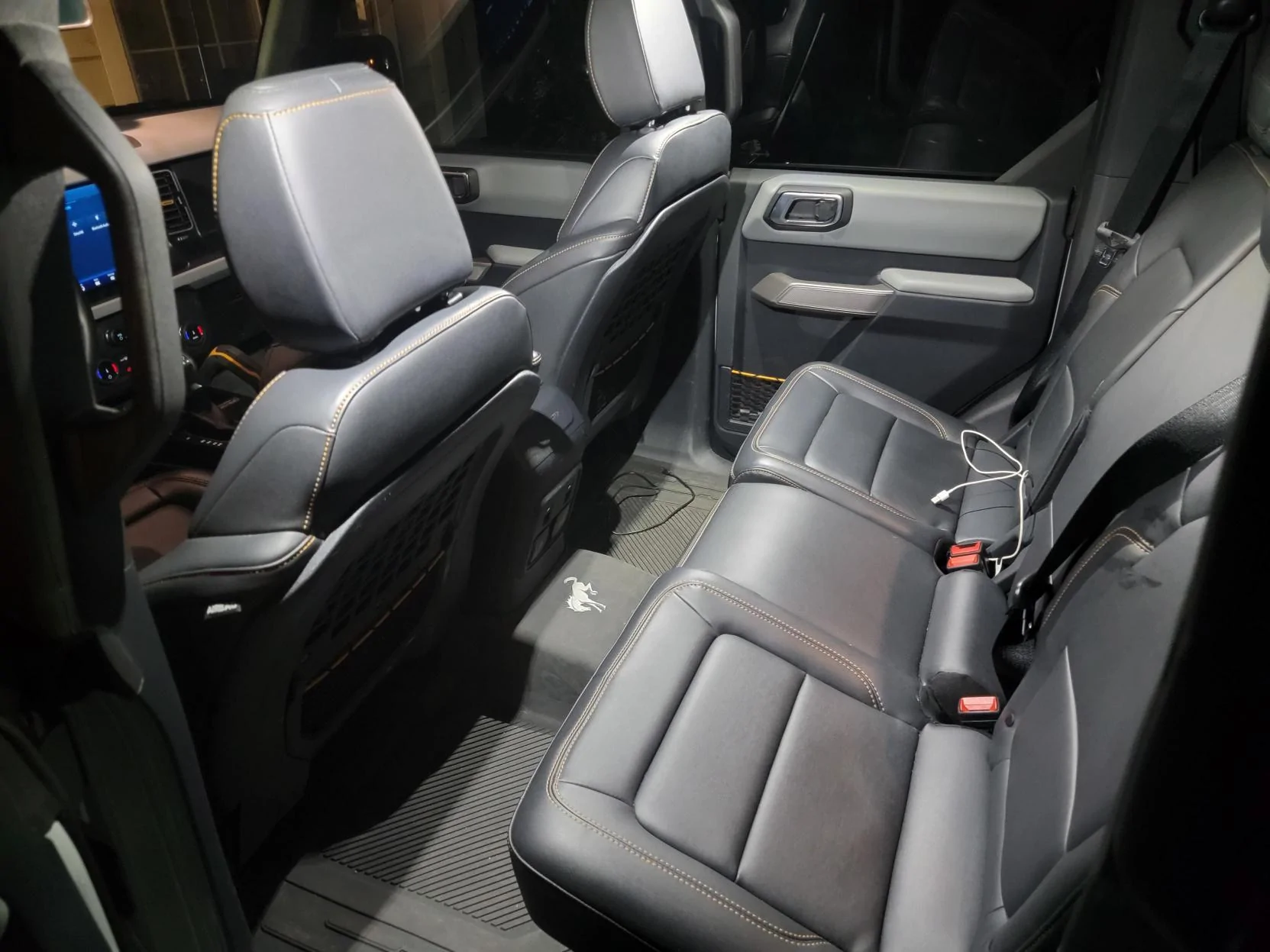

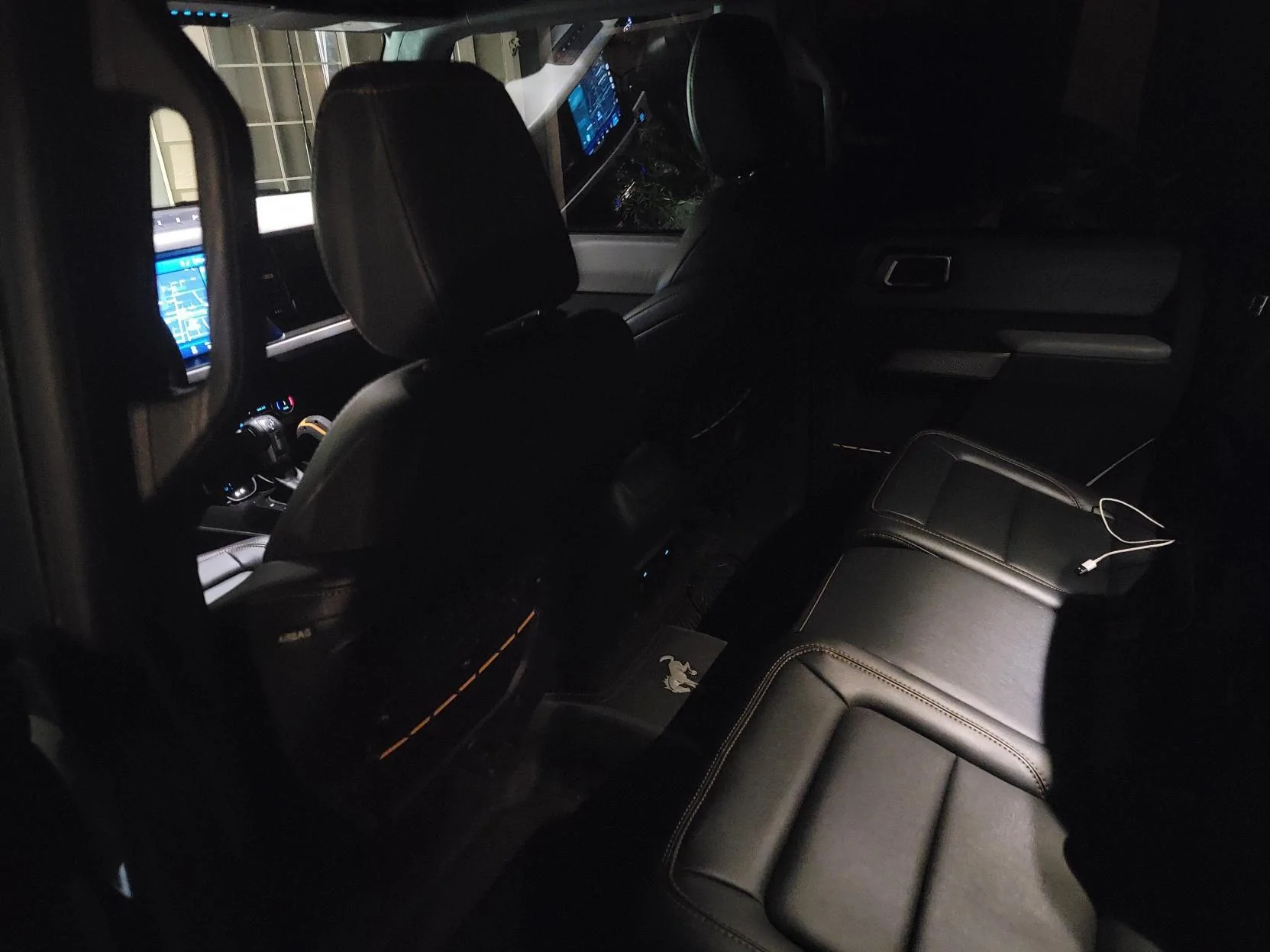

It came to my attention that my daughters could not see to buckle their seat belt do to the lack of light in the back of the Bronco. More light in the back was definitely needed; so I decided to design some mounts to hold rock lights I bought on Amazon. Just two lights were definitely enough. These are so bright my wife and I started laughing the first time I turned them on.
Stock Dome Light:

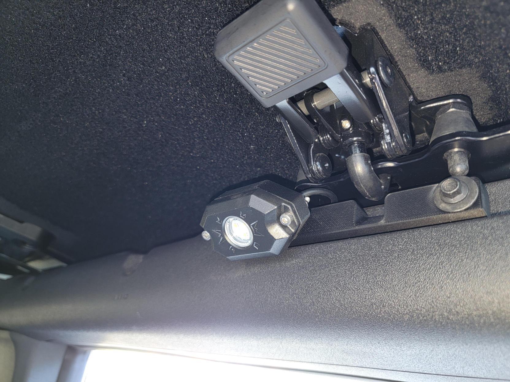

3D Printed Rock Light Mounts:
Ford Bronco 3D Printed Dome Light Mounts MicrosoftTeams-image (5)
Ford Bronco 3D Printed Dome Light Mounts MicrosoftTeams-image (6)
These are wired to AUX switch 6. I didn't need these things coming on every time I opened the door. If anyone is interested in the files to print themselves let me know. I'm accepting $5 donations just PM me.

Just don’t print them in PLA they will melt when it gets hot in the car. ASA is best for this application.
