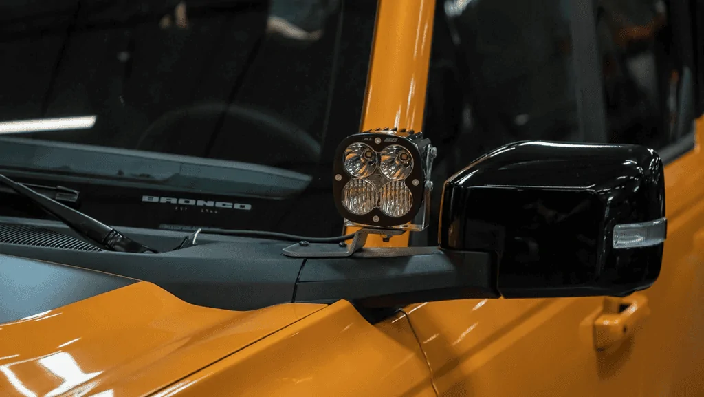

Adam,
Can you take a picture of your mounting plate both the videos you posted from Baja designs do not have that plate. Alsoo are you able to sell the plate seperate?
Thanks

Baja Designs does not sell their brackets/plates separate. You don't need their off-set mount unless you are running XL Series.

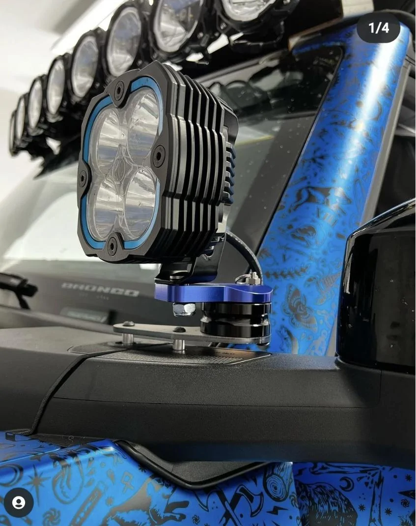

I'm not a fan on how the 2 bolts are holding that plate in the air although the mount does look cool.
I own the bronco in pic and can say its very sturdy - you have more options with riser bolt plate to flip turn left right inside outside before even mounting the swivel , gives endless mounting options - other than a fixed bracket mount wont have that freedom.

I really like these BAM mounts, need the swivel plus the bracket, spendy, but look sharp
https://juggernautpower.com/products/bam-swivel-mounts-universal?variant=41018457981110
I like where they were going with this and the quality of the parts. But I can tell just by looking at that photo, those lights are bouncing all over the place. Too many raised up support areas for the light to bounce around/flex on.
For my $$, having them bolted right to the mirror support is the best option. You have the most surface area and nothing extended in the area to flex. Baja Designs provides their off-set mount for XL Series so that they don't hit your antenna, but that's a flat piece of steel that sits flat, so no flex.

Well, good insight, and I do trust your opinion. (y)
