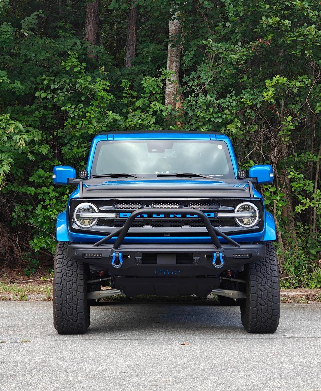

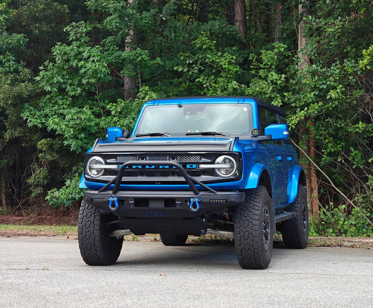

Yesterday I installed my much anticipated 4wp front bumper. I wanted to make a thread and give a proper shout out to Boss 4x4 @Boss Broncos whom I purchased from. Great company. Not only did they price match/adjust the bumper's price to be lower than where I had found it elsewhere... but when FedEx lost the first one, they sent out a new one as quickly as they were able. They took the extra step to utilize a different shipping method directly via the distributor to avoid another issue. They were also very quick to communicate with via email. It's always refreshing to work with companies that go the extra mile for their customers so I like to make sure they get a lil extra recognition when things are handled so well! Ya'll check em out!
Edit: For future reference if anyone is searching - the parking sensor brackets go opposite how I have them in these photos (sensor hole at top of bracket, angled upwards to be parallel with the ground instead of angled down). I have already fixed them but thanks to Boss Broncos for confirming this for me. There was limited data available and the directions sucked so I wasnt sure at time of install. Corrected this and parking sensors work perfectly.
Ford Bronco 4wp Front Bumper from Boss4x4 IMG_20250725_205830
Ford Bronco 4wp Front Bumper from Boss4x4 IMG_20250725_205657
Im going to be getting a paint pen to paint over the shiny silver mounting bolts that you can see in the winch plate mount/T openings.
I will update the thread with a photo of the front/360 degree camera intrusion from the bull bar later today. That is something I had tried to find before purchasing in case it helps others. It's visible but not as bad as I thought it would be, and tolerable.
Perfect option for going with a high clearance bumper without needing to go the extra step of cutting off the front crash bar mounts. They aren't visible enough to be an eye sore as they are on a lot of the other higher clearance options (one of the reasons I went with this one). Love the new look, huge improvement over the plastic bumper.

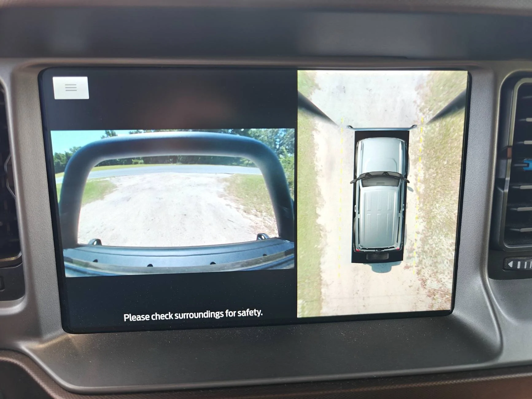

For anyone curious, this shows the intrusion of the bull bar with the factory 360 camera setup.

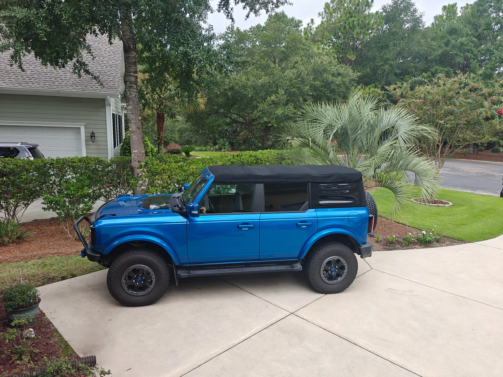

@Jazer I'm thininking of getting this bumper for my bronco. Do you happen to have any pics from the side you can post. I'm wanting to see how far the bull bar sticks out from the grill. Also, it looks like you were able to keep the factory tow hooks, is that correct?

The Bull bar looks great, imo. I was worried about that at first too but found i actually prefer it to the ones that are right up against the grill. I asked the same question in someone else's 4wp bumper thread and they did provide a side shot if you can do a search and find it.
This is the only pic I have atm and the angle isn't great nor shows it properly. The B is in the garage right now or id get a new one. I'll try to remember tomorrow.
Ford Bronco 4wp Front Bumper from Boss4x4 1000003157
As for the tow hooks. I removed my RC conversion brackets and put the stock tow rings back on with the 4wp bumper and 4wp skid. They were designed with this in mind, so there is a slight gap that fits the stock tow rings perfectly.
