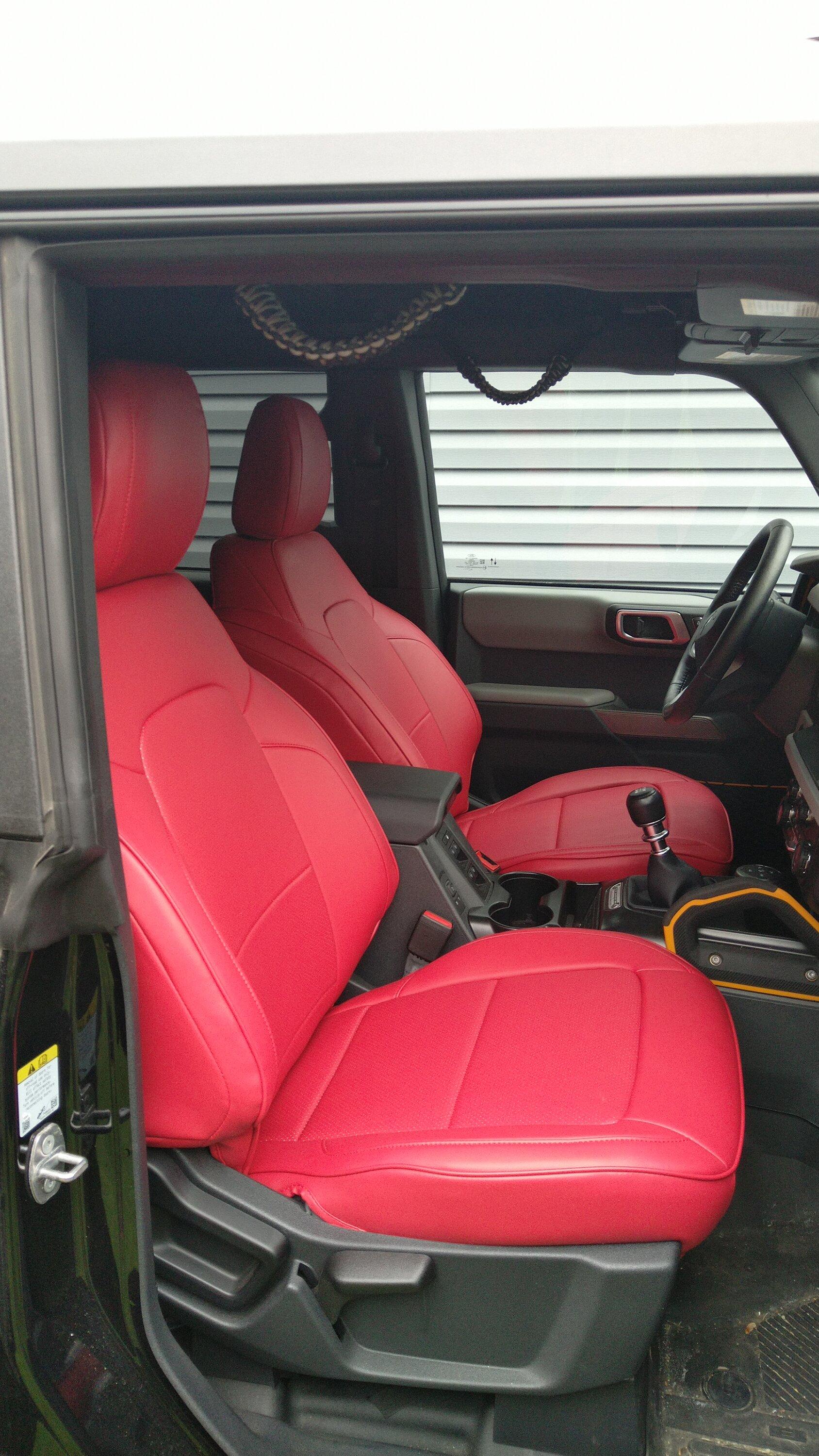

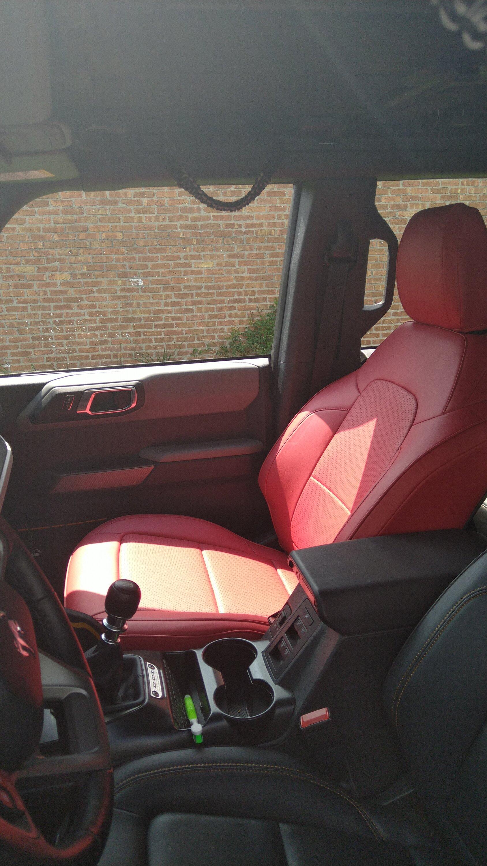

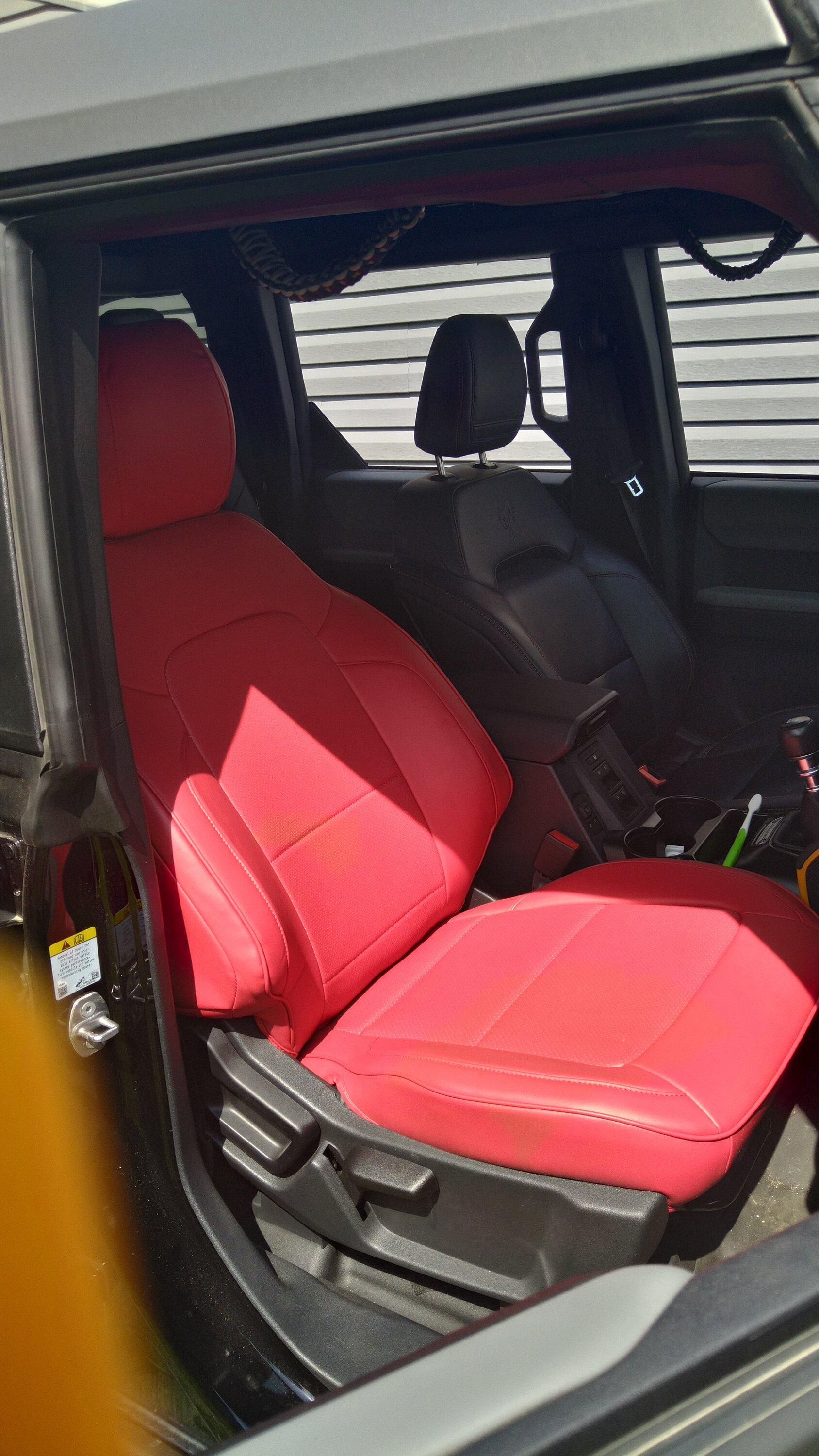

I started with the front seats, specifically the bottom covers. They went on easily and fit more tightly, and ended up being extremely convincing as stock equipment. The top covers look just as good, as do the headrest covers. The overall tight fit means it takes some patience to install the front covers, but wow they're great (and the perforations aren't bad either).
The front bottoms are secured with two tension straps, and two elastic loops which hook together. The front seatback covers use a retention strap at the bottom rear of the cover, along with three disc clips on three elastic loops. The retention strap requires removing the front seatbacks, in my case my BL has the Molle covers, or you could use a snake like a bent hanger to pull one strap to clip into the other. You push the disc clips through until they can be set flat against the inside of the seat, it tensions the loops to hold the cover in place.

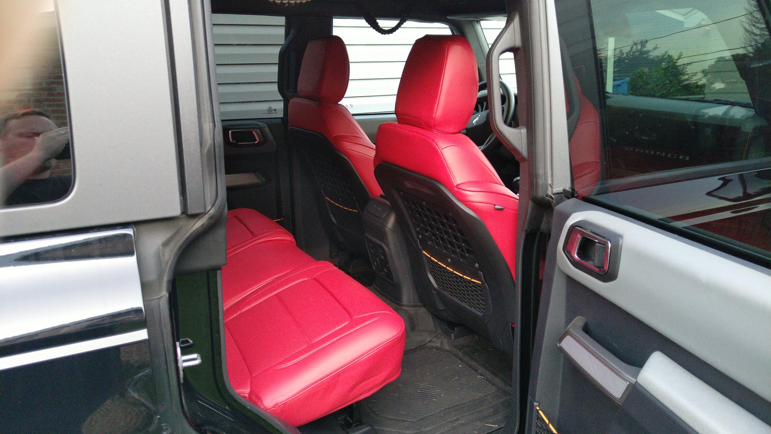

Rear: two seat bottoms, two seat tops, three head rest covers

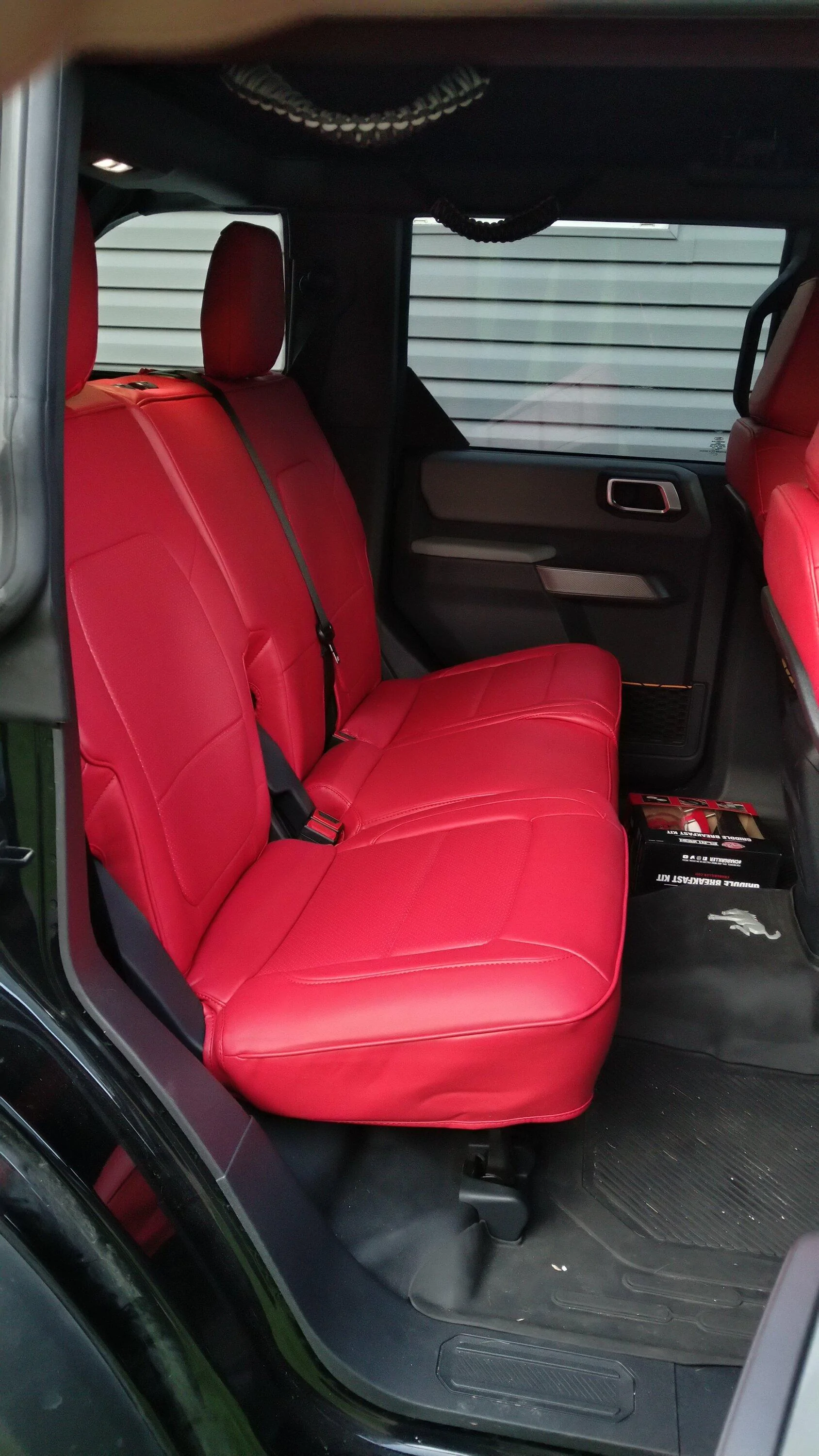

The rear bottoms work very similarly to the front, with the same tension straps and hooks. The rear seat upper covers are easier than the front, since you just get them on and zip them up to finish the job.
I'd rate this as a 9.5/10, and its mostly in the details. I wish there was some kind of drawstring in the bottom edge of the rear bottom covers, so I could draw them a bit tighter. I'd love to have the rear upper covers' zippers in the seatback split, so they are both hidden. If the front seat bottom seams were brought down another 2 inches for a complete tuck around the hinge area, literally no one would be able to tell these are covers instead of OEM equipment. I'll probably have to ditch the orange BL accents, not sure with what.

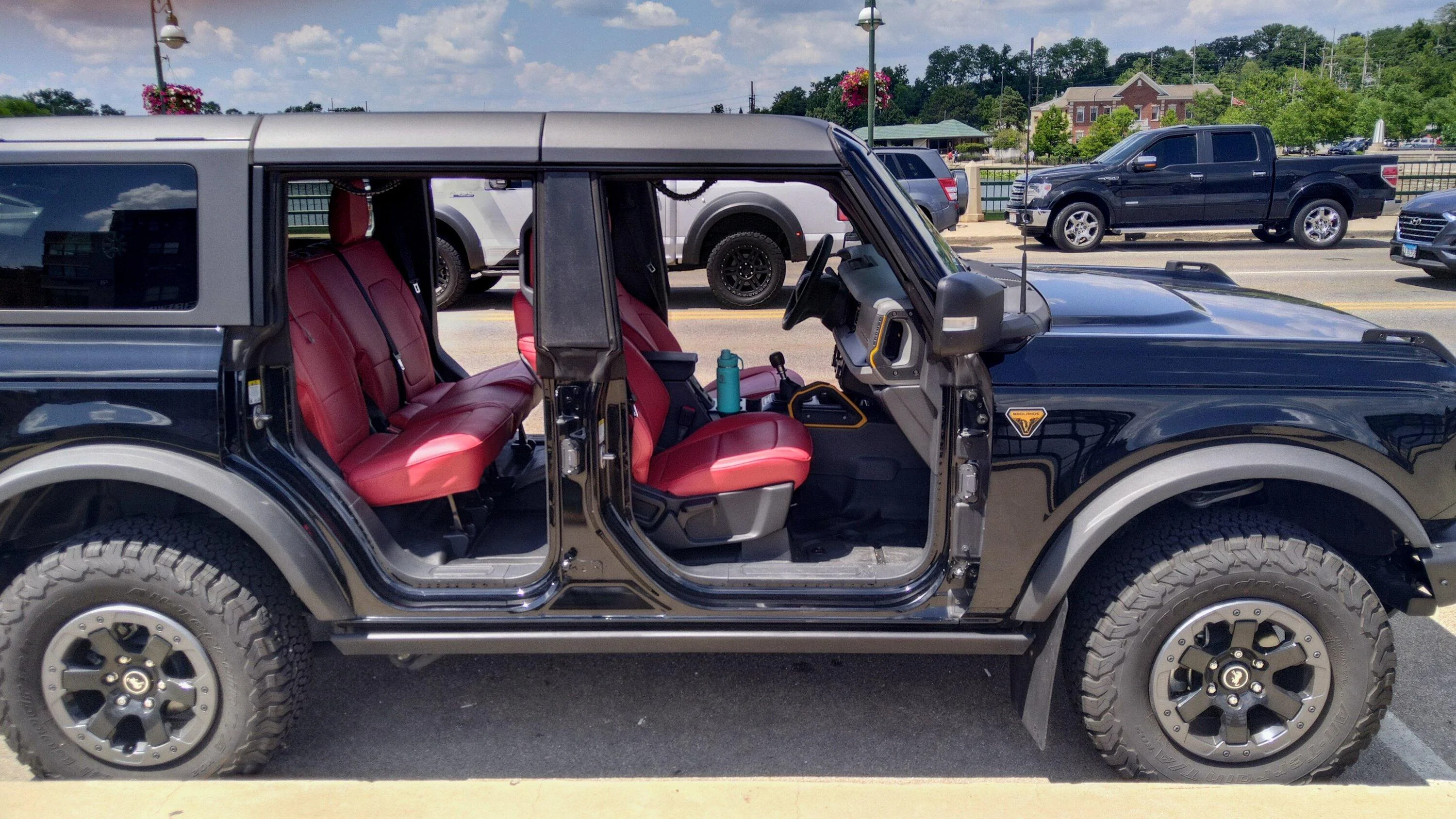

Anyway, here are pics, bonus first time with the doors off for the last one!
Ford Bronco I finally went for it: IAG Red Seat Cover Kit review IMG_20230707_152821
Ford Bronco I finally went for it: IAG Red Seat Cover Kit review IMG_20230707_152807
Ford Bronco I finally went for it: IAG Red Seat Cover Kit review IMG_20230707_180340
Ford Bronco I finally went for it: IAG Red Seat Cover Kit review IMG_20230708_200506
Ford Bronco I finally went for it: IAG Red Seat Cover Kit review IMG_20230708_200526
Ford Bronco I finally went for it: IAG Red Seat Cover Kit review IMG_20230709_142446~2

Great writeup! I thought it would be too much red, but they actually look awesome in the doors-off picture
