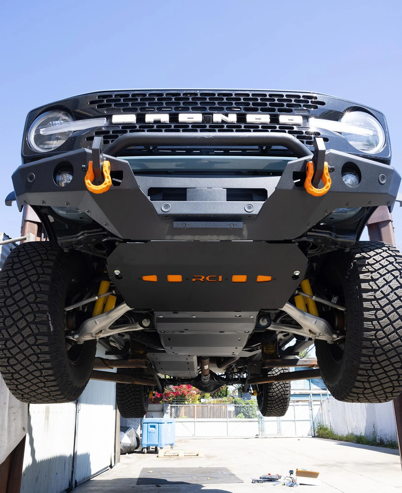

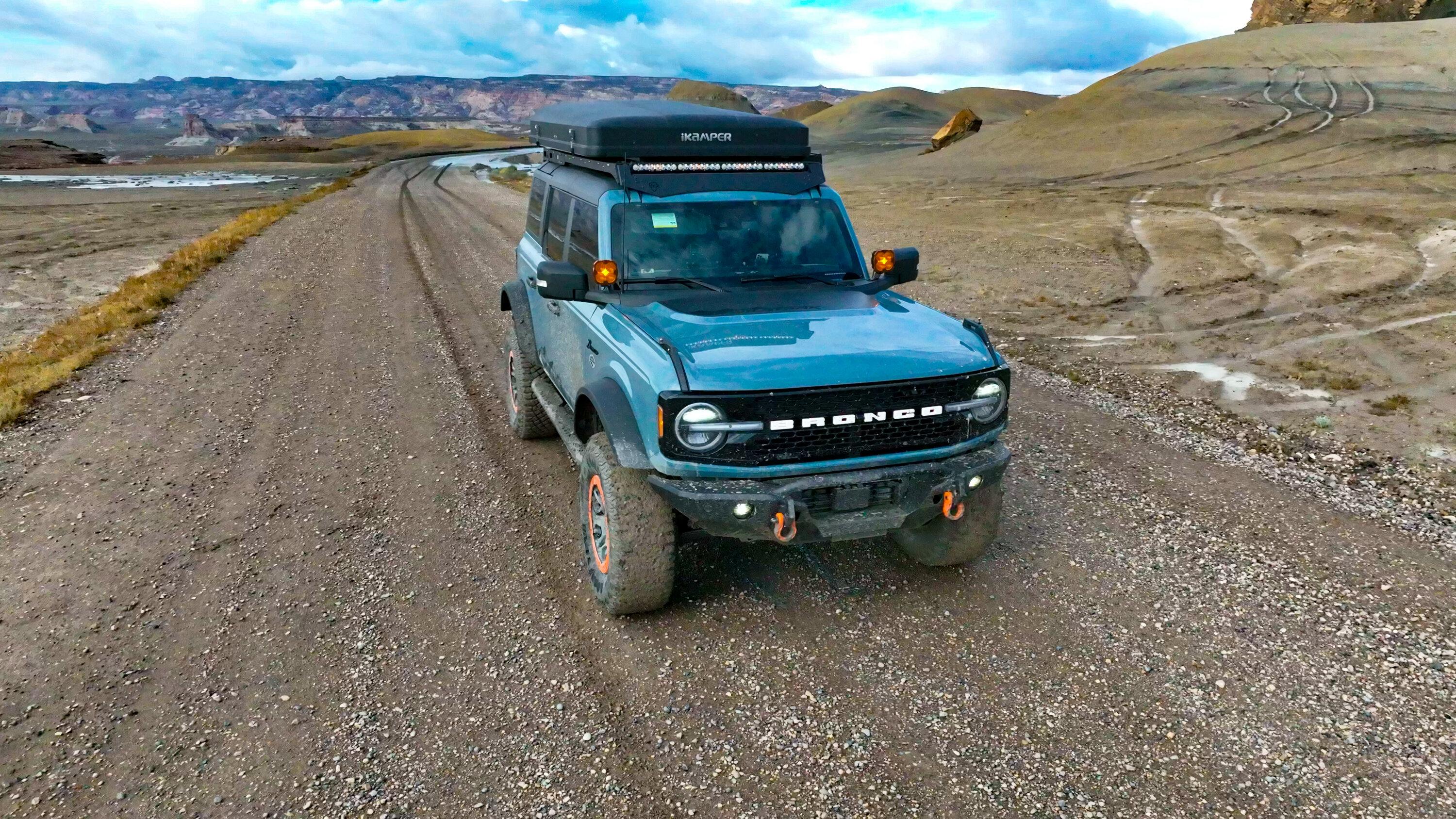

Greetings, everyone! I used to delay sharing my progress before and after, but now I've completed my project (although I might consider adding a winch later). Here's a list of all the modifications I've made:
  1. ORACLE Lighting Universal Illuminated LED Letter Badges - 232
  2. Havoc Offroad Steel Bender Front Bumper - 969
  3. Vanguard aluminium Rear bumper (Amazon) - 818
  4. Fuel Tank Skid Plate – 1/4" 5052 Aluminum – Black Powder Coat - 525
  5. Skid Plate Package – 1/4" 5052 Aluminum – Black Powder Coat - 1250

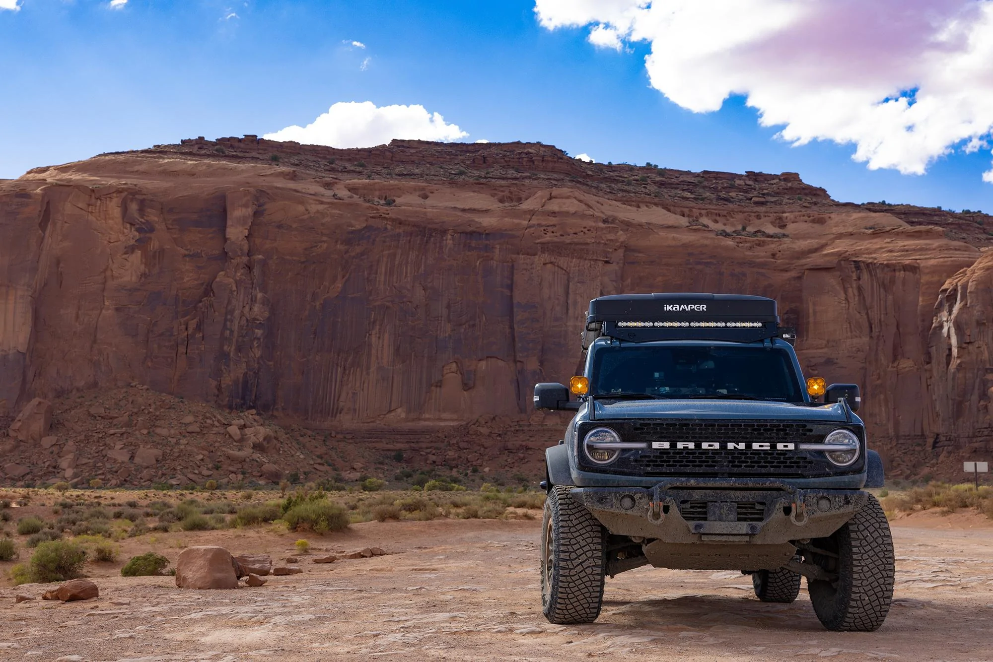

  16. iKamper Skycamp 3.0 - 4847
  17. iKamper Bracket Locks 3.0 - 96

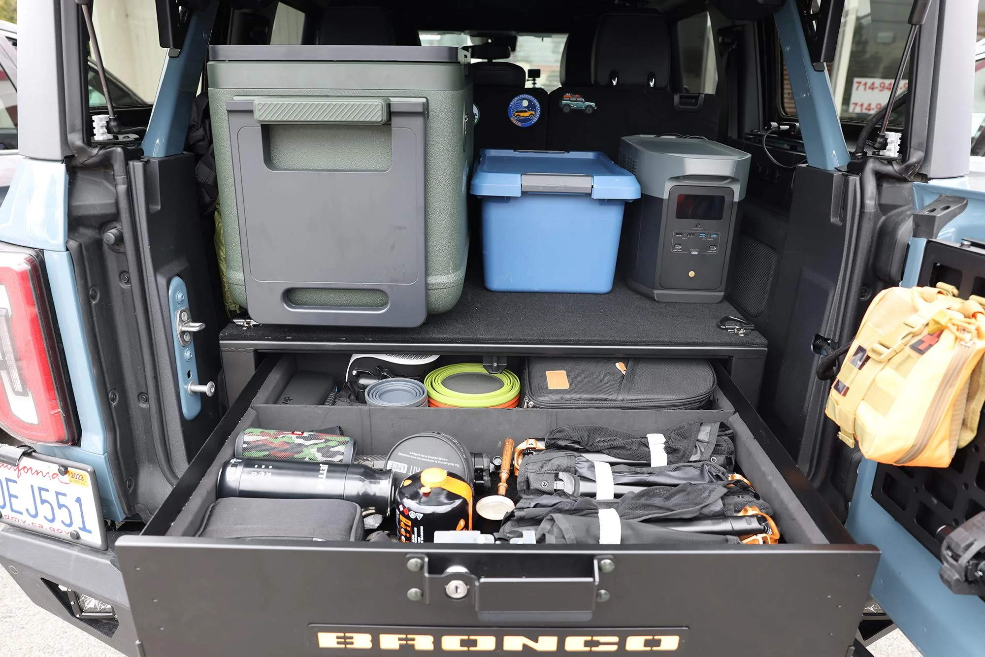

  31. BRONCO 4DR 2021-2023 CARGO AREA SECURITY DRAWER - 789
  32. Plywood and carpet mod for CARGO AREA SECURITY DRAWER made by me - 60

Question about the rotopax on the tailgate; can you open it full swing with the tanks on it or did you put the limiter on because it was hitting the fender? I plan to have a similar setup on my tailgate.

If you are planing to have 2 tanks than you have to get 90 degree limited tailgate strut , search for this (Hammer Built Limiting Tailgate Strut for 6th Gen Bronco), otherwise with 1 roto tank you can fully open the gate without limitation.
