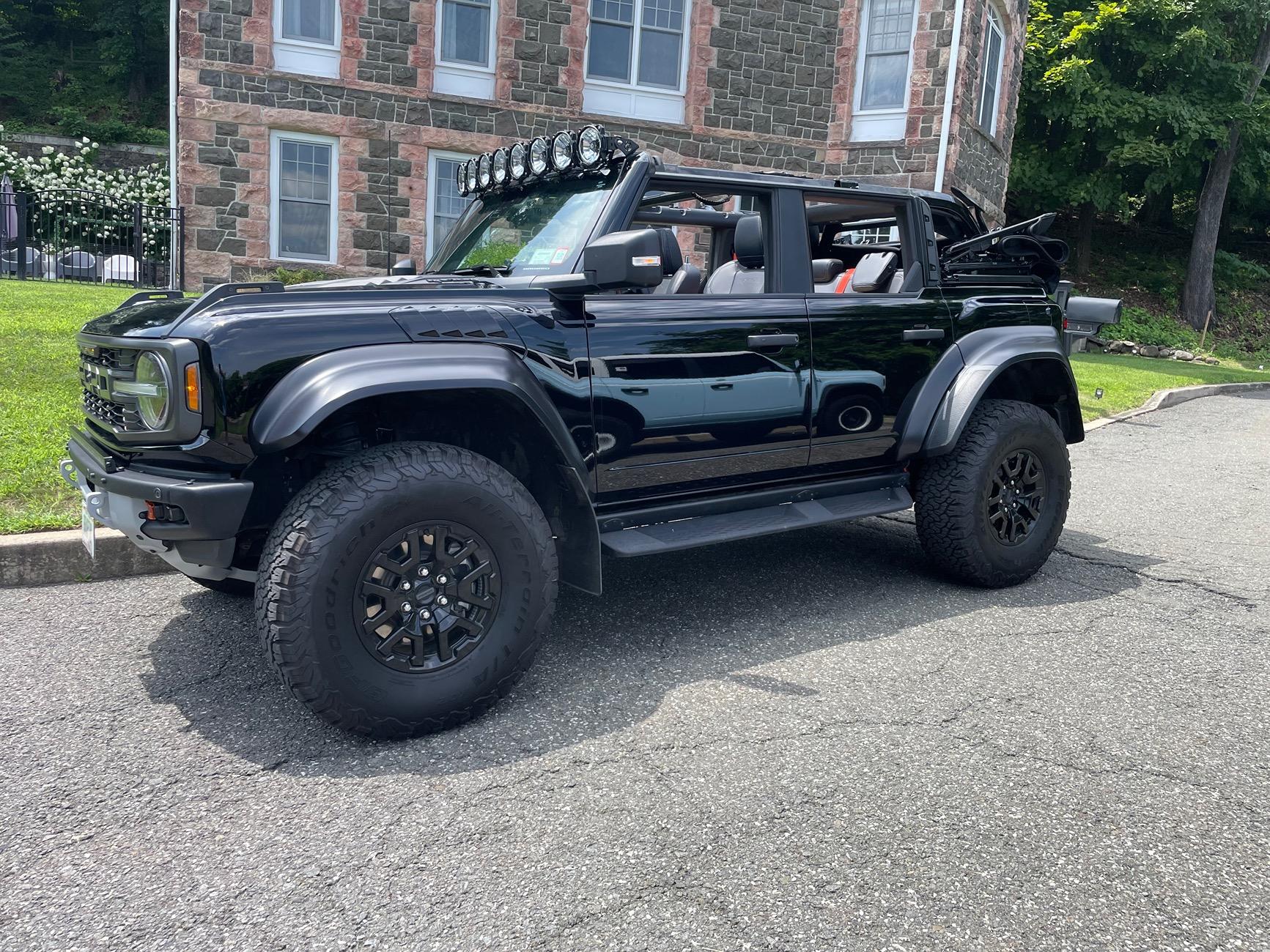

So this happened today.
Ford Bronco Braptor gets a soft top conversion IMG_7600

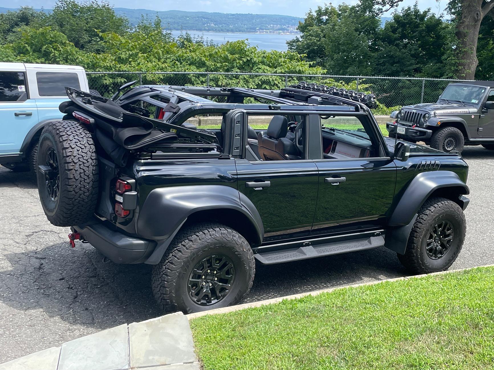

Ford Bronco Braptor gets a soft top conversion IMG_7613

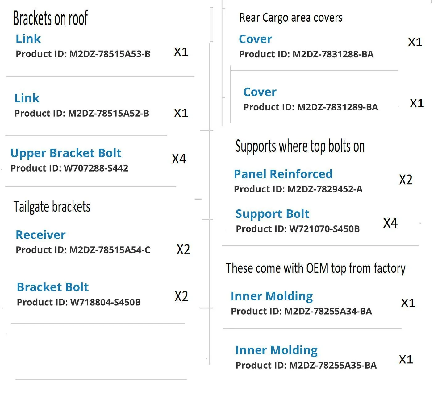

I purchased the soft top via FB Marketplace back in January. The seller was great until I contacted him 4 months later in April seeking the extra pieces that come pre-installed on Broncos with the Dual Top option (brackets on roof, tailgate brackets, Rear cargo area covers & Supports where the top bolts in) since he wouldn’t need these without the soft top that he sold me. He was a douche and refused to provide them to me even though I offered to pay for them and they should have been included in our initial transaction. I should have done more homework in advance but I thought since the soft top was on the original pallet, all the parts would be there. Lesson learned!
There is a very helpful thread about all things soft top (sorry, I don’t recall the exact title) that I pilfered the following list from:

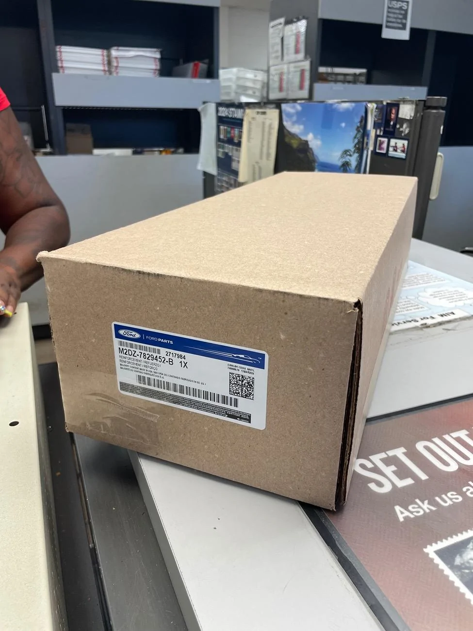

Ford has since changed part # for the Supports where the top bolts in and you only need to order 1 piece and not 2 since this is now a kit that has the 2 brackets, alignment tools, alignment pin & bolts) - p/n now ends in -B and here’s a picture of the box from Ford.
Ford Bronco Braptor gets a soft top conversion IMG_7584
FYI - I purchased the tailgate brackets from Mountains2Metal because the Ford part # is all fu@ked up in their system and the price was like $600+ for 2 small brackets.
