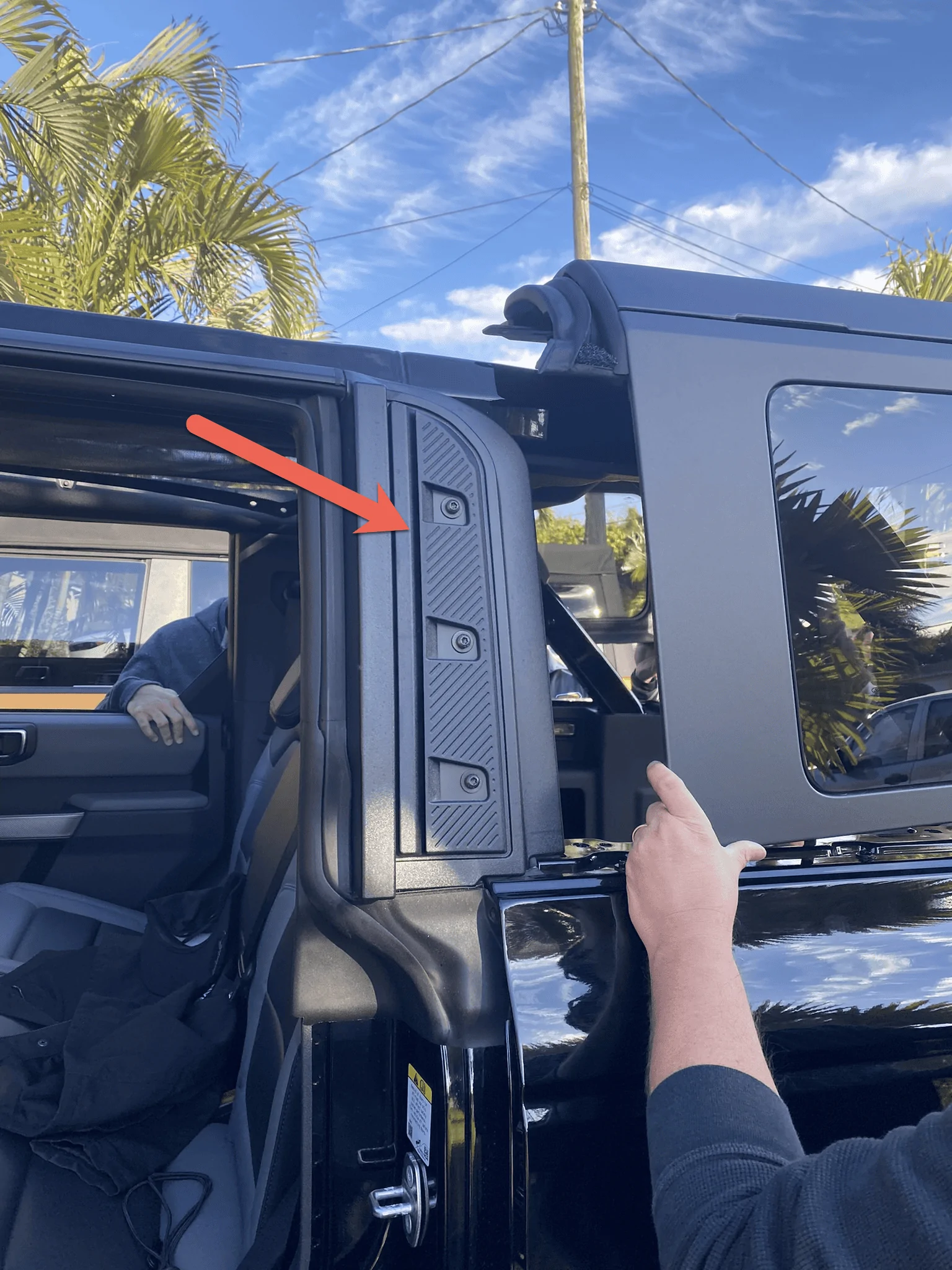

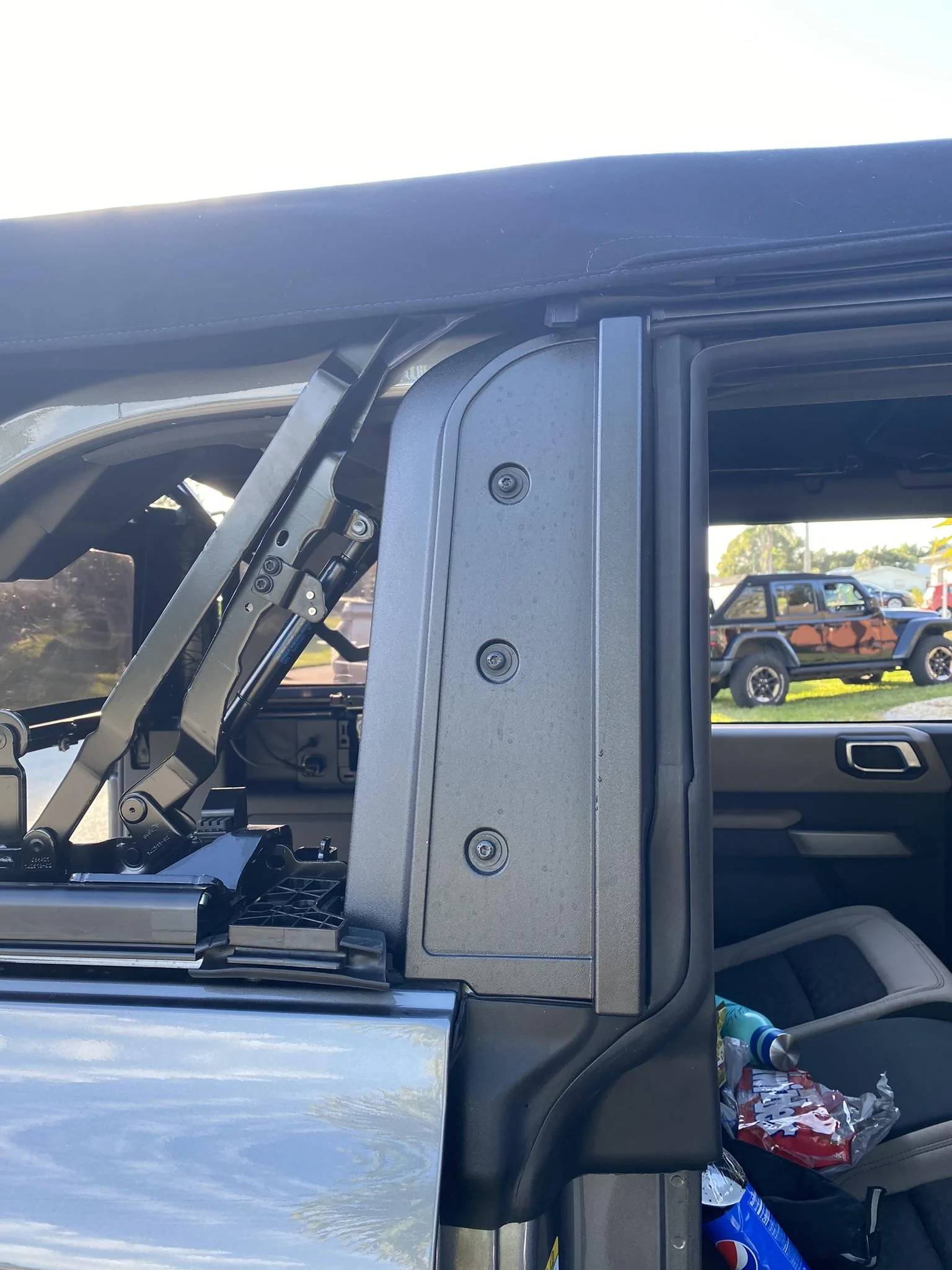

Soft Top Side Window Channels:
After swapping the tops and moving on to the victory lap of installing the side soft top windows, we realized that Ford does not include the front side window channel (shown below) brackets on the hard top models:
With window channel:
Ford Bronco Soft Top <--> Hard Top Swap : Tips & Lessons Learned - UPDATED 1643550060295
Without window channel (Note the @GearShade Jeep lurking in the background):
Ford Bronco Soft Top <--> Hard Top Swap : Tips & Lessons Learned - UPDATED DF87371C-3650-4C10-8745-A65359D17444_1_102_o
It is a simple 3 bolt swap for each bracket.
Ford Bronco Soft Top <--> Hard Top Swap : Tips & Lessons Learned - UPDATED AE955D2D-EB44-4E2A-B662-577C39C7D0ED_1_102_o
Ford Bronco Soft Top <--> Hard Top Swap : Tips & Lessons Learned - UPDATED 3D0B3464-94AE-4628-9121-53054D0DF8D1_1_102_o

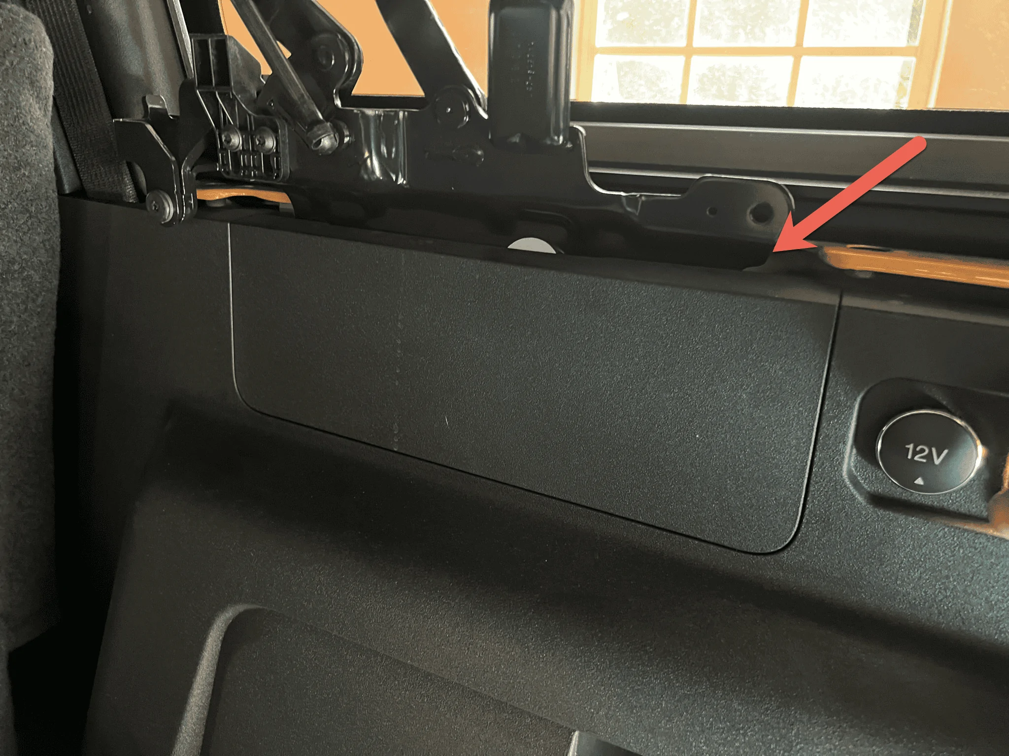

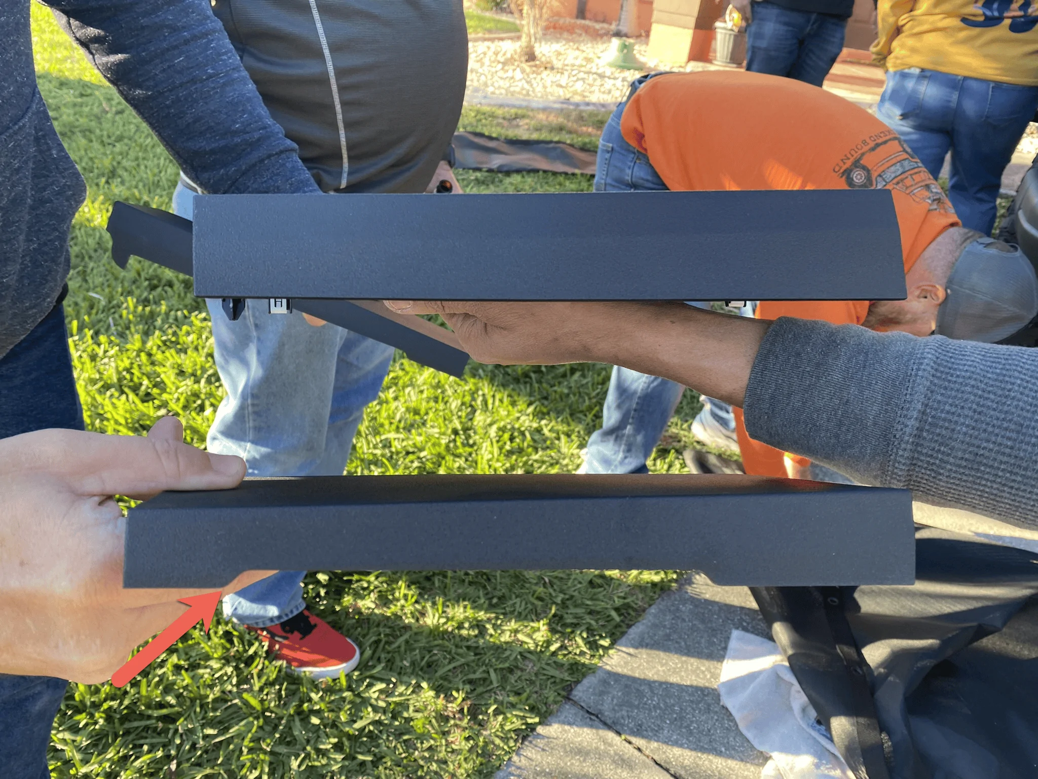

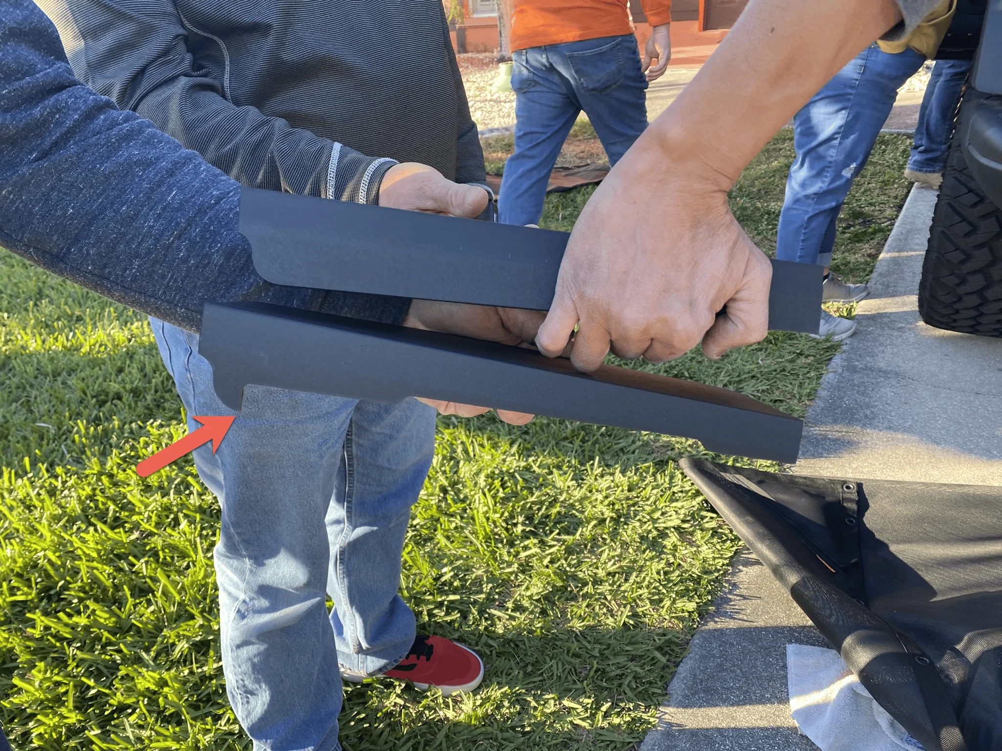

Rear Cargo Access Panel Covers:
The final step in the process was to reinstall the rear cargo access panels. When trying to reinstall the panels on the hard top donor, we could not get the panels to fit properly. That is when we noticed the panels are different between the models.
Notice the relief cuts on the bottom covers from the soft top:
Ford Bronco Soft Top <--> Hard Top Swap : Tips & Lessons Learned - UPDATED 1643552250976
Ford Bronco Soft Top <--> Hard Top Swap : Tips & Lessons Learned - UPDATED 1643552361910
The relief area is required for the soft top frame:
Ford Bronco Soft Top <--> Hard Top Swap : Tips & Lessons Learned - UPDATED 1643557317655

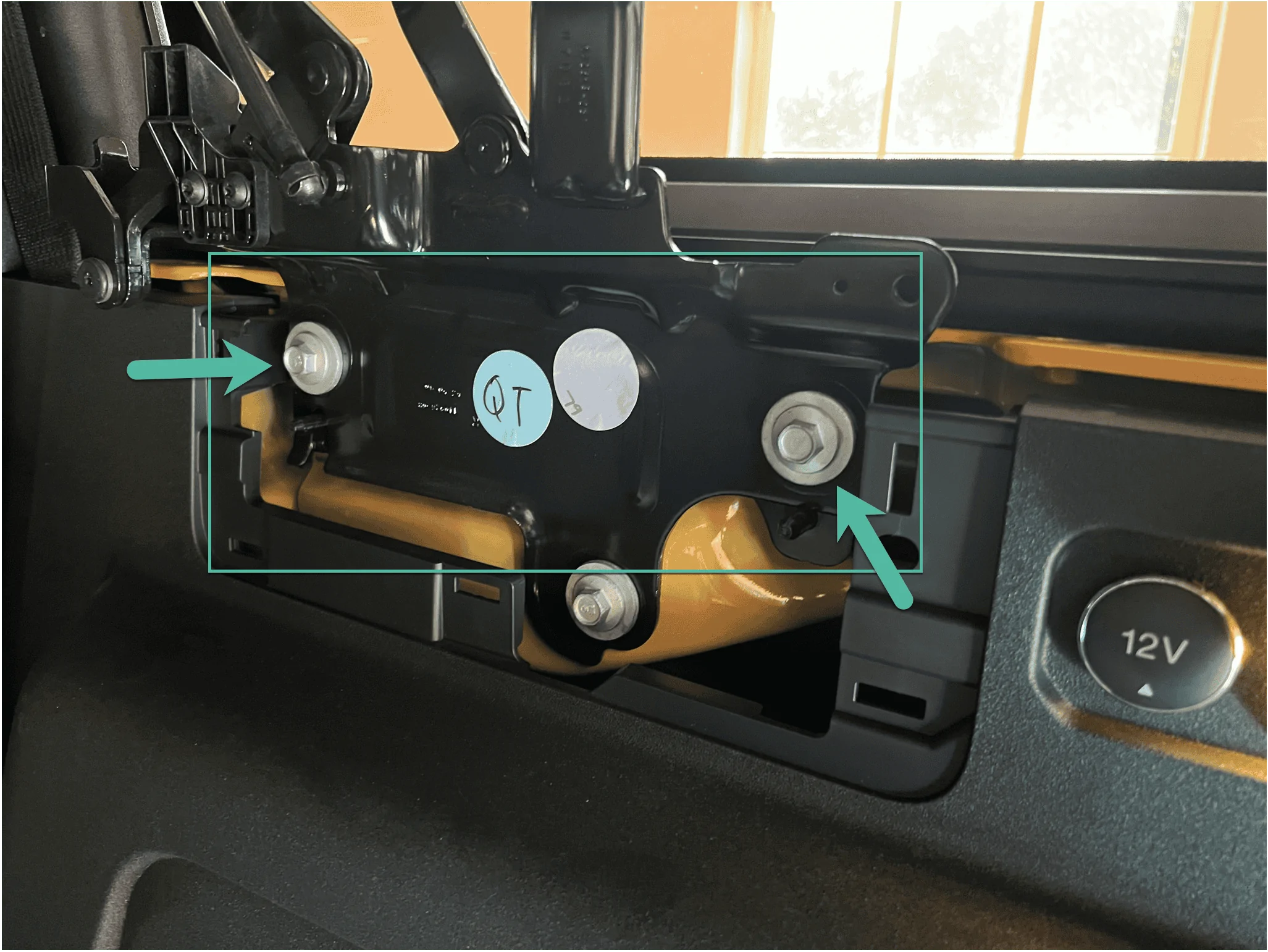

Frame Bolts and Bracket:
The 3 bolts highlighted were not included in the hard top as well as the bracket the top 2 bolts attached to:
Ford Bronco Soft Top <--> Hard Top Swap : Tips & Lessons Learned - UPDATED 1643556325827
Top bracket location (sorry no pic if the bracket itself):
Ford Bronco Soft Top <--> Hard Top Swap : Tips & Lessons Learned - UPDATED 1643556789697

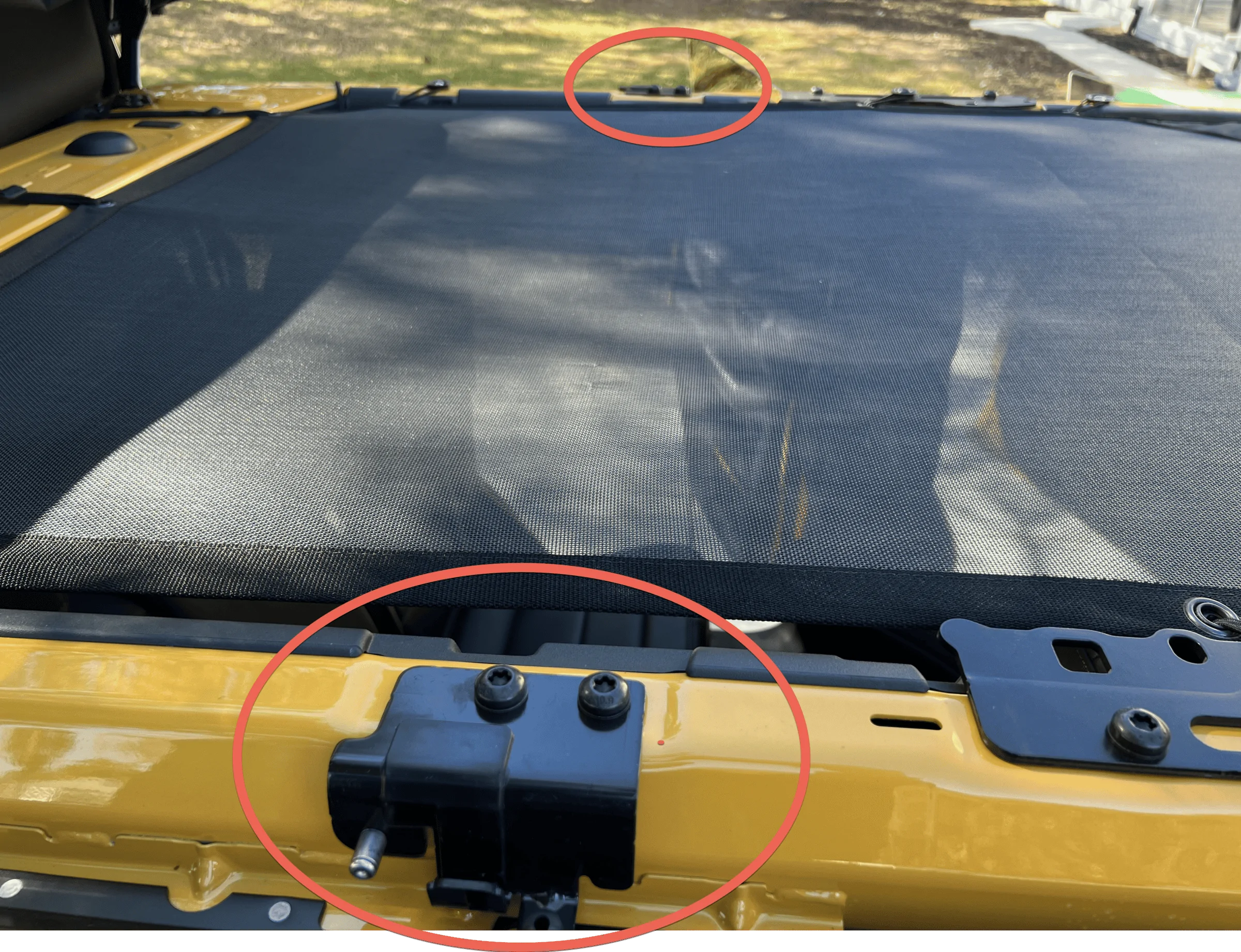

Roll Bar Brackets:
Both the brackets and the screws will need to be swapped over. These do require some adjustment. Our approach was pretty simple and seemed to be affective. We simply left the screws loose enough to allow for lateral bracket movement. We then closed top and adjusted the brackets to where the top latch and side silver post matched. It took a few ups and downs to get it set. In the end both brackets were pretty much adjusted to the rear as much as they would go.
Ford Bronco Soft Top <--> Hard Top Swap : Tips & Lessons Learned - UPDATED 1643574421640
Rear Latch Brackets:
The 2 rear latch brackets were the last items we needed to swap. They too needed some adjustment. Again we left them a bit loose, closed the top, let them latch and tightened accordingly.
Ford Bronco Soft Top <--> Hard Top Swap : Tips & Lessons Learned - UPDATED 1643574341394

Where is the rear cargo access panel? I canā€™t place it from just looking at the part.
Updated to include a pic of the location as well well as some additional items.
