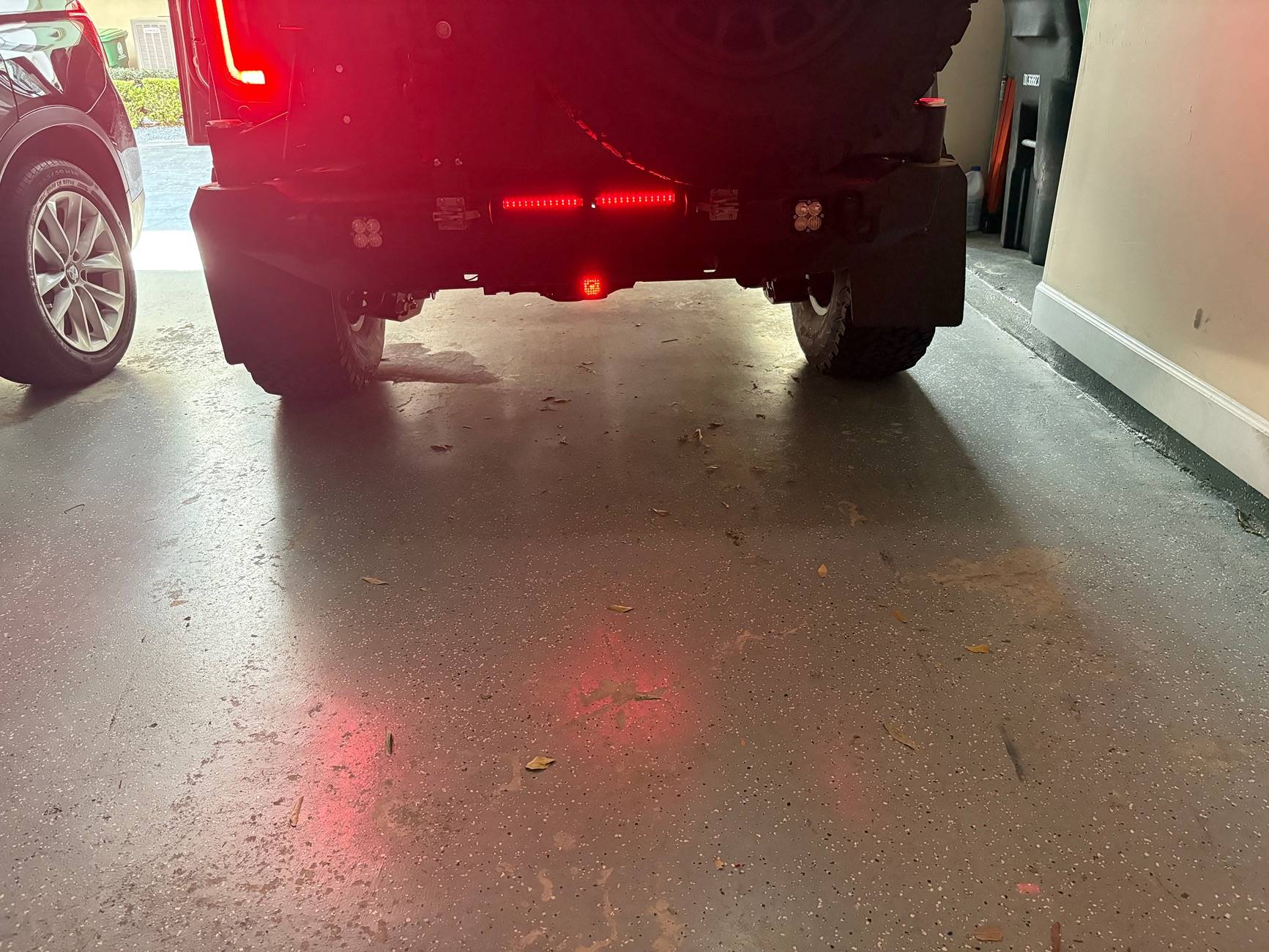

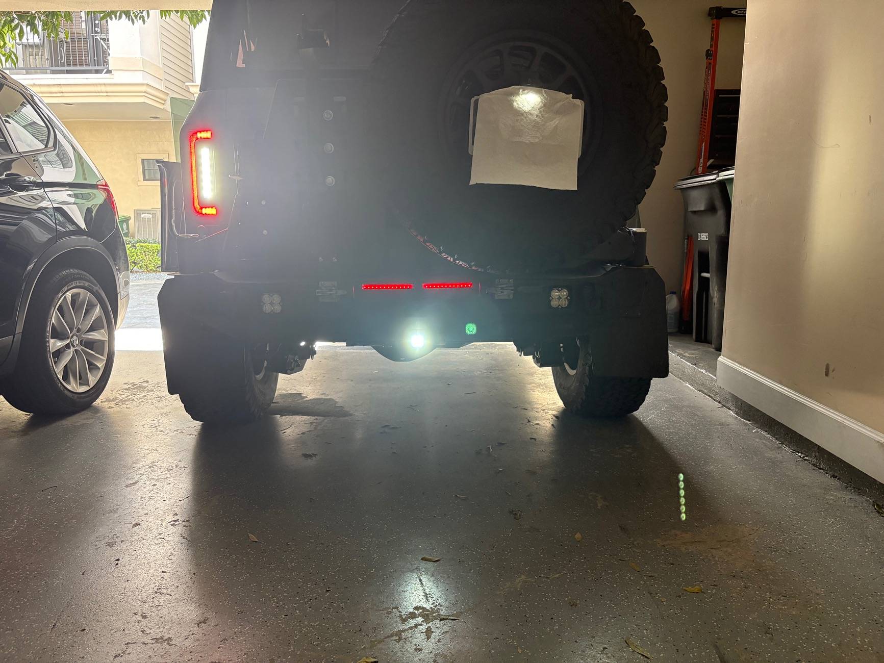

My offset spare blocks the passenger side tail light assembly for closely following drivers. There’s a spare tire ring 3rd brake light but this needed more signal visibility and reverse. Added a cheap Curt stick on set of brake/signals and Diode Dynamic brake/reverse. The extra reverse is great and very bright. Using both 7 and 4 pin trailer connectors.
The harness connection itself if moved way up inside/above the bumper, after previously getting mashed at 2 lower locations I thought were safe.

Did you get the regular C1 Hitchmount or the C1R? I like the Diode Dynamics lights I have so far, but I'm on the fence about the Hitchmount kit. The reverse light output on the Bronco is a bit piddly, especially on trails at night.
C1R - that has reverse, and even with my Oracle light-bar reverse lights it makes a difference. Doesnt help that I’m blocking one side with a tire, but this hitch light being centered and low to the ground makes a great pattern. I used it on another vehicle for a while in the mountains. I also have manual Aux rear flood/spots but too much for when there is traffic around.
