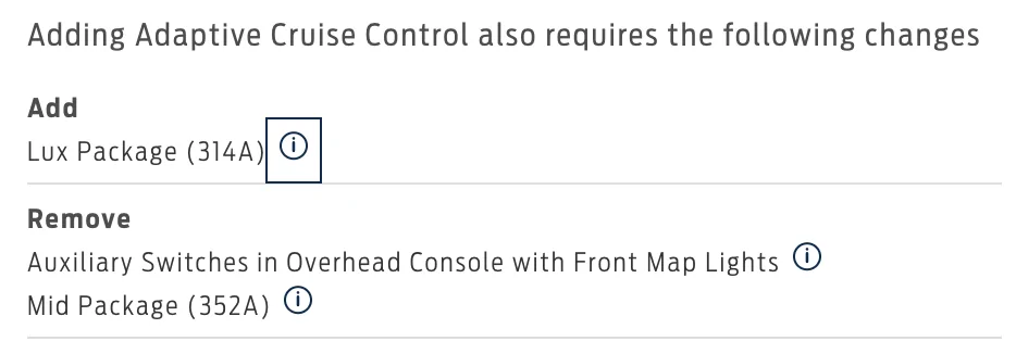

ACC is only available on LUX package. Also, ACC requires a radar installation and dedicated wiring I know this because I also attempted to retrofit on my Mustang
Ford Bronco Adding Adaptive Cruise Control??? Screen Shot 2022-02-11 at 3.15.55 PM
Were you successful? Have other mustang owner been able to do the install?
