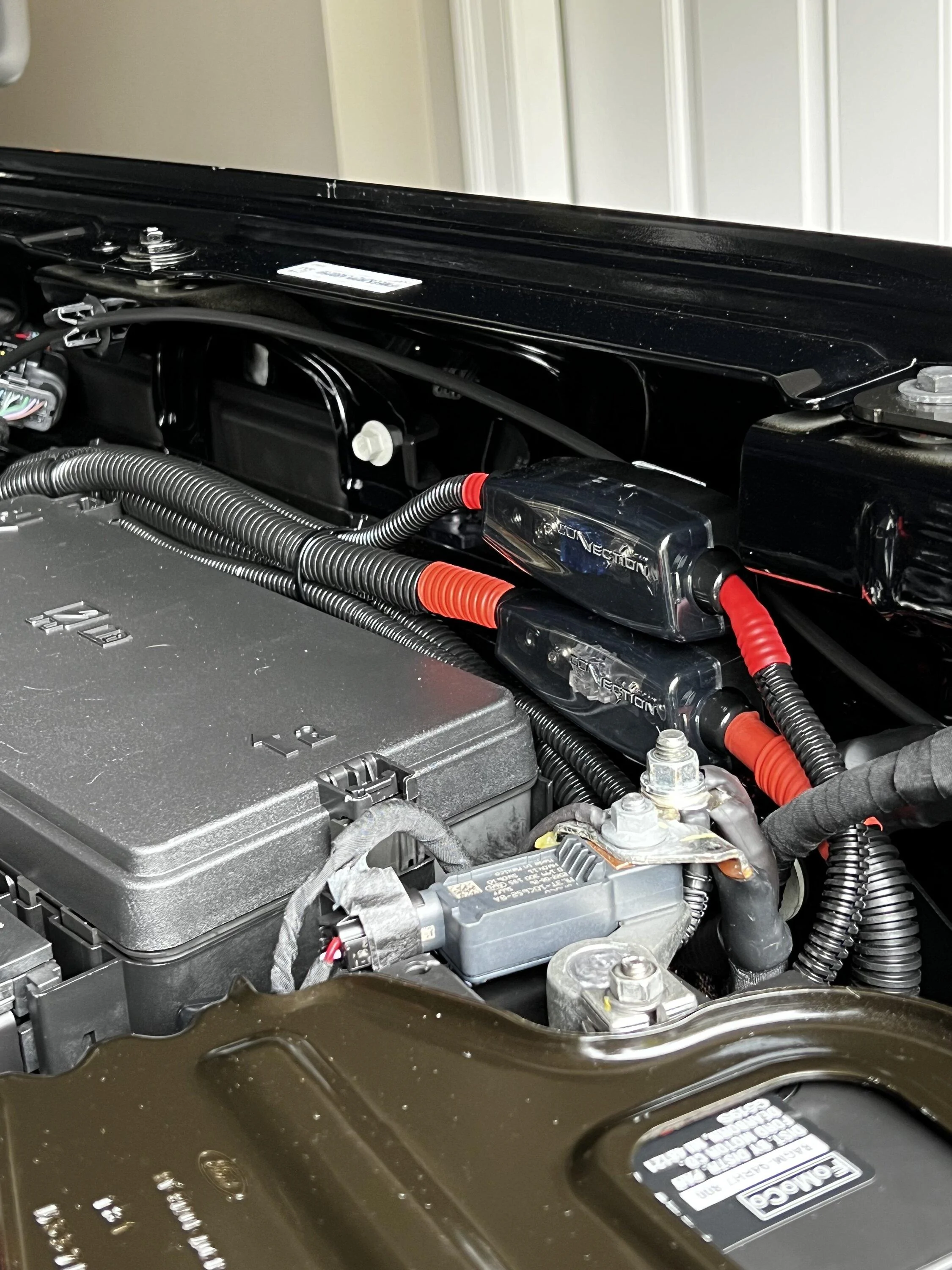

What’s everyone doing? Only pre-fab I’m aware of is the Stinger version.

one for the amp one for the compressor
Ford Bronco Amplifier Fuse Mounting IMG_0675
Great spot - I mounted mine in that general area too but tucked under the quarter panel overhang for additional moisture protection.
This looks like a good location. How are they held in place?
I attached mine with 3M Dual Lock

I mounted mine on top the battery. Poked 2 holes in the felt cover and mounted to that.
Have a lower amp (60) in the rear quarter before the amp. Covers my 20’ cable run on both ends.
