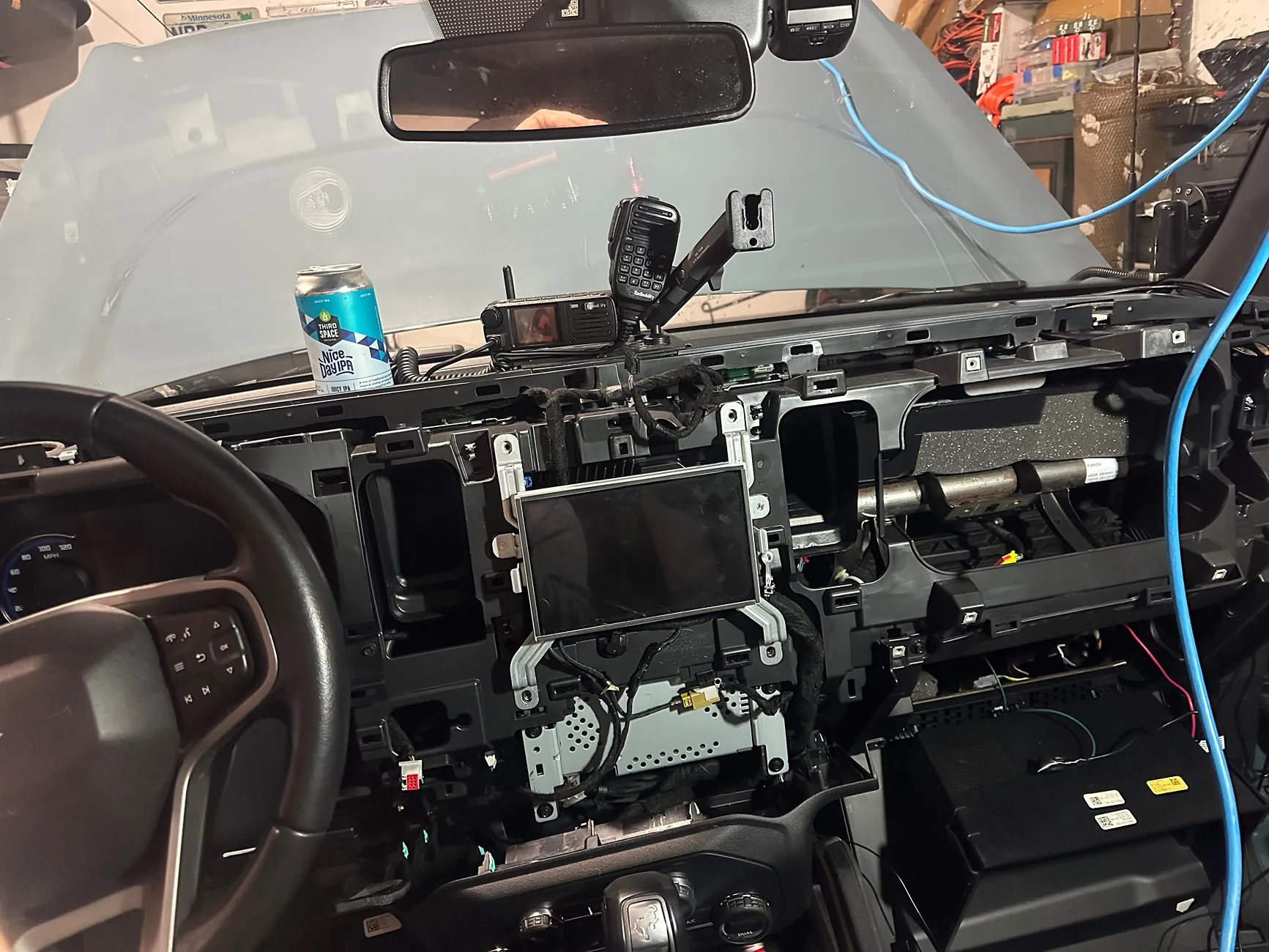

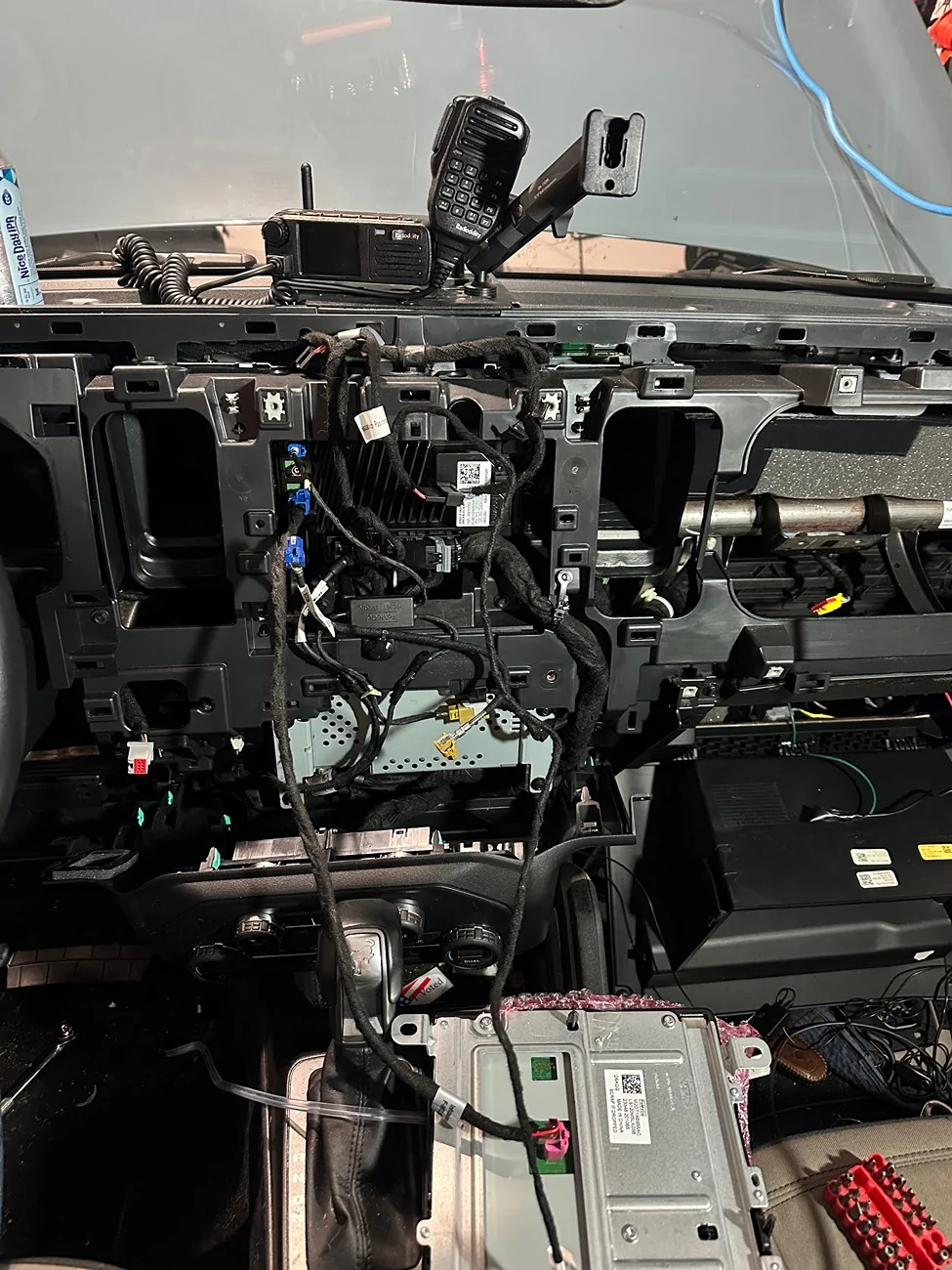

I don't want to pay that hefty price either... So I did a little research. I was able to track down a used APIM on EBay for about $400 from a salvaged 21' Bronco. I verified via google the VIN to make sure it was a 12" screen.
Now I can buy that CARABC kit and with a little help of FORScan too just incase to get it all working.
Part # MU5T-14670-PSC
Communication/Sync Control Module
From my understanding, if the APIM is not firmware updated prior to going into the different car it will eventually be unusable with the next firmware update.
