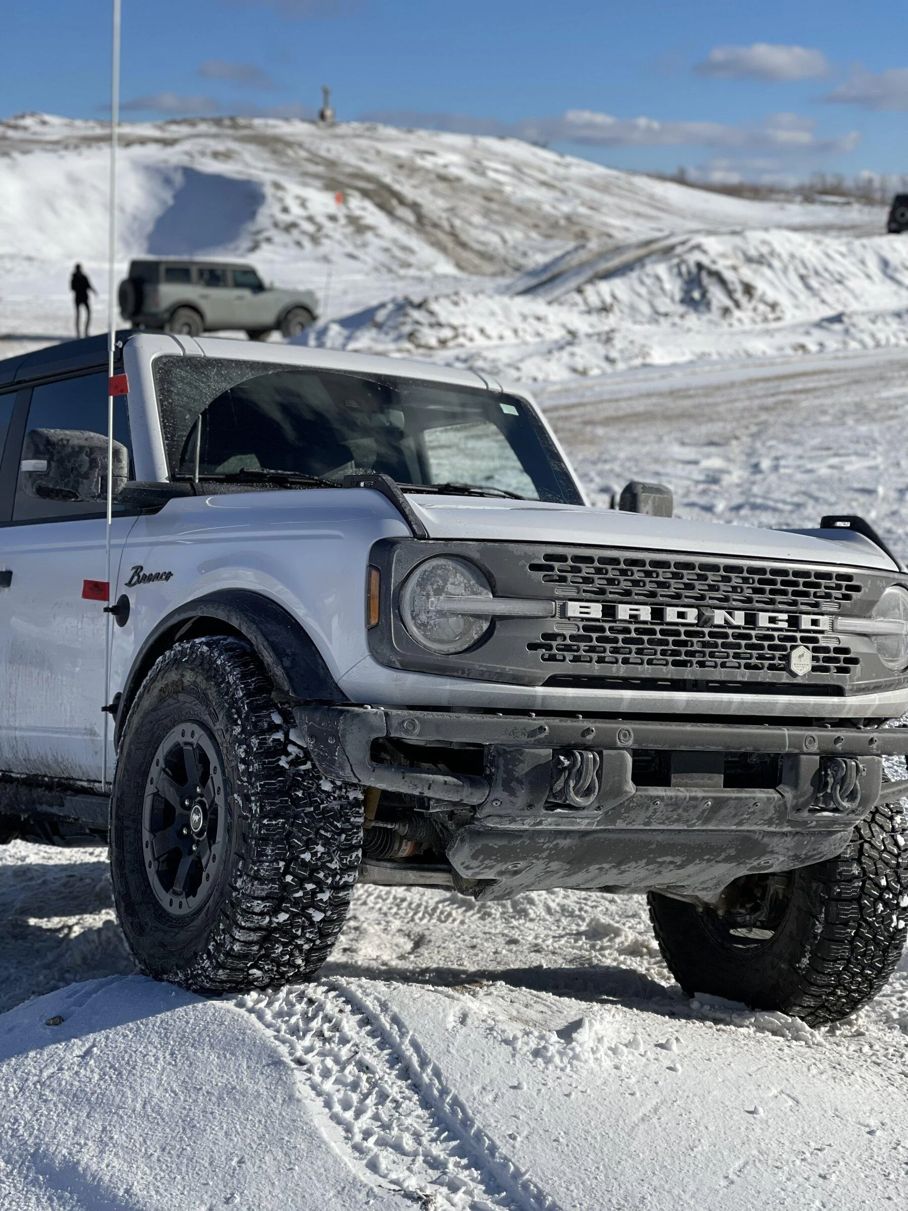

May just be the angle, but it looks like your front camber might be off a bit.
I put a 2" leveling kit on my BD and the alignment was way out of spec afterward.
i saw that too. looks like a positive camber now. and sort of lift (especially with that big of a spacer he put on) needs an alignment.

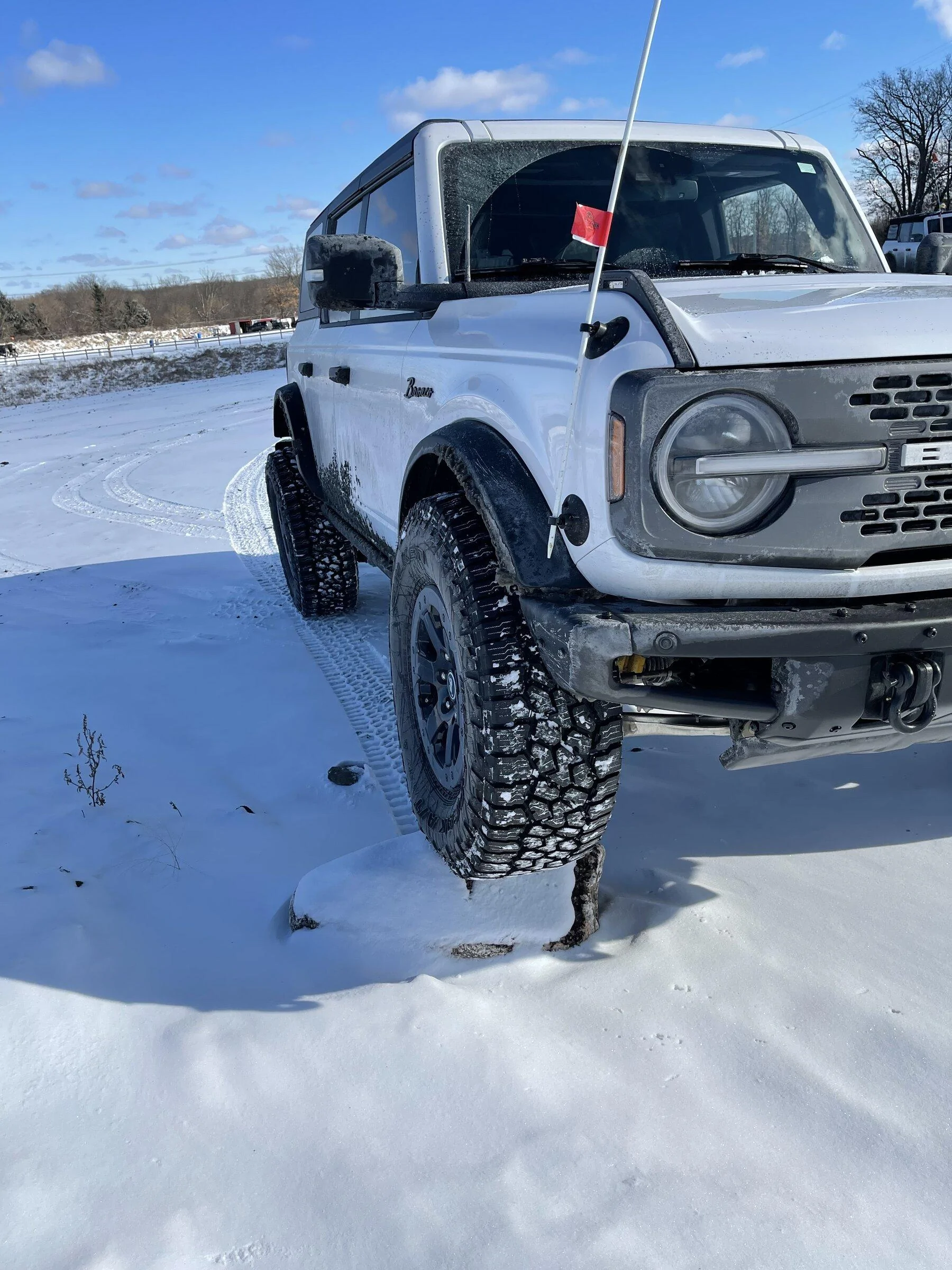

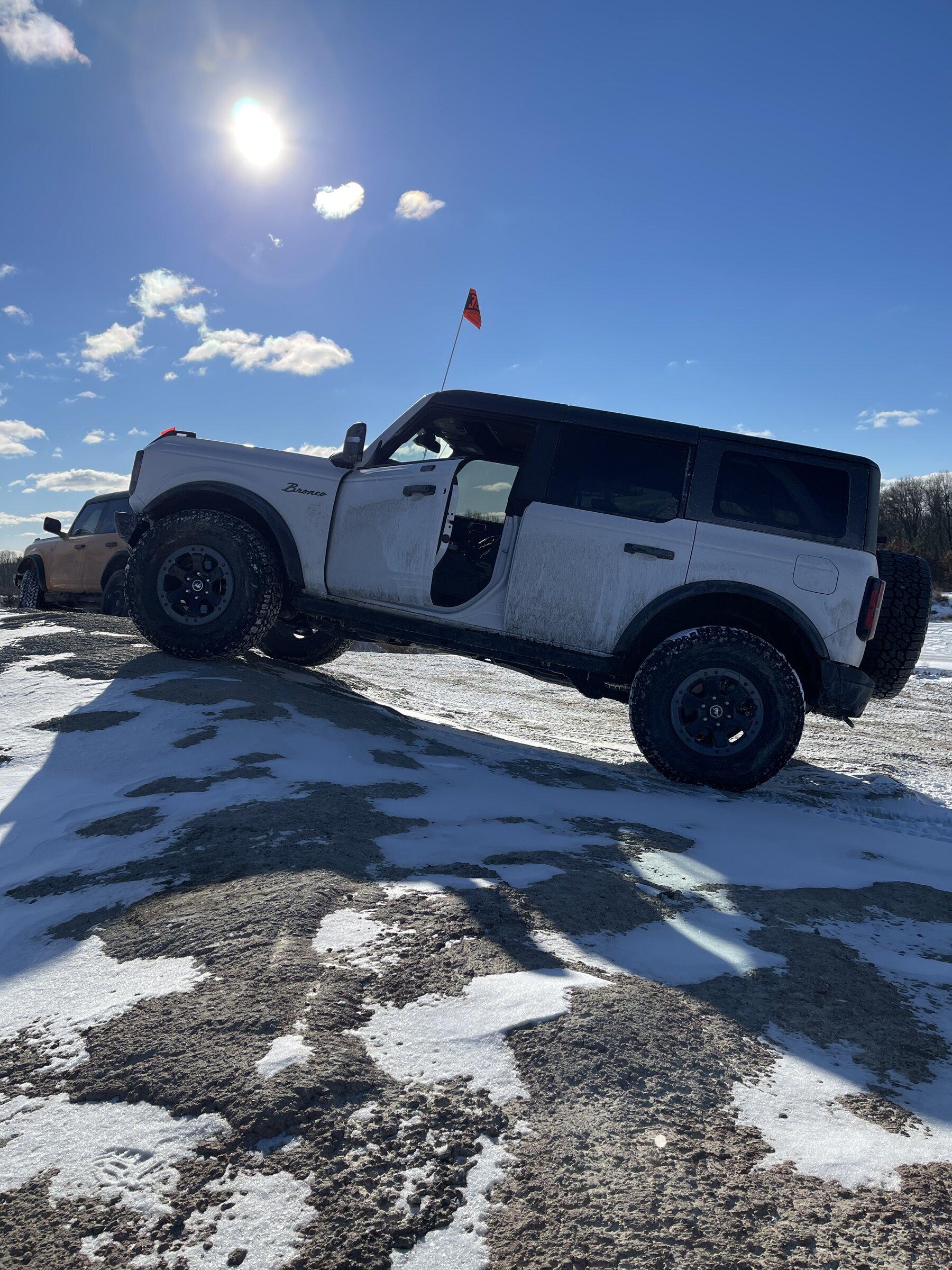

Noice!! Looks like you had fun! No rubbing?
no rubbing...still had some room. Plenty of space between UCA and tire. I have 1.5" spacers so not sure if that is why or if it would have been fine with out. Just know zero issues yesterday!

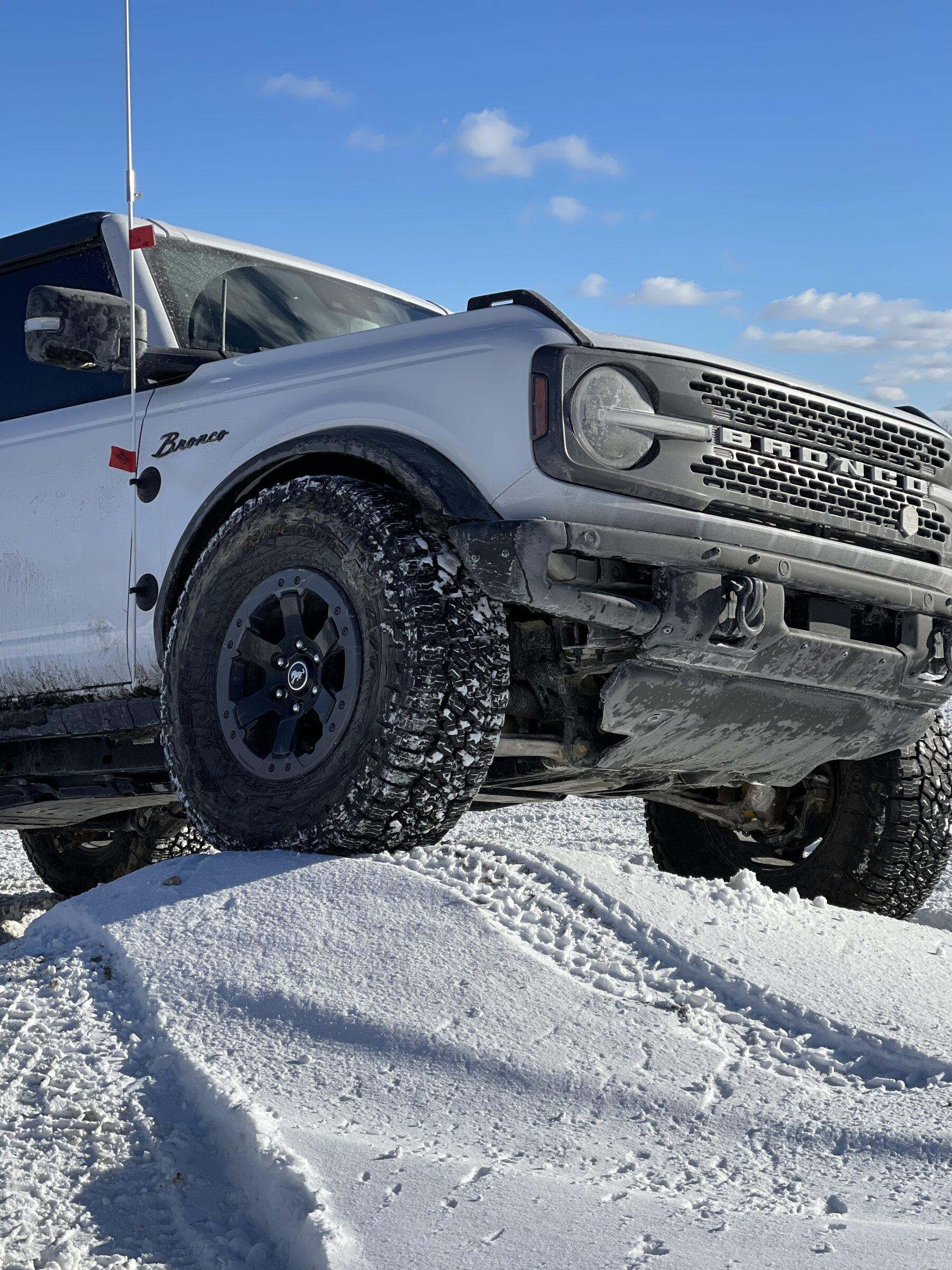

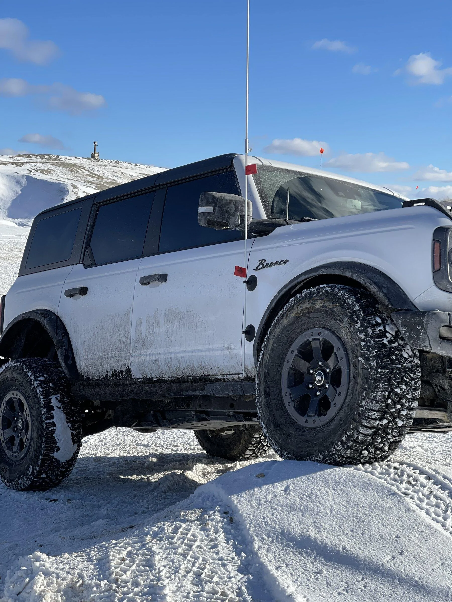

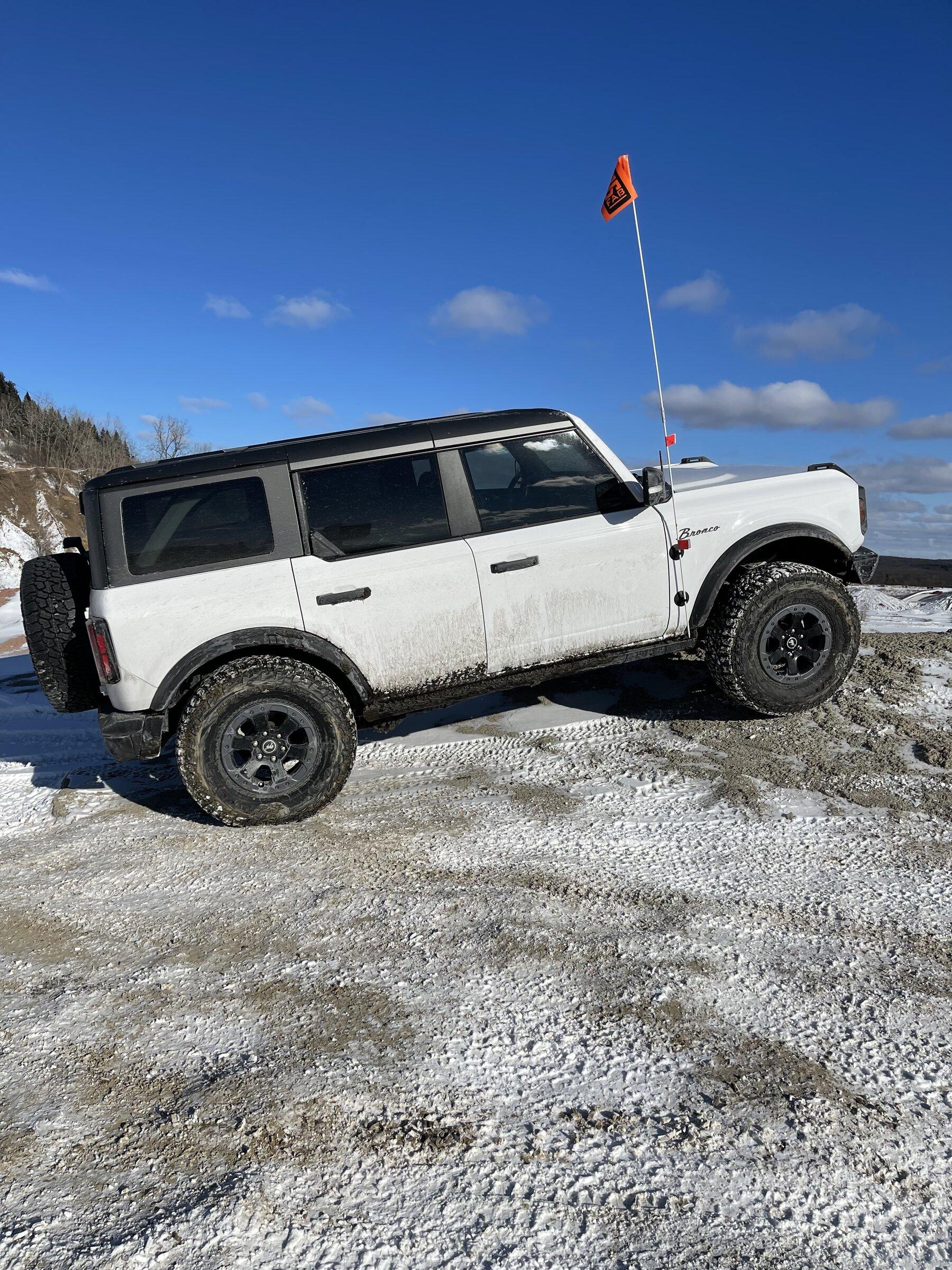

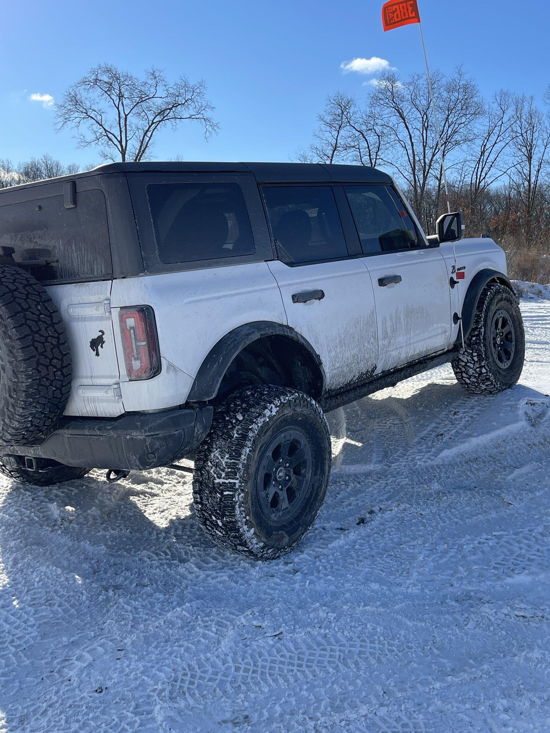

looks nice, i assume you are showing here much articulation and NOT rubbing??
Yes someone asked to see if there was rubbing when off pavement. no rubbing throughout the day.
nice! Thanks for taking the time to let us know. I’ll have 0 offset wheels, so should be similar set up.
youre welcome. yes you should have no issues at all. so stock rims are +55 plus 1.5" spacer if my math is correct and if it is the correct way to figure it out, I have something equivalent to about a +17. Correct me if that is not correct way of calculating.
