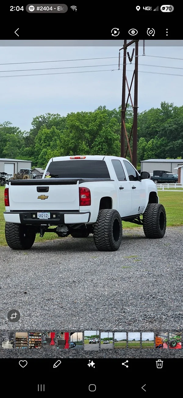

What would be the setup needed for the new Bajas to be used on a new Bronco?
Looking at the 36x17x17. Would assume I would need a 17x12 but I would want the minimum offset.

Mickey thompson haven't announced the offset/backspacing of the 17x12. the forged 17x14 has -101 offset. They will stick out tremendously. Ironically I'll be getting the 17x12 on 17x36r17 on my silverado 1500, but that look is more excepted than on a g6 bronco. For example this is 36x15.50r20 on 20x14 with -76 offset on 3inch spacers on the rear and 1.5 on the front.

You're going to run into issues with turning the wheel.
They just announced these tires being re-launched at SEMA. I didn't see any posts with them but maybe I missed post or didn't search properly.
I would be putting these wheels and tires with some sort of widebody fenders.
Silverado has the same bolt pattern, I expect to see pictures of this setup on your Bronco to ignite the forum in massive flames.

17x12 et -38 would be the same backspace as a typical 17x9 et 0. So the 12” would stick out 3” so would be perfect with the ADV 8” fenders.
