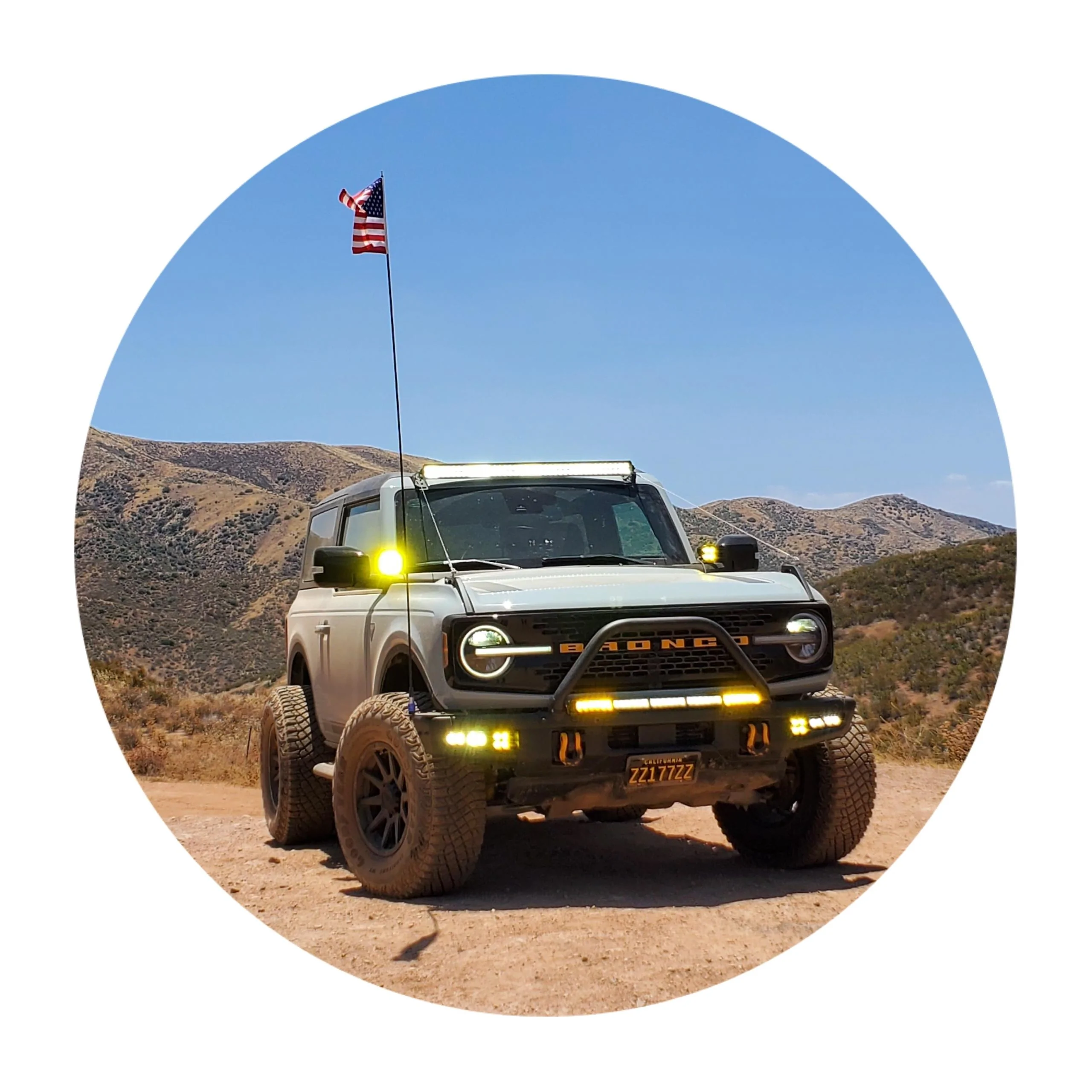

I have Baja Design Fogs, Chase, Ditch, and rock lights.
I have a North Lights Co 40" dual row bar on the roof.
I have a Diode Dynamics 30" bar on the bumper.
Ford Bronco Baja Designs Vs. Diode Dynamics KakaoTalk_20220620_065343096
They're all great in their own way, but the North Lights Co 40" is the brightest LED light source I have ever seen in any application, but it's also the most LEDs I've seen in a single fixture. I had to swap my factory AUX switches to a SwitchPro 9100 just because of the power this light bar requires.
The Diode Dynamics have the cleanest, most focused beam of light.
Baja Design lights are the most solidly built lights, and feel like they'll last the longest, and are sufficiently bright as well.
North Lights Co is bright and powerful, but the beam has a wider spread and I can't say for it's longevity, but feels pretty solid to me. Mainly, I don't have any wind noise until I pass 80 MPH, and I hear a whistle, but I'm not sure if it's from the mount or the bar.
The only thing I'd want to do is add more rock lights to the bottom (currently at 8), and when my Trailrax roof rack arrives, probably a light or two on each side.
