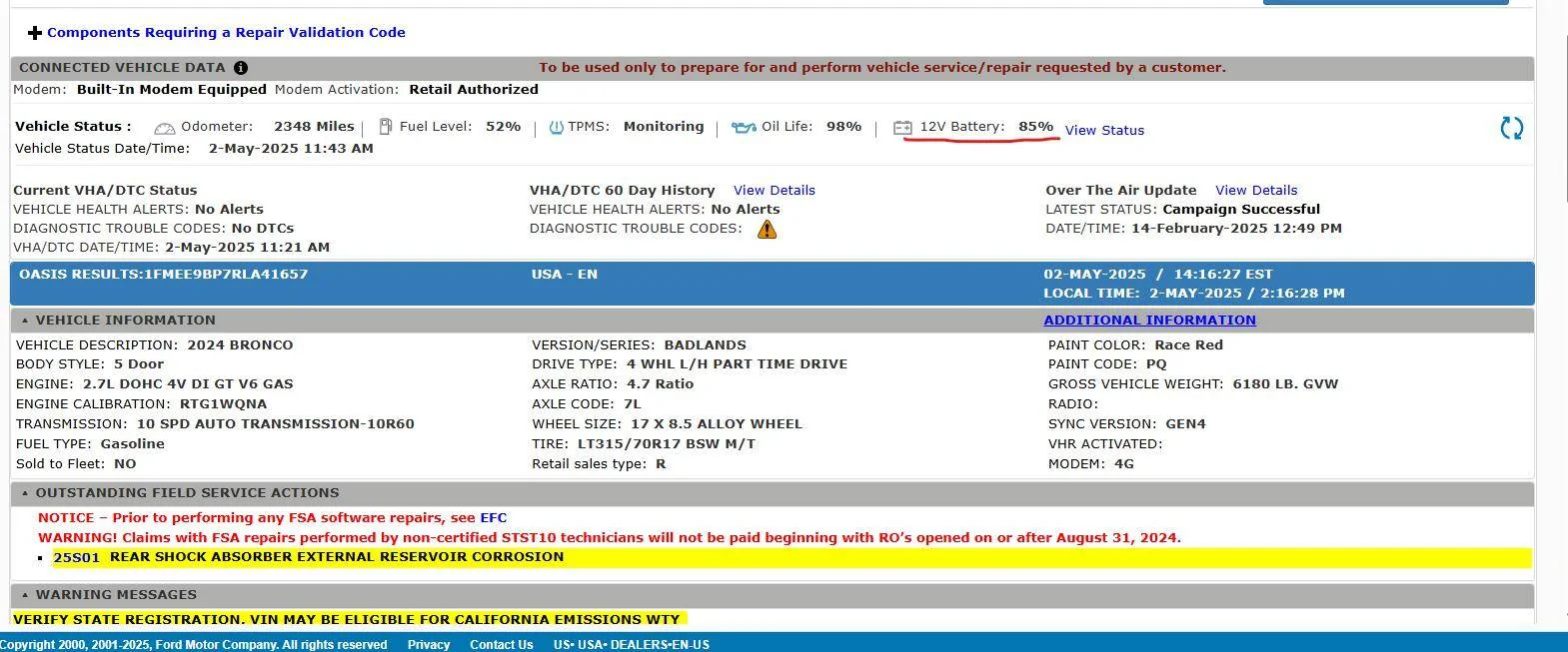

Thanks, 1FMEE9BP7RLA41657 I admit it doesnt get driven as much as it should.

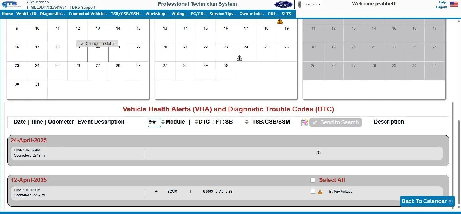

On a positive note, your battery state of charge is very good right now.
Not much here so it's pretty much the tender or pull a cable. We have an average of about 2 customers a week that are in the same situation as far as use is concerned. Unfortunately, the way Ford does their software and how the vehicle goes into sleep mode, there's literally no "fix" for this short of driving more or the charger. It's hard to explain to people, especially those who haven't had a new vehicle in the last 10 years why this is a problem now when it wasn't back then. Technology, isn't it great:rolleyes:

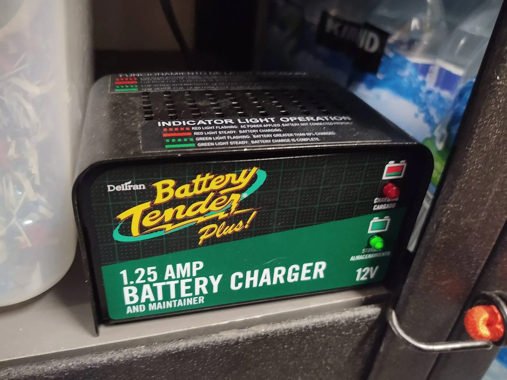

I keep mine on a Deltran Battery Tender 24/7....it's always ready to go and will lengthen your battery life. Buy an extra 6' cable and extend it out through the grill.
Get this one:
