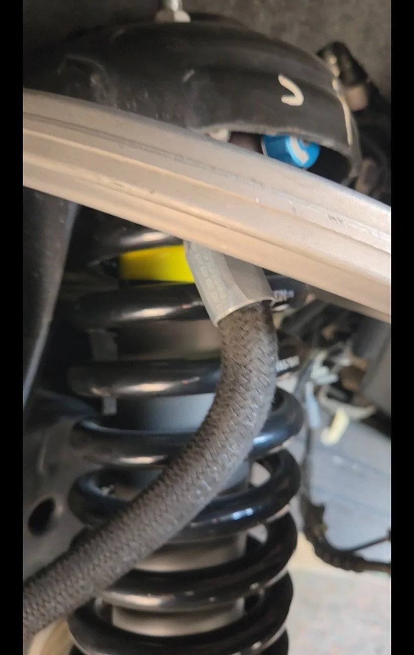

Driver side photo
Hose fitting is angled towards uca causing a bend in the hose. It barely clears the uca at full droop when car is lifted.

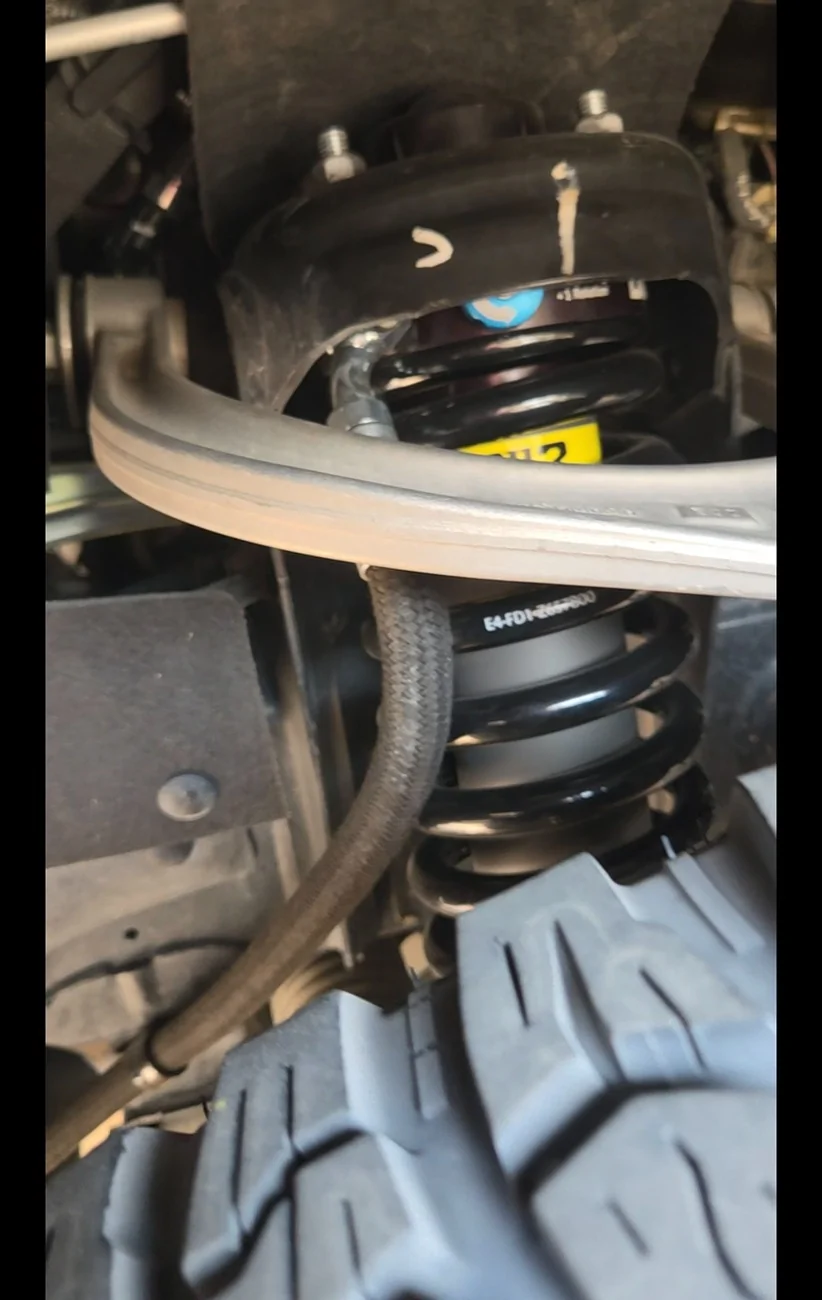

Passenger side
Passenger side hose fitting exits straight without angle which is what it's supposed to be.

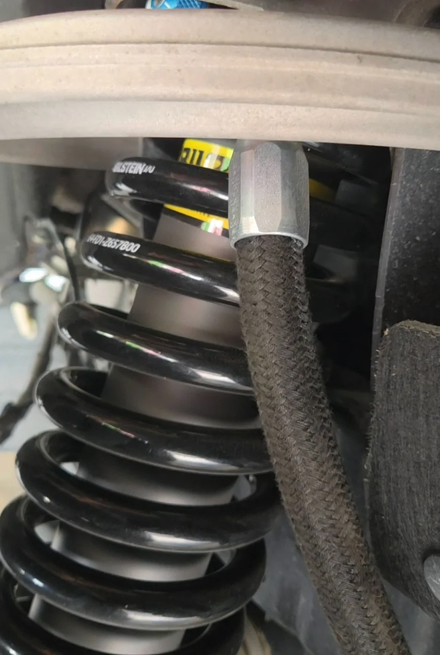

I looked up other photos online and the hose seems to exit straight from the shock on driver side without an angle in the silver fitting.

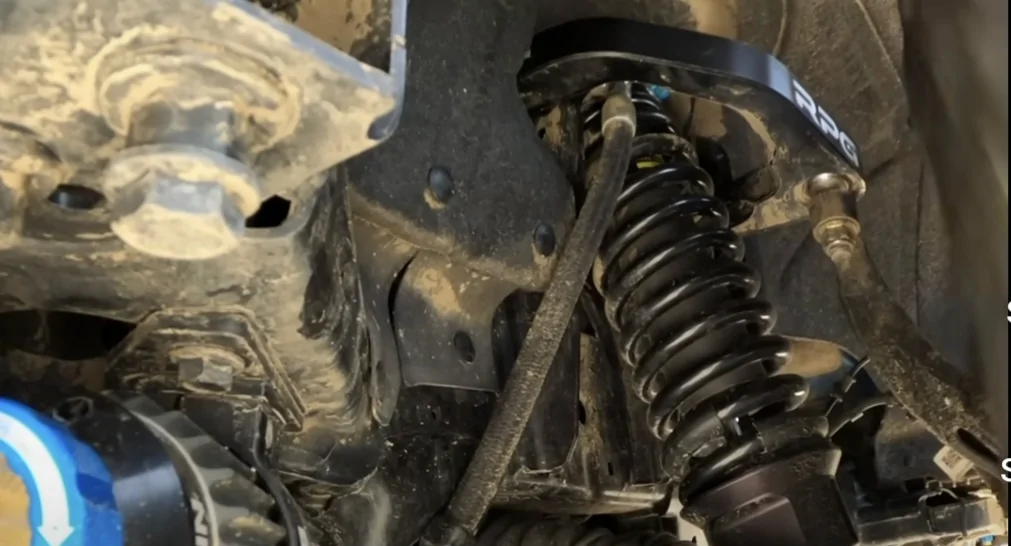

From shock surplus video

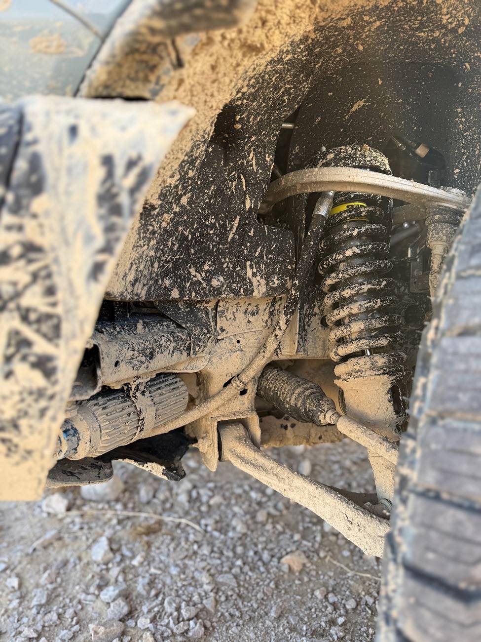

Photo from another member here

Driver side photo
Passenger side
