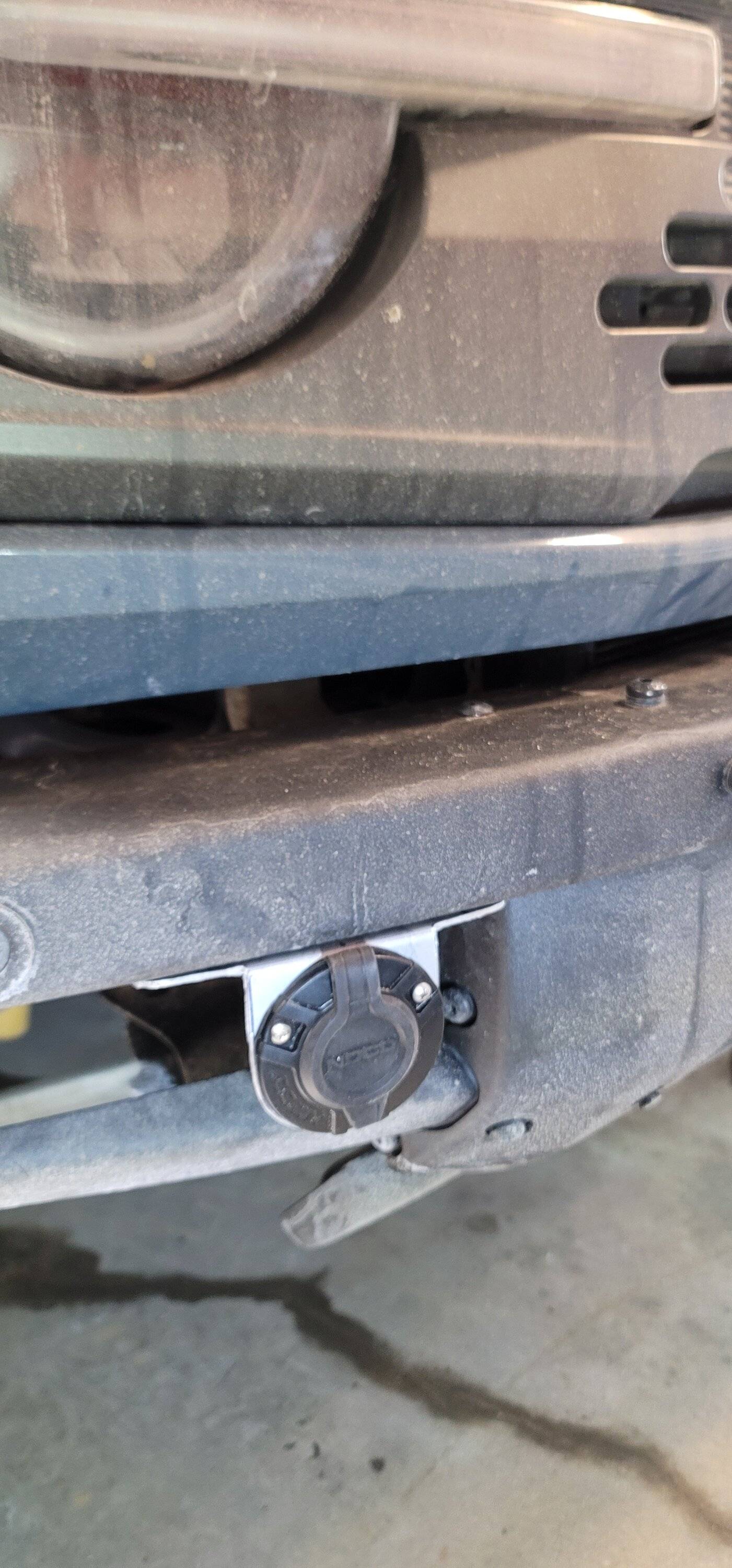

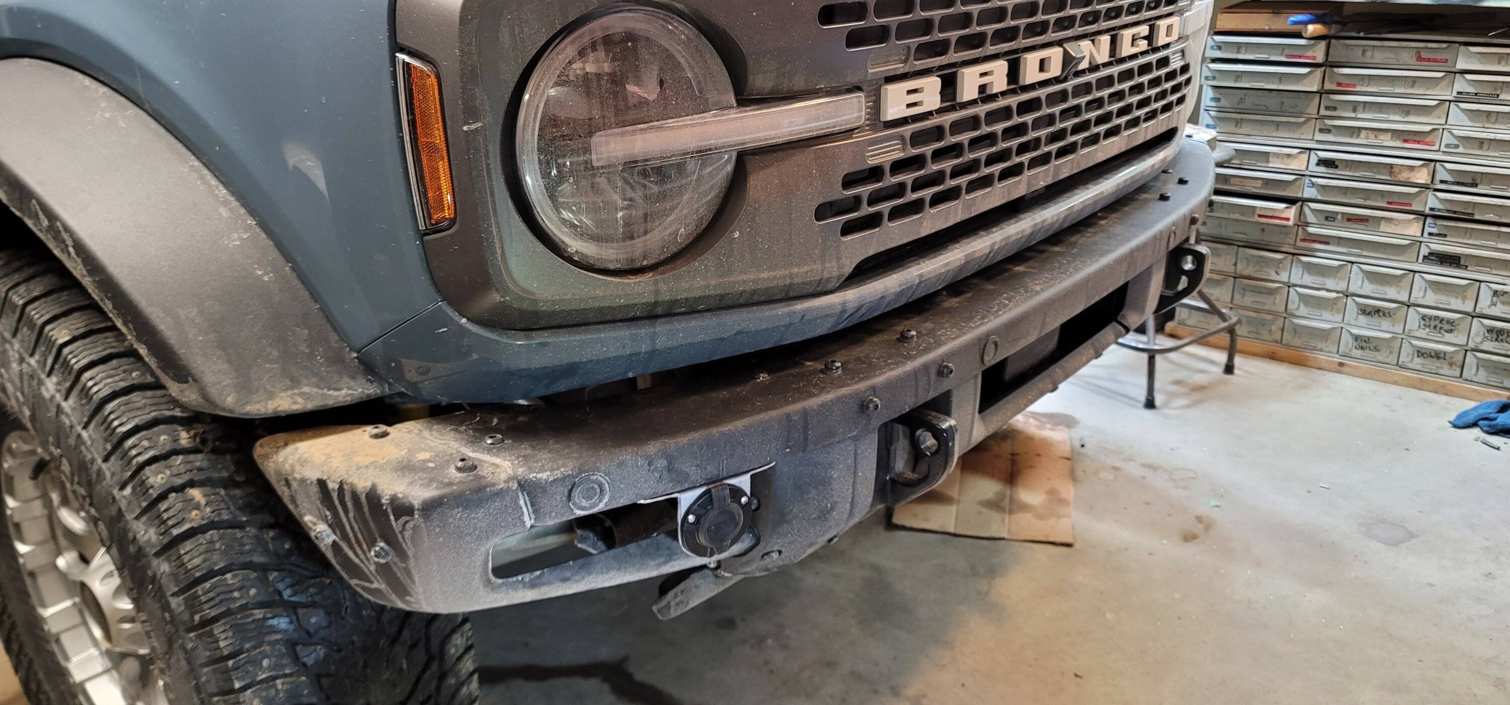

Ford had a real brain fart where they hid the block heater cord. I made a temporary block heater relocation bracket and extension.
I used a NOCO 16" extension (lengthened by 12 inches).
A piece of aluminum road sign.
I will be making a new mount in the spring because the fog light pocket will be filled with lighting.

I just ordered one of these for my 23 Super Duty last night!. Plug is very obscured due to to grill guard & winch. I found this mounting plate on Etsy and was worth it for the time I would have into fabricating one:

I just unhooked like 5 clips and the strung the OEM cord out the same spot as you, no extension needed.

uh, that's a great idea!
I have to say I didn't think out the rerouting option.:confused:
I might go that route next winter...

yours looks much cleaner, I like it, mines held in place with a zip tie.
