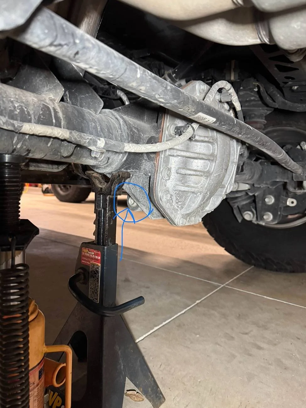

When I did mine, I reused the gasket, cleaned up the surface and good to go..... pretty easy. I do wish ford made a cover with a drain plug but for as rarely as I'll do this I guess it's ok. My fluid at 25k was pretty clean, I used amsoil 70-140 to refill.
doesn’t the Ford Braptor already have a huge drain plug in front of the differential? This is mine.
Ugh, it looks like most of my reason to have purchase the FP one is gone. You've used that to swap fluid? Asking as you said, "doesn't...".

Ugh, it looks like most of my reason to purchase the FP one is gone. You've used that to swap fluid? Asking as you said, "doesn't...".
It does. That is a drain plug
