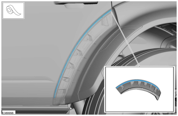

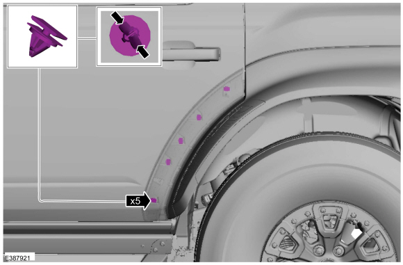

Looks like it’s held on by some clips and a little tape. Workshop manual says to remove the interior door trim, to gain access to release the clips.
Rear Door Moulding - Raptor
Special Tool(s) / General Equipment
Interior Trim Remover
Removal
NOTE:
LH side shown, RH side similar.
  1. Remove the LH side rear door trim.
    Refer to: Rear Door Trim Panel (501-05 Interior Trim and Ornamentation, Removal and Installation).
  1. Remove the LH side rear door watershield.
    Refer to: Rear Door Glass Run and Bracket - 5-Door (501-11 Glass, Frames and Mechanisms, Removal and Installation).
  1. Press the lugs and release the retainers from the door.

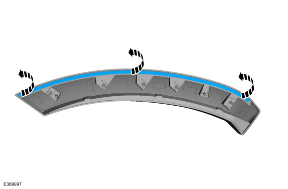

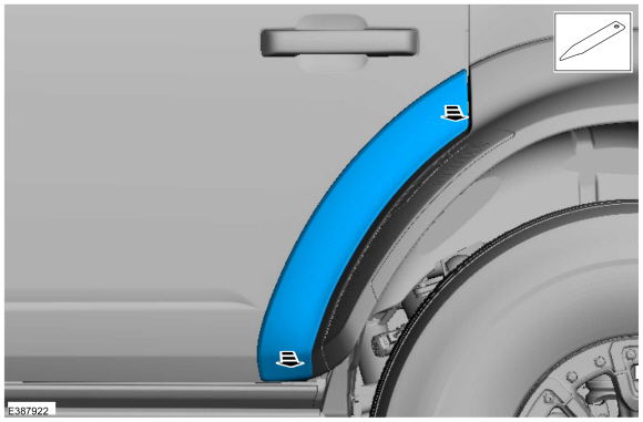

  1. Using the interior trim remover, pry and slowly allow tape to start relaese and remove the rear door moulding.
    Use the General Equipment: Interior Trim Remover
Ford Bronco {thread} {filename}
  1. NOTE: Not to use solvents to remove the tape or damage to the rear door moulding
    Remove the tape by rolling off with thumbs.
