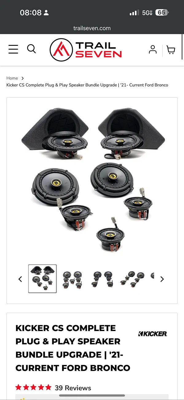

Hello all, I am looking to fully change out my B&O speakers to Kicker CS plug and play with the 6.5” Pod and speaker upgrade from TRAIL SEVEN. Is there anything I should do to protect the speakers in the housing with foam or such? Also about setting the rear pods from tweeter to regular full speakers, how and is this possible to do. If so I’d love to know. Thank you very much.

in the B&o system you cant make the rear pods full range
this kit also looks to put coax speaker in the kick panels. which is frankly just dumb. red flag to me.

B&O has tunes DSP stick to corner coax and rest of 4" woofers preferably with integrated circuit boards like OE speakers and 6.5" woofer kicks.
It's can actually sound very good with good speakers. Ground zero BMW 4" coax, Audison 4" woofers and Hertz or Audison woofers ok r whatever you can get a deal on from Indy shop or diymobileaudio.
