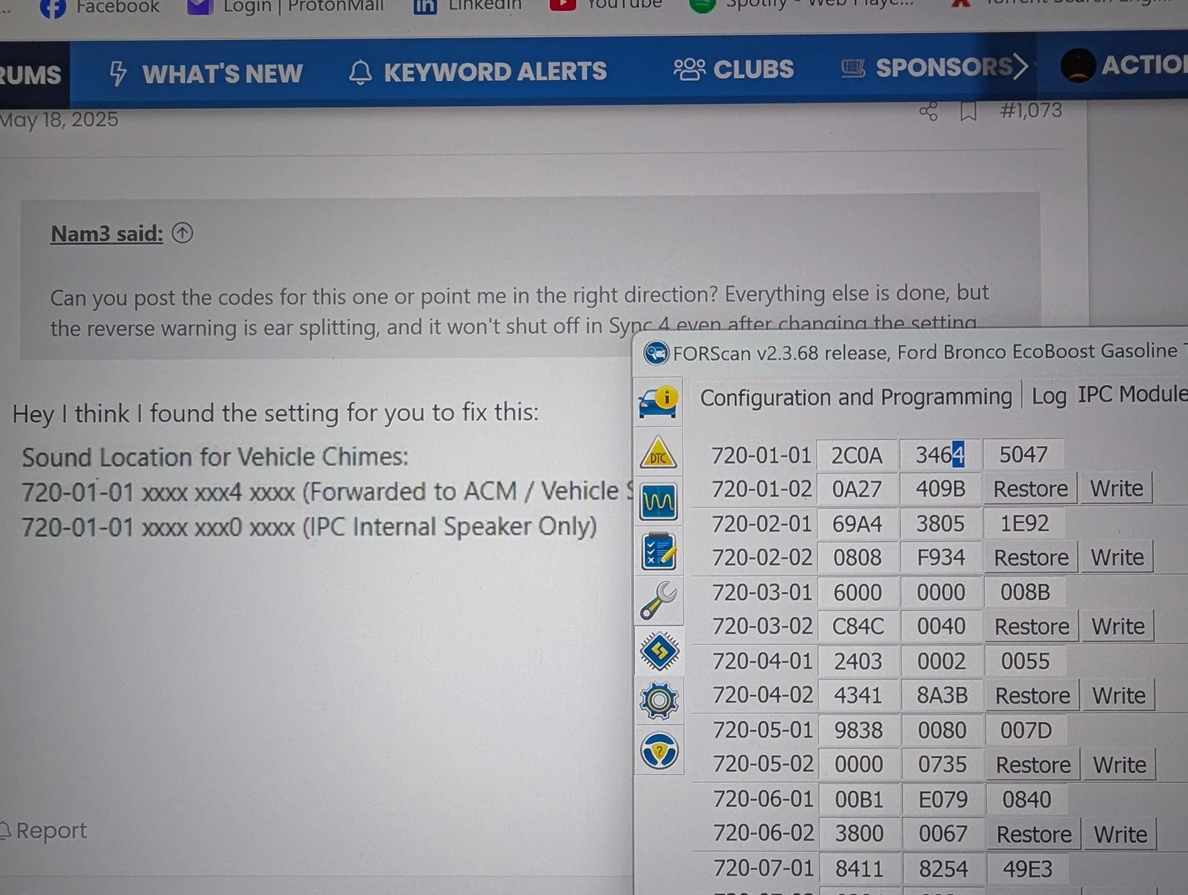

Since ordering, I've been reading that the chime sounds in my car are going to become "unbearably loud" ... 🙉
Did you experience this?
If so, did you remedy it?
I've seen multiple threads and multiple solutions, but figured your be the best to ask as we have the same equipment installed.

Good catch...yes, I did. You gotta play with the two dials on the side (gains). If I remember correctly, the slightest adjustment can make all the difference. After you get it installed and tuned, dont shut it all up. Play around with the audio for a bit to make adjustments. Watch their Youtube install video and you should be fine. I am happy to answer any questions you may have. TrailSeven is also great with customer service. Good luck!

It's easy to do in forscan, change 720-01-01 xxxx - xxx4 - xxxx to 720-01-01 xxxx - xxx0 - xxxx under IPC module.
Moves all the chimes from being run through the speakers to the IPC internal speaker.
I can barely hear them now with music and my exhaust. Without loud music you can hear them normally .

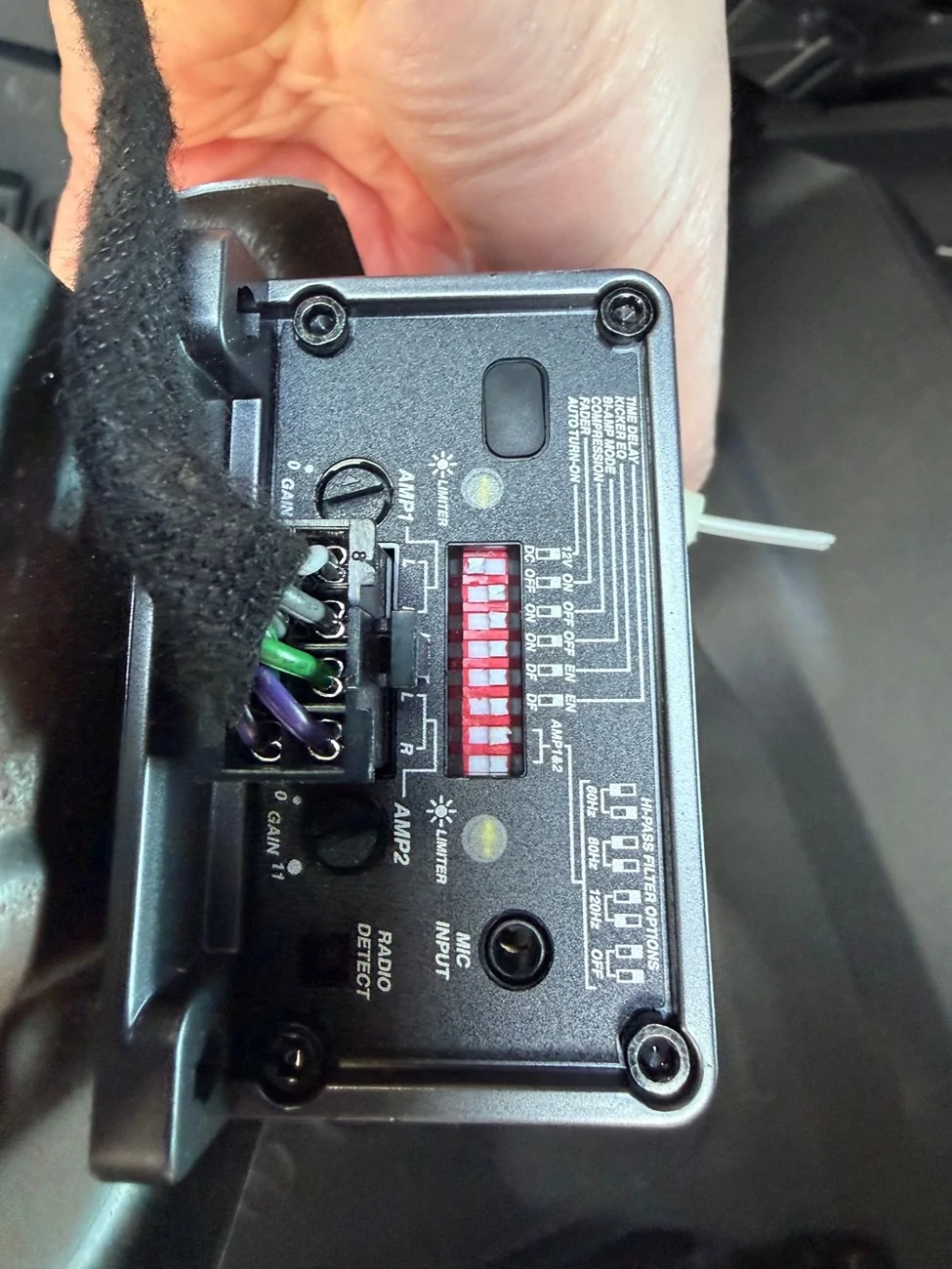

I installed the Kicker 200.4
However, when I run the DSP it sounds terrible. Speakers crackling even at low volumes, and unpleasant to the ears (to say the least).
What setting did you set your kicker 200.4 dip switches to?
Are you using the DSP setting or no?
I still have the gains all the way down on the amp.
Also, do my you have a sub woofer on your setup?
I did the Ford fusion amp with kicker 6.75" sub to replace the fake ones that it got built with.
Also, does anyone know if the other speakers signal is affected when you enable the power to the sub in forscan?
Maybe because I have that setting on, but the fuse removed during the DSP setup it's messing something up?
Or did I get a faulty wiring harness??
Gah. So frustrating.

Hi..and apologies for the delay.
Yes, I use the DSP setting turned on. I did the whole pink noise calibration. I do NOT have a subwoofer. I cannot remember my DSP switches but I will open it up under my steering wheel and take a picture and upload it here. Hoping I can do that later today and I will get back to you.

Here is my amp's set up:

Thanks for that Chris. 🤙🏼🤙🏼.
I'll play around with the high pass filter and try turn the gains up just a hair to see if I get an improvement.
It sounds pretty good as is, but it is endlessly frustrating that the DSP process has only made the sound worse so far.

The only other thing I can think of, and not sure if it makes a difference - when you did the Pink noise calibration, did you set all the audio settings back to factory first? Thought I would just throw that Hail Mary out there. Best of luck!
