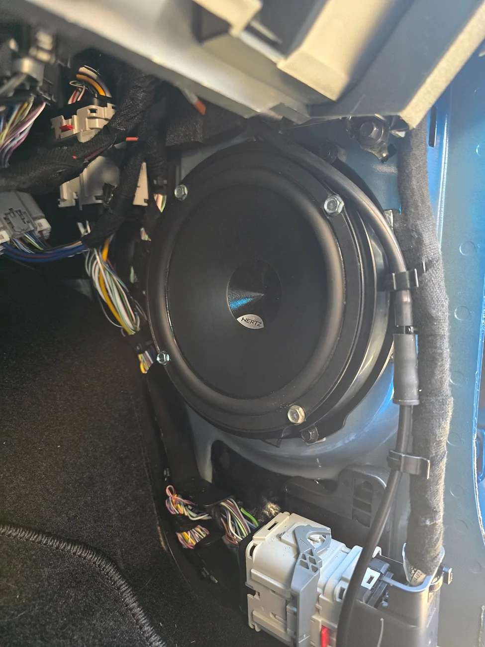

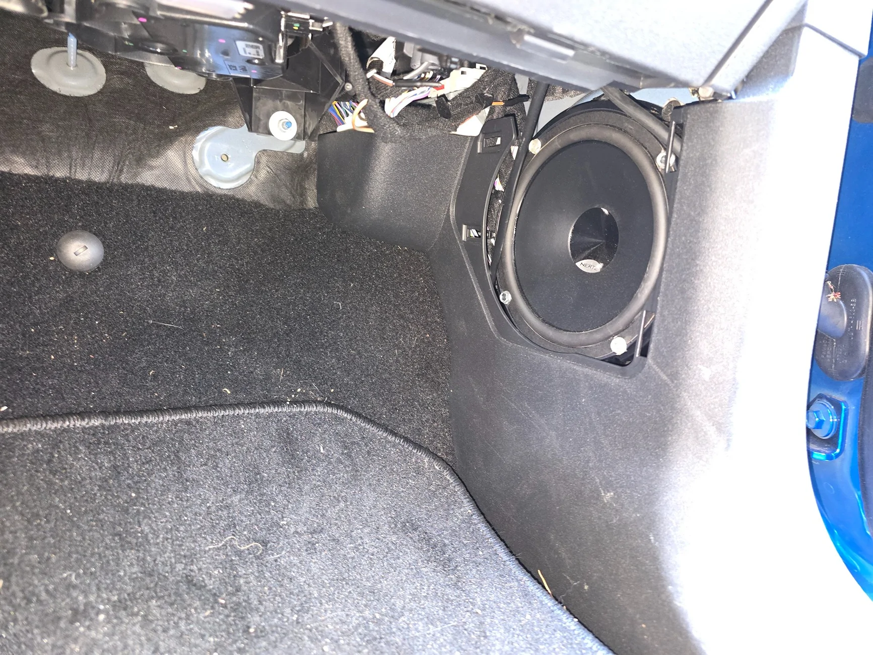

I did a Hertz System too and used the Mabett pods.
Ive got:
DCX 100.3 in the dash
DCX165.3 in the rear Mabett pods
DSK165.3 in the kick with the tweets on the dash
Can confirm these speakers fit, but the kicks were hitting the grills, so I took the grills off, but the grills can be modified if you like.

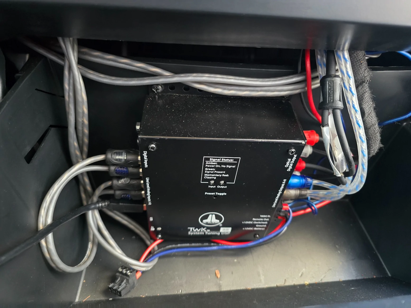

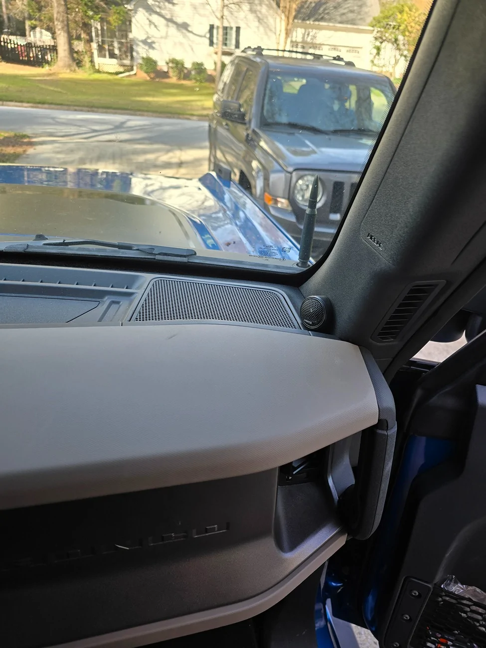

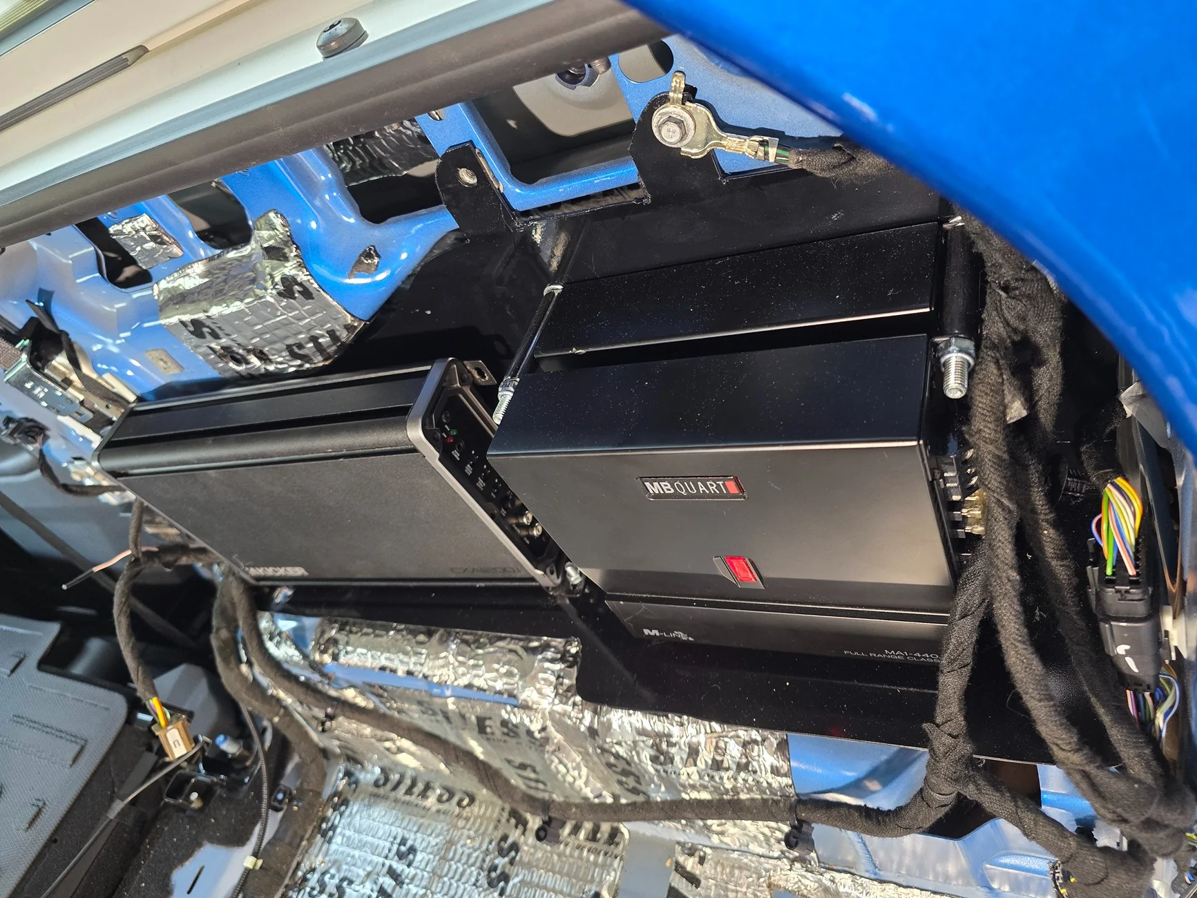

Here you can see the tweets.,they fit the dash/a pillar almost perfectly. I didn't screw them in, but did use a little double-sided tape. All speakers are on their own channel from the amps. No crossovers on the components but all amps are fed from the twk-88 and each channel is independently tuned.
I used a PAC interface for my non-b&o to route signal to the twk
