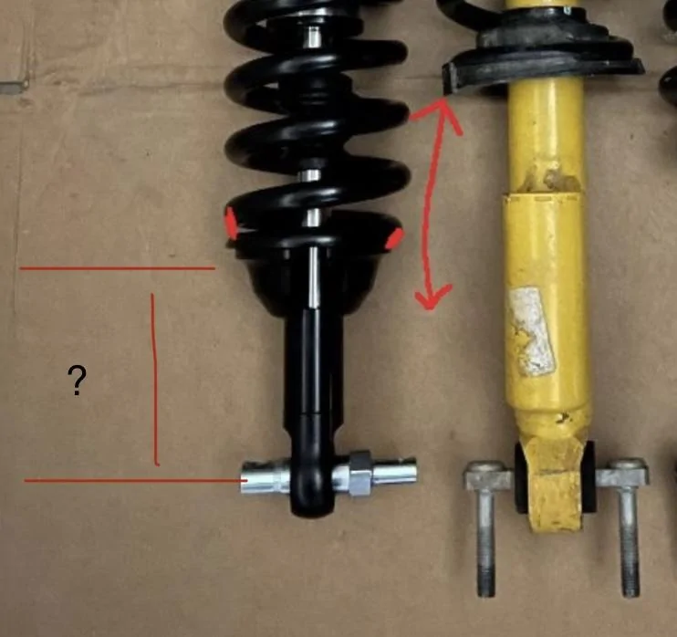

Zero issues with the Eibachs. I have them on my BD Sas on 37 KO2s. I’m up about 2/3 of they way on the adjusters. Lift about 2.5 inches over stock squatch bd.
Good to hear that the 37 KO2s are clearing with the Eibach coilovers. I installed the Eibachs with their factory settings and also have about 2.5" over stock squatch. I have a few questions if you don't mind:
1) What offset wheels are you running?
2) Are you using the stock UCAs or did you go aftermarket?
Stock control arms, upper and lower, but I am at the end of their adjustment on the ellipticals.
0 offset wheels.

To get the front end back to factory alignment settings, likely an aftermarket UCA. I've heard mixed opinions about adding rear links to let the rear end move around easier. Depending on which kit, extended rear brake lines may be needed.
Biggest thing I'd recommend is to not lift as far as you can. The more droop travel you leave in the front and rear end, the better it'll drive. Crank it up to get almost no down travel and it'll ride extremely harsh.
I have had an Icon Suspension on my 4-Door for almost 6 months now. The Front Coil Overs do not hit the Tie Rods.
