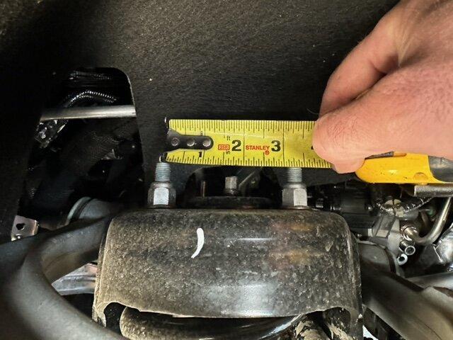

What is the thing or measurement that makes the space lift for the HOSS 2.0 not compatible with the Hoss 3.0?
What's so different about the Bilsteins and the Fox components?
The shock towers should be the same. The lower control arms are the same right?
I just want to add an inch or two to level it out some. Adding the winch did not help the rake.
Ford Bronco Difference between the HOSS 2.0 and 3.0? IMG_5761
This is the measurement I took of the bolts on the Fox struts.

HOSS 2 and HOSS 3 should be the same lift height.

Zone says their leveling spacer kit works with Hoss 3.0 on their website. If you want more that 1” then Foutz, SVC, and RPG make perch collars (more sizes available on Foutz than RPG).

I like the rake, levels out nicely when loaded with gear, hate negative rake! lol

Zone says their leveling spacer kit works with Hoss 3.0 on their website. If yo want more that 1” then Foutz, SVC, and RPG make perch collars (more sizes available on Foutz than RPG).
Thanks, will look it up.

Tube diameter. The bilsteins have a 1.9ish inch tube diameter. The Fox 2.5 are 2.5” diameter. This impacts all perched collars and some hybrid (collars and top puck) lifts designed for the bilsteins. Also some of the top pucks have too narrow of a center hole to accommodate the larger diameters fox tubes. Some pucks will fit or can be modified to fit. It is not rocket science……..
This.

There are several threads on what lifts work with HOSS 3.0. RC 2.5 puck lift (it’s not hybrid) and perch collars (RPG and Foutz). Eibach SAS Pro kit apparently work, but everyone needs the HD springs, but no ETA yet for those. There have been a few posts about Dobinsons working too…but you may need to experiment.
https://www.bronco6g.com/forum/threads/hoss-3-0-replace-stock-springs-with-longer-springs.71776/
