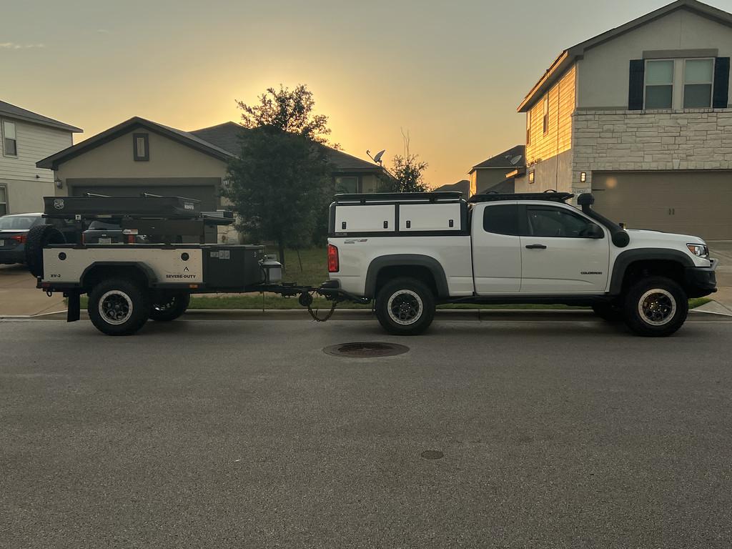

emulous74
Seth
Dec 25, 2020
408
683
Austin, TX (Pflugerville)
'19 ZR2 Bison D , '23 Bronco 2DR, MT
While your tow vehicle does not need matching rims and tires, there are some real benefits, besides just looking cool. My Schutt Industries XV-2 trailer has a spare tire carrier as well, so I decided to go with matching rims and tires because if I get in a bind where I have two flat/unrepairable tires on my truck, I have an extra spare on my trailer. The other thing, if I'm even worse off, I can always take the tires off my trailer for my truck in order to get out of a bad situation.
In my thinking why not spend a little extra money in getting everything matching so you have more options when things go south. You're buying rims and tires for it anyway.
