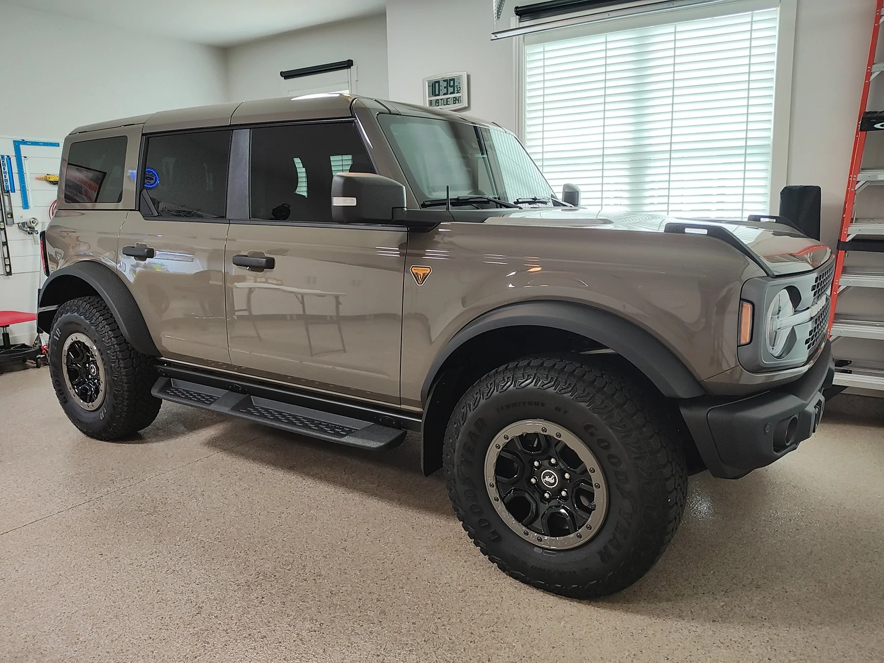

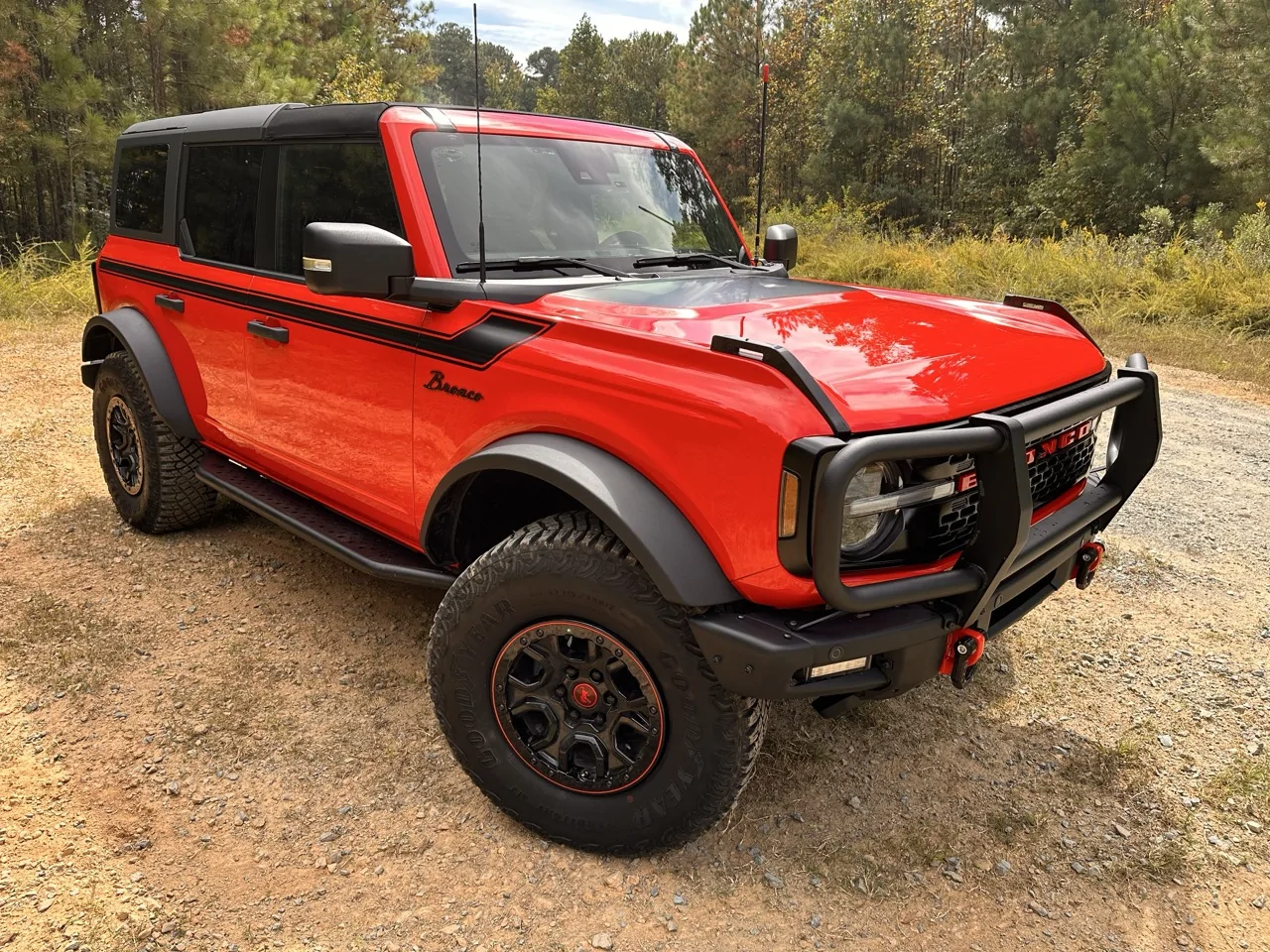

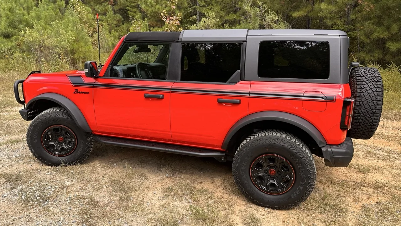

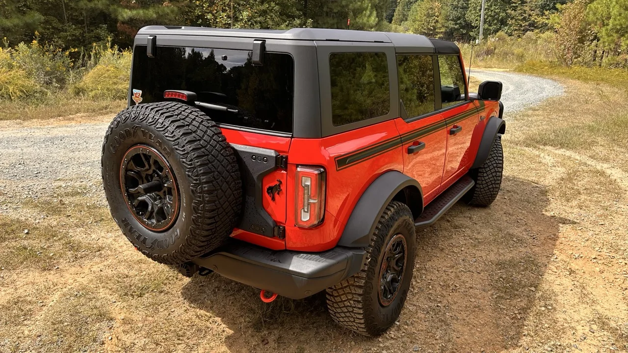

Background:
There are trim rings available that match the exterior paint color. Nothing against them, they are just a little too bold for my taste. I was curious to find something that added a bit of color but wasn't so distracting. Why not fill in that groove on the ring with an accent color? I'm sharing the results because I haven't seen this attempted elsewhere and if anyone is curious about doing this or something similar, here's an example of what it looks like.
Method:
I used a variation on powder coating to give the bead lock trim rings a little extra flair. To do this, I packed powder into the circular groove of the trim rings and baked it until cured. To help apply the powder, I first put some of the powder into a small squeeze bottle to help better control where the powder laid down (aim for the groove). If you want, you can also add powder to the edges of the sunken screw holes, but for the final product I decided against that. I then used a 3M applicator squeegee covered on one end with a monkey strip to level out and remove excess powder from the surface of the ring. It's not as simple as it sounds, since the powder will get everywhere. Multiple passes are required. I used a microfiber cloth damp with window cleaner to clean the squeegee as I went and this helped to remove excess powder. The damp cloth can also be used to clean up the areas where unwanted powder lands, like the outside edge. It is important to clean the powder from everywhere you don't want, because once cured, it's there for good.
The red tinted wheel caps was a mod I did earlier. I was inspired by this post. I used a couple of coats of candy apple red from a spray can and a clearcoat spray. This mod was separate from the powdercoating experiment above, but since it'll be in the pictures, this is the scoop.
Shopping list:
Black Bead Lock Trim Ring Kit (to replace stock silver ones)
Black lug nuts
Application tools:
Monkey Strips
3M Hand Applicator Squeegee
Sprayway Glass Cleaner
Squeeze Bottle applicator and funnel
Powder:
Ford Race Red
Tinted wheel caps:
House of Kolor Apple Red Kandy B/C 12-Ounce Aerosol Spray Can
USC SprayMax 2K Glamour High Gloss Aerosol Clear

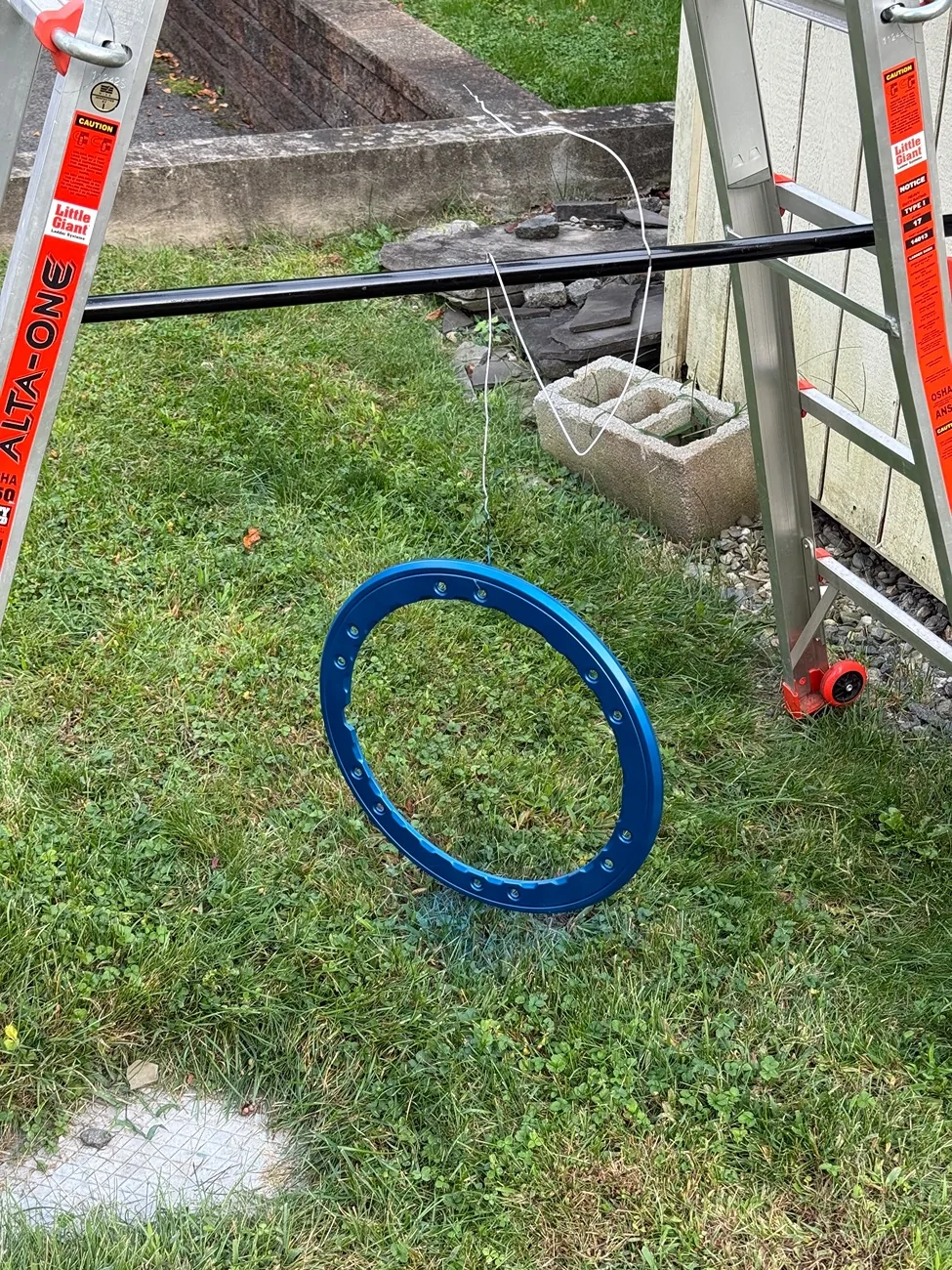

Looks great OP, I agree, I like a more subtle contrast. I powder coated mine charcoal grey, for an even more subtle contrast.

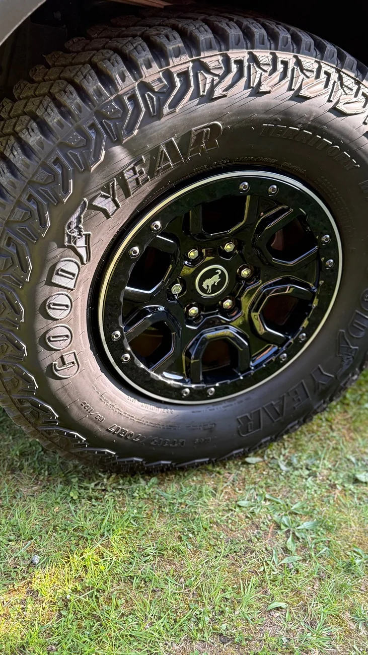

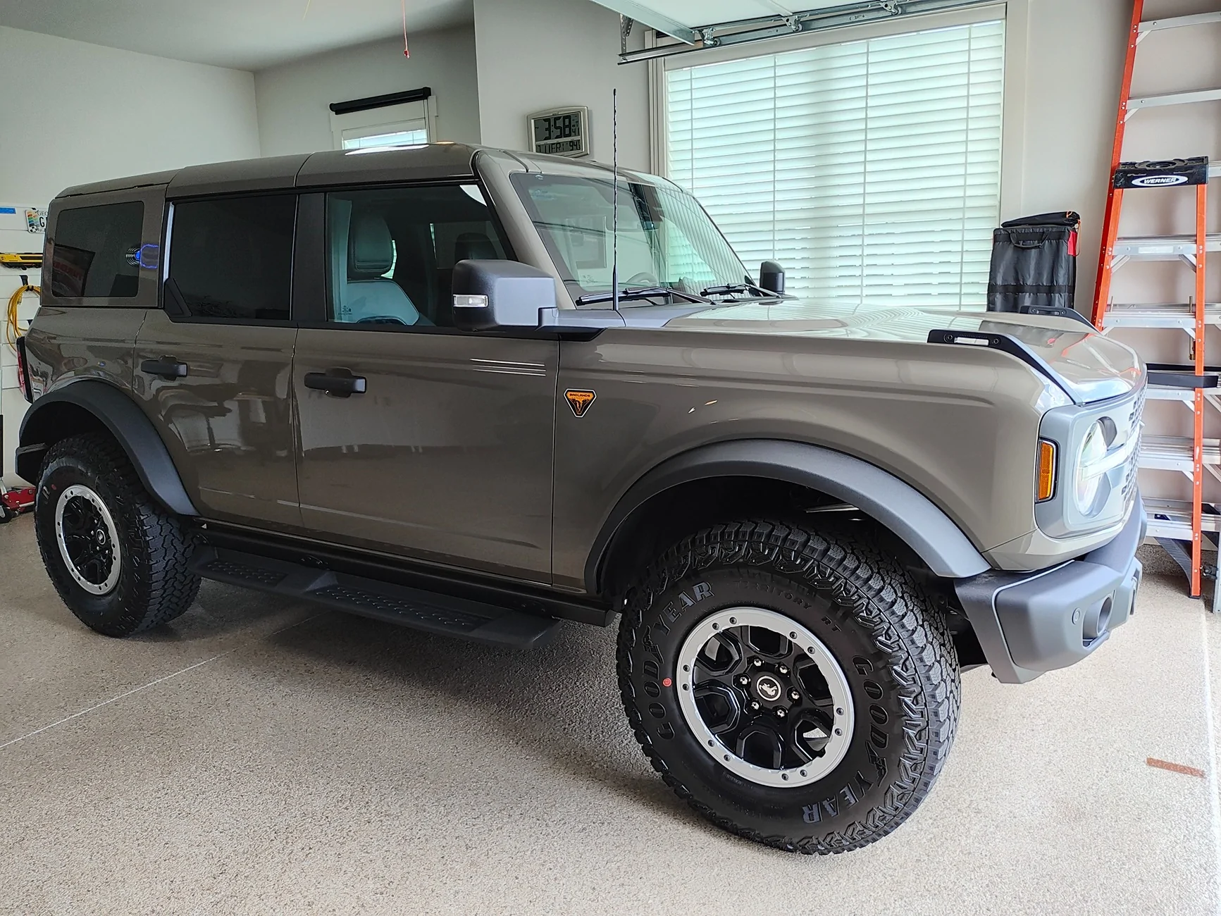

I found this thread while experimenting on how to paint my rings. Yours came out great, btw. I like what you did with the hubs.
Ford Bronco DIY - Paint matched accent for bead lock trim rings IMG_6219

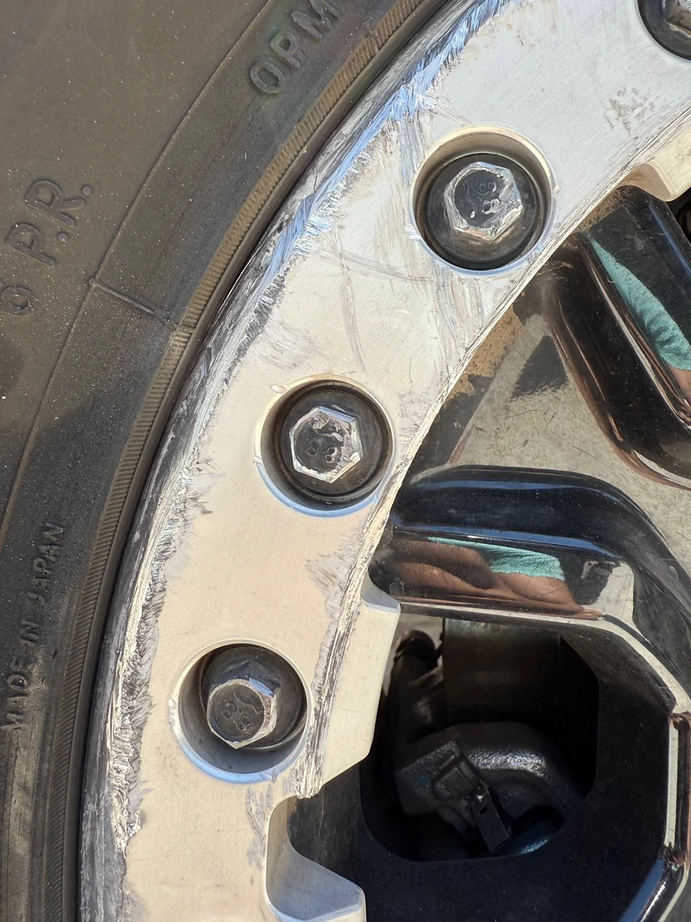

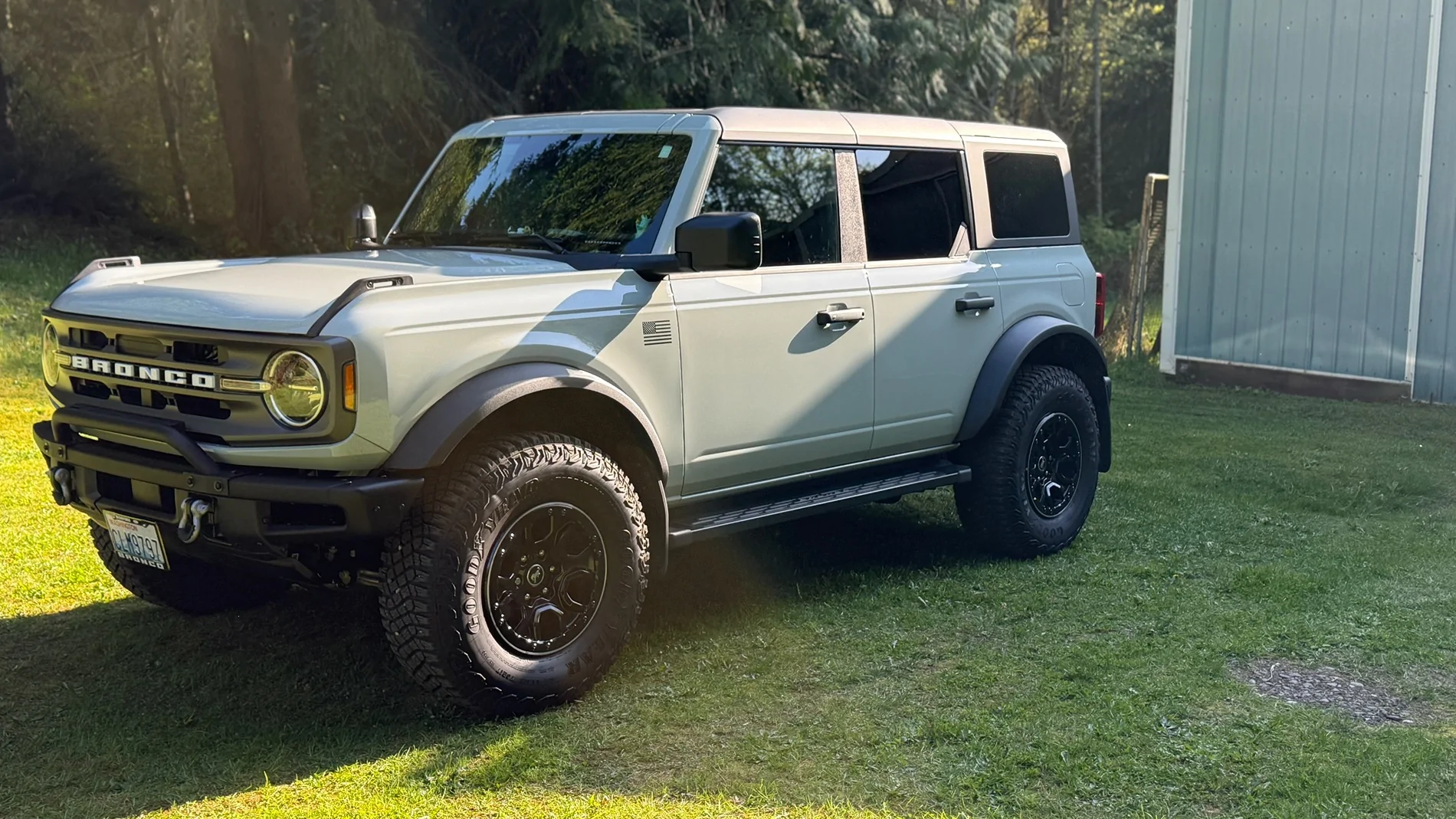

I went a similar route but thought a thin strip of silver looked good. The all black wheel was too much for me. I think the thin line of a contrasting color is perfect. Painting the full beauty ring is hit or miss to me depending on color.
Ford Bronco DIY - Paint matched accent for bead lock trim rings IMG_2301
Ford Bronco DIY - Paint matched accent for bead lock trim rings IMG_2302
adamruiz2001
Aug 21, 2020
1,098
1,449
SoCal
Ford SVT Lightning
What process did you take to get the strip of silver on ring?
tock13
Tony
Oct 4, 2022
69
1,422
2,492
WA State
Mazda, 66 Honda CT90, ‘94 Toyota Xtra cab
i started to make a “lazy-susan“ like mount from piece of plywood that I could mount the ring to and spin it under a stationary mounted sander but just decided to go a simple route and move on.
i used those blades that are used in carpet knives. I just hand scraped the clear coat and black paint off down to bare aluminum. Then I block sanded the raw surface smooth. I think I went 300 grit down to 2000 grit. I left the aluminum raw, nothing is coating it. Been through a winter and summer with no staining or corroding, look as good as when I first scraped off the paint.
I must say, my method is not at all time efficient so take it for what it’s worth. For me it worked great and I love how it breaks up the all black wildtrack look.
