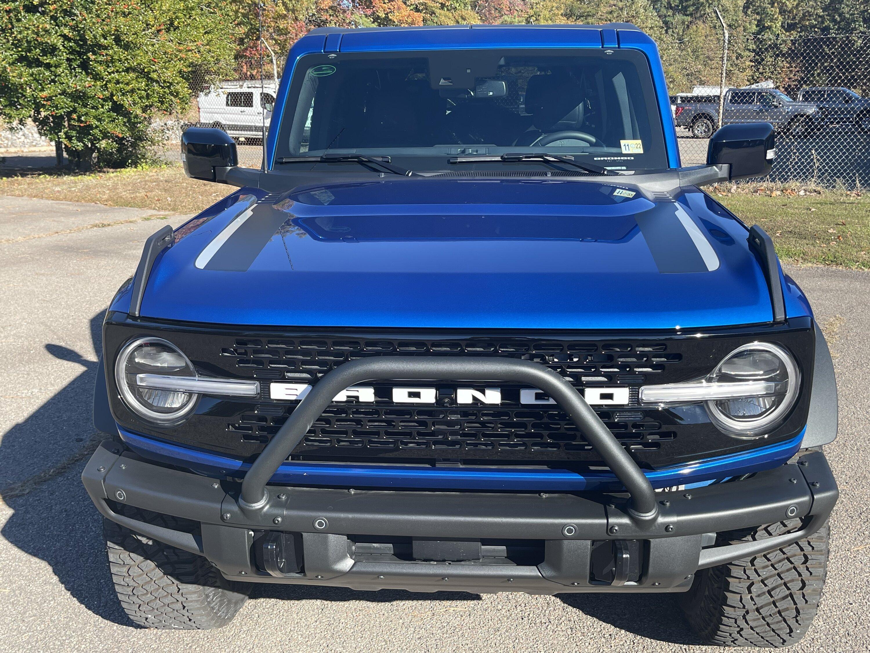

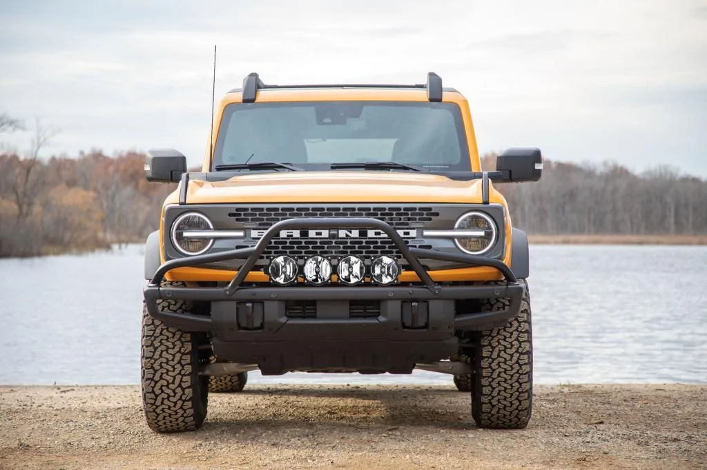

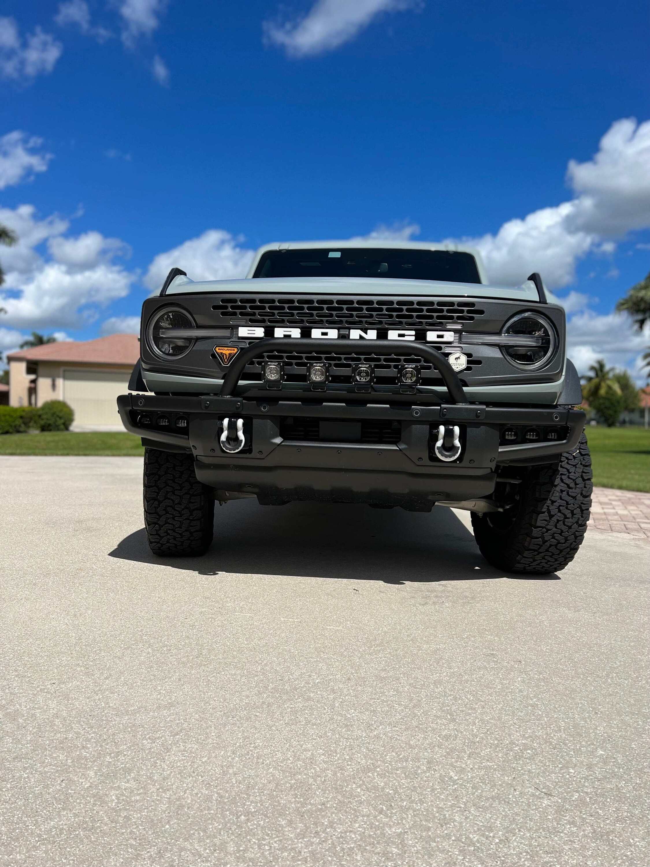

Does anyone know of a setup that allows 4 round lights that fit inside the factory brush guard?
I want this look, but while retaining my factory brush guard if possible. Any ideas?
Ford Bronco Does anyone offer 4 round lights that fit inside the factory brush guard? 1687694006616
Ford Bronco Does anyone offer 4 round lights that fit inside the factory brush guard? 1687694663139
I know it would be a tight fit, but I’m hoping not impossible.
also considering the KC or similar roof/upper windshield mounted bar but concerned about added wind noise.

That looks like it may be tight. I don't think mounting both together will be the issue (may just need longer mounting hardware), but more so squeezing those lights in the middle of the bar. The angle of the original bar, shown in the OP's picture, would be fine. But the newer version that came out pretty quickly after might be tight.
Hopefully I'm wrong. Best of luck with this!

Yeah, I don’t want to hang them from the factory brush bar but want to mount them to a bracket basically on the bumper like that photo but with larger diameter lights and using the factory bar.
Ford Bronco Does anyone offer 4 round lights that fit inside the factory brush guard? 1687699910287

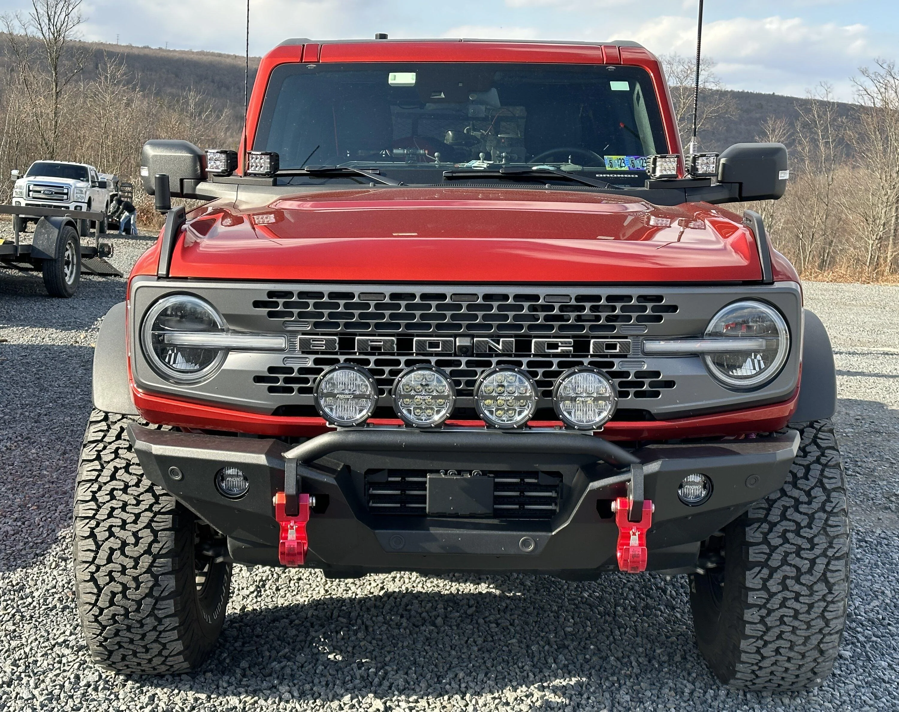

I was hoping to run 4 6" KC Gravity lights as well. Unfortunately, I think they are going to be too big to fit in the space. specs show that they are 6" wide but 7" tall, plus mounts I just don't think that there will be enough room.

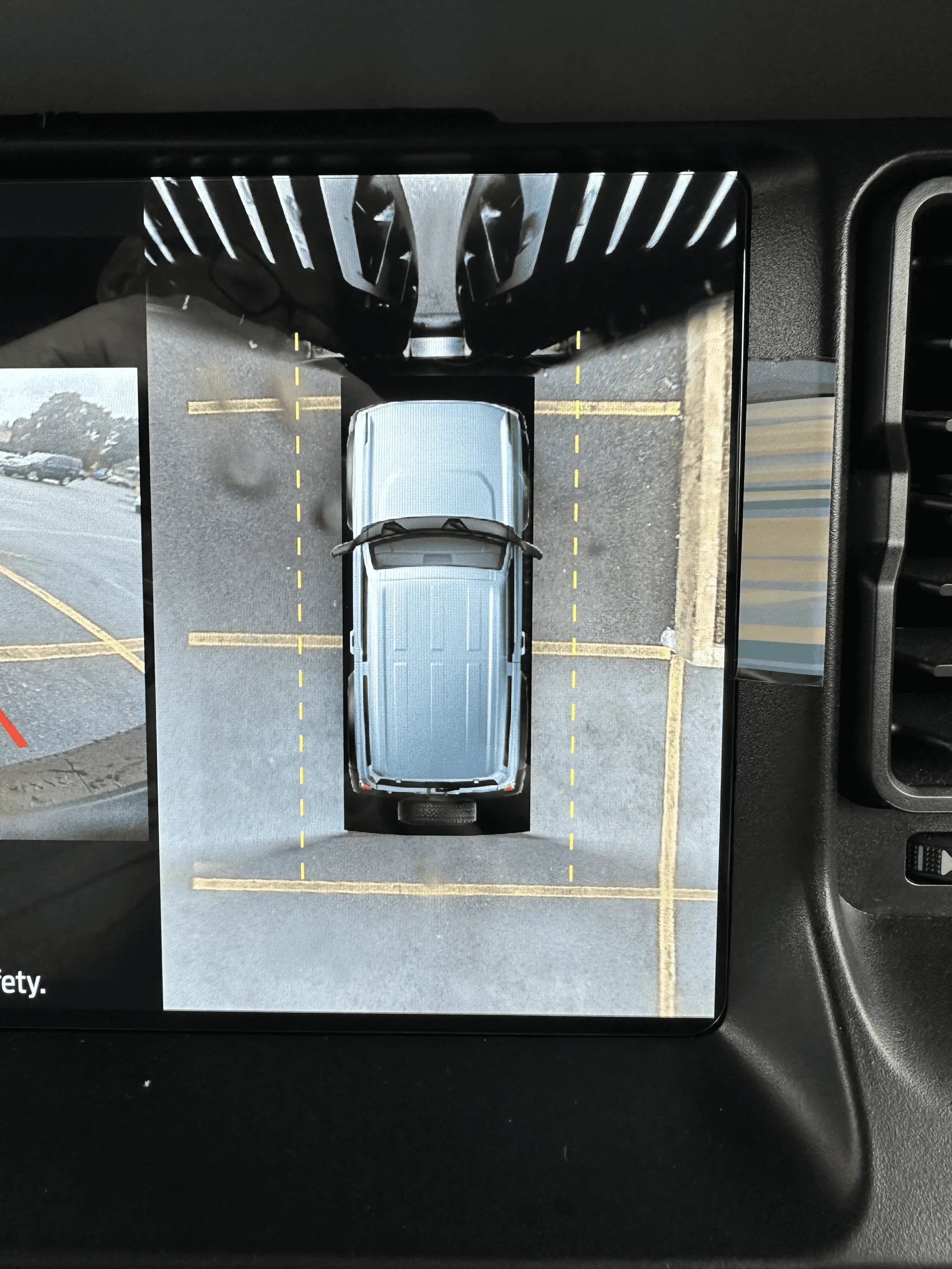

To make matters worse, it looks like having 4 large lights so closely spaced is going to eliminate 95% of the view from my front camera. Another member was kind enough to share some photos of his 4 light setup which I love the look of, but losing my front camera is a deal breaker for me.
As shown below, all you can see is the back of the two center lights.
Ford Bronco Does anyone offer 4 round lights that fit inside the factory brush guard? 1687973986168
I an now leaning towards using 2 6" KC lights or possibly a smaller Baja Designs setup.

The thread original photo shows Rigid 360-series round lights... can't tell if they are 6" or 4" round. Rigid has both sizes. The 360-series 4 inch might fit.

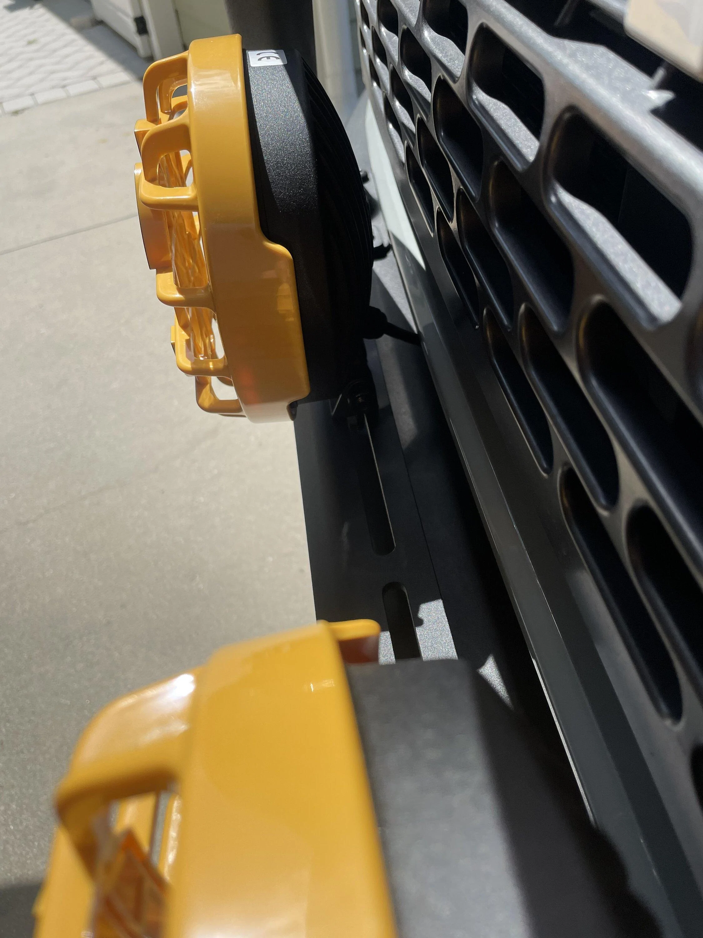

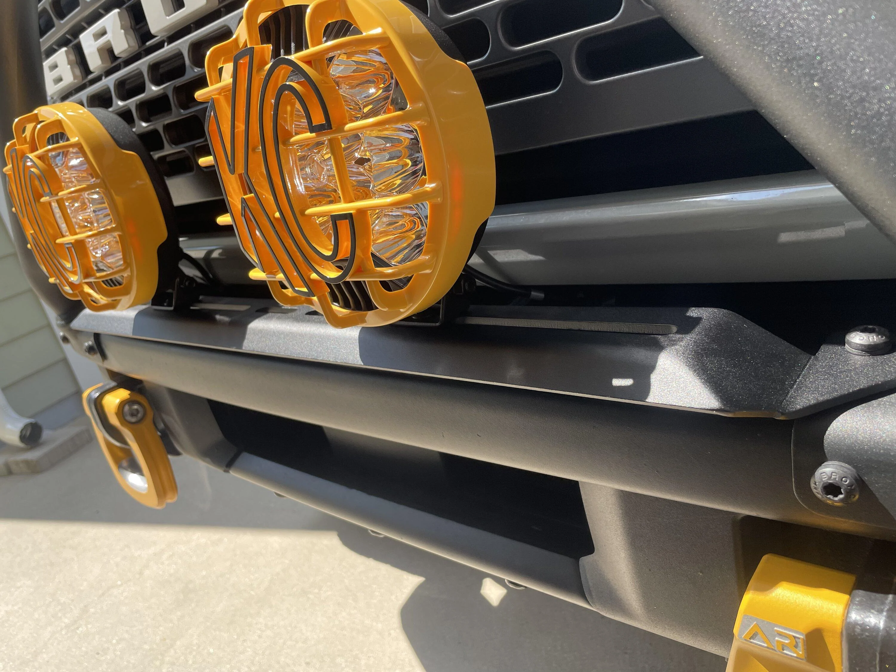

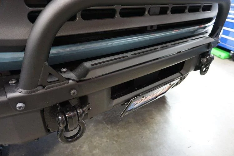

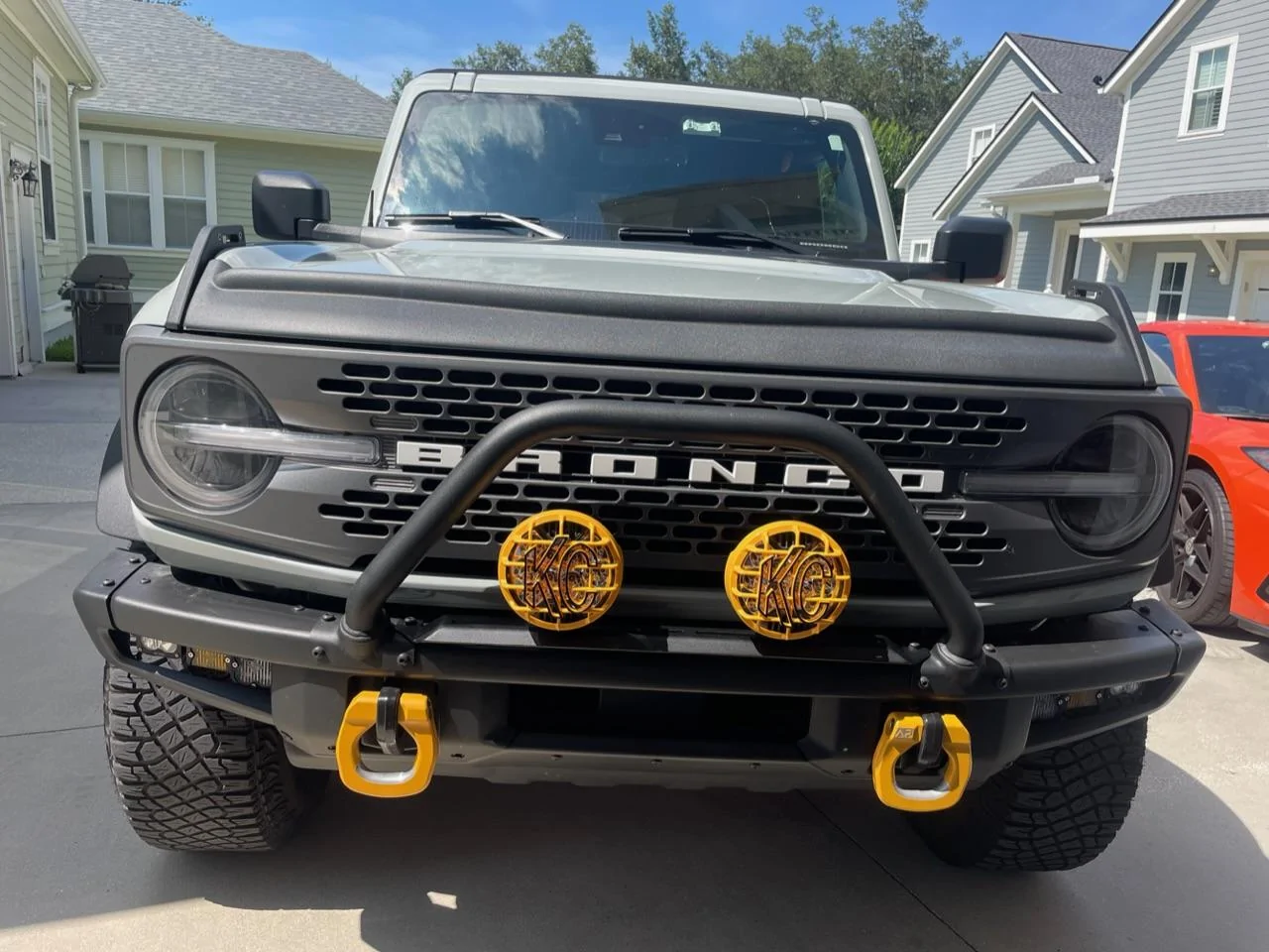

I just got the mount in and works perfectly the way I wanted it to for 2 6” KC lights. It’s a nice piece with the slots and feels extremely solid with a thick section and shape. Perfect alignment with the brush bar top bolt, though is light being aluminum. Pleased on day one since I didn’t need to wait any longer for the US made bars in stock that seemed to still needed me to change the mounting bolts for the KCs I have since they would be too long but with this bar it’s all clear of the bumper easily. Anyway just the look and mount method I was after. With the slots, good offset from the grille and bumper it should work well for any set up.
https://greenlaneoffroad.com/6th-gen-ford-bronco/2021-bronco-front-light-mount-bar
Ford Bronco Does anyone offer 4 round lights that fit inside the factory brush guard? 038EAAE3-BD67-4FF7-9EB7-126EEDE0FB6A
Ford Bronco Does anyone offer 4 round lights that fit inside the factory brush guard? FB1B9535-5985-4341-943D-65EA60606299
Ford Bronco Does anyone offer 4 round lights that fit inside the factory brush guard? 0DDBB356-3EC1-4F30-9694-3A05D8CD927E

Your setup looks great - thanks for the pics. I think that makes my mind up (other than if I should also get their ditch light mounts while I am at it.
