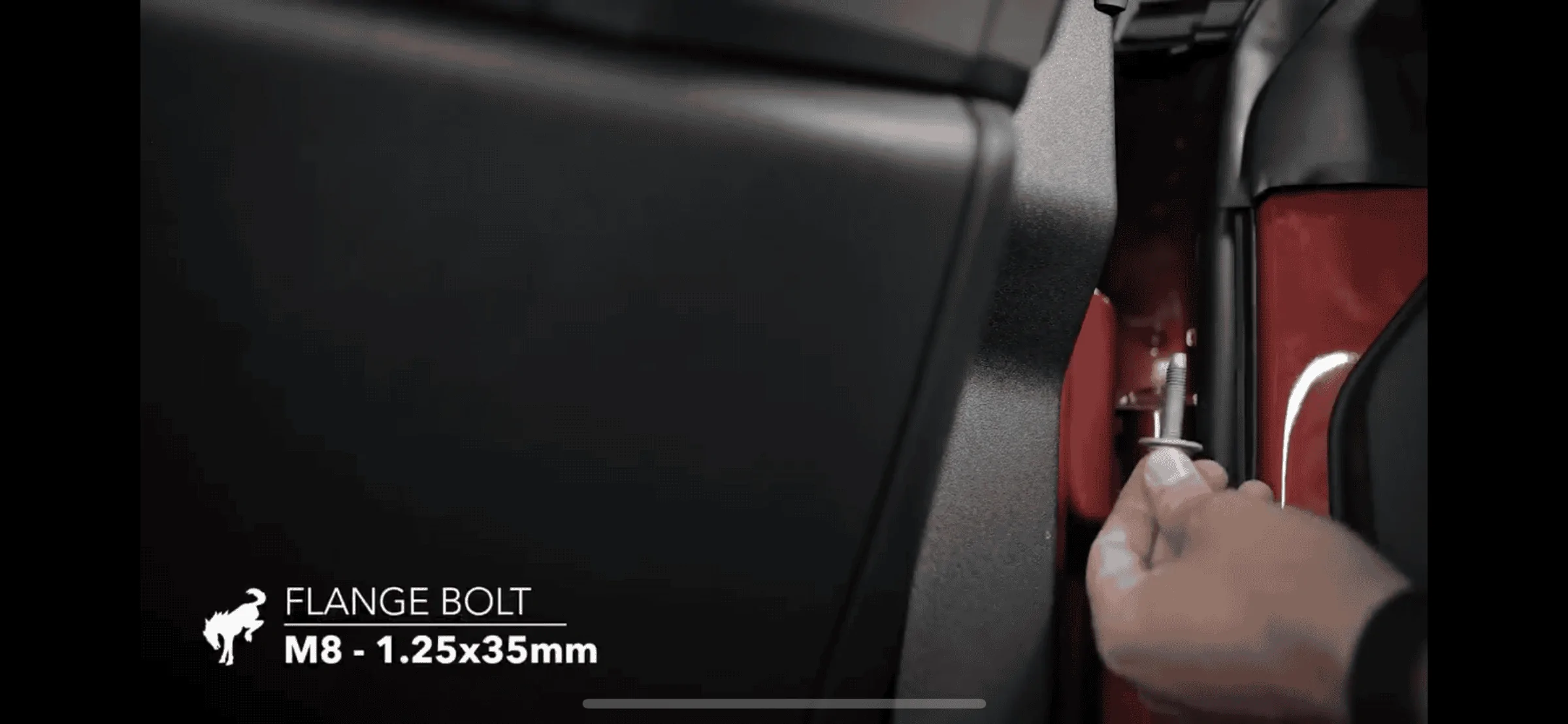

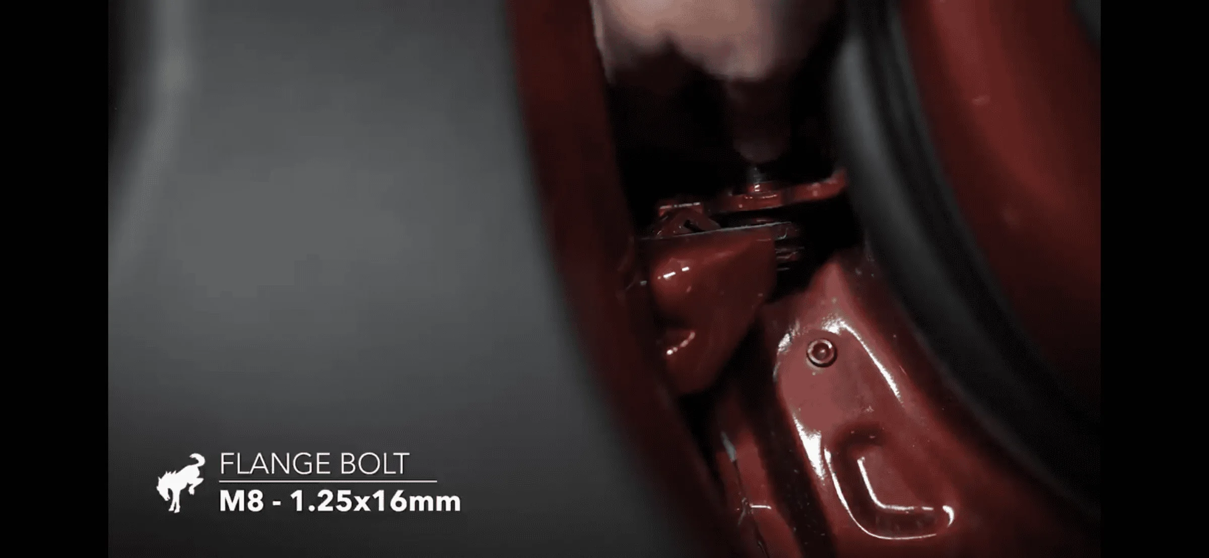

I lost an upper bolt this weekend off-roading in NC & TN (I didn’t remove the doors this trip. I’ve had them off before but not since Memorial Day). Ordered some M8 - 1.25 x 35mm hex bolts on Amazon, which were delivered today. It fits perfectly and I’m considering buying a couple 16mm to keep in my toolkit. Thanks for the assist.

W721743-S439 upper for all doors
W721744-S439 lower for all doors
