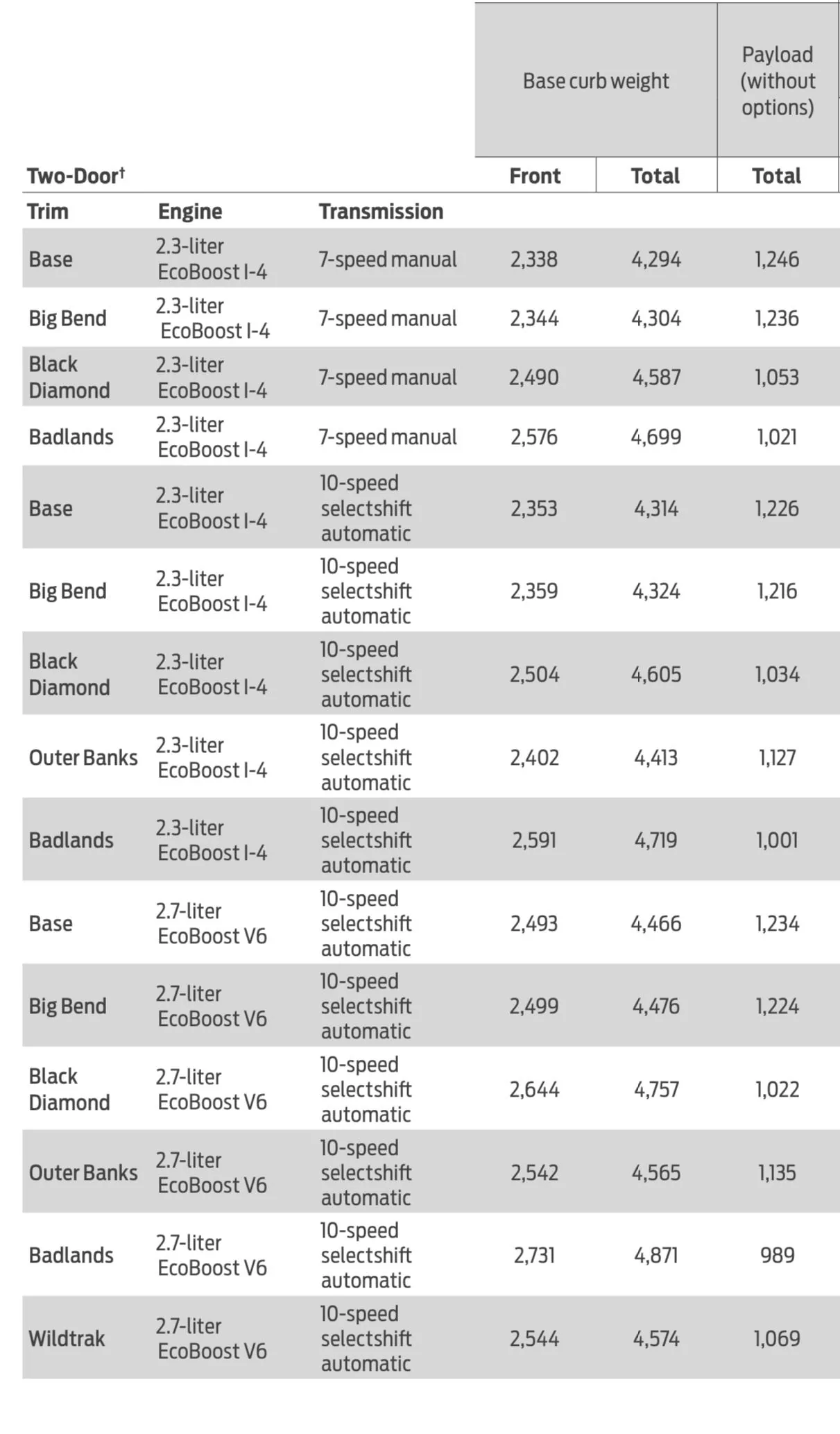

Thank you. Just looking at the weight of the 2.7 Badlands compared to all other trims it’s the heaviest Bronco which may warrant the 550 even without extra weight added. The Eibach Coilovers are one size fits all but it seems like they should have a few options based on trim.
Ford Bronco Eibach Coilovers NOW AVAILABLE! IMG_3029

Cool chart, great information there
Looking at that I would have to agree with you. Especially with a steel bumper
